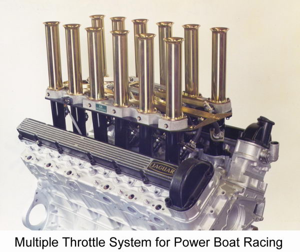

The more I think about this and consider this project the closer to succumbing to temptation.
The valid practical considerations raised by Greg and others regarding physical space limits, air filtration and need for ecu remapping to accommodate likely slight increase in air flow are problems that need a solution. Indeed Jenvey allude to tight space limitations in the fitting instructions for their kit ..."The kit fits very close to the cam covers and under the bonnet"
Incidentally could anyone confirm what if any differences there are between bonnet for 4.0 L and V12 bonnet (6.0l facelift in case it matters )
If someone would convince me that they could install this on anew XJS in a competent manner I may bite the bullet.
Also not directly related as it's from a marine application of V12 Jaguar engine
The inline 6 cylinder bonnet had a hump in the middle to clear the upright engine. The V12 cars, pre facelift, did not have this hump. All facelift cars, regardless of engine, had the same hump bonnet. In any mod of this sort, using a later/6 cylinder bonnet must be a good idea as there will be a touch more space available in the middle 12 inches or so. Theer are no fixing changes apart from the catch, so just be sure you get a bonnet with the same shutting catch type.
As to Q2, drive it down to France and I will quote a very reasonable charge! Seriously, though, I could recommend a couple of very good independent Jaguar guys, but not that close the Wigan. I am sure so could loads of other posters from the UK.
As RB said, air filtration would be a problem. If Jenvey have no ideas, some sort of huge lightweight fabricated box with the trumpets poking into it, with a large diameter filtered feed from the front/headlight nacelles would seem to be the best option.
Greg
