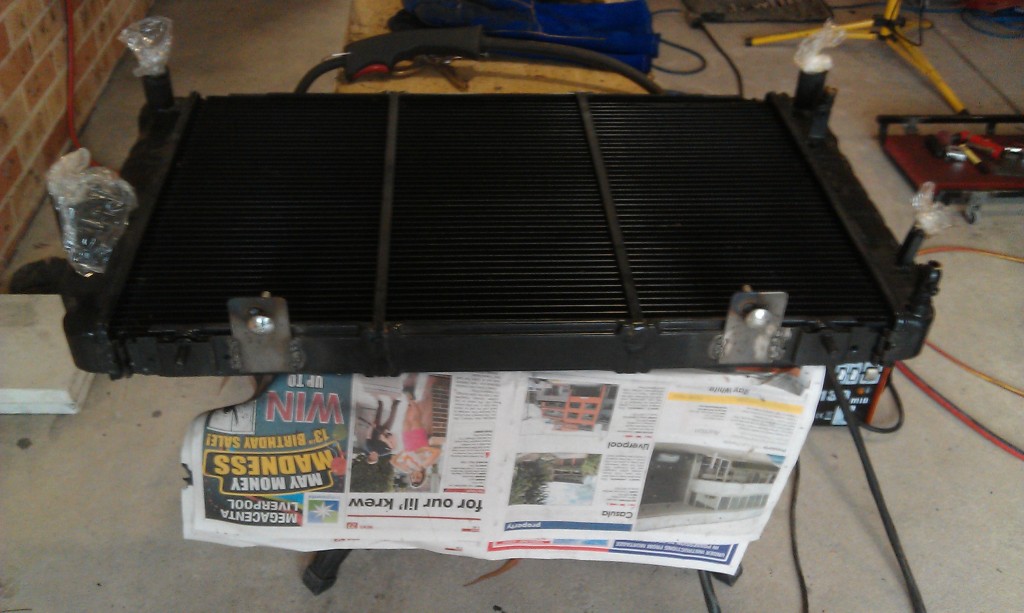

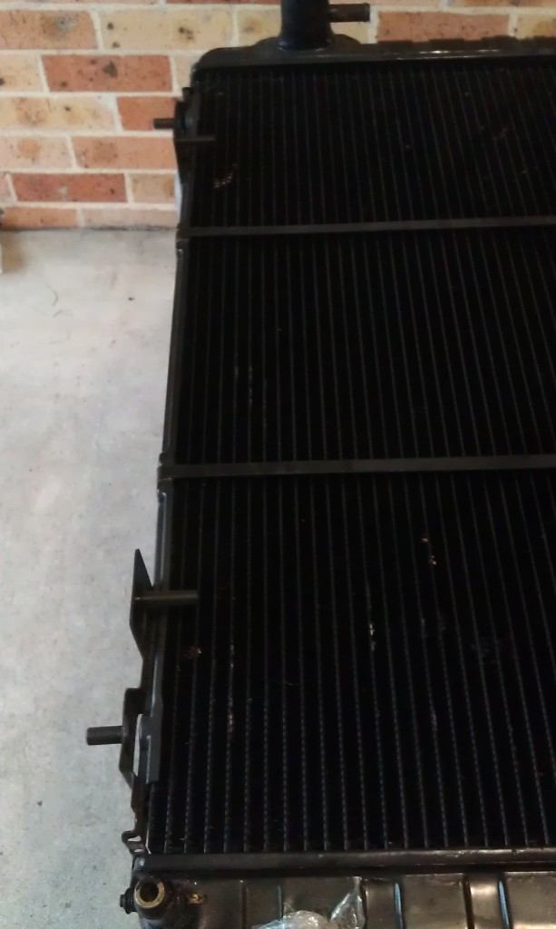

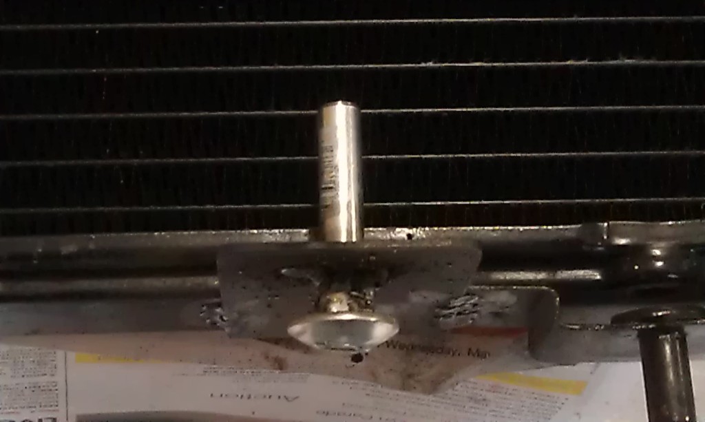

Ok I would use 2 16" fans. Same size as the Ford fans I have (same as Grants)
You could use aluminum bar 25x3mm to mount them. Run the bar vertical, use the t\radiator top support to fix the top and fab something for the lower mount. I welded a couple of pins to the bottom of the radiator that holds the bottom of the fans with a U shaped clip that fits over the radiator and holds the fans, the rad top support holds the U clip in place.
These pics will give you an idea - did it this way to make it easy to remove the fans for servicing as I had the rad out.
Bolts Welded in place
Tidied up and painted
