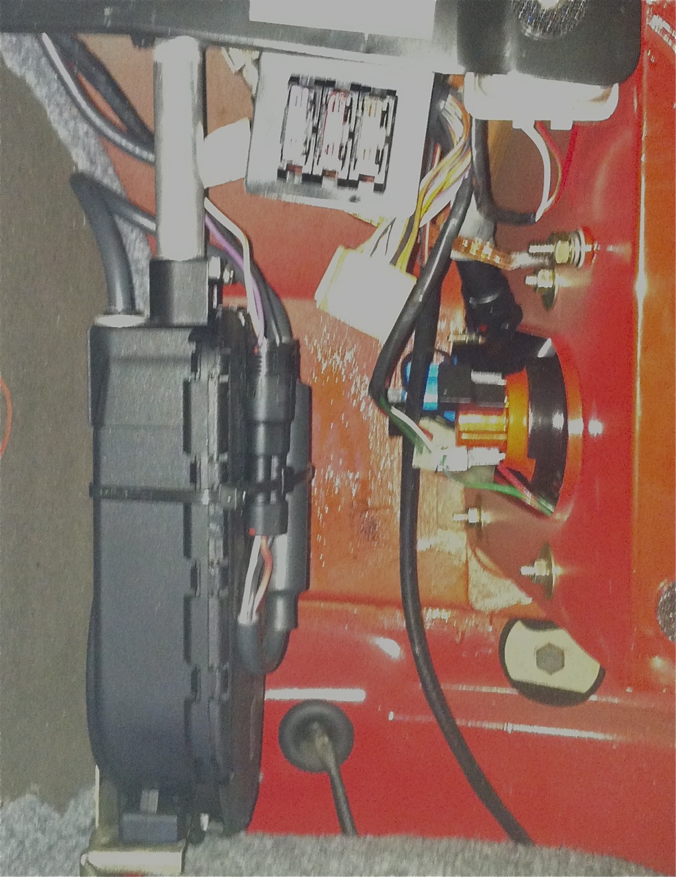

The large white plastic block connector in the foreground is for the security ECU...

Yup, the range of the remote from new is about 1 foot,......... and the remotes antenna runs down the UK driver side only !! So really bad on the left side. Its the black plug. I had thought about re-routing it down the left side.
