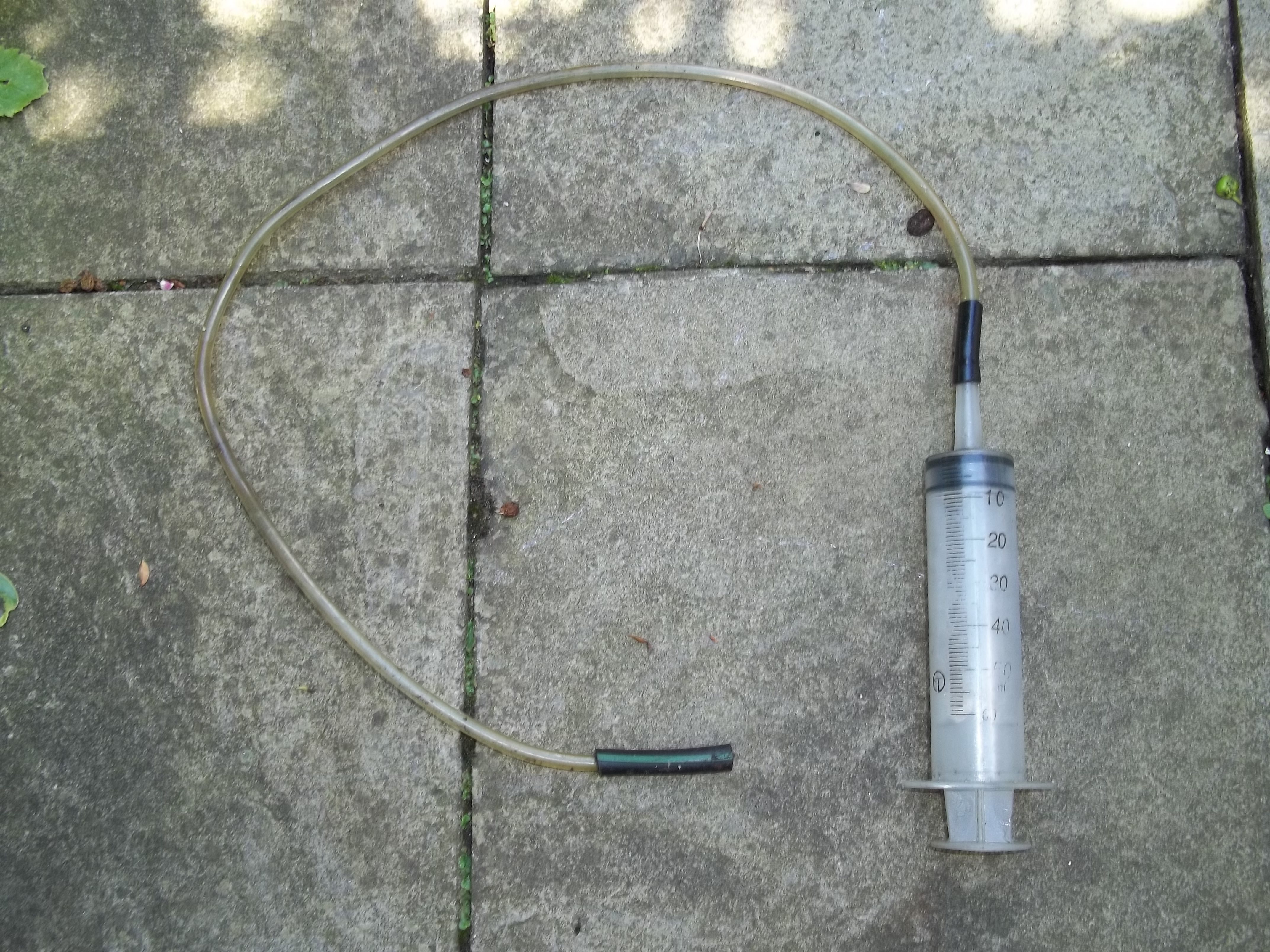

I use a big hypodermic syringe used for stem cell transplant available from chemists with plastic pipe, you may have to put grease round the nipple to stop drawing air in though

Now that looks like it might actually work! (for a change!)

Problem Solved and here is how I did it.
First of all I got myself a Syringe like rpg together with a piece of Polythene Tube that was a really good fit on the Bleed Nipple and a good fit on the Syringe.
Then used it to try and Suck the Brake Fluid, from the Reservoir to the Caliper, unfortunately this method didn't really work that well for me.
So next I tried 'Gravity Bleeding' as suggested by 'Plums'
I already had the Polythene Tube, which was a really good fit on the 'Bleed Nipple'
So I put the Tube on the 'Bleed Nipple' and then tied the middle of the Tube, to the Top of the 'Shock Absorber'
In order that any Brake Fluid, coming out of the Caliper would have to Climb up hill, before going down again into the Jam Jar.
Then I opened the 'Bleed Nipple' half a turn, at which point the Brake Fluid came out of the Caliper and started to climb up the Tube, together will some Air Bubbles!
The Fluid only Climbed about Six inches up the Tube, so I got into the Car and 'dabbed' the Brake Pedal (only little touches not the pedal to the floor)
Then got out and checked the progress of the Brake Fluid in the Tube, which was nearly up to the top of the bend, where I had tied the Tube to the Top of the Shock Absorber.
With lots of little Air Bubbles, making their way up the Tube, I stopped for a Cuppa, after topping up the Reservoir.
Ten minutes later all the Bubbles had gone and even a few more 'dabbs' on the Brakes failed to produce any more, at which point Brakes Fluid was starting to drip in the Jam Jar.
