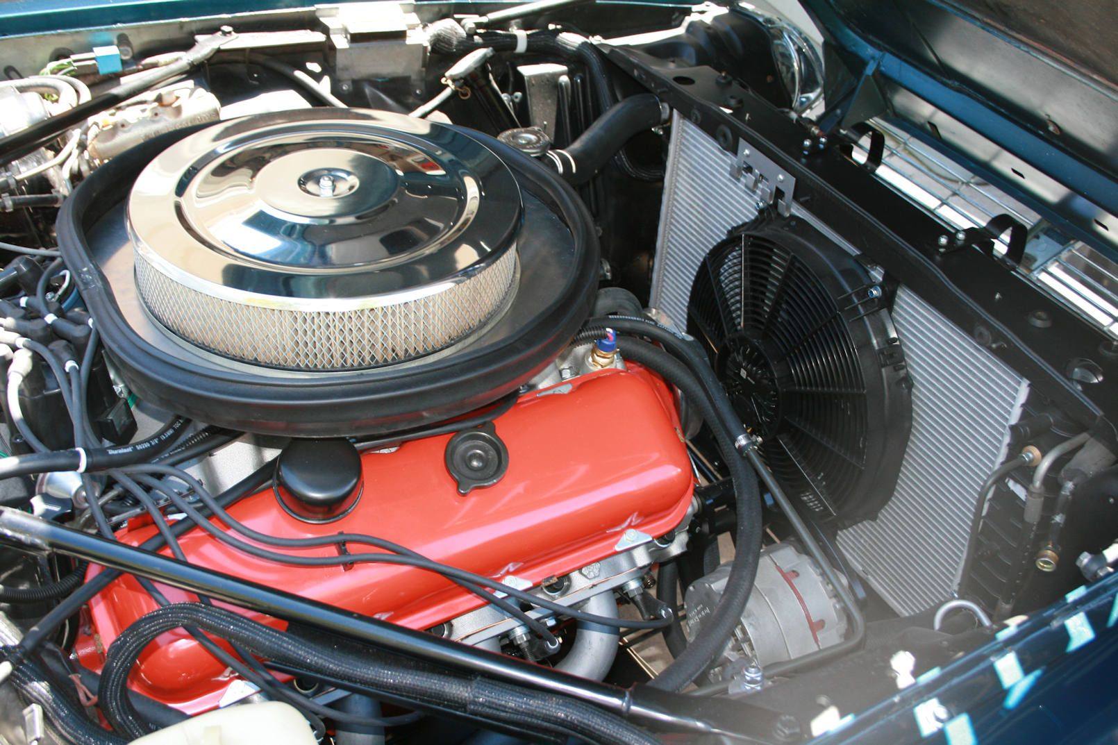

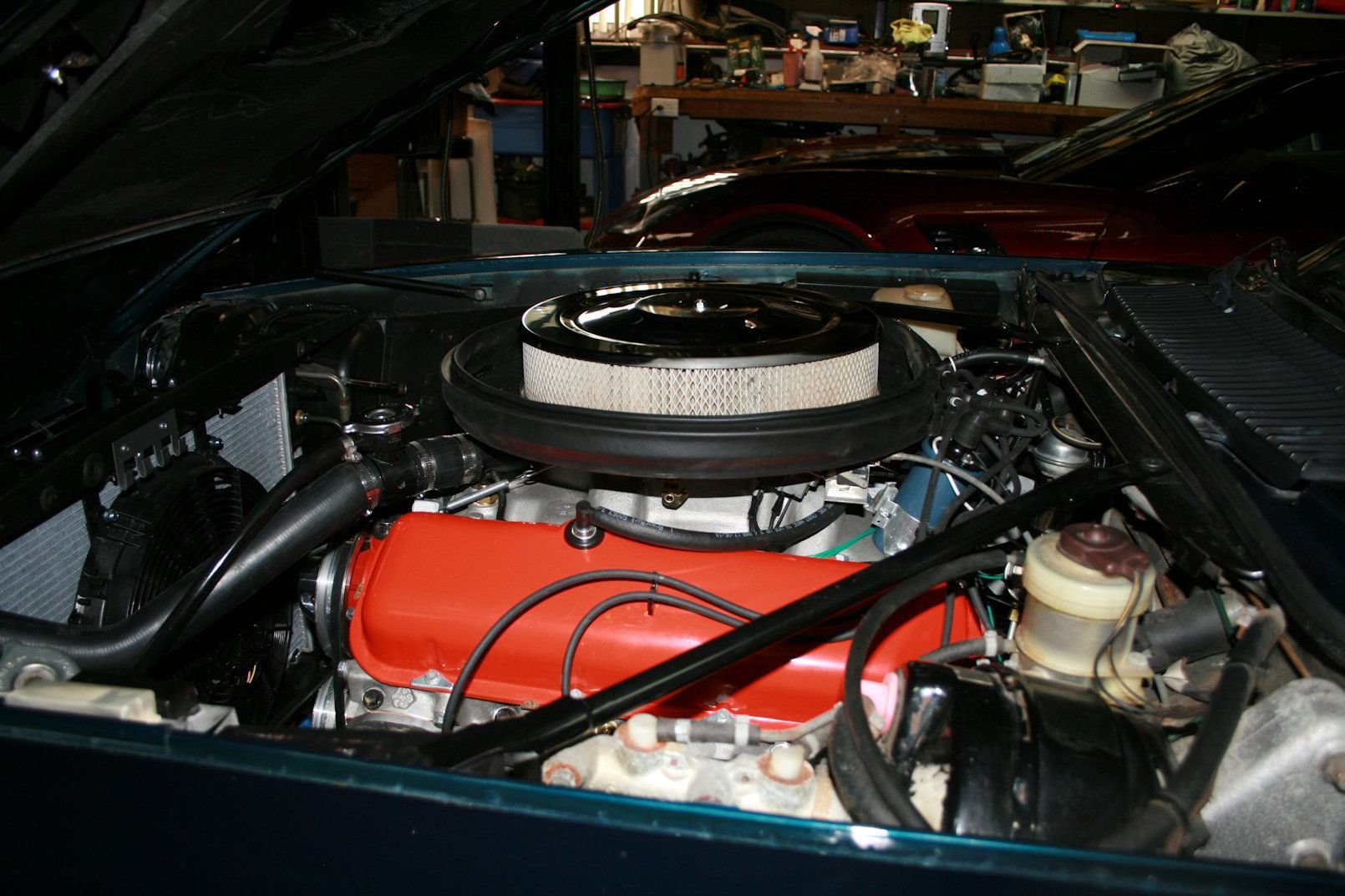

479 CI Big Block Chevy. 540 HP.
lots of room to work on it
Cold air intake from the cowl
The current swap is typically an LS motor, they are reasonably price, will blow the doors off a V12 car and conversion kits are readily available. They weigh less than the V12, so you may have to use different front springs, or cut a partial coil off of them. I see you are in CA, you still ahve to meet emission standards so an LS is the way to go, but investigate what hoops you need to go thru. I believe you have to meet emission for either the year of the motor, or the year of the car, which ever is newest. Google jaguar v12 to LS conversion kit. Someone in CA makes these, i believe, they can answer your questions.
