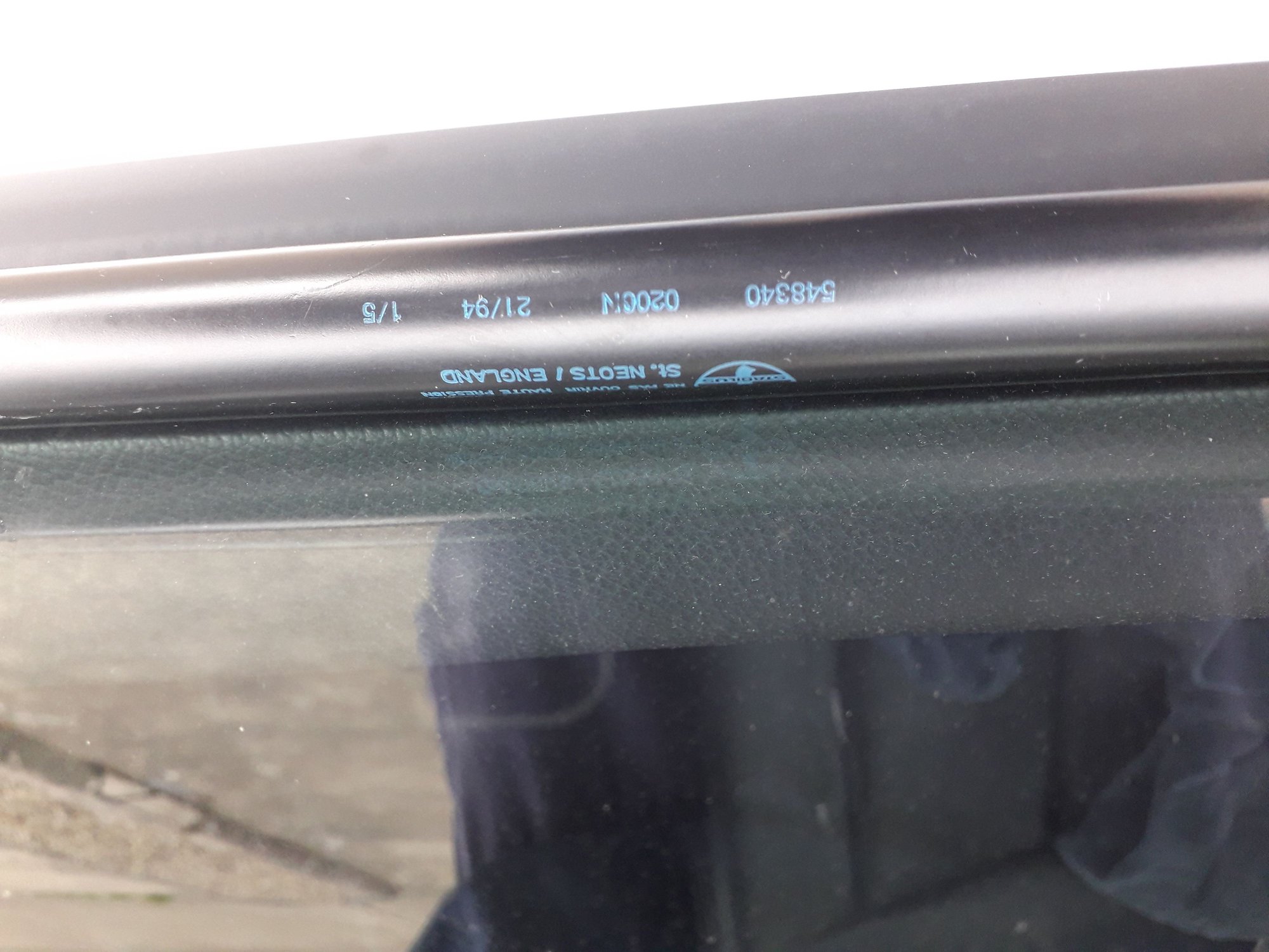

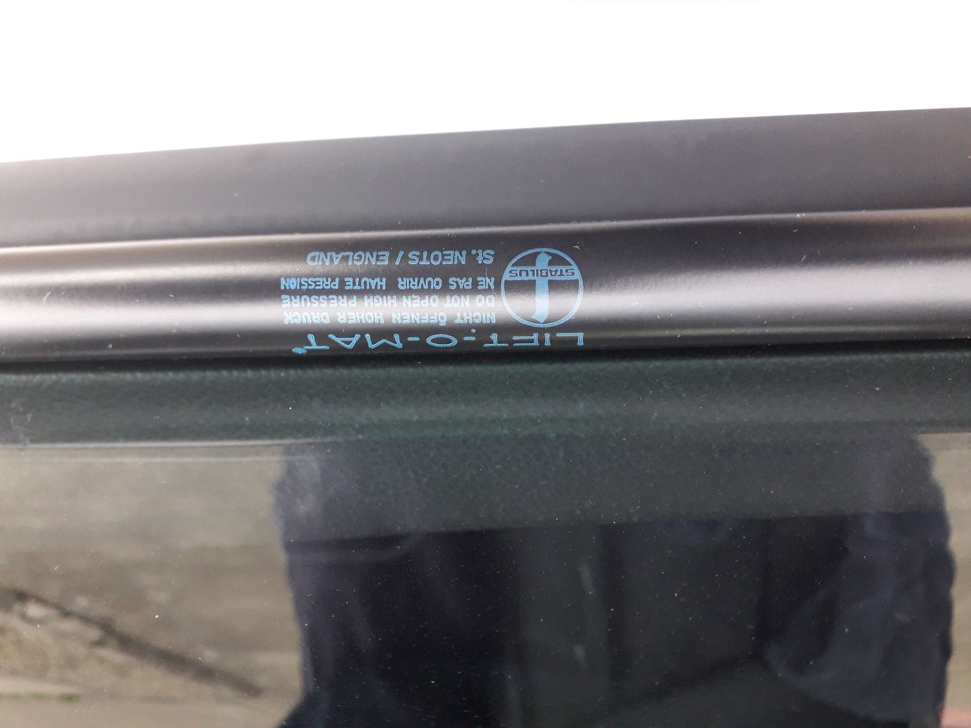

The original struts, as with a number of JLR vehicles were Stabilus Lift-o-Mat. Different parts depending if a spoiler was fitted.
For non-spoiler cars, the attached pics show the original Stabilus parts including part number. I now have the uprated struts fitted so can show pics of that part number if you need it.
Hope that helps
