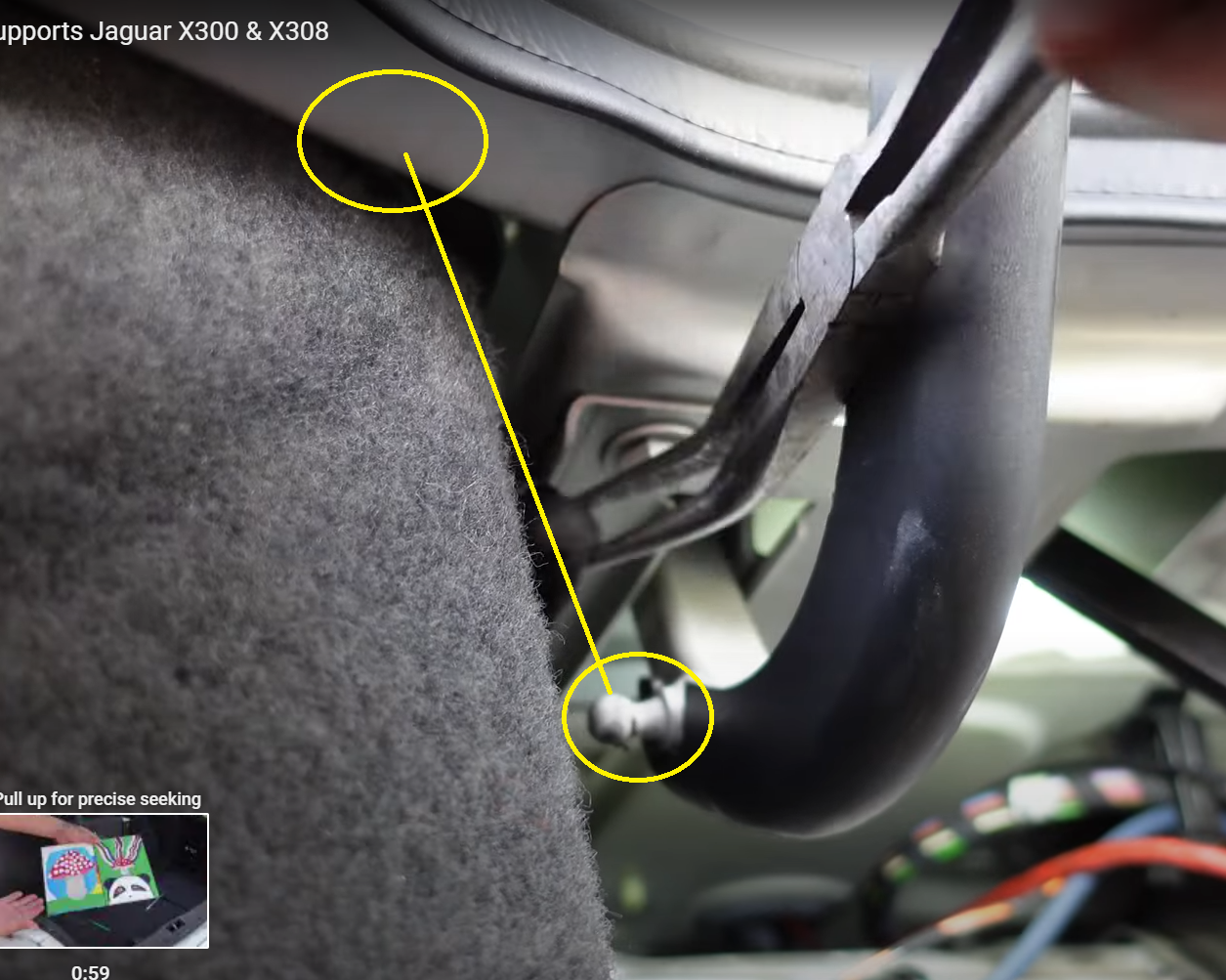

Hey i was wondering if anyone had done and/or had any ideas on how to possibly make the boot/trunk open all the way rather than just pop once unlocked.
i have seen these springs which in some cases look easy to install but i can't quite think where would be the point on the hinge and on the car body to attach., as the spring needs to be fully relaxed when boot is open and under stress when boot is closed.
it is possible simple and i am just missing it.
or is it maybe a case of getting some upgraded boot struts?
some with some more power might actually force the boot to open by itself.
maybe install it as marked on this image?
so that it is essentially opposite to the gas strut.
so as the boot closes it gets pulled tight so when you pop the boot it wants to relax and pull the gust strut out

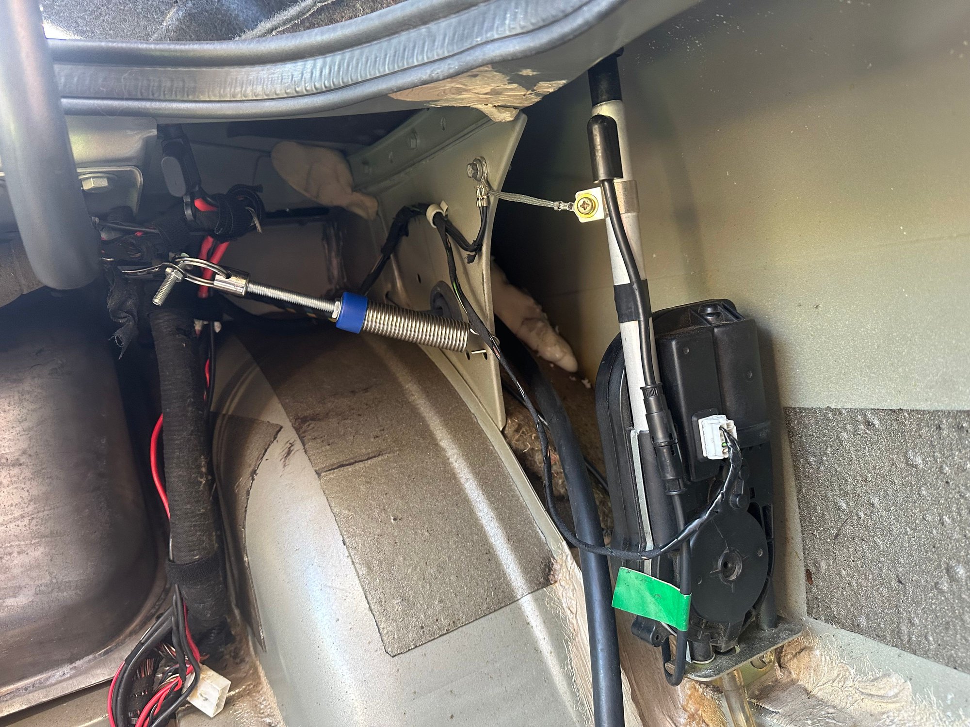

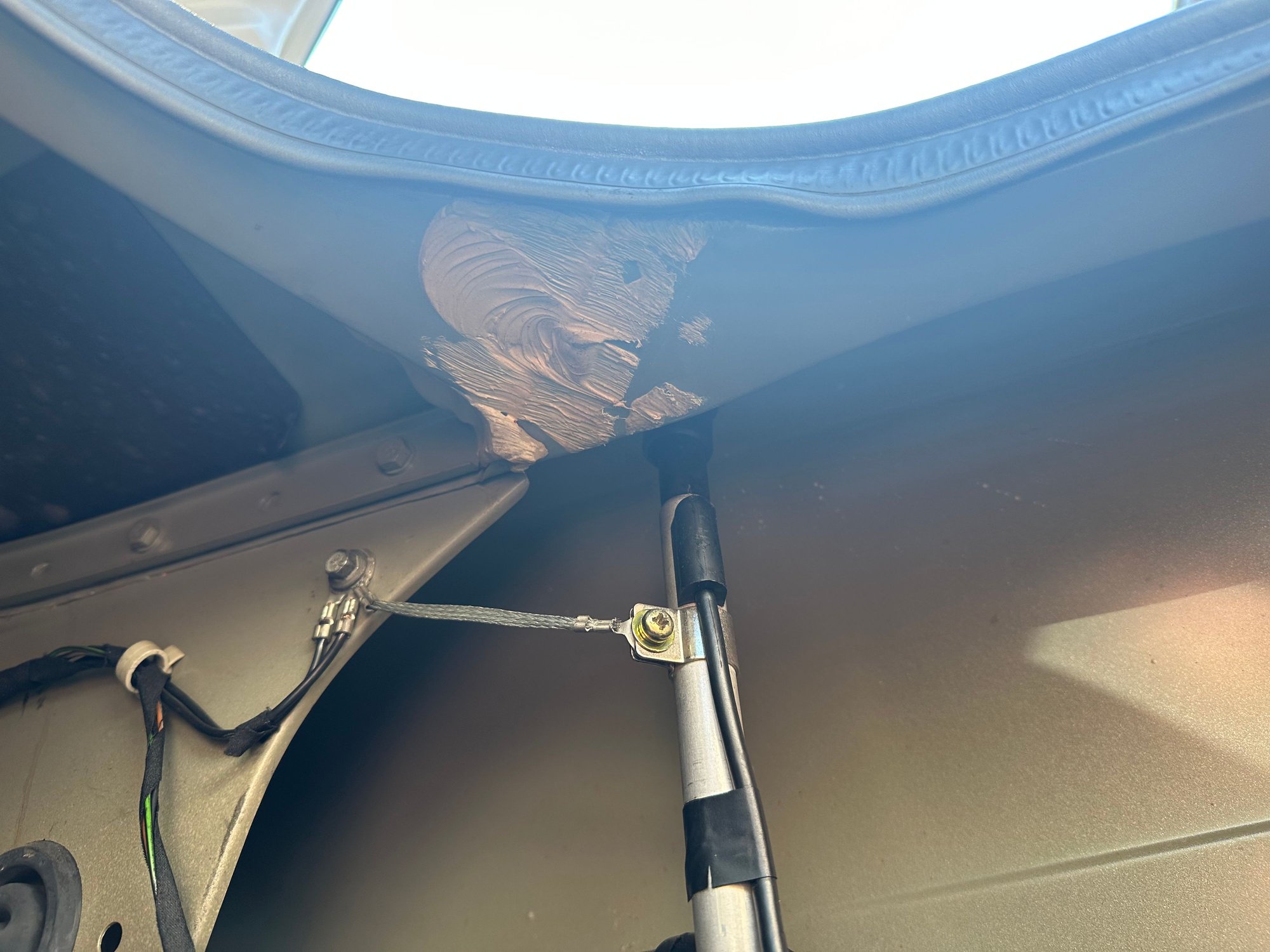

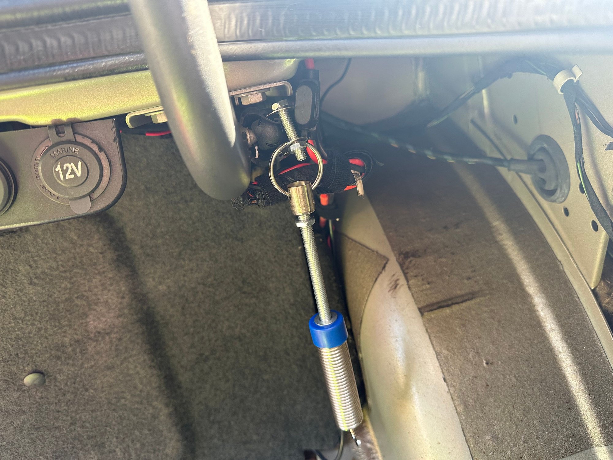

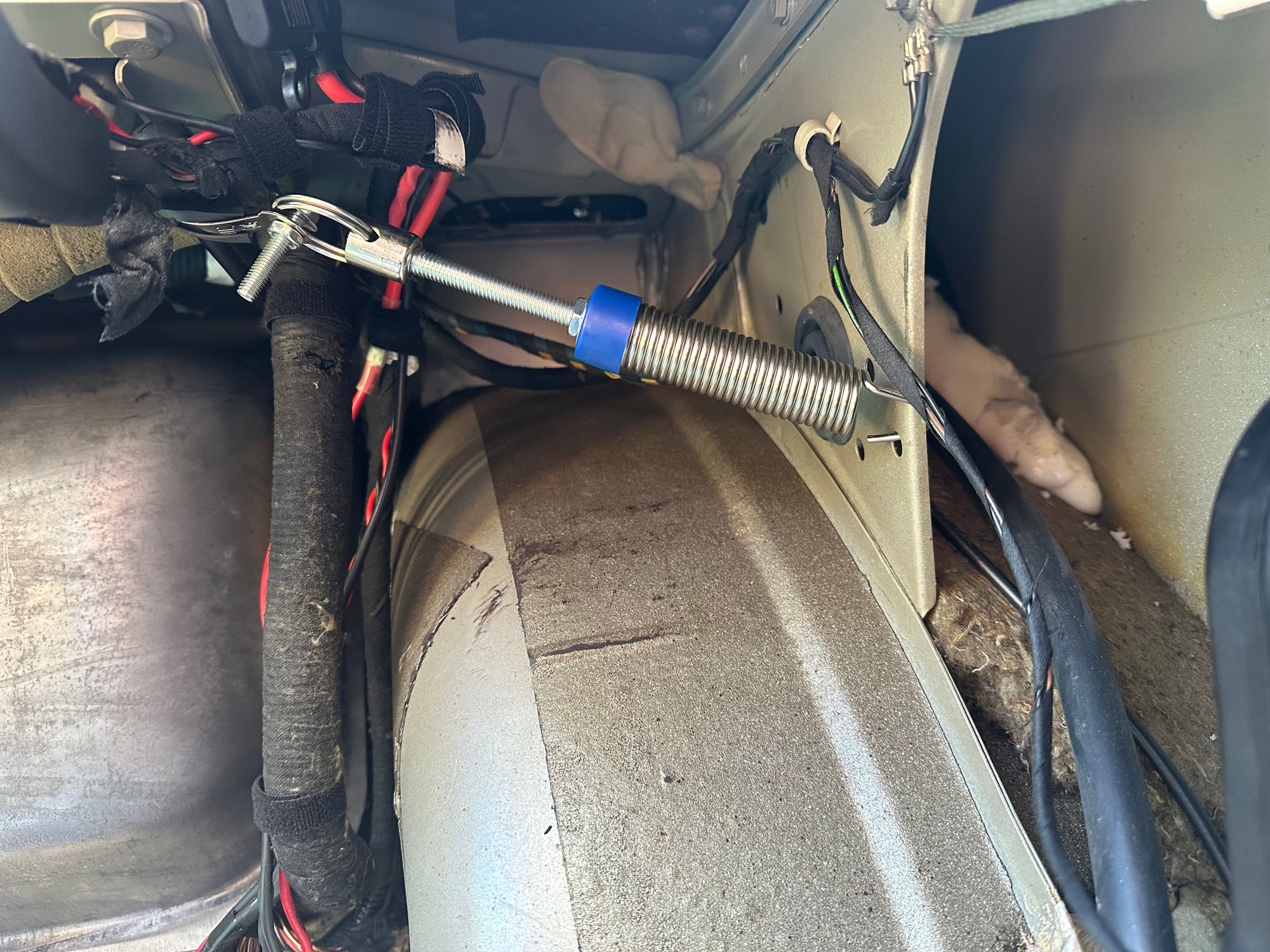

Ok, so sometimes the simple solution is the best solution.
so these springs are designed to pull on the strut.
when the boot is closed they become under tension.
so as soon as the boot is popped they want to remove the stress and return to relaxed state. in doing so they pull on the boot struts and begin to open to boot.
at some point the boot struts take over and push the boot all the way open.
simple yet effective.
physics for the win.
a mechanical connection is always much more reliable than an electrical option imo.

also just something to note.
as the springs are under tension as you close the boot, the boot requires a bit more force to shut it (not too much so that it is annoying) but enough that it is noticeable and will stop the boot from slamming ****.

Spud, you did it, and its perfect! The struts just aren't strong enough without springs. This is the way it should have been done by the factory. That lid is heavy and it is very annoying when it falls and slams shut. Nice work. It is now on my list of useful mods.
