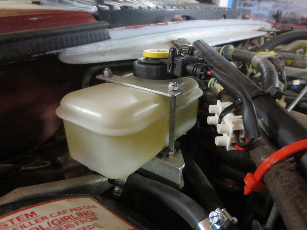

I have gone through three reservoirs in 17 years. They leak and as you say, it seems impossible to buy just the lid, and the entire thing is idiotic money. So this last time I went aftermarket, much cheaper, much better made. this is what it looked like from the supplier (but all aftermarket places have them):
2 Chamber Brake Fluid Reservoir - Car Builder Solutions - Kit Car Parts and Accessories
And installed:
The only thing is you need 8 mm hoses and then a reducer in the line to step them down to the size of the master cylinder inlet. Not difficult to do.
