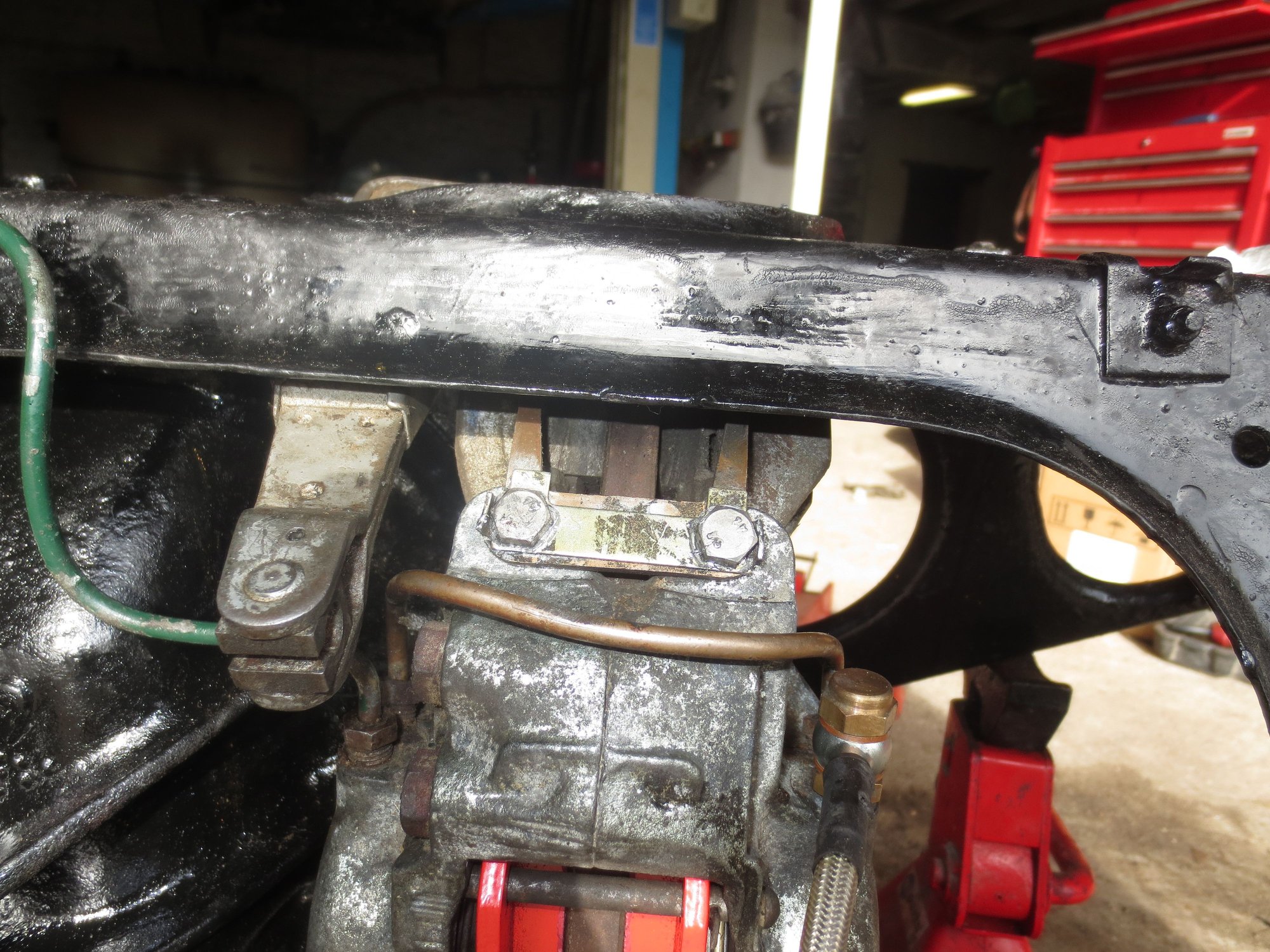

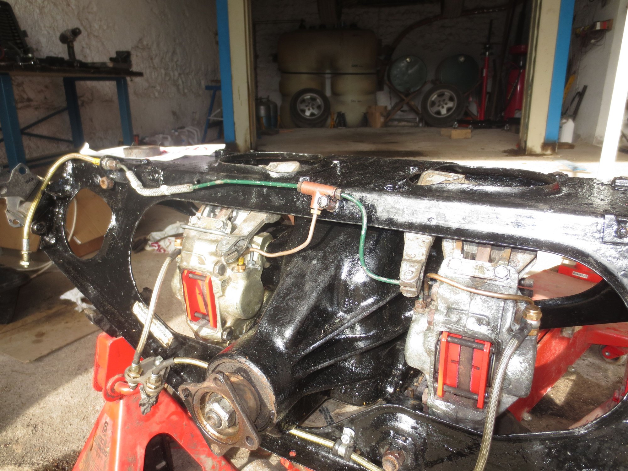

Inboard braked cars have solid line going from a three way connector above the diff, bolted to the cage:
  • One input hard line from the M/C
  • one hard line going to each caliper.
The fittings (from memory) are Imperial and require a 7/16ths spanner. Any one could be leaking, as could the connectors to the actual calipers, and the bridhe pipe that connects the two pistons. I think you can JUST get to these fittings without dropping the cage. An open brake pipe spanner may help as will a short open ended spanner.
It can also happen, if the diff becomes slightly loose on its cage mountings, and that tiny bit of play causes leaks in the fittings or the hard lines, In which case the lines have to be changed and the diff fixing bolts tightended. This is a bit unlikely in your case.
Therefore I suggest you tighten the connectors, which (I think) you can do if you raise the car, without having to drop the cage. Then as long as the car is SAFELY SUPPORTED, ask a helper to start the car and press the brake hard, and see if the assembly leaks anywhere.
I have Fosseway performance remote bleeders on my car as you can see in the last pic. Great idea for any inboard braked car.
