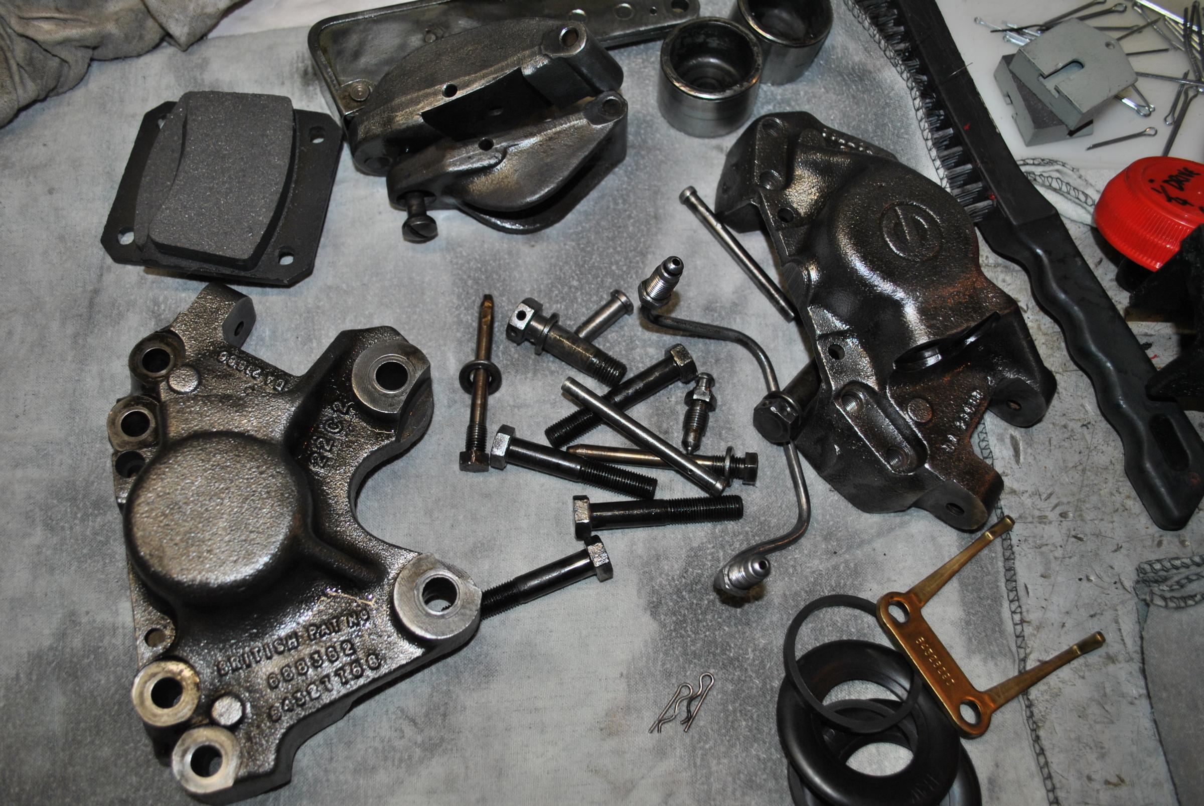

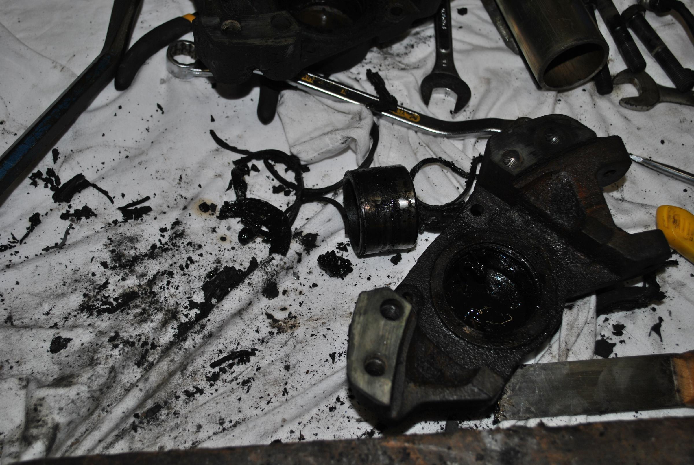

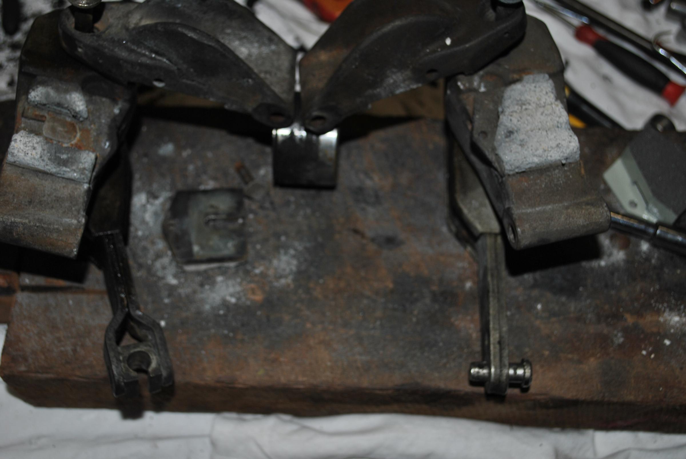

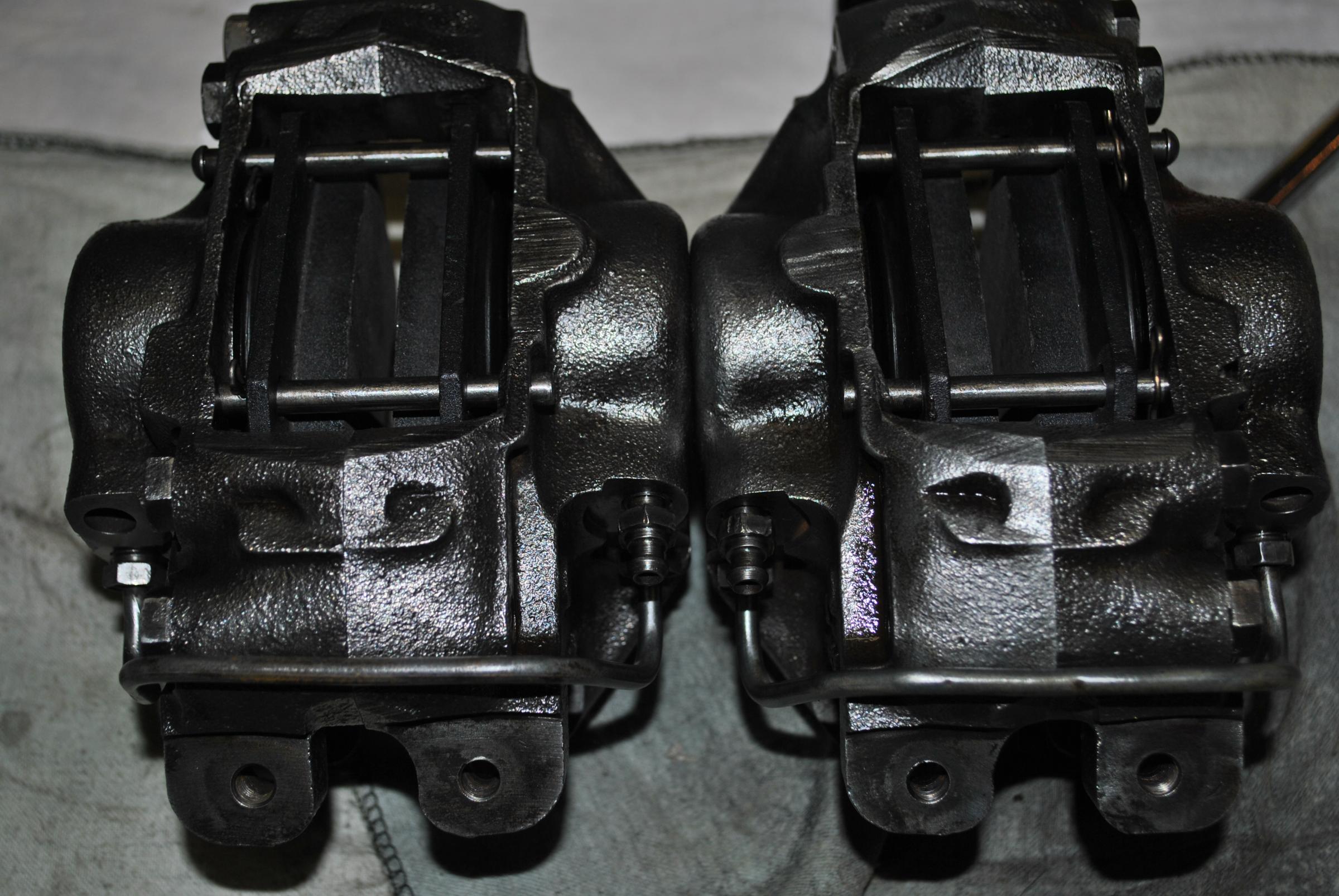

I spent not a great deal over $600 to do diff, calipers and handbrake calipers and cable.
brake overhaul - wired bolts-dsc_9242.jpgbrake overhaul - wired bolts-dsc_9243.jpgbrake overhaul - wired bolts-dsc_9250.jpgbrake overhaul - wired bolts-dsc_9254.jpg

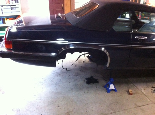

lower bolt RHS the head of the bolt hit the diff housing before it cleared the mounting flange for the caliper...
So all I had to do was pull the rotor off to loosen the flange bolts to give me clearance to remove the bolt so I could take off the caliper so that I could remove the rotor...
Attached Thumbnails brake overhaul - wired bolts-irs-out.jpg   brake overhaul - wired bolts-jammed-caliper-bolt.jpg   brake overhaul - wired bolts-wired-bolts-2.jpg   brake overhaul - wired bolts-final-drive-unit.jpg
