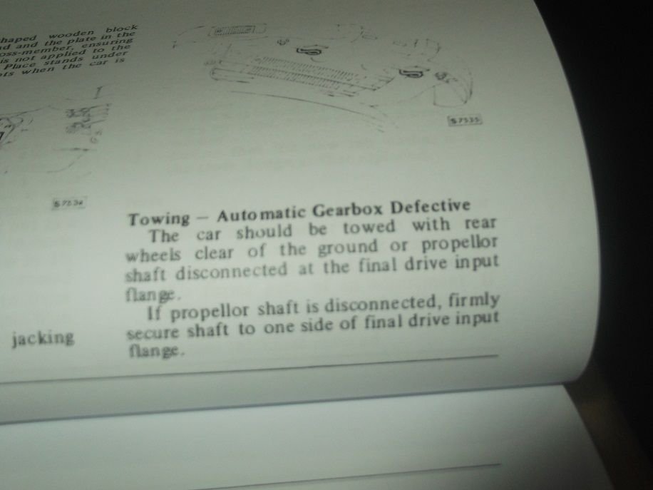

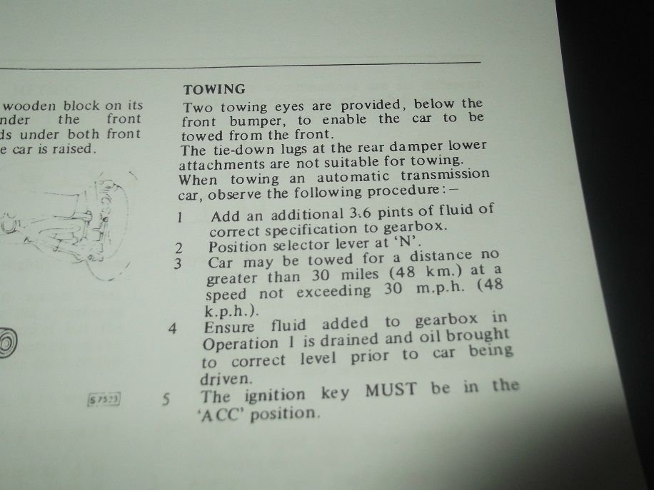

Realize this post is a bit old - but got home from work yesterday - bit late in the afternoon and a bit cold to work on her at night - so I read my book instead.
In my Repair operation Manual - Page 34, says the car can be towed with precautions taken.
If the gearbox is suspect - then the back wheels need to be off the ground or tail shaft removed.
Goes against what I have always believed in a automatic car, but it is in the book
JimC64
