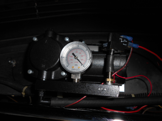

i just finished a front brake upgrade, new hi-quality gold rotors, slotted and dimpled, rebild the Wilwood calipers. flush system, and added an electric vacuum pump, SS lines.
excuse the corvair engine shot, computor burped.
Attached Thumbnails Brembo Brakes on a XJS-ebc-gold-sports-rorors-slotted-dimpled-002.jpg   Brembo Brakes on a XJS-corvair-jag-brakes-004.jpg   Brembo Brakes on a XJS-jag-vac-pump-001.jpg   Brembo Brakes on a XJS-corvair-jag-brakes-003.jpg
