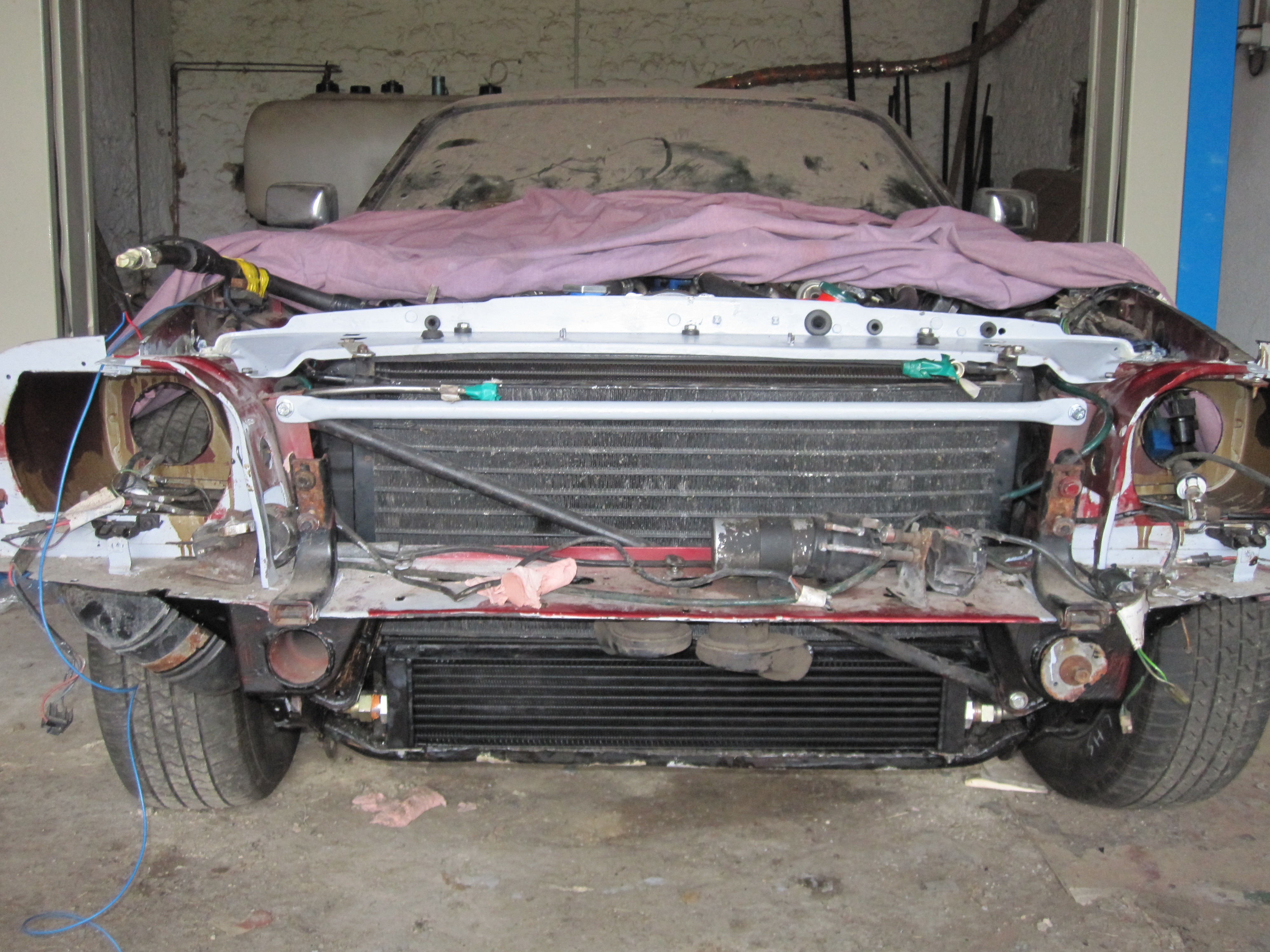

The absorbers are mounted in a tube in the chassis about 6 inches long. Like Baxtor my car does not have the absorbers, but the tube can be clearly seen in the attached photo LHS of shot. Access to the back of the tube is needed, and this will need the undertray to be removed, at least.
It might be easier to cut the fixings off that attach the absorber to the bumper bracket, if you can get to them. good luck
