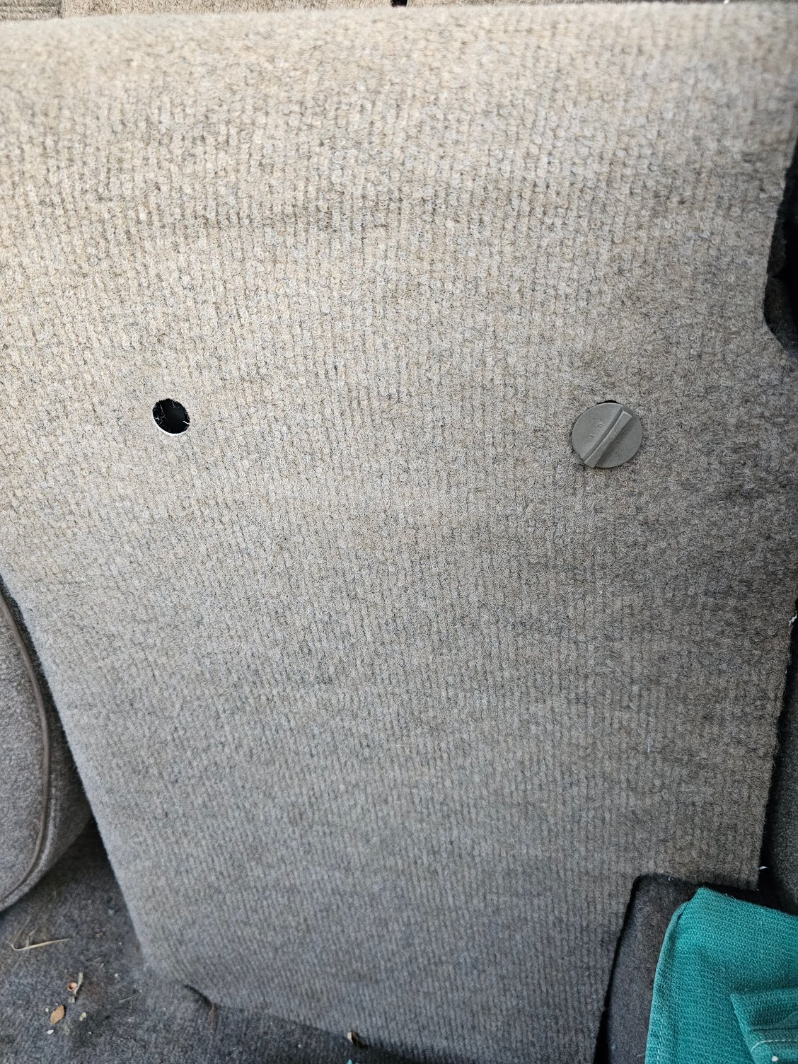

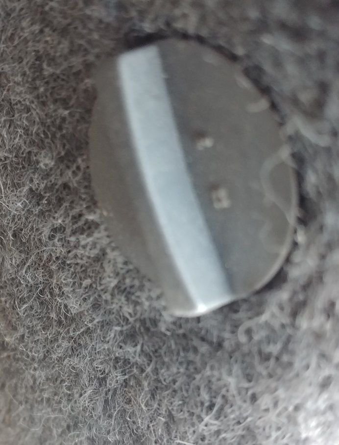

Can someone identify this fastener? Battery cover in trunk

That 1/4 turn turnbuckle stud hasn't been available new for many years. Time to start looking on eBay etc.

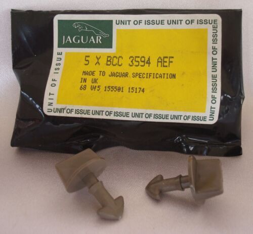

BCC3594 in Black is NLA from Jaguar
BCC3594AEF is the same part in Rattan and that is still available.

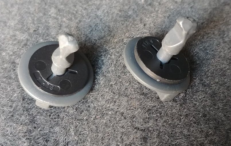

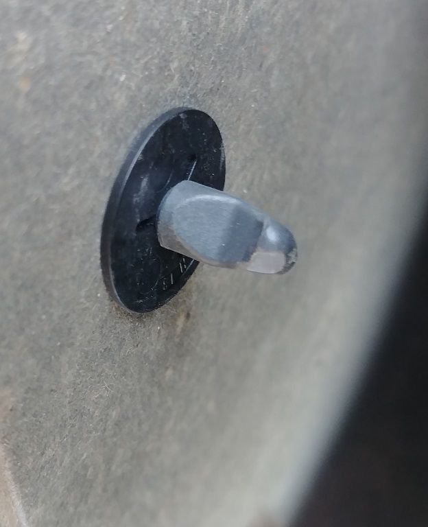

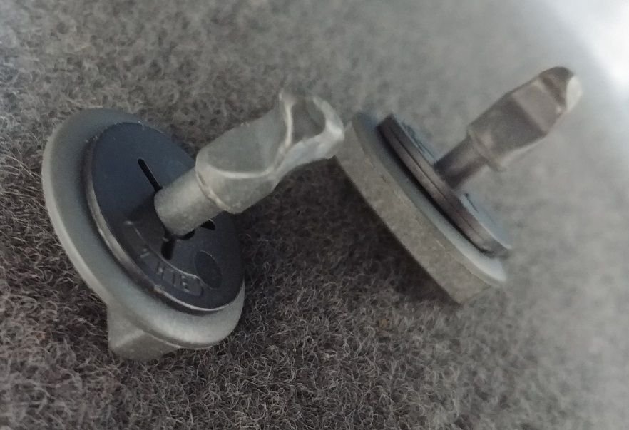

These are for the battery cover and the rear light cover of an XJS Celebration.

Turnbuckle stud: BEC18106LFH

Turnbuckle stud: BCC3594AEF
