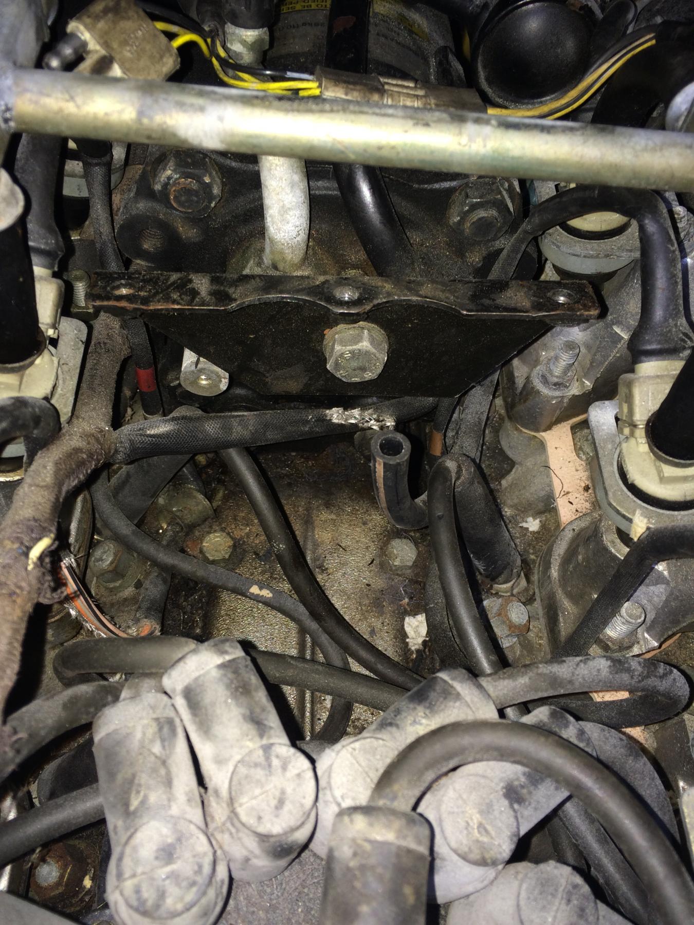

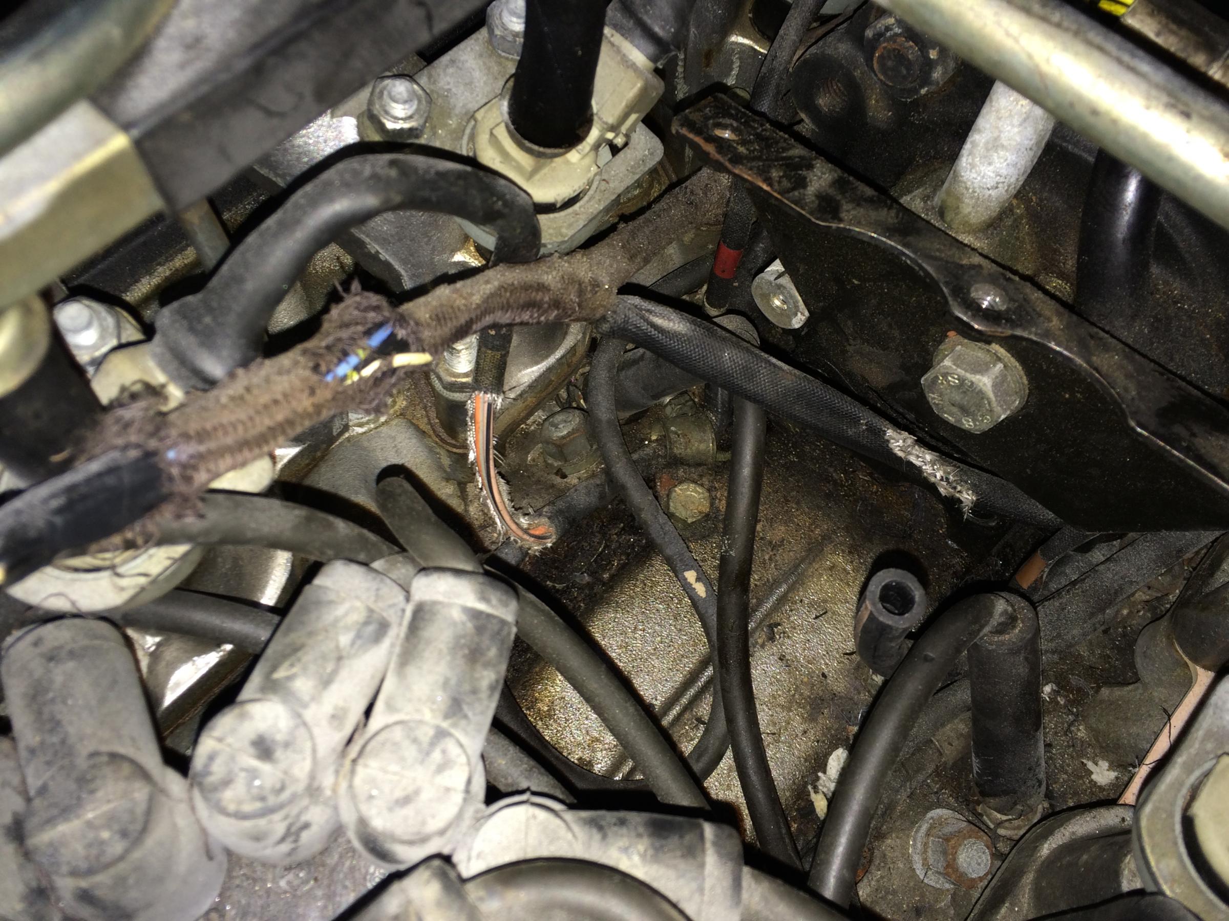

So- I have the cruise control bellows moved, the a/c compressor moved. Researching how to move the throttle pedestal.
I have a side trip question though- I found a nice snug rodent nest under the cruise control bellows and it looks like they used some of the wire coating for part of their snug little nest. I don't see any wire actually exposed but the individual wires are in some places.
Is there a way to use something to repair the existing protecting covers for the individual wires or do they likely need to actually be replaced?
Pictures included (I think).
Attached Thumbnails Car revival question-img_0280.jpg   Car revival question-img_0281.jpg   Car revival question-img_0282.jpg   Car revival question-img_0283.jpg

The insulation on the wires can be repaired, bit of a bodge, but OK. From the pics it looks like the outer covers only have been eaten! Carefully look at the pvc insulation covering the actual copper strands. If any of this is eaten away, wrap it with PVC insulating tape wound round the copper/chewed bits.

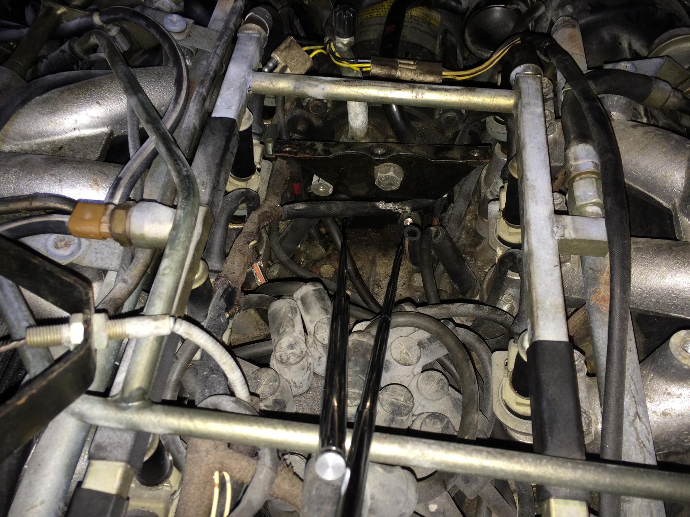

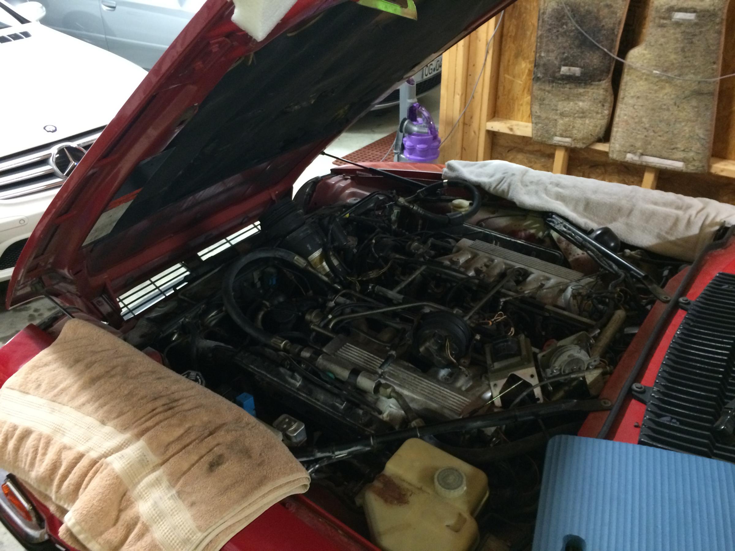

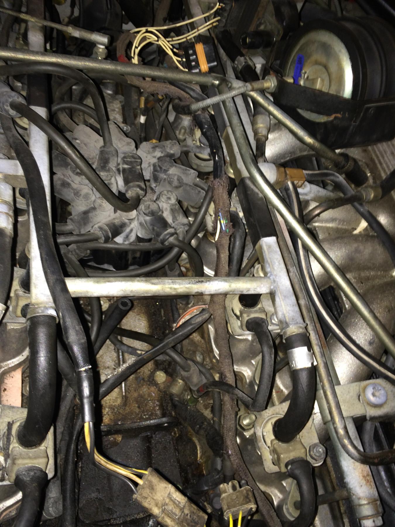

I took apart a great many things but I think I now have access to the "vee".
Do these images look right for beginning to try to blow out crap from around the plugs, change the plugs, change the HT wires, repair the rodent damage, and do a compression test?
Attached Thumbnails Car revival question-img_0308.jpg   Car revival question-img_0309.jpg   Car revival question-img_0310.jpg

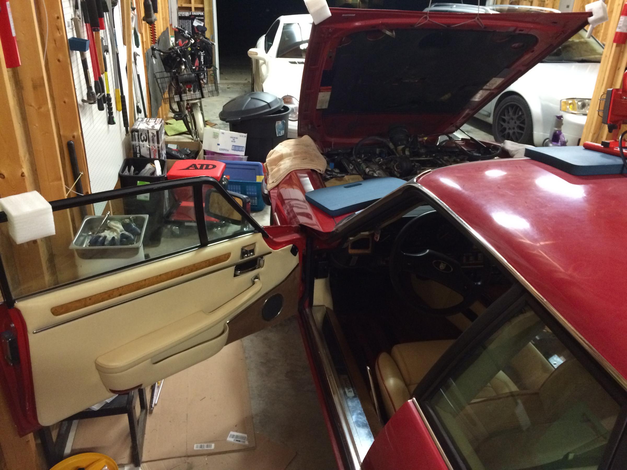

by the way this is the "workspace" if anyone has suggestions or comments-
Attached Thumbnails Car revival question-img_0311.jpg   Car revival question-img_0312.jpg   Car revival question-img_0313.jpg   Car revival question-img_0314.jpg

Well, its for sure you have Marelli ignition. I will stand by my recommendation of a compression test, before you spend another penny. To me, its sort of a starting point with knowing the condition of the engine. I again will say, the car was parked for a reason. If that reason was a dropped valve seat, even the expense of a set of plugs is a waste, unless you plan on doing a major teardown, rebuild of the heads. With that said, if the engine has decent compression, next thing for me, is to check for fire. On my non-running Marelli car, I put the coil leads, (the distributor ends), next to metal, and turned then engine over. I had fire on one side (A), continuosly. B side would drop out after 3-6 seconds. On my car, it turned out to be the rear crank sensor. The Marelli ignition isn't near as intimidating as it was when I purchased the car.
I just know it takes 3 things for a gasoline engine to run (if its in decent mechanical condition). Fire, fuel, and air. To me, in that order. Establish mechanical condition, then make sure you have fire, then fuel, and presumptively, you don't have a blockage on the intake side, and the car "should" run. My offer is open to talk.

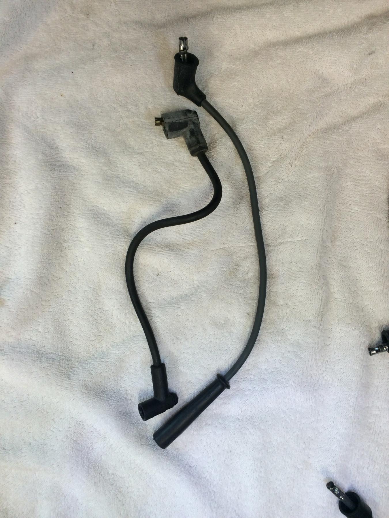

As I begin to change the spark plug wires (plugs and compression tester are not here yet) I notice that my new Bosch plugs are not all the same angle as the ones in the car- namely it appears to be the front most and back most plugs (1 and 6 both sides I think) have a right angle where the plug wire attaches to the plug.
My new Bosch ones are all straight at the wire/ plug attachment.
Is this a problem (especially under the a/c compressor) and I need to buy different wires or will this be ok space wise?
In the picture the old wire is on the left and the new one is on the right for reference.
And- the new set does not include the two wires that attach to the center top of the distributor- they are both very short. Also pictured. Do these not need to be replaced?
Attached Thumbnails Car revival question-img_0340.jpg   Car revival question-img_0341.jpg   Car revival question-img_0342.jpg

I feel you do need the angled boots on at least the front plugs because of the A/C compressor. I can't say the straight ones won't work, yet "may" begin to short to ground pretty quickly as the heat begins its work on the new boot/wires being right up against the compressor.
Not much need to worry with those wires until compression test is done. The neat thing about the Marelli cap, is that it is clearly marked as to which wire goes where. I feel completely comfortable pulling all of the plug wires with my Marelli car. I promise the apprehension goes away, the more you work on your car. I'm really hoping that the compression test goes well for you. As Kirby said, one cylinder much lower on compression certainly means more teardown. If this engine has a mechanical failure in a valve seat, valve, those plug wires will become a very very low priority.
