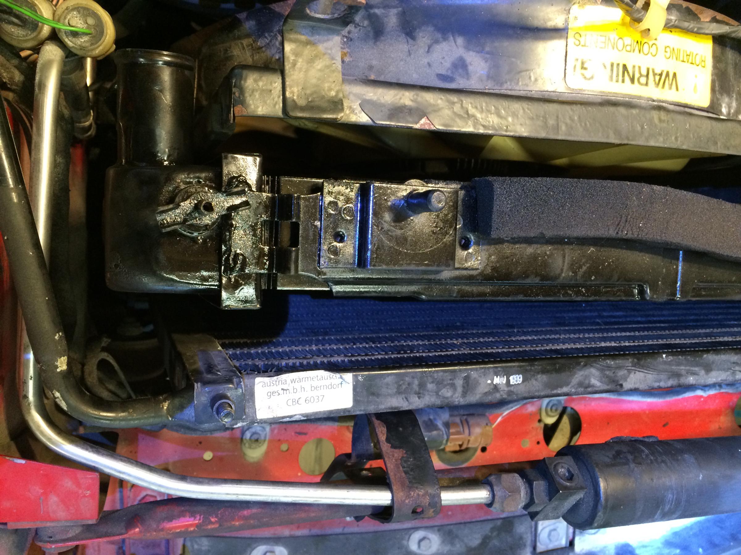

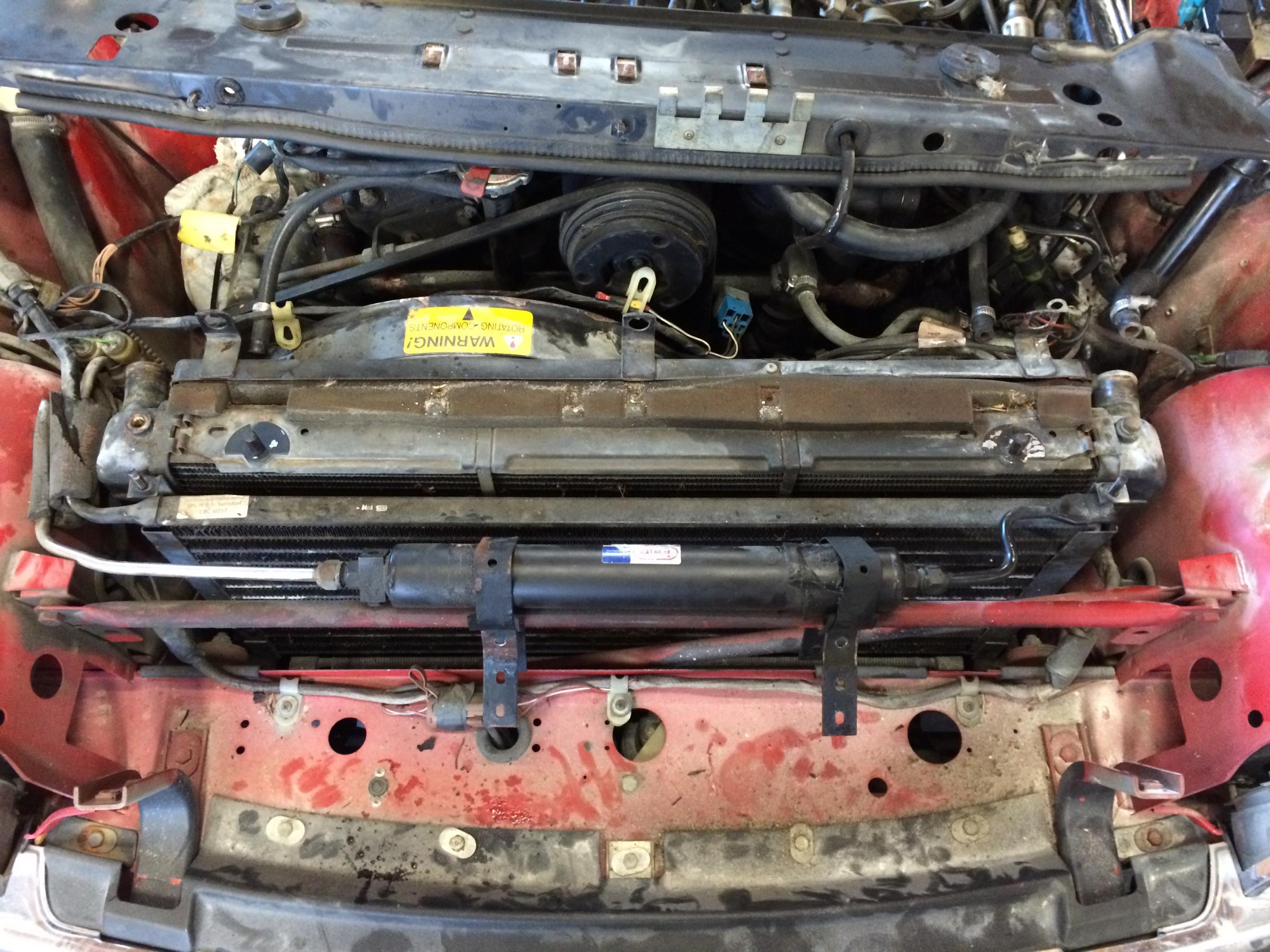

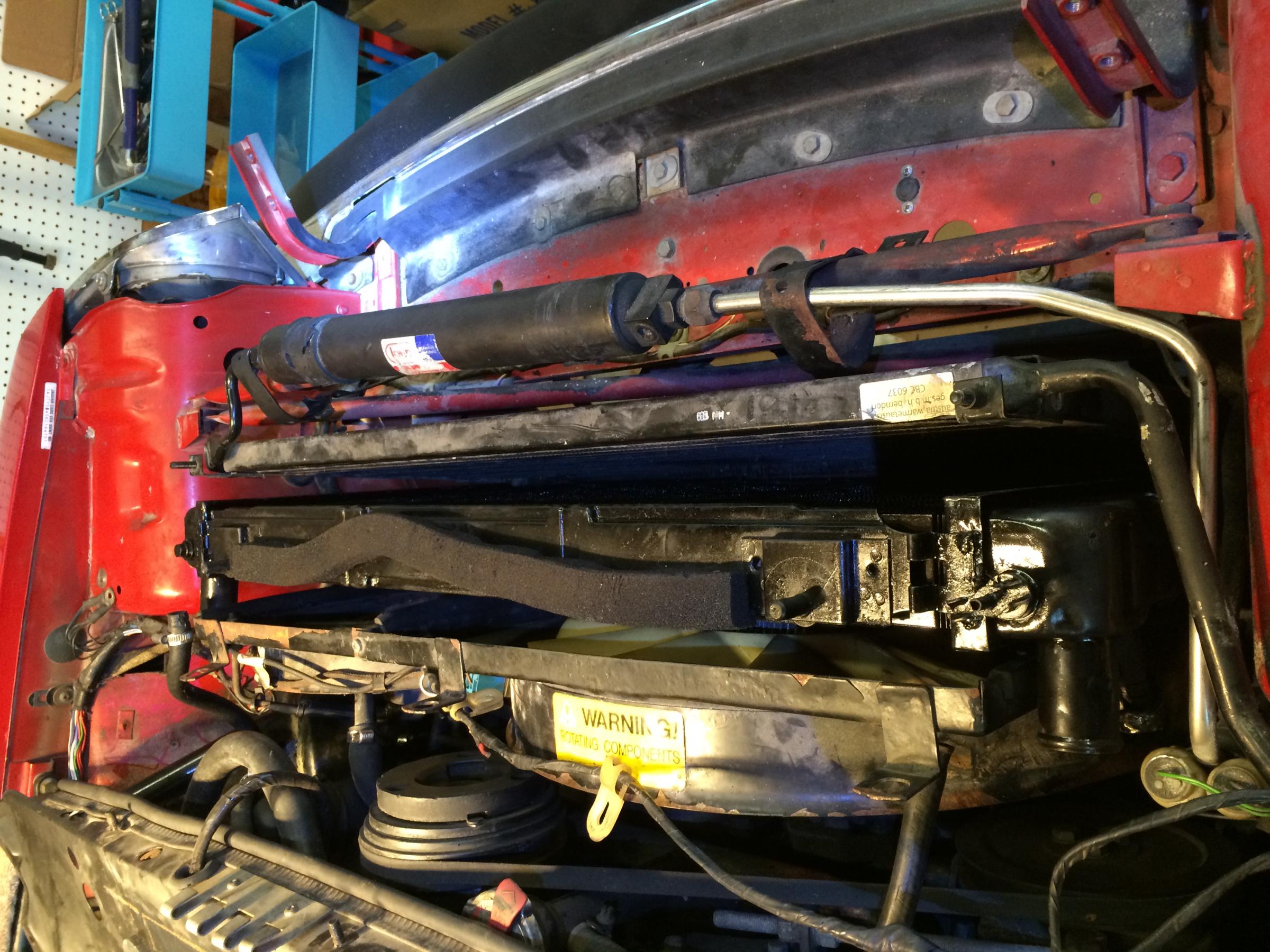

It might help to bring pictures for the radiator guys.
I just tried to reinstall it only to discover the mounting tabs on top were put back on the wrong side of the radiator! Pics attached.
And- now I am not sure how the bottom ones are supposed to look since I don't think I ever took pics of the bottom of the radiator before I brought it in to the shop! Anyone have pics of the bottom of the radiator?
edit- now that I look closer I think the bottom supports are actually on the top of my radiator now!
So now I need to figure out if the supports are set forward toward the front of the car when the radiator is in or set towards the back of the car when the radiator is in. And if the top and bottom supports are set the same direction.

The photos look like they may have the tanks reversed as well the air bleed is on the left or if you will driver side US on both of my XJ-S's.

I think I may be lucky I have a before pic since I try to photograph all the major steps so I have come chance of getting everything back together-
I think the air bleed is ok- he just put something in it so nothing would enter I think.
these pics are before recore and after recore
Attached Thumbnails Car revival question-img_0675.jpg   Car revival question-incorrect-brackets-1.jpg
