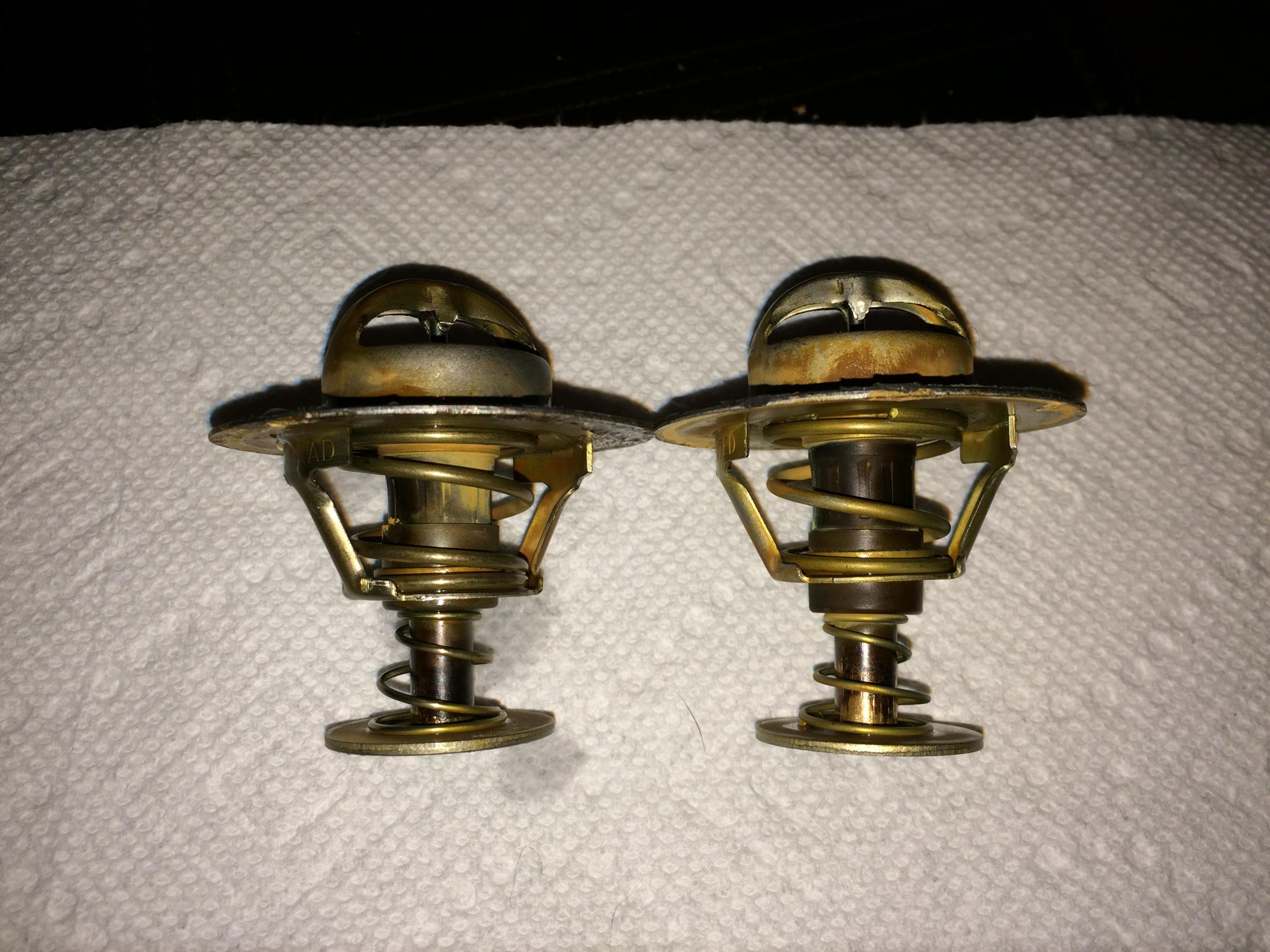

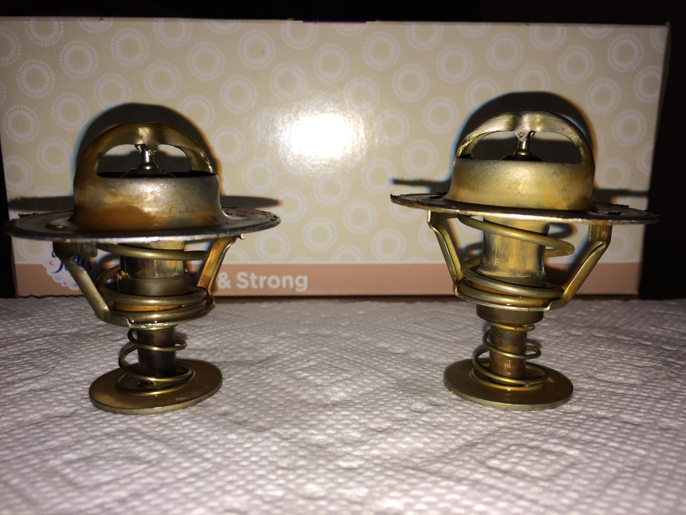

thought I would build some confidence by checking the thermostats first before I pull the radiator. They both opened in hot water. One is slightly taller than the other although they look to be the same manufacturer. Does anyone think this is a problem?

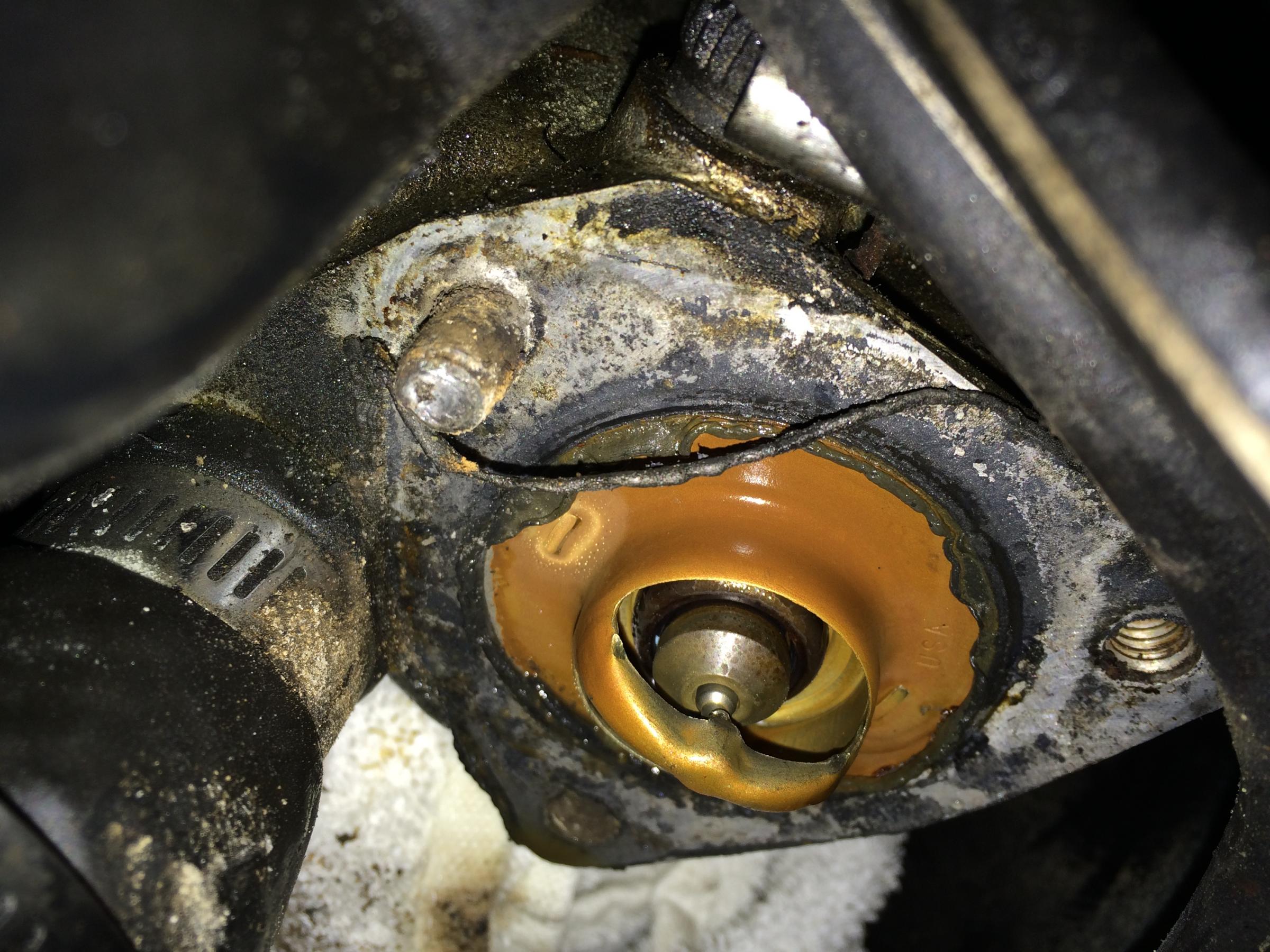

one of the bolts that holds the thermostat housing in place broke off as I tried to unscrew it. It's the drivers side housing. Anyone have any thoughts as to how to try to get it out?

Hi,
You can always use a tap and die set to get the bolt off. If I am seeing the picture clearly I think that there is enough of the bolt there where *maybe* you can get a good grip of it with something (vice grips?) to ease it out. However you proceed I would apply heat near that bolt.
Good luck!

Well, from the looks of it, you at least wound up with some to grab hold of with vice grips. I would liberally soak it with some penetrating fluid. After that, if it didn't want to turn out fairly easily, I might try drilling the center of it, spray more penetrating fluid the hole, IF you can drill completely through the stud. After that, I might apply some heat around it.

when you guys say apply heat how does one do that safely in the engine bay? I have a heat gun that I could try to put right on the bolt but I worry about heating something else that should not or does not want to be heated.

I would try an outside easyout. I think mine are Craftsmen.
They grip the outside of the bolt instead of drilling it out.

I have used a heat gun, as well as a mapp gas torch. The trick is, to heat the aluminum, but not the bolt as much. I've used lots of wet rags wrapped around things, whatever it takes. I use a product called PB Blaster, but have seen several different brands of penetrating fluid mentioned on here.

I would remove the housing completely from the car and drill out broken bolt correctly. The bolt sheared off so very unlikely to shift with vice grips etc. Not much more time involved in removal, two more gaskets and there will be a lot less drama in the long run doing it on the bench.

I just reread your thermostat post and checked pics, I notice your thermostats do not have jiggle pins, they should have these and they should be oriented to the top when fitted.

I read about those but I don't really know what they are. I will get a pair from one of the Jaguar sites.
