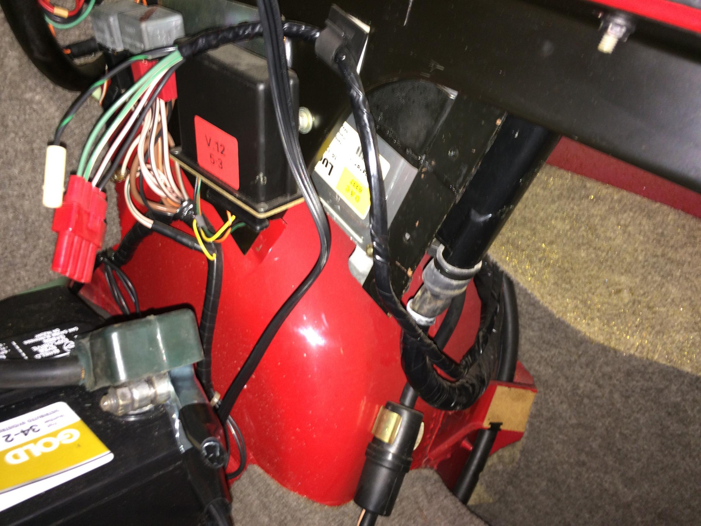

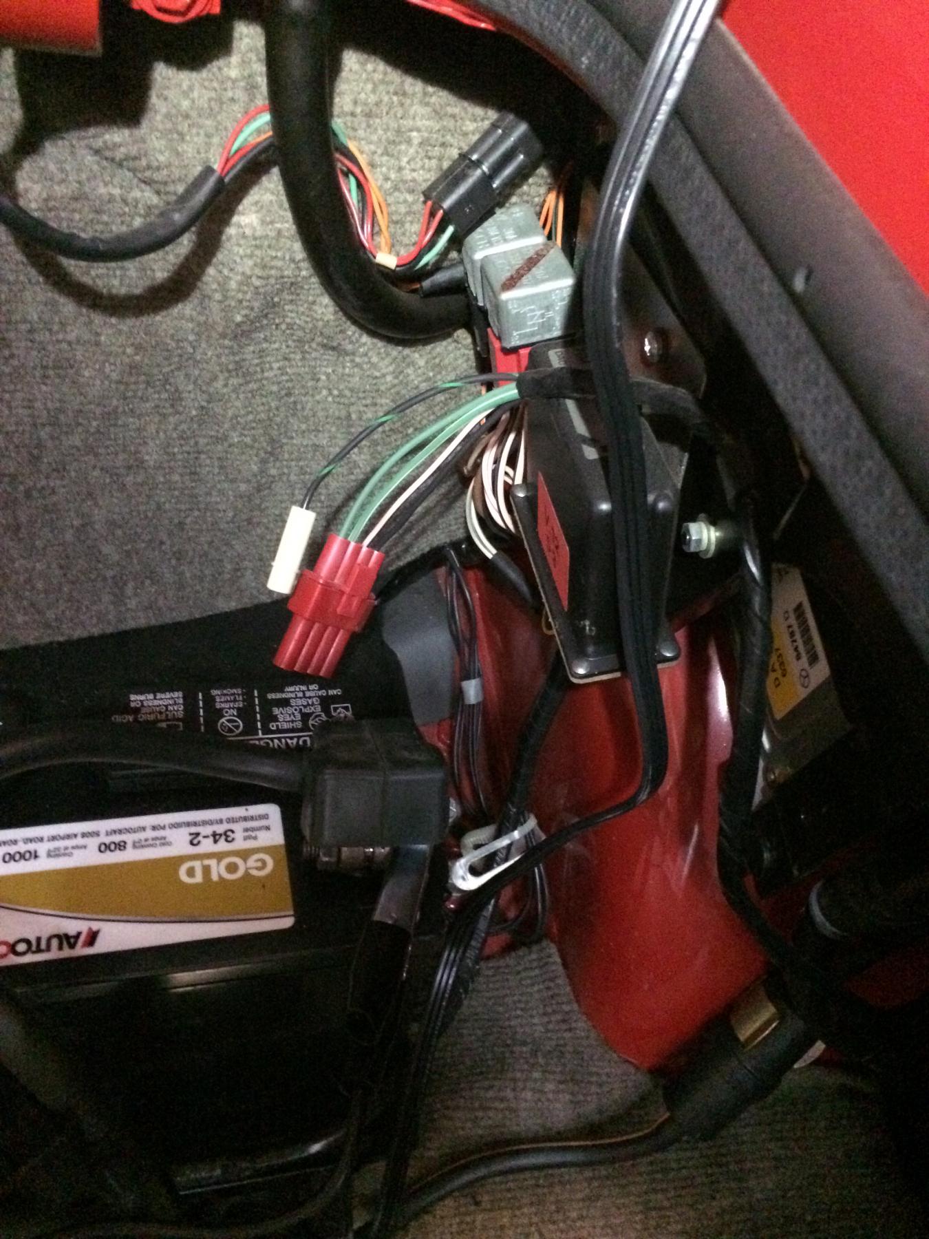

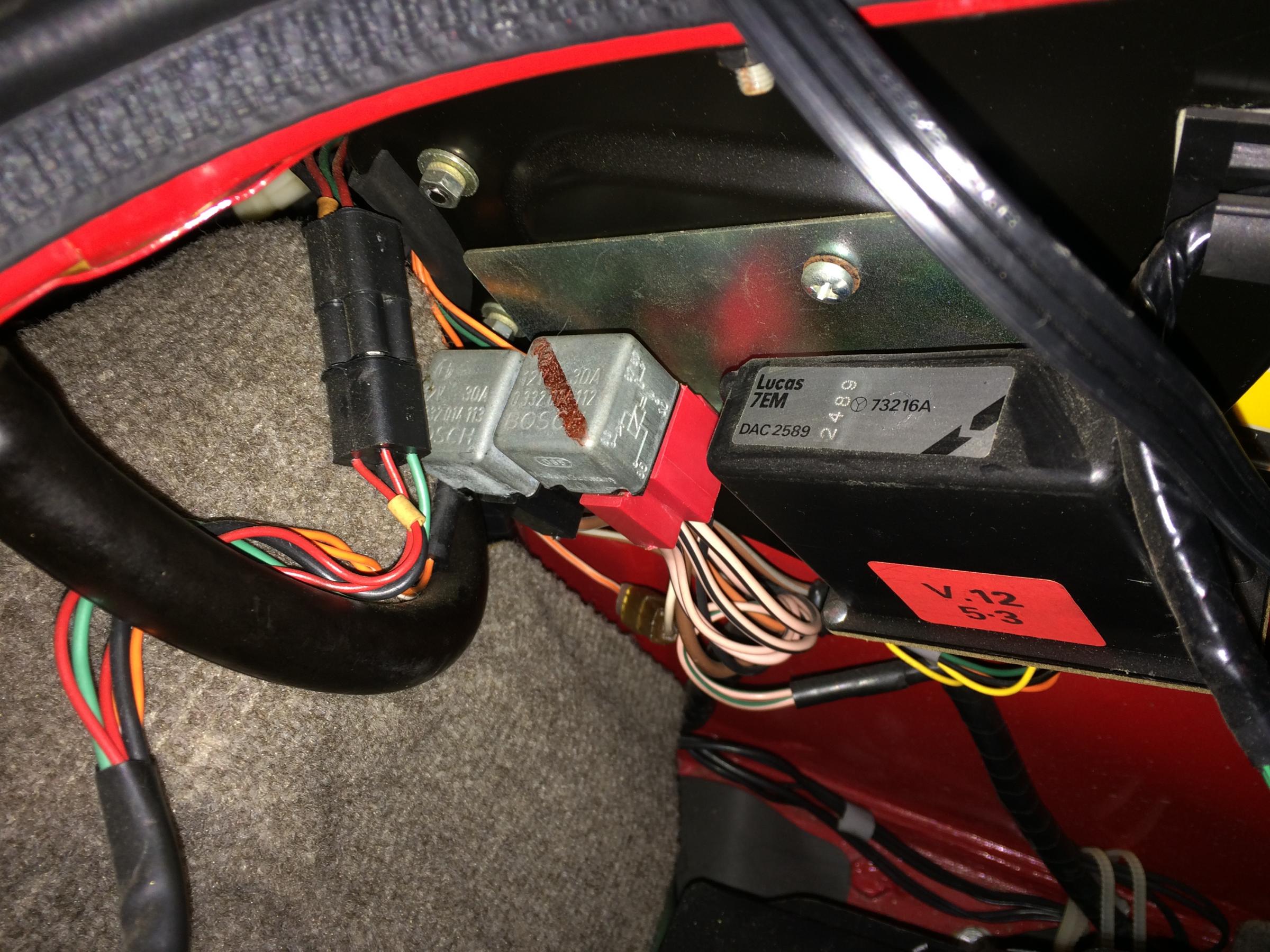

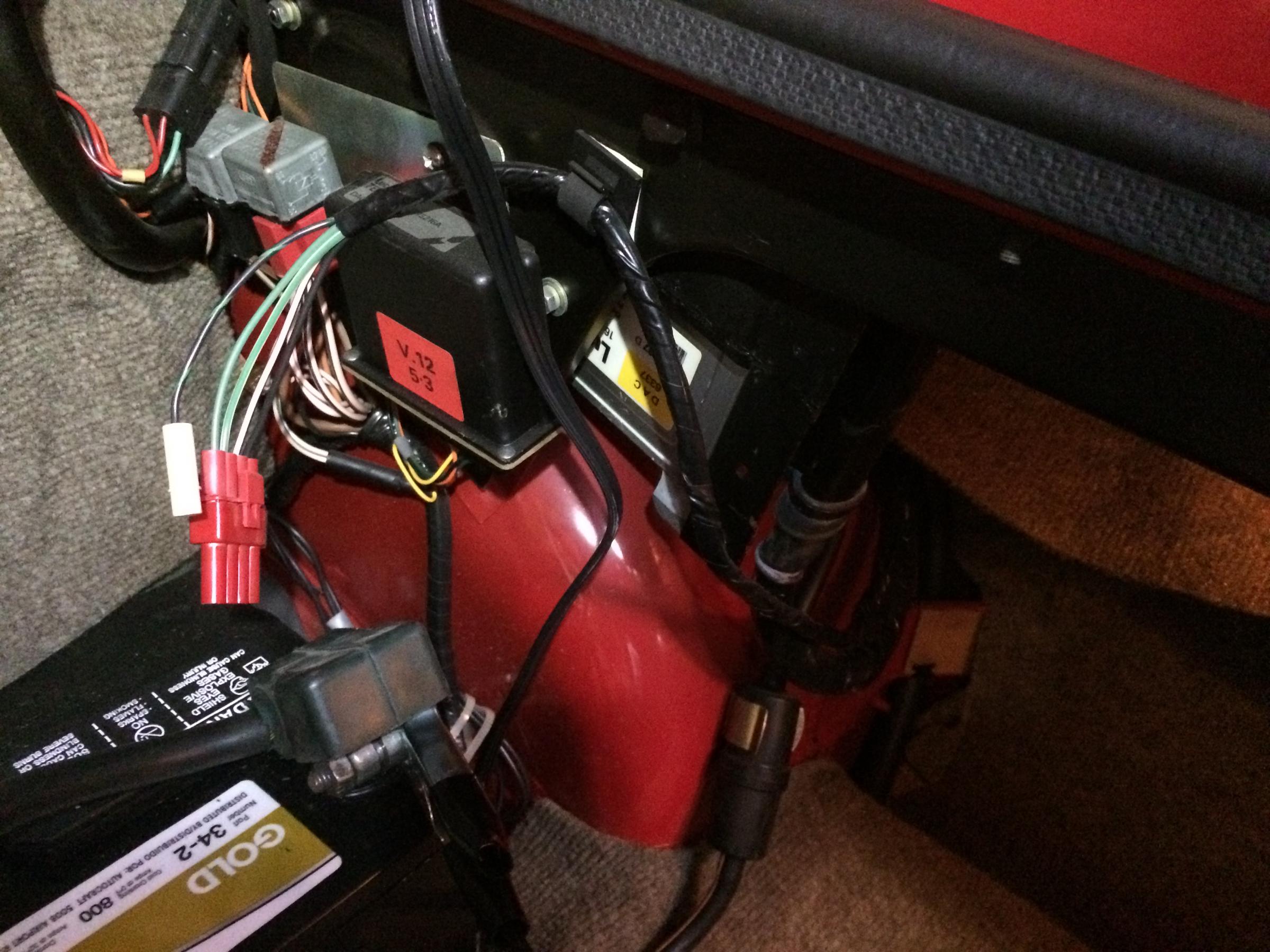

As I began to try to figure out how to depressurize the fuel system I found these in the right side of the trunk not attached to anything. Anybody recognize them and should they be attached to something?
Attached Thumbnails Car revival question-img_0464.jpg   Car revival question-img_0465.jpg   Car revival question-img_0466.jpg   Car revival question-img_0467.jpg

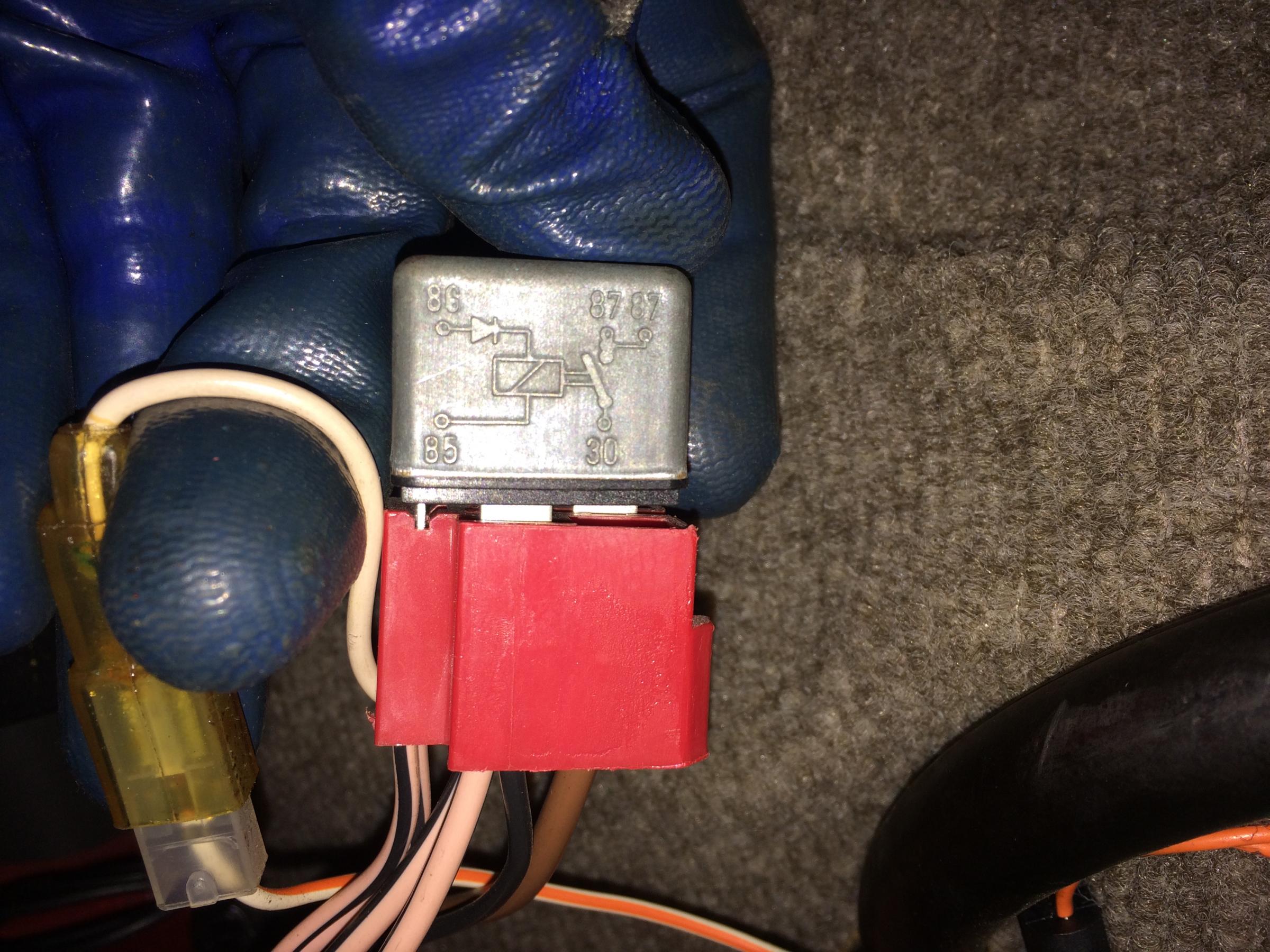

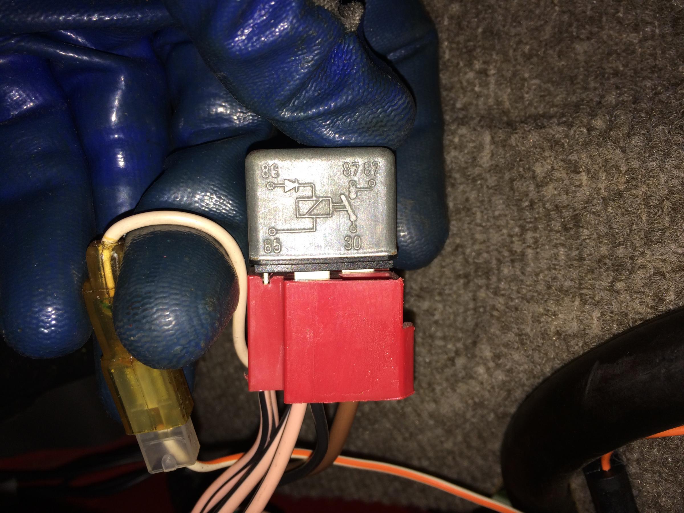

To depressurize the fuel system do you just pull the silver box off the red box? Or can you just undo the connector that comes from it?
I wimped out and tripped the motion/ inertia sensor switch in the driver side door area and ran the pump a couple of times and had no fuel pressure when I began to start the rail removal.
But I would like to know how to do it properly.
Attached Thumbnails Car revival question-img_0468.jpg   Car revival question-img_0469.jpg   Car revival question-img_0477.jpg   Car revival question-img_0478.jpg
