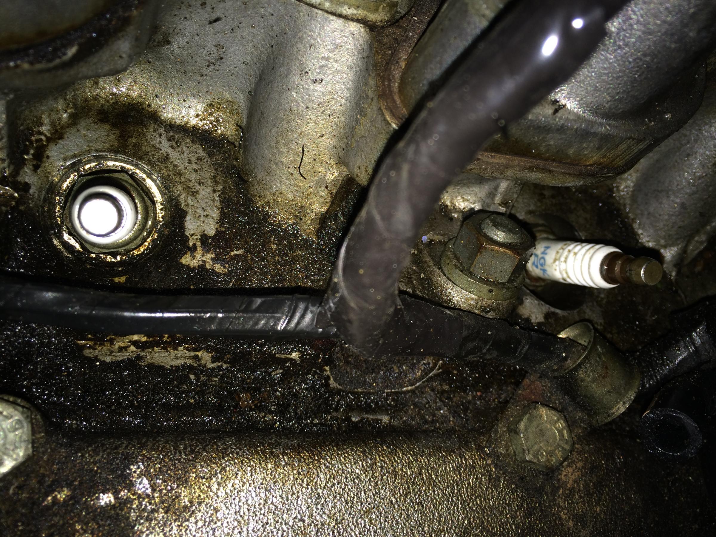

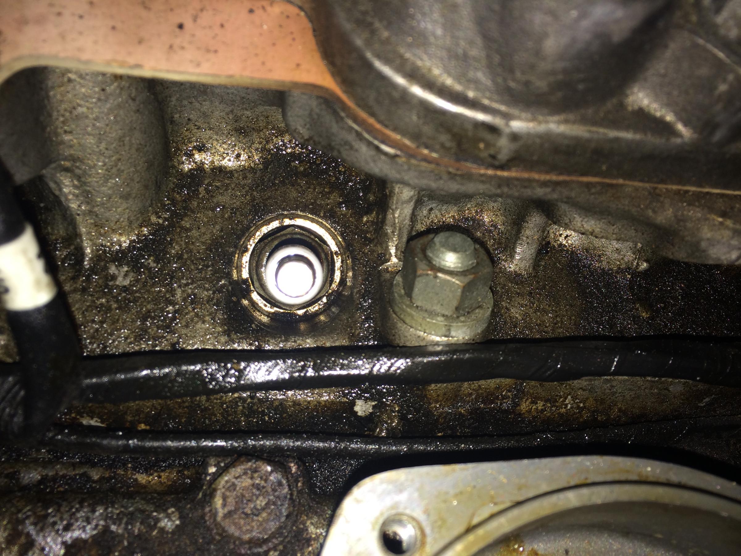

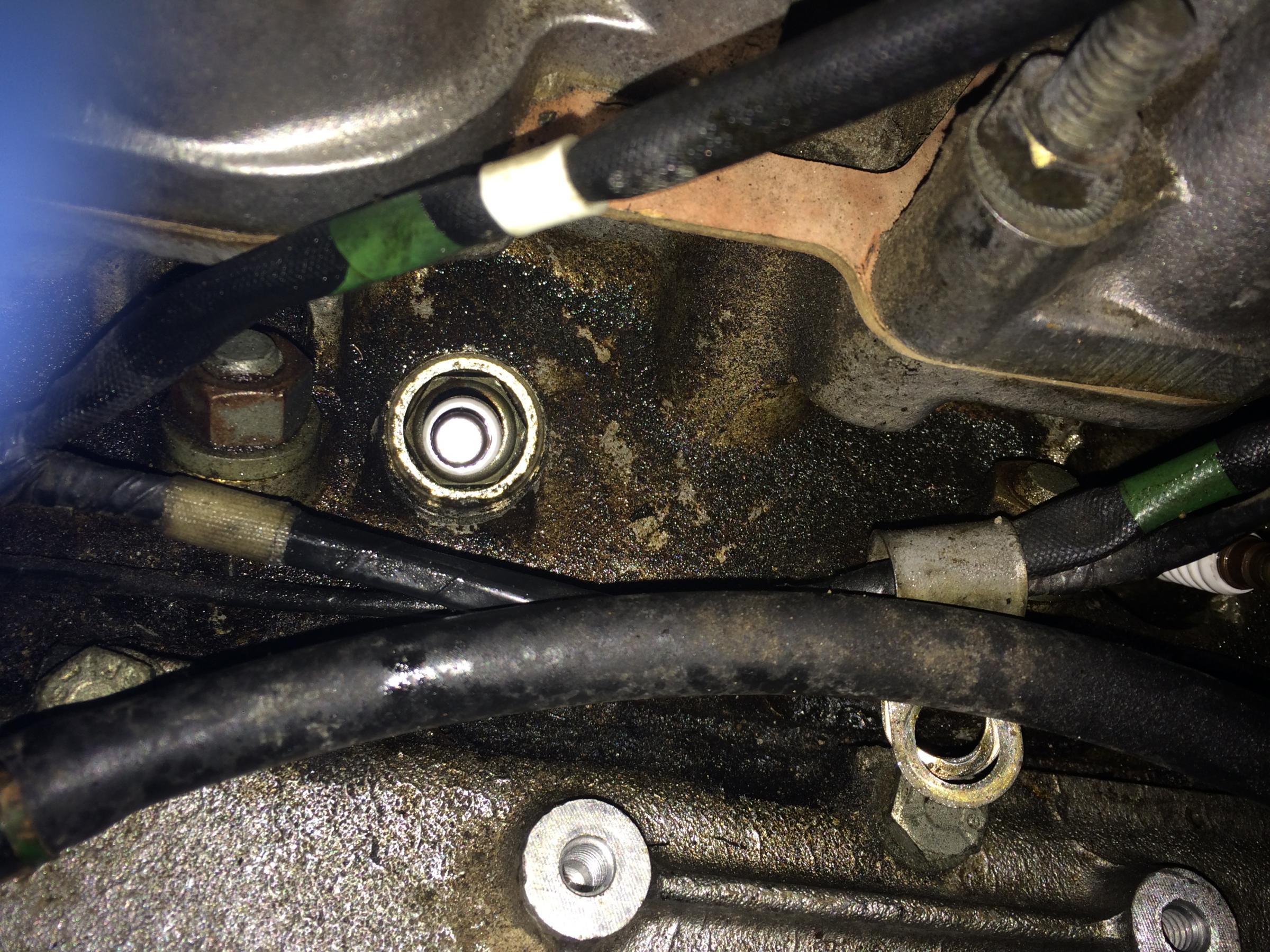

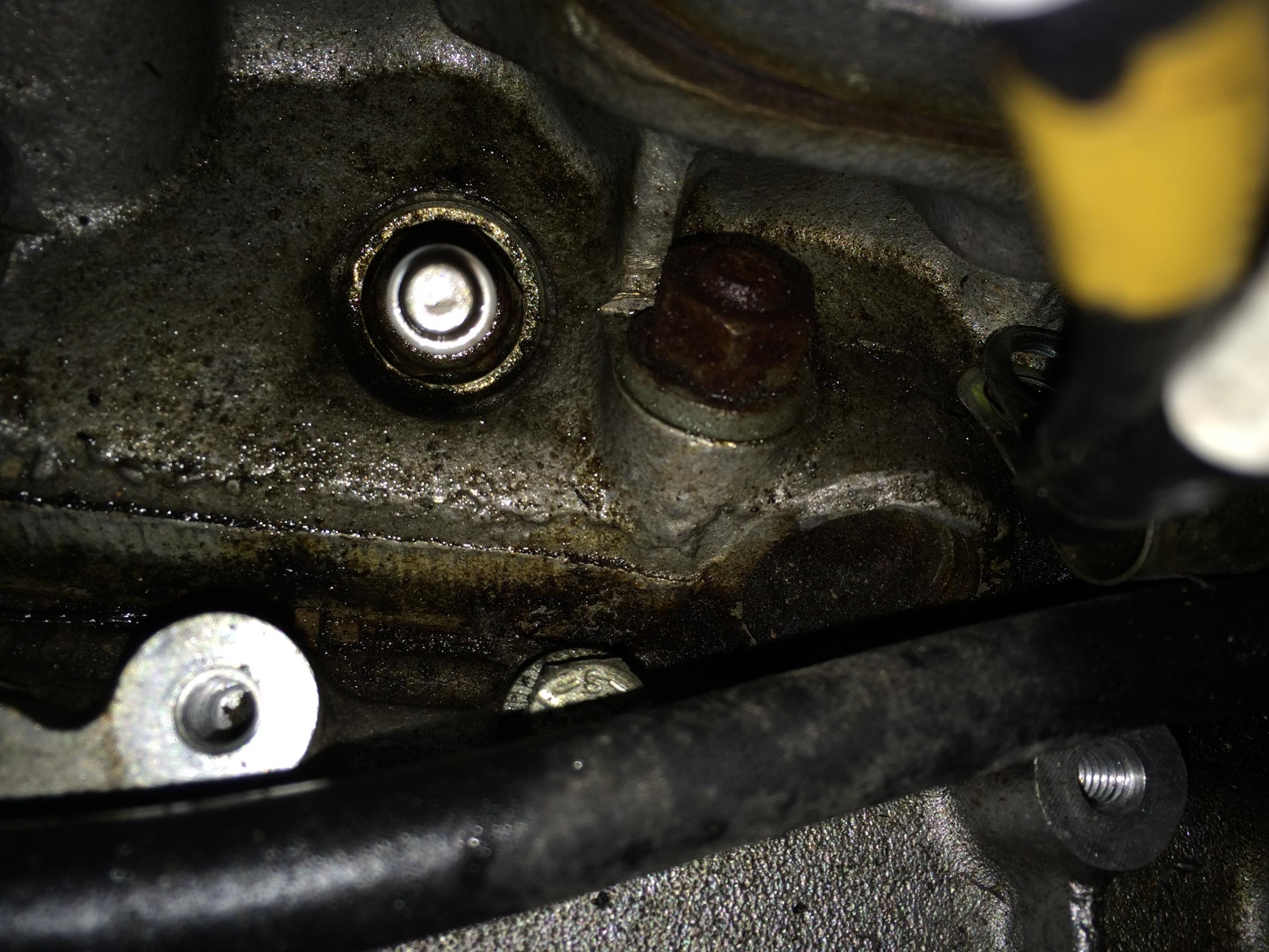

on another front I have vacuumed and sprayed out the recessions surrounding the spark plugs.
Does this look clean enough to remove the plugs, test compression, and install the new plugs (once I get the last one out)?
Attached Thumbnails Car revival question-img_0419.jpg   Car revival question-img_0420.jpg   Car revival question-img_0421.jpg   Car revival question-img_0422.jpg
Old Dec 1, 2014 | 08:53 PM
  #52
superchargedtr6's Avatar
Joined: Dec 2013
Posts: 1,078
Likes: 398
From: Greer SC
I don't worry so much about "clean" as I do loose debris. If you have a compressed air supply, its usually very safe to just blow away all dirt, debris with plugs in, before removing them. Whatever you do, get that plug out! No telling how long it has been in there. Plugs gaps increase over time, use. As you may realize, this seems to be a primary cause of the Marelli meltdown.
I may sound like a broken record, but I have had the misfortune of having two V12s drop a valve seat, totally unrelated to my ownership. Neither car did I know the ultimate history of, so no idea of its overall condition, other than how it looked. A compression test will let you know a lot about the condition of the engine. The compression testor, only has to be hand tightened to work. Has a o-ring on it to seal against the head. One lister was correct. These plugs are tapered. They barely need tightening. But I always put anti-seize on them, going back, just to make next time easy. Change the plugs every 10K or so, and I doubt you'll ever have the Marelli meltdown. All that seems to happen, is the plugs are neglected, and the path of travel of fire to ground (resistance) becomes so great, that going through the rotor becomes the path of least resistance. Once a bank of plugs quit getting fire, and the Lucas keeps sending fuel, well, you get the fire.

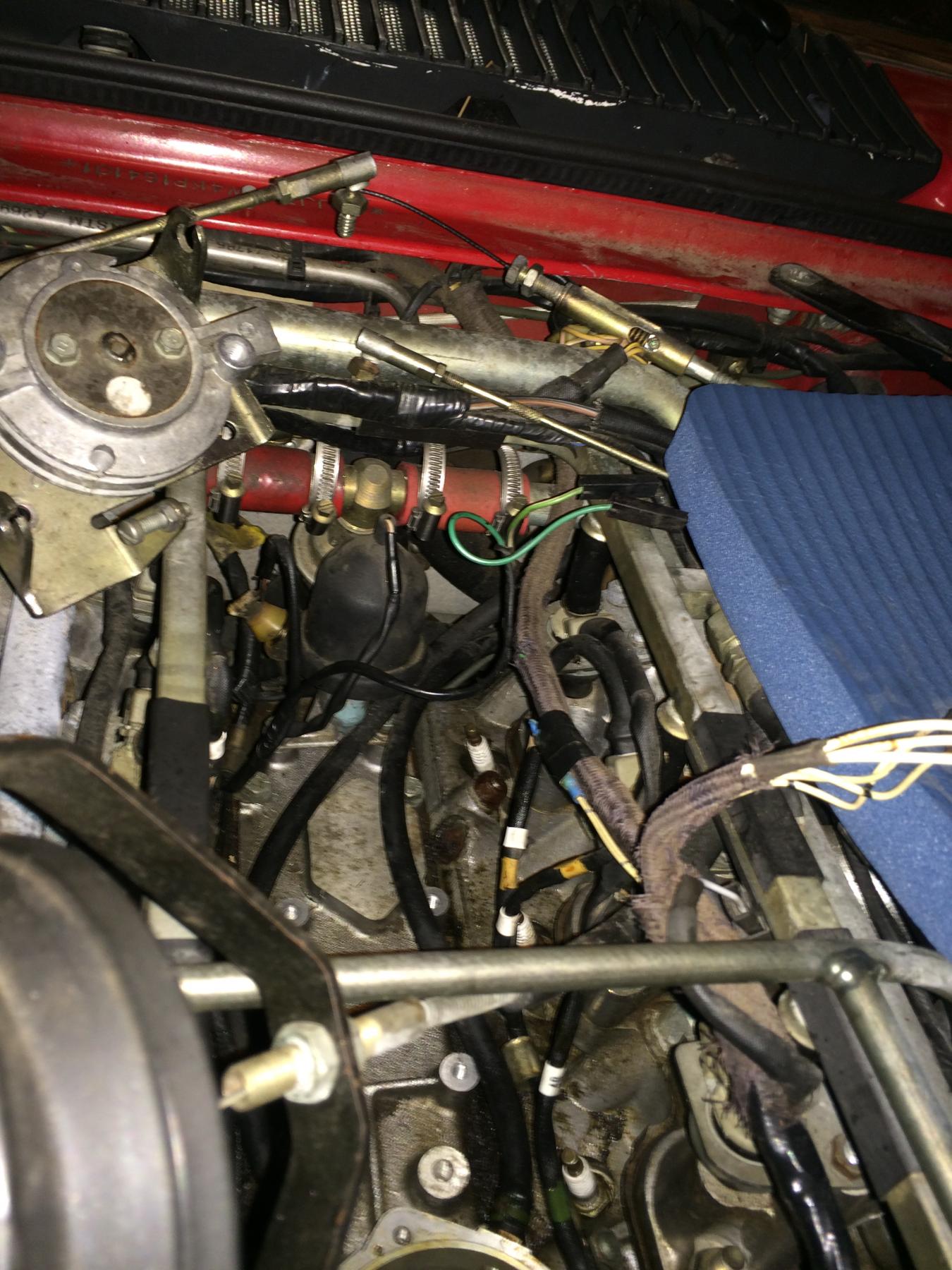

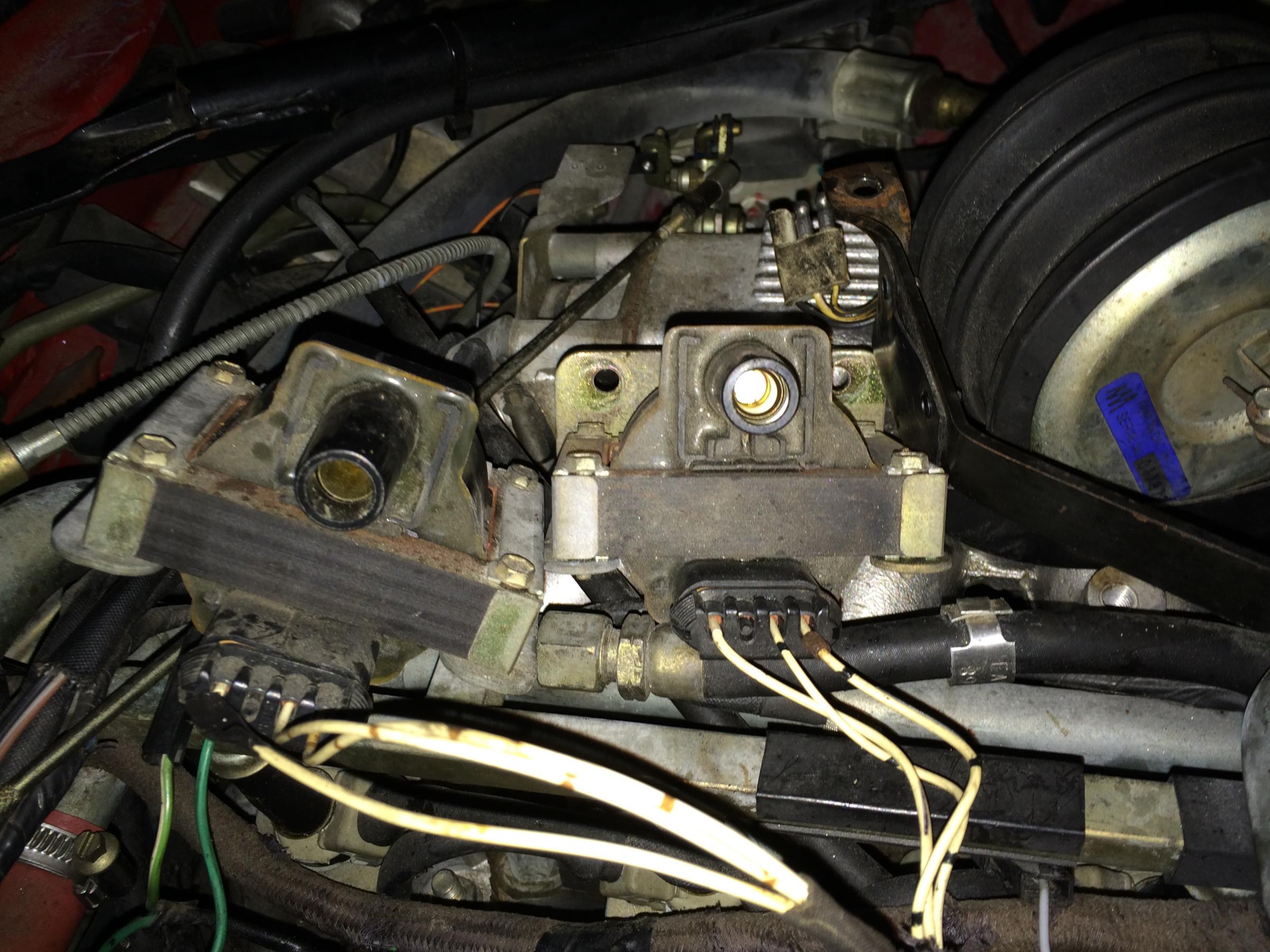

for testing spark are these the coils? I basically attach an HT line to each and have someone crank the car while I hold them with some insulated combo of gloves/ wrench and see if it creates a spark and inch or half inch from metal in the engine?
Sound like a plan?

Old Dec 2, 2014 | 08:06 PM
  #56
Joined: Dec 2013
Posts: 1,078
Likes: 398
From: Greer SC
The only reason I so strongly advise a CT, is because of the 0 compression issue a dropped valve seat/burnt valve can cause. Seems a real waste of time, to spend any more time or energy on a car that you really have no idea will run well at all, once you've put so much time and money into. A CT only takes about 20 minutes. You needed to pull the plugs anyway.
If you have decent compression on all cylinders, then there would HAVE to be much more confidence that time and money spent is well grounded in fact, not hope.
I don't recommend holding those coil wires at all. You can take a nylon wire tie, a wooden or plastic clothes pin, and put the exposed metal end of the wire very near about anything metal. For that matter, you could use a couple of the longer plug wires, push the metal end out through the boot, and just lay it on the plenums. Then, without any help, reach through the lowered window, and spin it over. You will see the result if it is firing. If it is, put it back together. For what its worth, I might try and start it then.

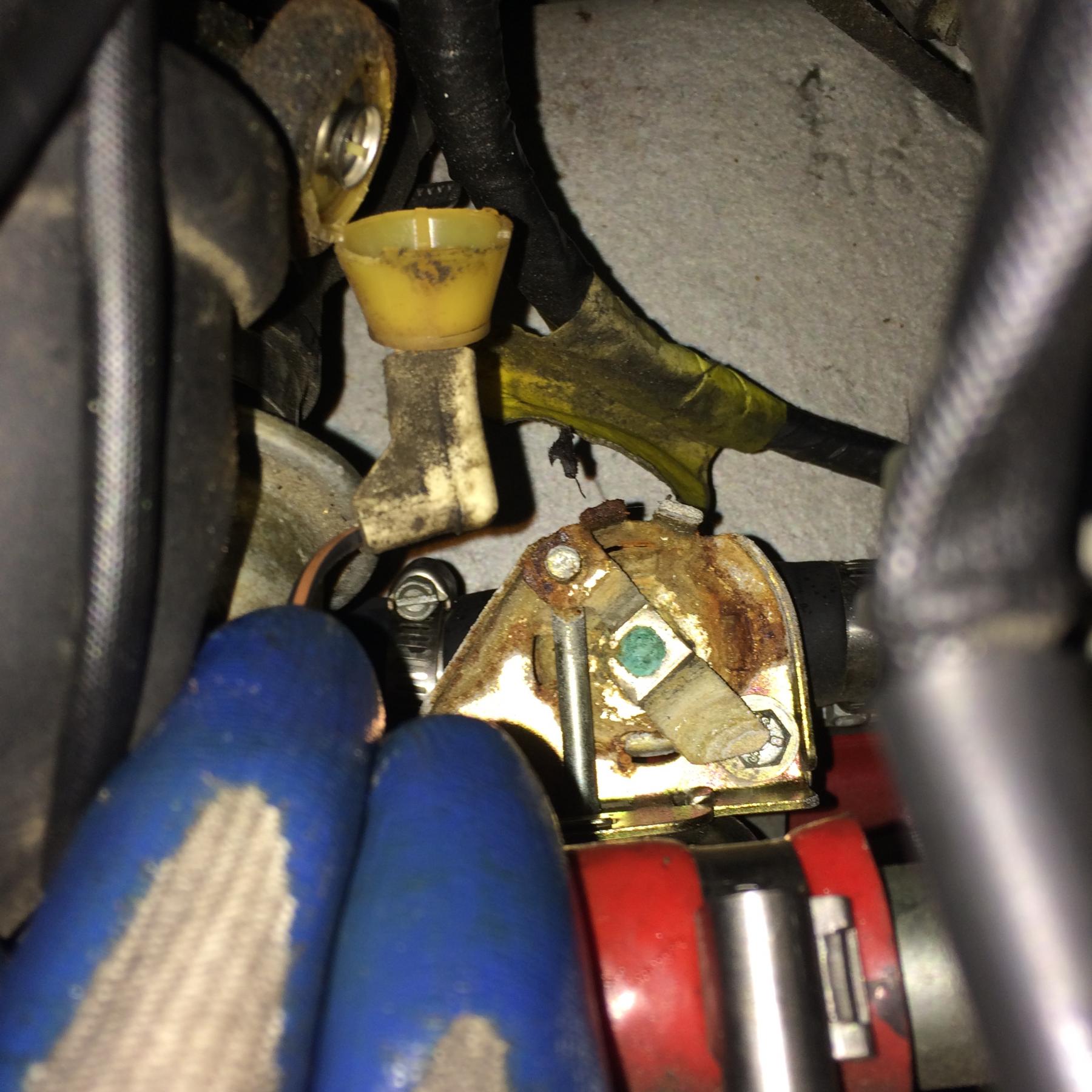

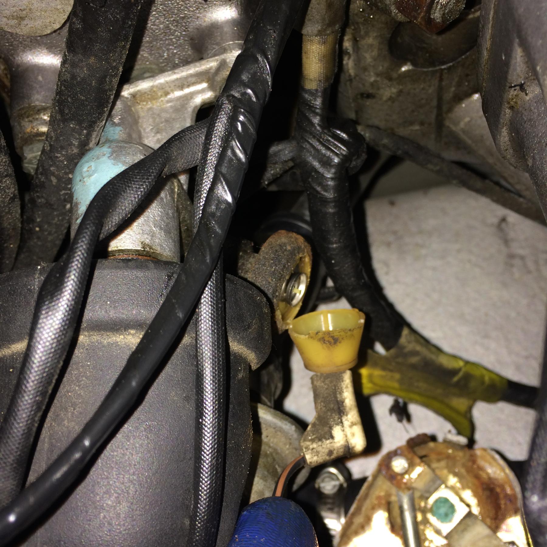

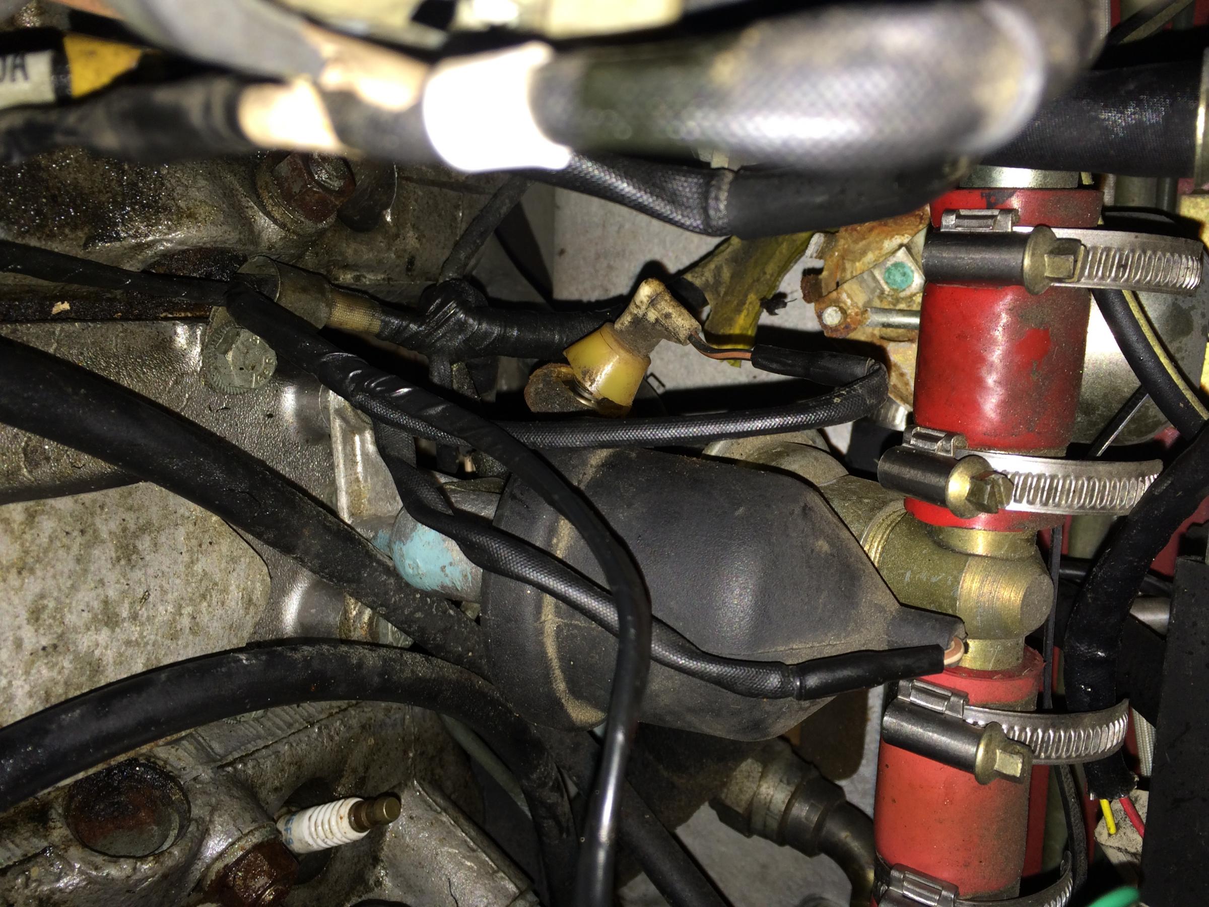

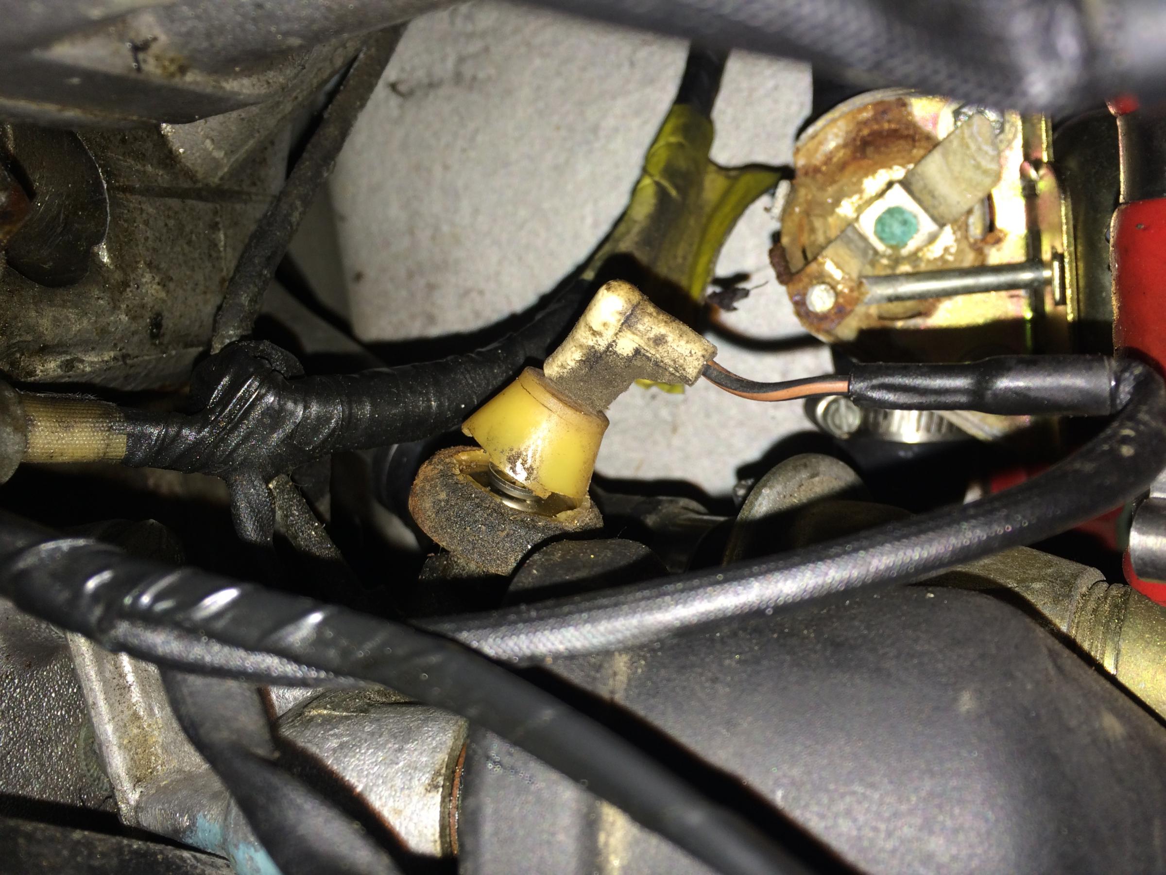

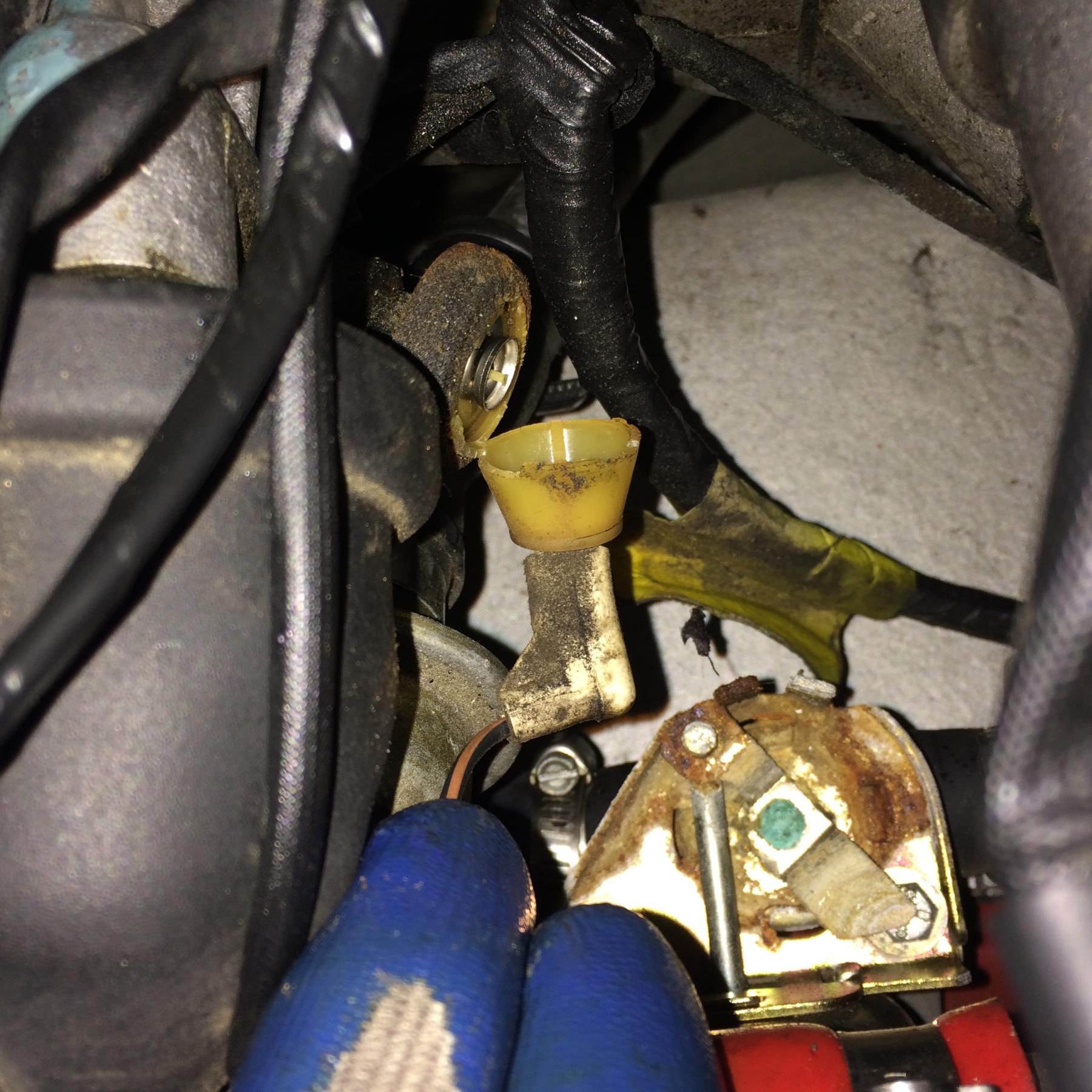

also- I have what I would consider almost certainly some "collateral damage" from me-
this is right at the firewall and looks to be attached to a small bellows or smaller version of the cruise control bellows-
anyone have ideas as to what this is and how I would go about trying to repair/ replace it?
