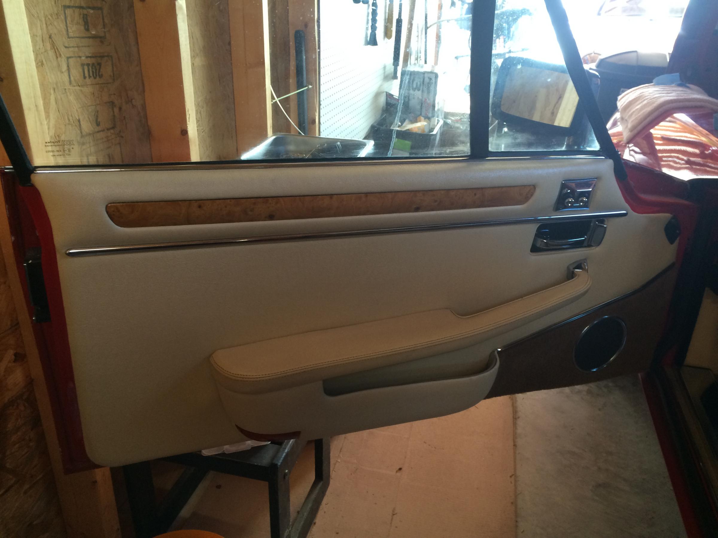

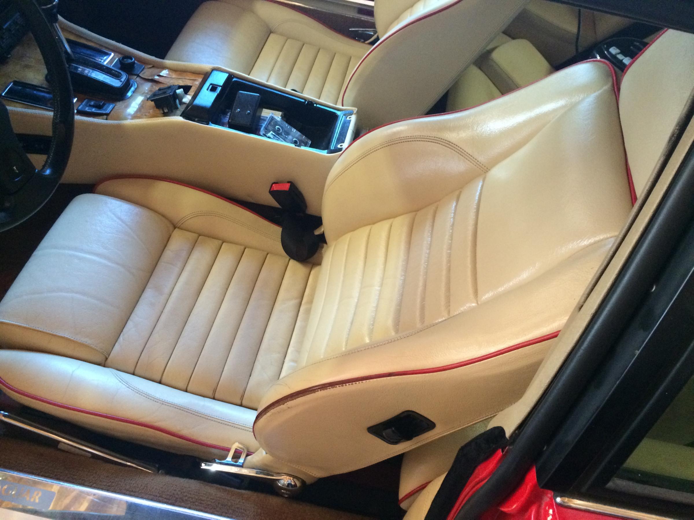

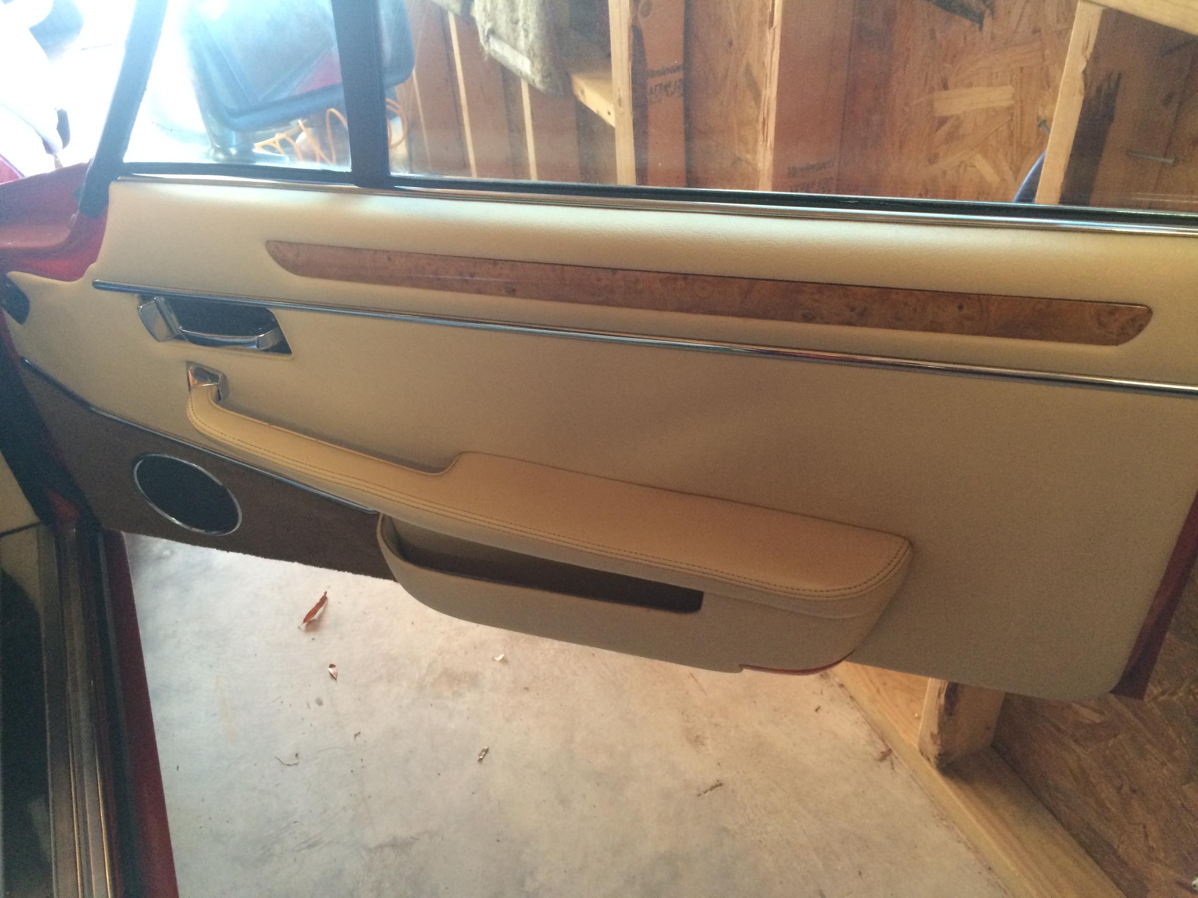

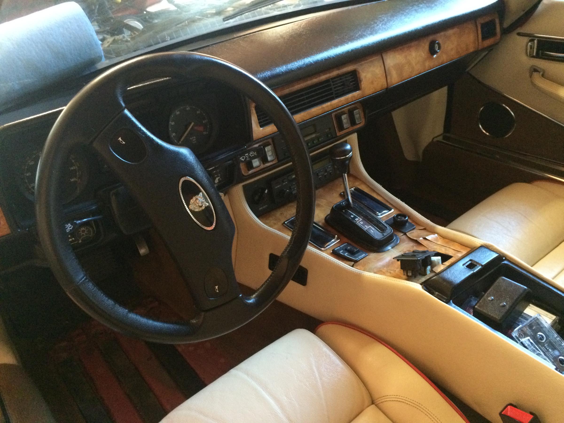

Depends on your perspective but I think it's in pretty good shape. The only interior work it needs is the center console- not sure what happened to it but it looks like someone took a heat gun to it. The rest of the interior is not showroom perfect but it's fine for me.
The pain looks pretty good- there is some adhesive on some of it from what I think was the car cover sitting on it for years. I hope that buffs out but I won't know anytime soon because I can't get it out to wash it!

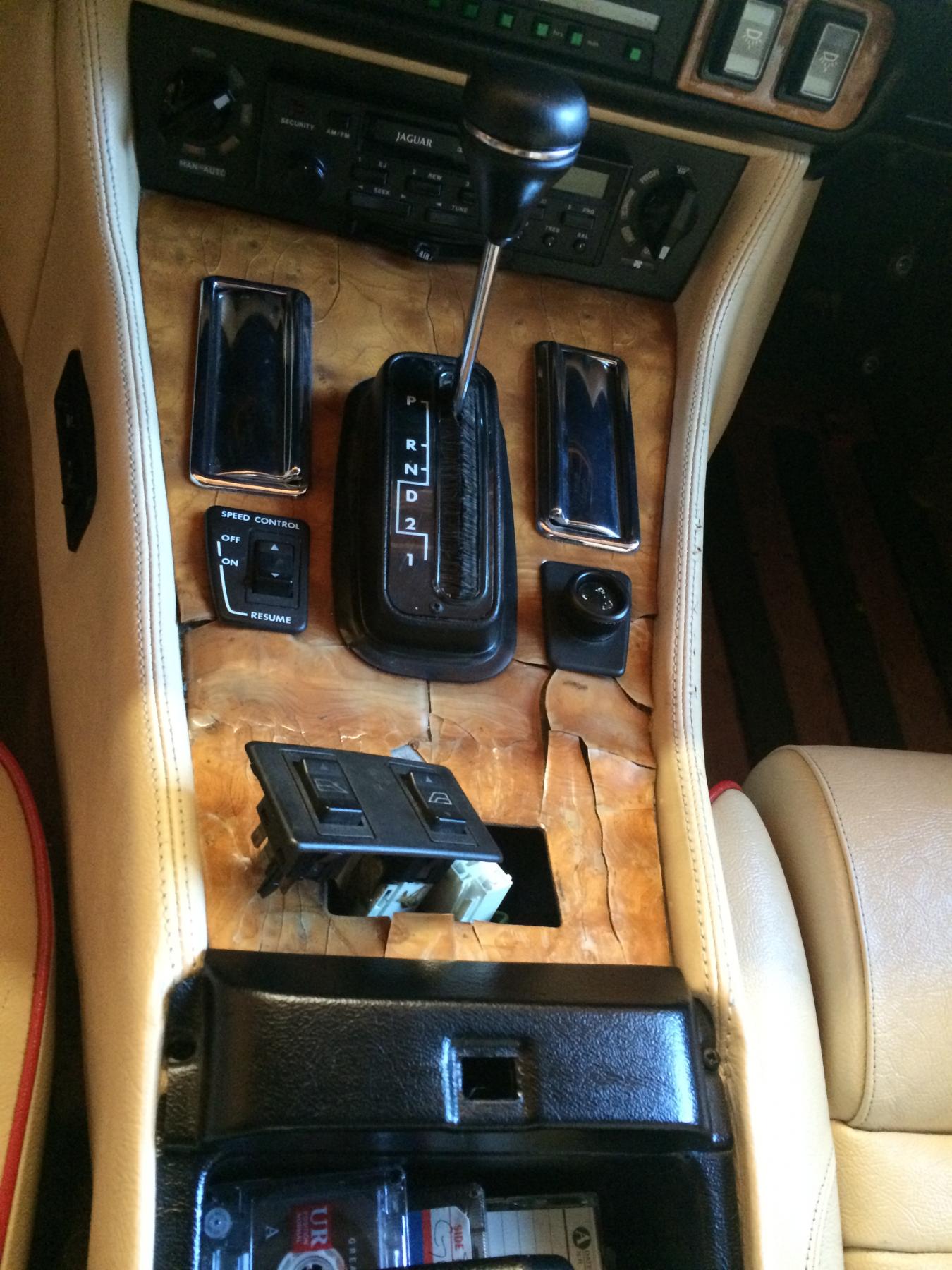

I had Pauls Jag in Ft Lauderdale redo my console. You send the glovebox wood, and the console wood, and they send back a matching console to all the other wood. Nice alternative, especially on a connvertible, where the rest of the wood has aged about the same.

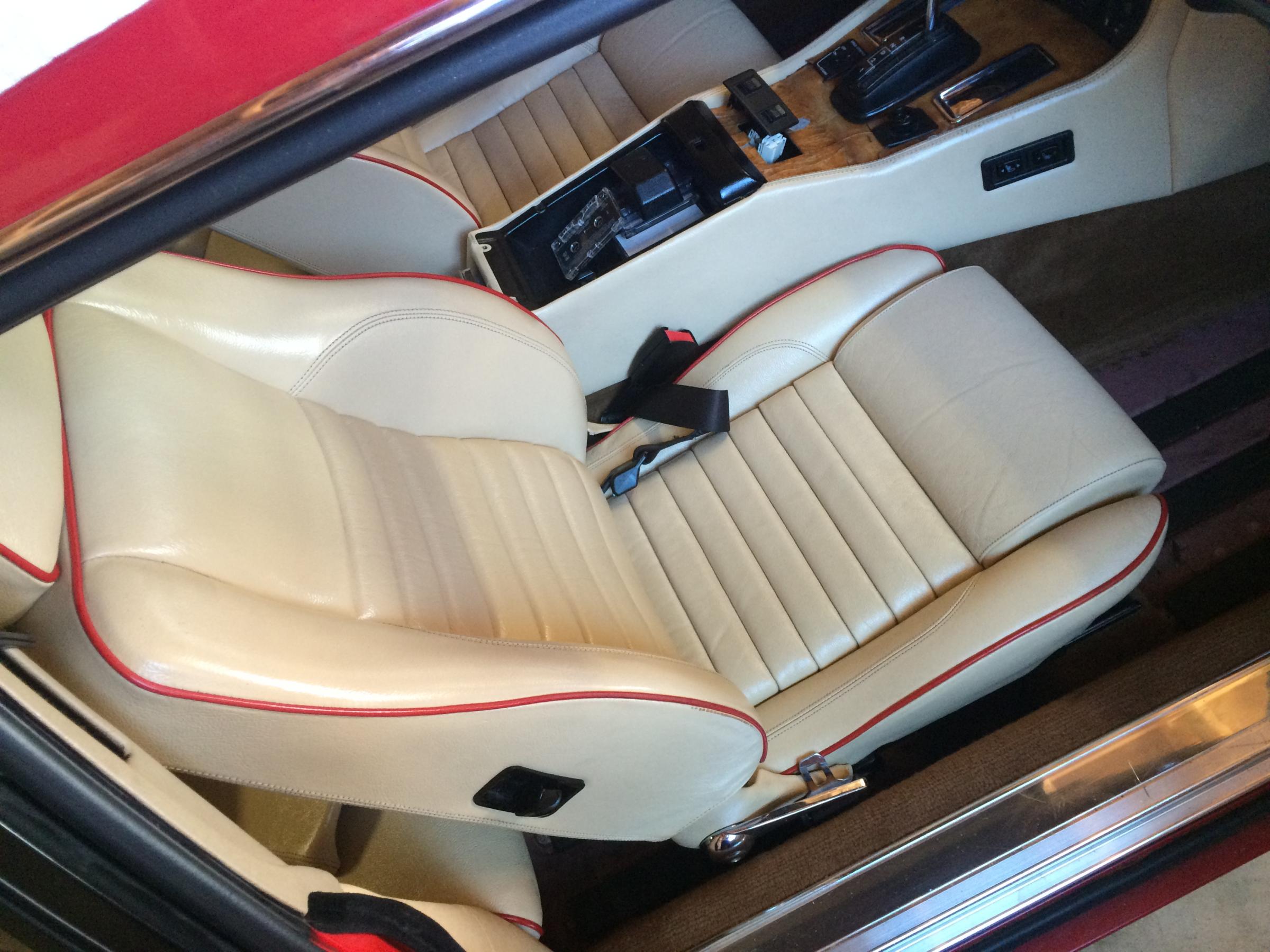

Hard to go wrong with red as far a body color, and from the pics, the interior does look pretty decent.
I'm just not in the best of judgement right now about these cars. I bought the current 89 as a non-running car, that had been misdiagnosed, then kinda butchered by a shop that appears to know very little of Jags. I have owned many of these. This one is a beautiful convertible, but after a year of work, and the second tank of fuel put in, it dropped a valve seat sitting in the driveway. Very very frustrating. I now have a 6.0 to go in, and am converting it to a 5 speed now. These cars are a never ending pit for passion, hope, and lots of money, not always in that order, lol.

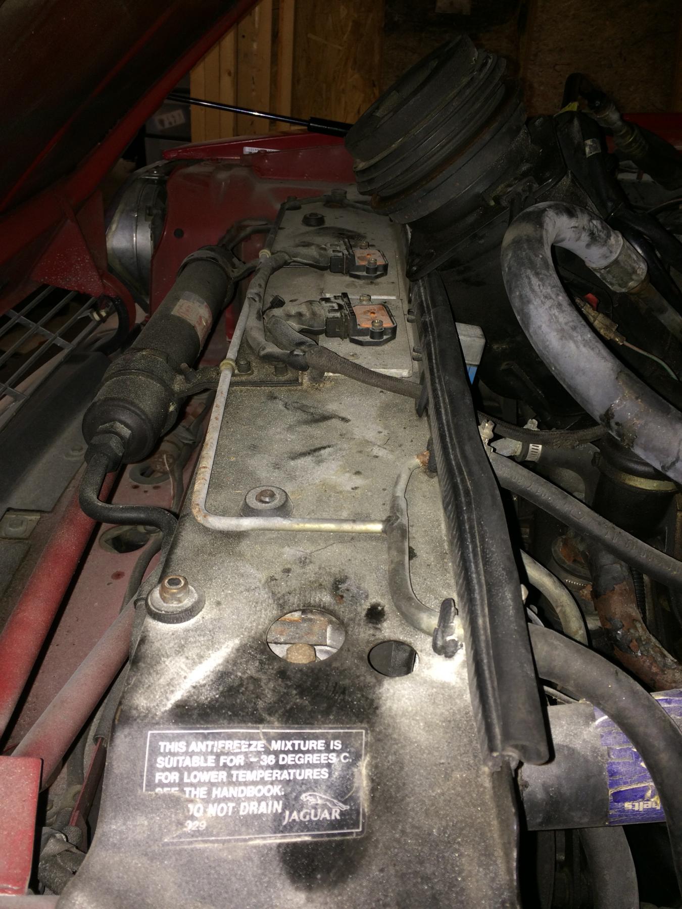

The A.I.R. pump is still there. Right next to the accordian radiator hose. There is no belt on it. You may have taken it off, but most times, the belt breaks about the time the pump seizes up. If it is inoperative, it isn't doing much good, so may as well get rid of it. And if you get rid of it, may as well do away with all of the lines it feeds.
There will be a small hole on each intake port that needs to be filled. I don't know what others have done, but I found a small allen head SS screw, that barely fit it the hole, about a half inch long. I put some black RTV on each one, then threaded it down into the hole. I let it set overnight, and my guess is they are still there....

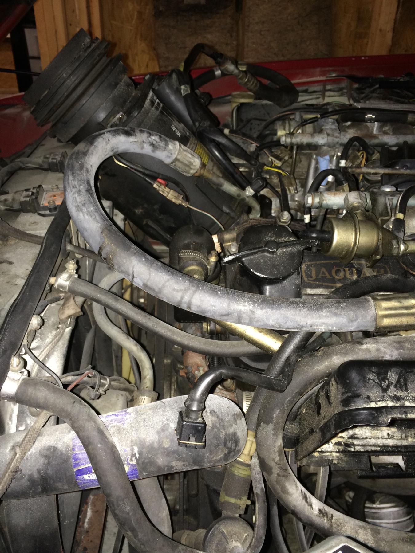

I think I put too many posts back to back but if anyone has thoughts on post 79 or 80 please let me know.
If the connector in 79 needs to be connected I want to try to get it back to it's mate.
And I don't want to break anything in 80 trying to disconnect it if it's the wrong thing!

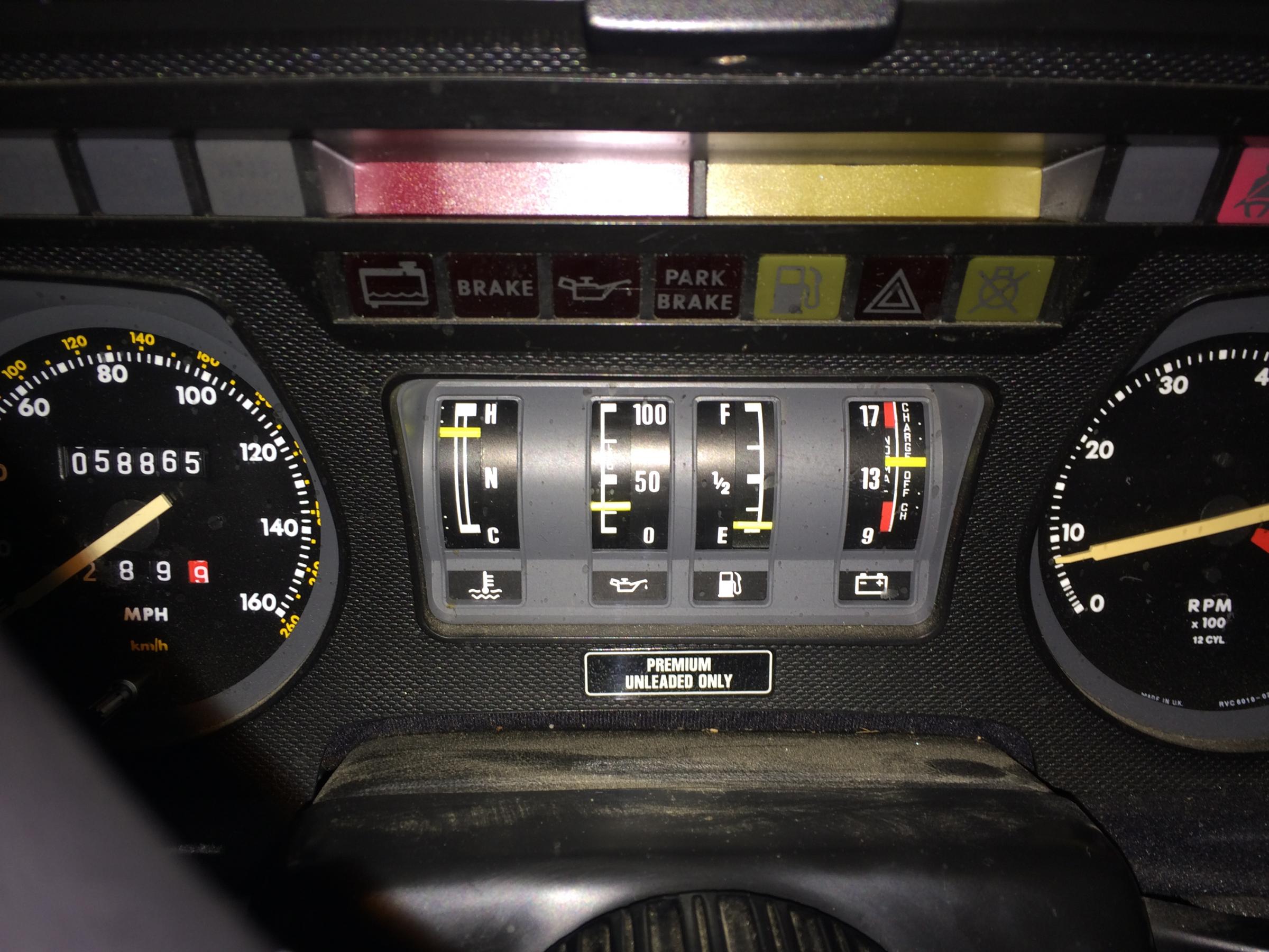

I also took a pic of the dash if anyone has thoughts about anything being amiss- ran for a couple of minutes and then noticed the left gauge (coolant temp?- need to check the manual) was high so I shut it off.

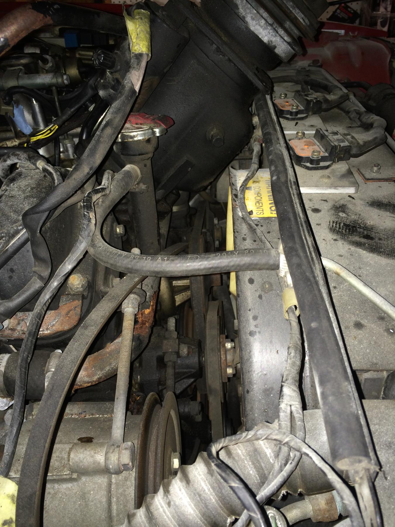

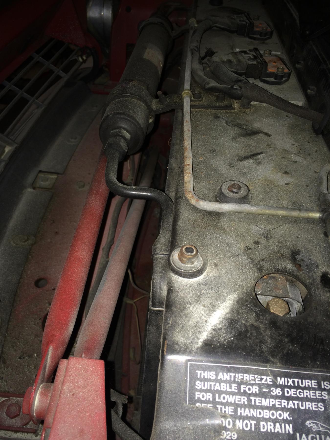

went out to start him again last night to sit and listen-
right after I started it the red coolant light came on. The engine was idling at about 2000 rpm.
I sat and watched and waited and after a few minutes the engine idle dropped to about 700, the red coolant light went off, and almost immediately the coolant temp gauge began to climb. I shut it off just after it passed midway.
After I shut it off I heard a hissing noise coming from the front of the car-
this is what I found if anyone has specific ideas-
makes me think maybe something is blocked or not being allowed to flow as rapidly as it wants-
or it's trying to boil was my other thought.
And as far as I can tell the coolant reservoir stayed steady the entire time.
