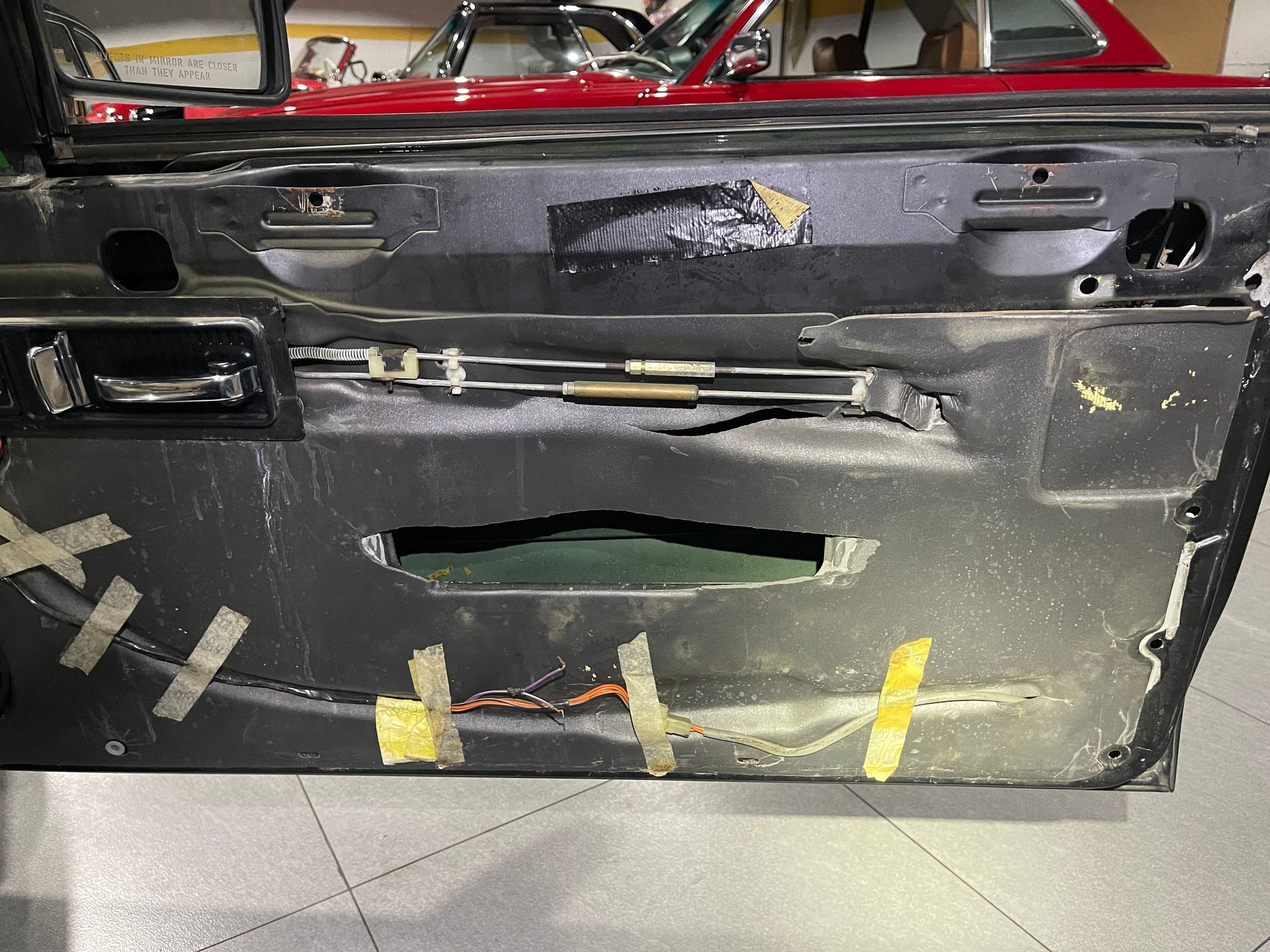

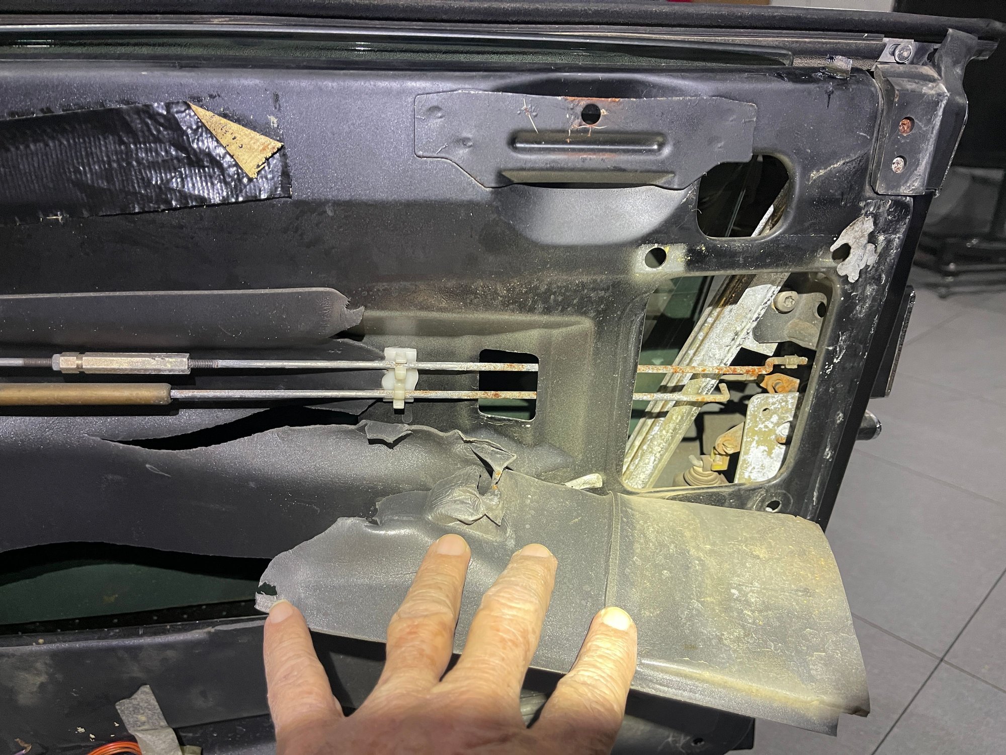

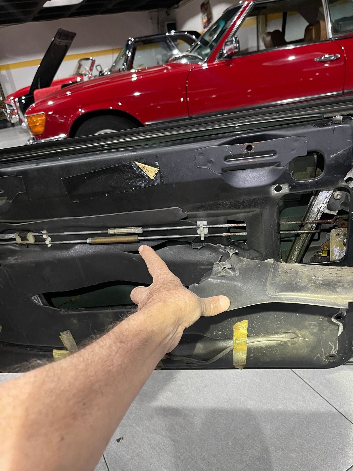

I pulled out the door card and tried to lock the car. I saw the lower rod in the first and second picture below where it is connected to the brass tube, presumably one of the adjusters? It moved towards the lock with the brass tube as well as the rest of the rod connected to the door lock, but at some point the rod and brass cylinder kept moving but not the rod connected to the lock. Looks like it has a spring inside.
I uncovered the poly black cover to see the amount of rust there (third photo) and suspected seizure, so cleaned it and sprayed it with WD 40, and lo and behold it was as good as new.
I sprayed any other moving metallic parts before reassembling the card. I decided to do the same thing for the other door as a precautionary matter.

Good job! That brass adjuster is indeed sprung, done, I think, in order to soften the "clonk" on locking and unlocking.
I had a similare problem and solved it by deactivating the sprung bit in the brass adjuster. See post 19 on this link:
https://www.jaguarforums.com/forum/x...repair-177091/
