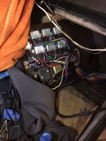

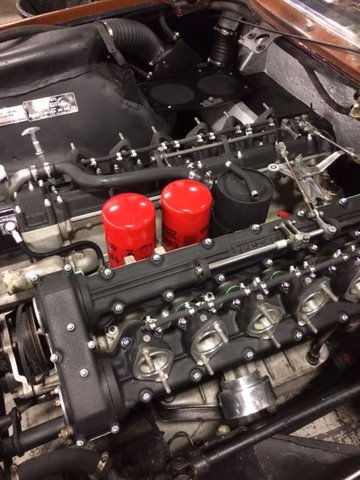

So......just for weekend conversation and a change of pace I thought I share a couple pics of another project of mine. An old Ferrari that suffered a .....um....."thermal event" in the engine bay. I've been working on it a few hours each week for a few months now.
The engine bay rehab is nearly done so pretty soon I'l start on wiring repairs. Fortunately the damage was limited to just about a dozen wires. And, fortunately, the wiring on these oldies is dirt simple. I've pulled the wires thru the firewall and into the cabin. This makes repair much more convenient. The wires will be re-sheathed and then routed back into the engine bay.
"While I'm at it" repairs include replace control cables for the heat/defrost systems and choke, wiring repairs related to old age, poor connections, and PO hack jobs (radio, alarm), repairing dead instruments, and the like.
The Ferrari guys and the Jag guys must've been cousins. Some stuff designed and built to last a lifetime....which means others things were obviously done "on the cheap".
Note the all-in-one component panel for relays and key junctions. Clever. This normally resides in the footwell on the cabin side of the firewall. I've shifted it out of position at the moment.
Anyone used to working on old Jags would feel right at home. Lots of tiny screws holding things together. Lots of un-sealed electrical connectors. Lots of Lucas and Smiths parts. So, actually, it really isn't a "change of pace" at all

All those relays sure look familiar! If it's all Smiths and Lucas can we call it a fancy MGB?

Slow-but-satisfying progress

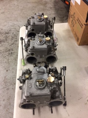

Six Weber carbs to overhaul. Three done, three to go! Fascinating.

SUs I can handle, but they look terrifying Doug! How did you find out what to do and how to do it? How will you remember where all the bits go when re-assembling? I need a list these days to remember what i went to the larder to fetch!

I was just thinking that photo makes me really appreciate SU's.
I just take lots of pics during reassembly, that's all!
What worries me is getting them all synchronized once the engine is running. That, and getting two distributors properly phased.
Its just like overhauling any other carb: disassemble, clean-clean-clean, reassemble. You don't have to actually understand how everything works or what it does ! Interesting carbs, though. The jets, emulsion tubes, even the venturis and throats can be removed and serviced with the carbs still on the car, if the need arose. Everything is accessible by taking the top cover off.
