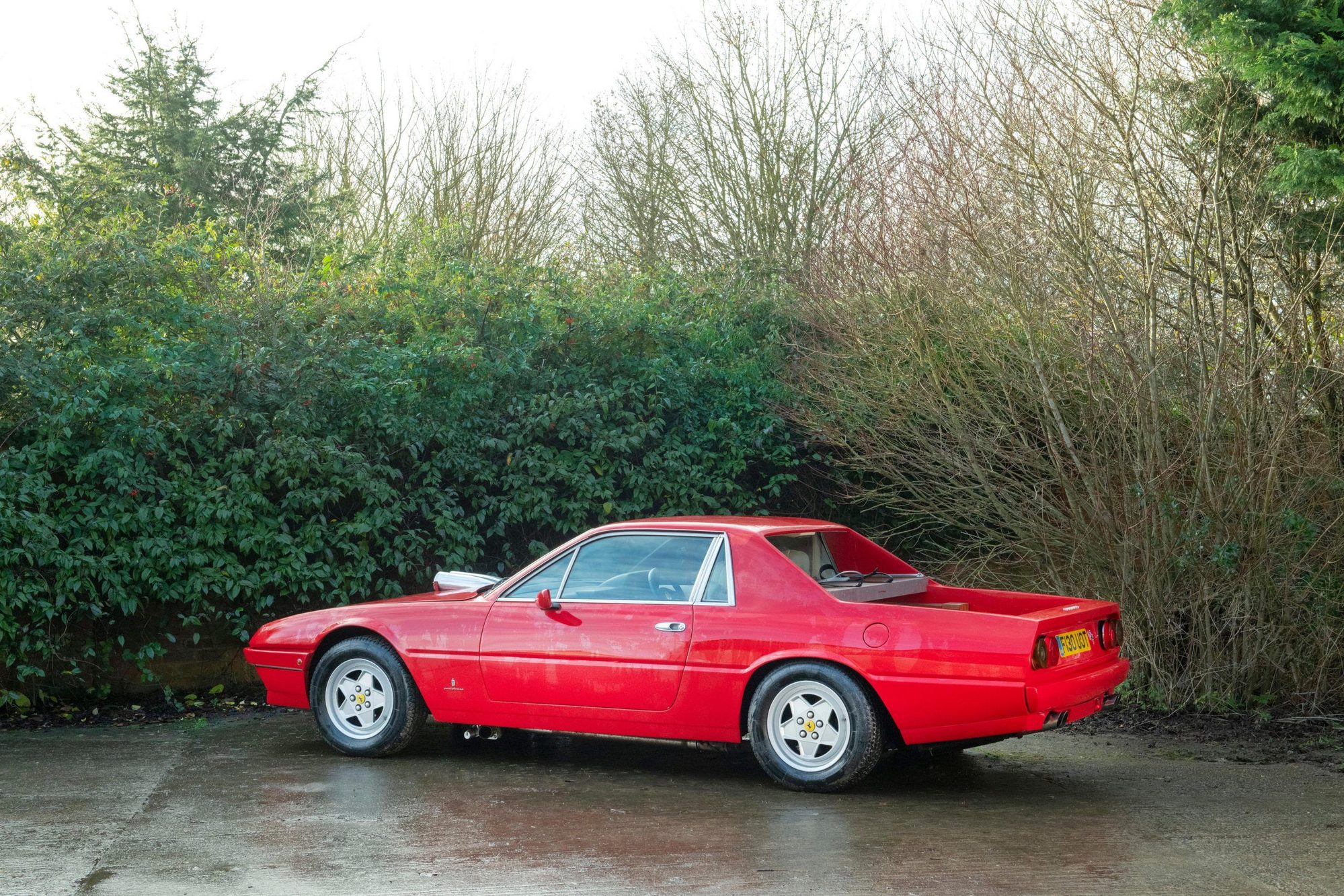

Doug,
Need a Parts Truck? (or Ute for our brothers down under)
https://www.hagerty.com/media/buying...up-conversion/
I know someone once did this to the XJS, and with the flying buttresses you could not tell it had been modified except from the rear view of the car.

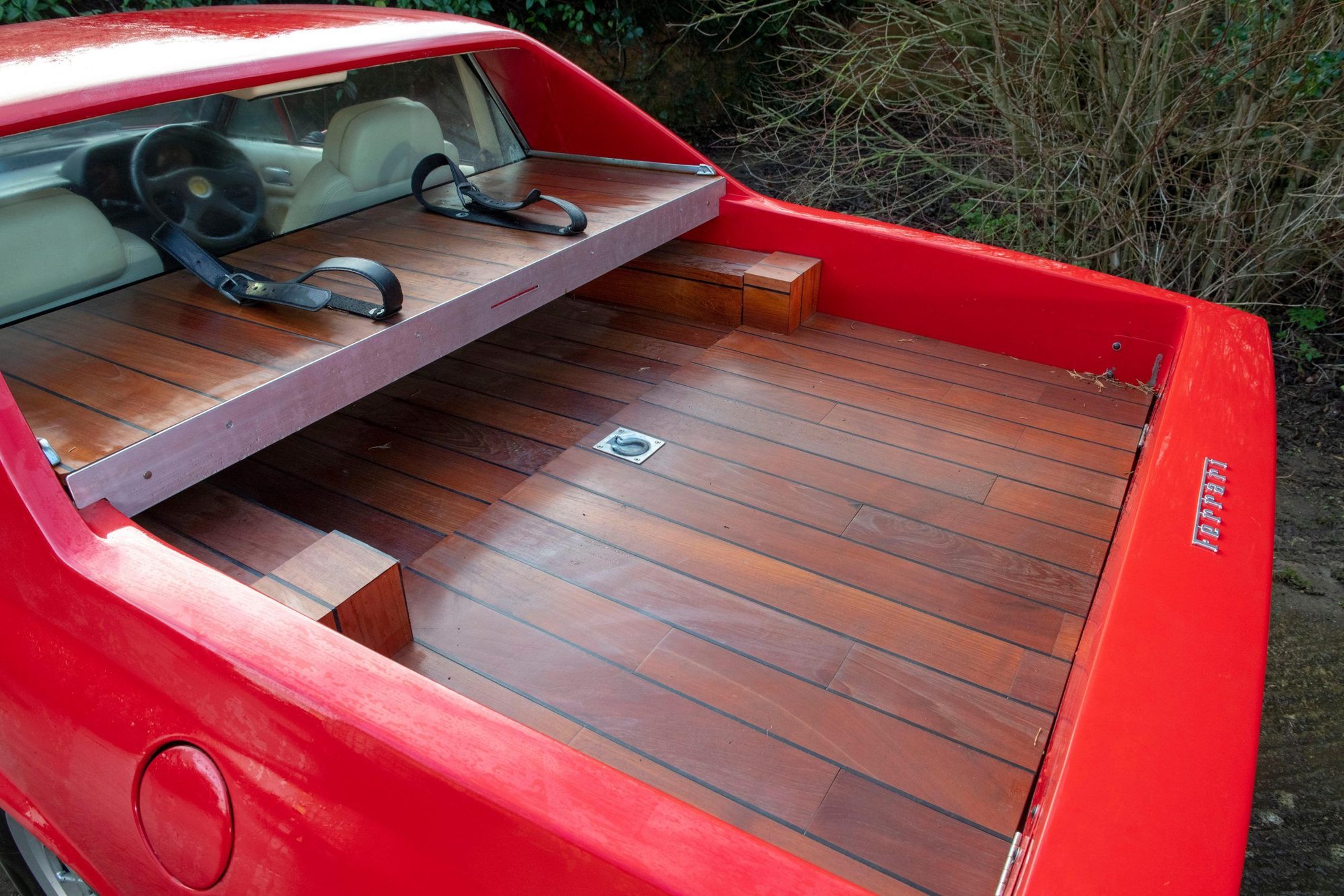

Originally Posted by Mac Allan
Doug,
I realized the link might not work so here are some pics -

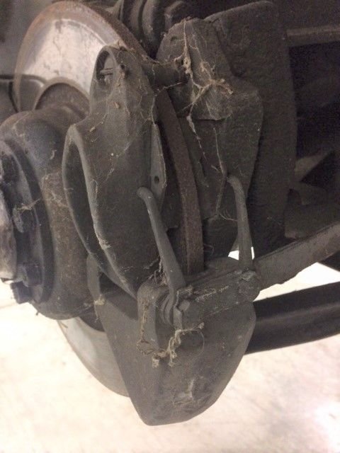

I'm nowhere near done with the first Ferrari when I've been tasked with resurrecting another. Gah !
This one is a 1967 330GTC. I just had to chuckle out loud when I pulled the wheel and saw the parking brake set-up. This will look totally familiar to anyone with an inboard brake Jag :-)
DD

That certainly looks familiar! Does it work as well as the Jaguar application?

I didn't try using it !
Yet
DD

My Alvis TD had the same setup, and all you had to do to adjust it was poke a screwdriver through the spokes and turn the large slotted screw! No worrying about does the automatic adjuster work!

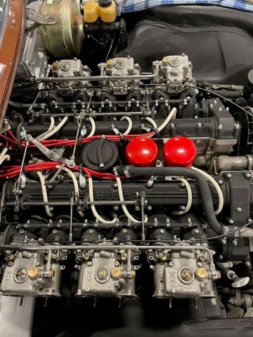

Been a year since I updated this thread. Haven't had a lot of time to devote to this project but an hour here and an hour there eventually yields results!
Believe it or not....I was a bit amazed, personally....the engine actually starts and runs ! Now comes the fun part: getting six carburetors and two distributors singing in perfect harmony. Wish me luck !
DD

That looks very impressive, well done!

Purdy Ain't It! not much else in the world looks as good under the hood as a V12 Ferrari. Damn Pretty. Nice Job Doug.

Wow, I'd love to hear it!
Rob

When (if?) I get it dialed-in I'll make a video.
I still have tons of work ahead of me before this car is done.
DD
