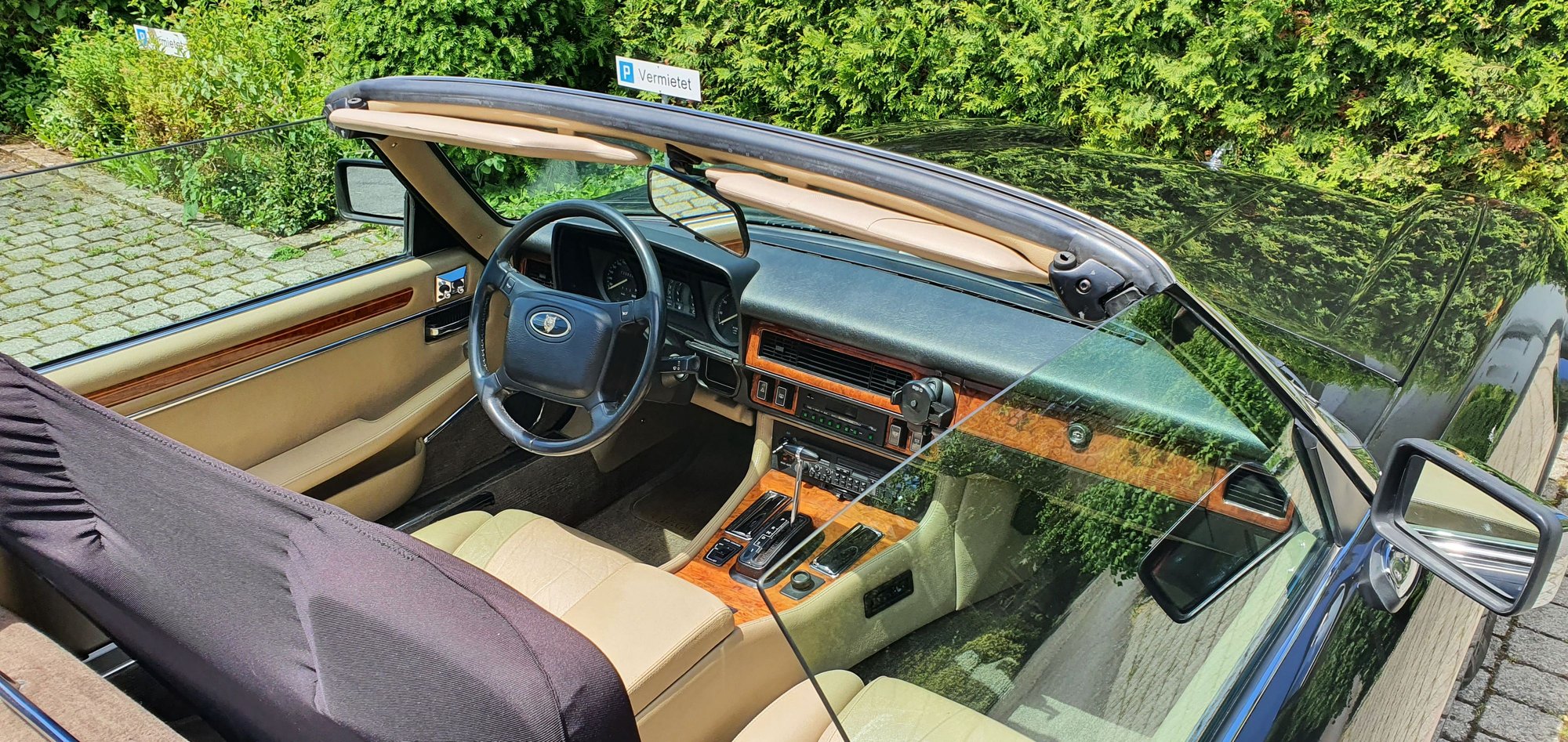

Dears, I own a 1990 V12 5.3 Convertible and wish to change the steering wheel. So my question, has anyone disconnected the the airbag and mounted something like a Nardi wheel, wood or otherwise ? If so what model no and modification attachments where needed ? Or any other suggestions?
Many thanks in advance for the feedback.
Derek

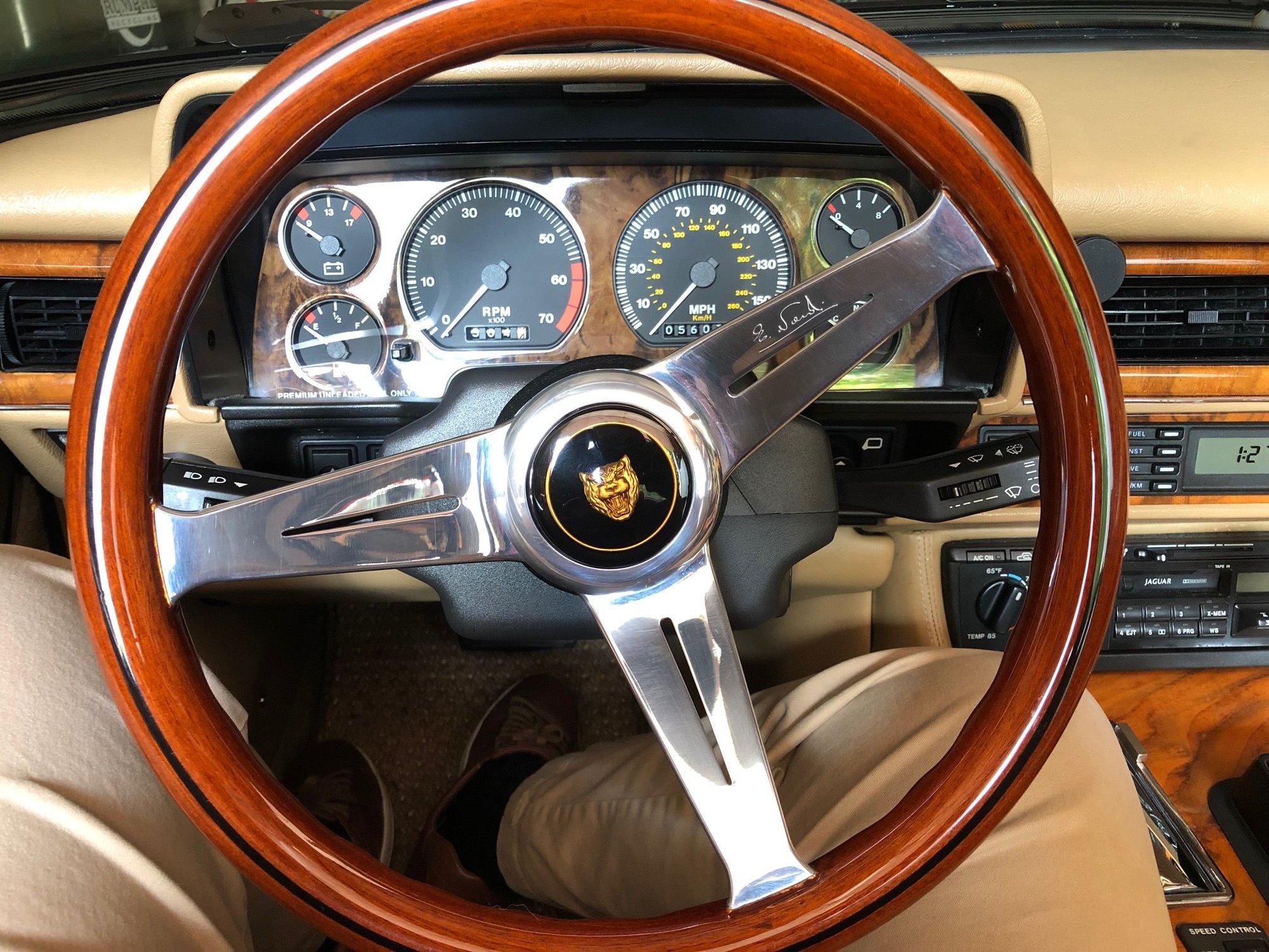

Yes you can replace the stock AirBag steering wheel with a Nardi wheel, which was the first change I made to my 1990 convertible after buying it (I hated the look of the airbag wheel, and the thought that there was only one airbag. Didn't like the idea that I might survive a accident and a passenger might not).
The bad news is that I did it so long ago, I can't recall all the specifics. I seem to recall that the Nardi adapter was only listed going up to '89 but still worked on the '90. There were all kinds of scary warnings back then about how airbags couldn't be disarmed or removed by DIYers, but there were clear instructions somewhere on how to go about it.

That's (almost certainly) not an airbag steering wheel, but the early facelift padded one. The airbag wheel has a monochrome Jaguar head moulded into the plastic, and a seam for the bag to burst out of. This one, which looks identical to mine, should just have a centre pad that pulls out.
Old Jun 8, 2021 | 03:38 PM
ptjs1's Avatar
Posts: 4,569
Likes: 3,515
From: Kent, UK
​​​​SDSD,
You're right, that's a non-airbag wheel, so significantly easier to remove. The horn buttons are integral to the centre pad as opposed to being fixed to the wheel spokes on an airbag wheel.

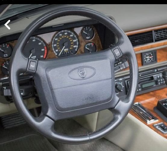

The airbag wheel is structured such that the airbag includes the top part of the padded area up to where the horn buttons are left alone remaining at the top of the spokes. As per the pic below.
In the non-airbag wheel, the padded part at the top centre of the wheel remains intact when the centre boss is removed, integral with the horn buttons, as per your pic.
Hope that makes better sense!

Now I get ya! So non-airbag and airbag alike have the horns on the spokes, but in the gasbag wheel, the buttons are separate, whereas with the non-gasbag wheel, the buttons are contained within the outer section surrounding the actual central pad.

Yes, I had it done professionally, but it was easy. Note: you want the deep dish style wheel. Plus,
you will find the controls on the column will be a longer reach and need some getting used to.
The wheel grip is also smaller. However, it is all worth it. The Nardi is more expensive but the one to use.
