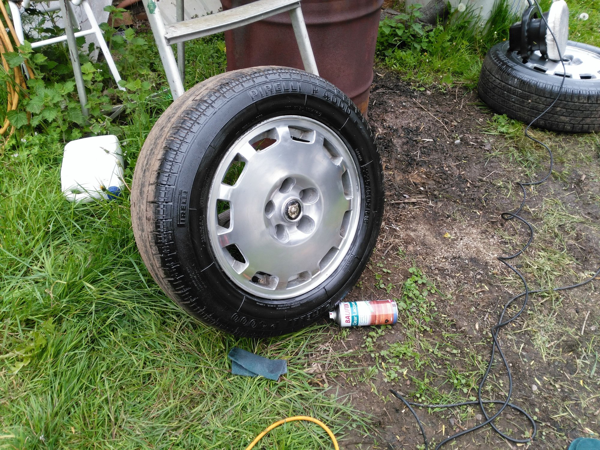

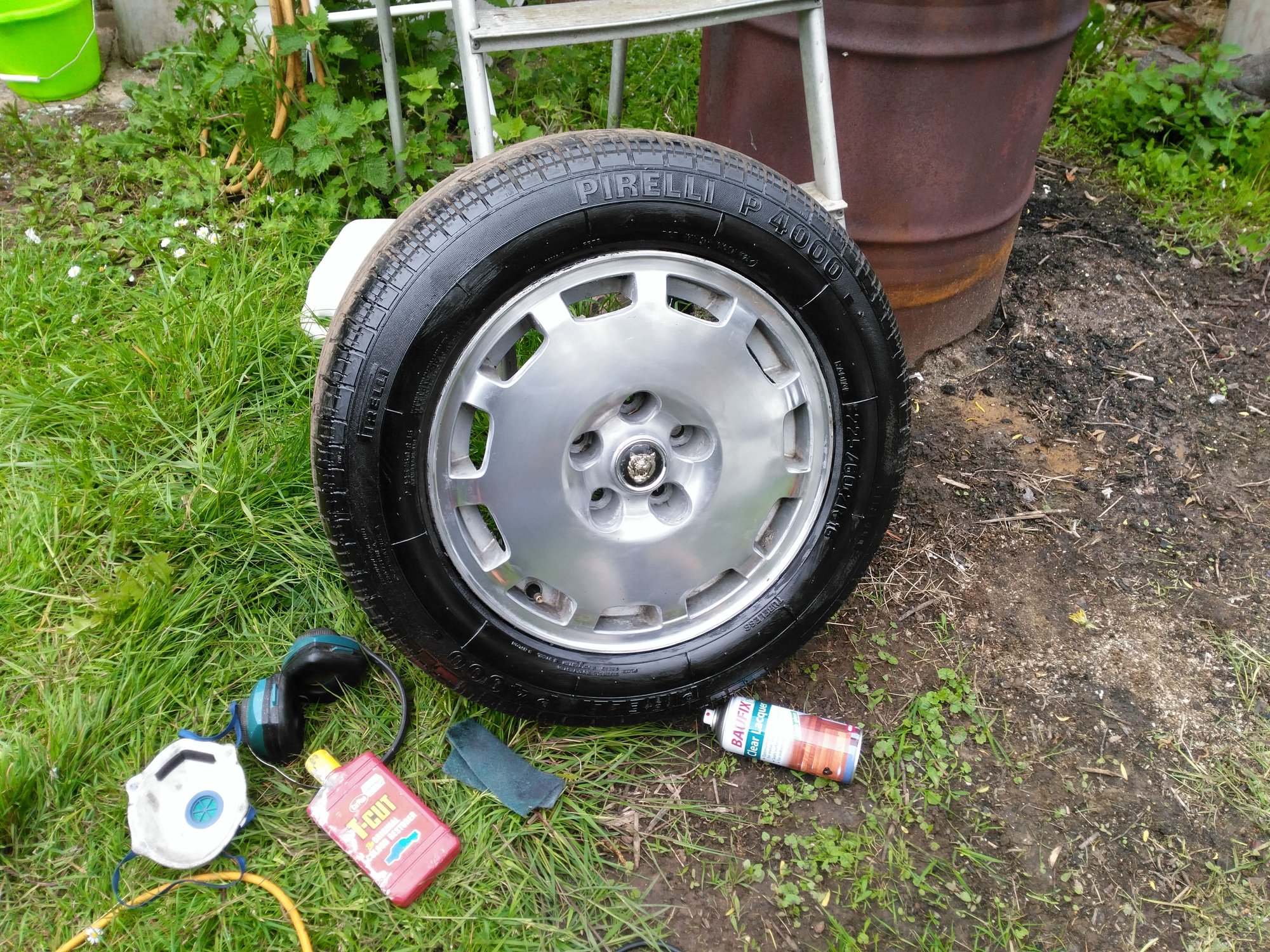

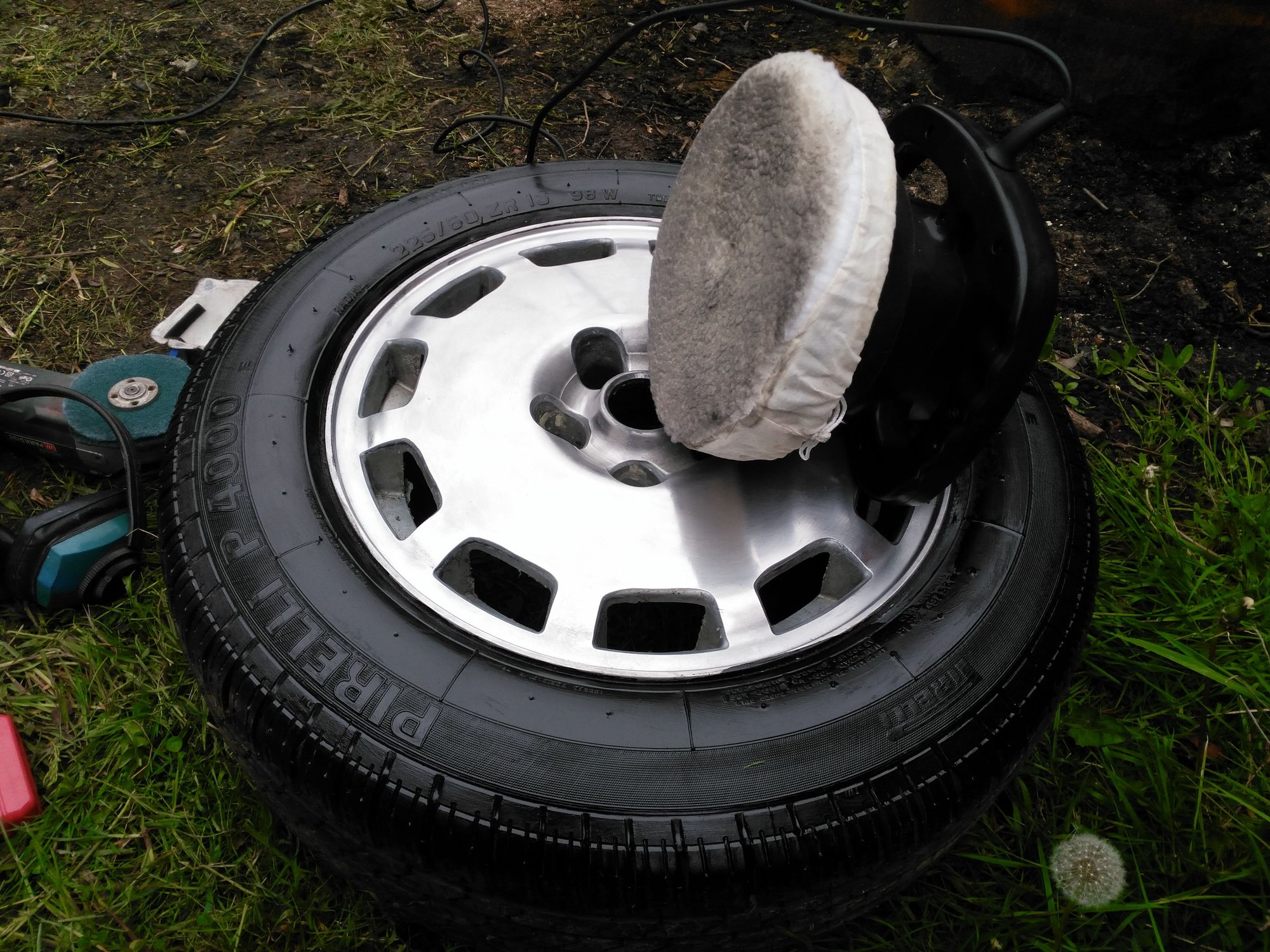

A Clean Pair Of Wheels (Part 4)
Polishing The Wheels Of My XJS 4.0L
Yesterday was a disaster!Polishing The Wheels Of My XJS 4.0L
As soon as I got the equipment out of the Garage to Polish the Wheels it started to rain, then as soon as I put it away it decided to stop!
Although today was different as it was so freezing cold I thought it would Snow but then around midday it really started to warm up, so no time to loose with the Polishing before the Weather changes for the worse
Polishing Wheels once the Lacquer has started to peel off, is nowhere near as easy as I though it would be, as like many other jobs on an XJS there is a knack rather like doing the Calipers which seemed to take forever and they did, so better luck next time on those as I have another pair to do
Though as for the Wheels this can be a bit of a Nightmare to get the Gun Metal Finish I was after, not too dull and also not too shiny but something that just seems to look just right, what with beauty being in the eye of the beholder and all that
Where one of the first mistakes I made was in applying too much buffing soap, as what you put on also has to come off to hopefully leave you with the perfect finish or something close to
It wasn't as if I hadn't got all the equipment, as I had everything I'd ever need to do the job, except that when I had a go at polishing these Wheels, I have to say I hadn't got the skill which only comes with lots and lots of practice and so I had to do the best I could which also involved an awful lot of hand polishing
Which if nothing else was keeping me warm, although I thing I managed to get the look I was after at the end, though when I say end, there are still two more Wheels to do, so hopefully I will not be making those same mistakes next time
Nearly but not quite the look I wanted
So So Close!
Yass! That will do for me!
Can't resist a little bit more Buffing to give me the 'Gun Metal Grey Look' that I was after

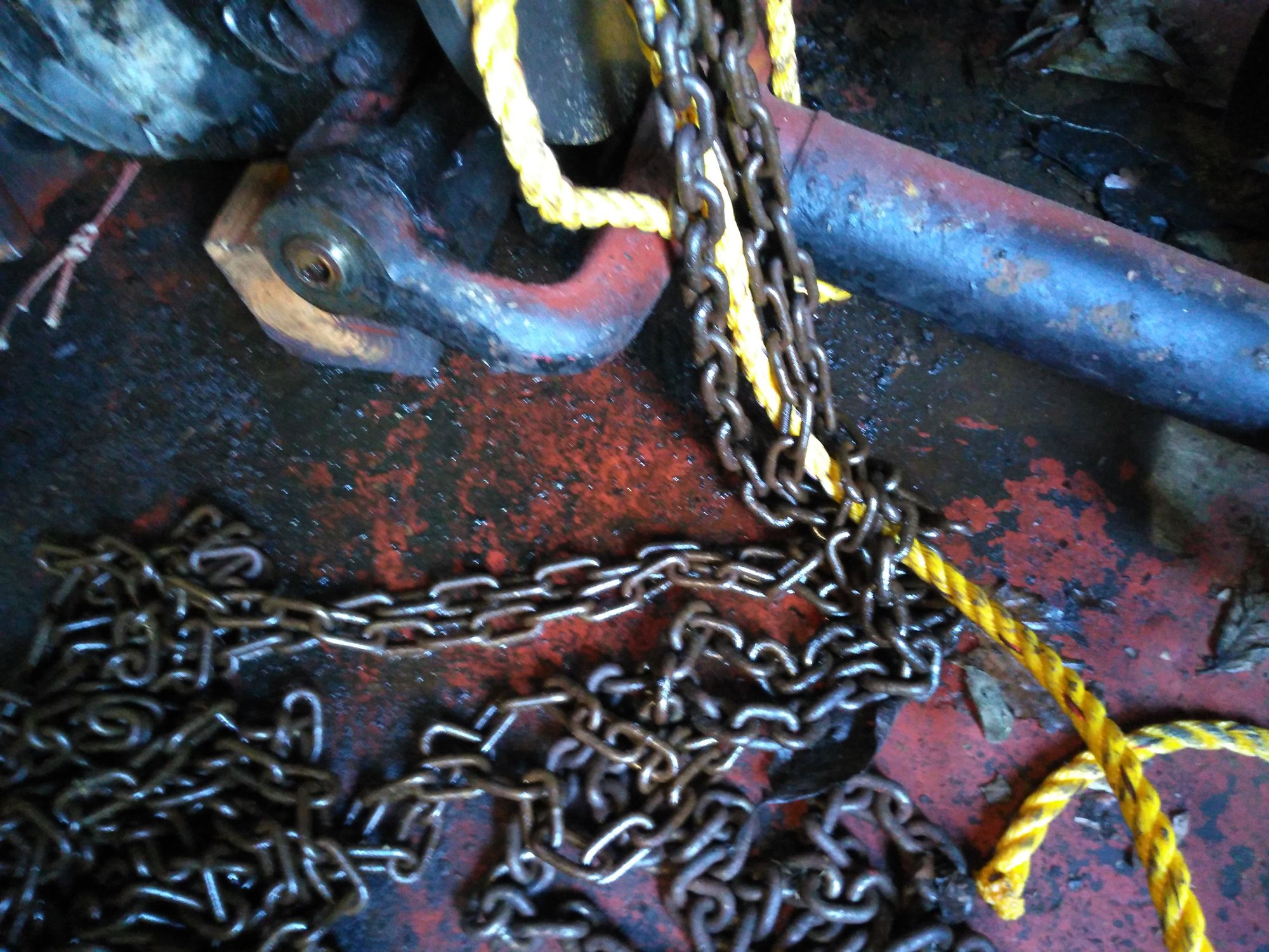

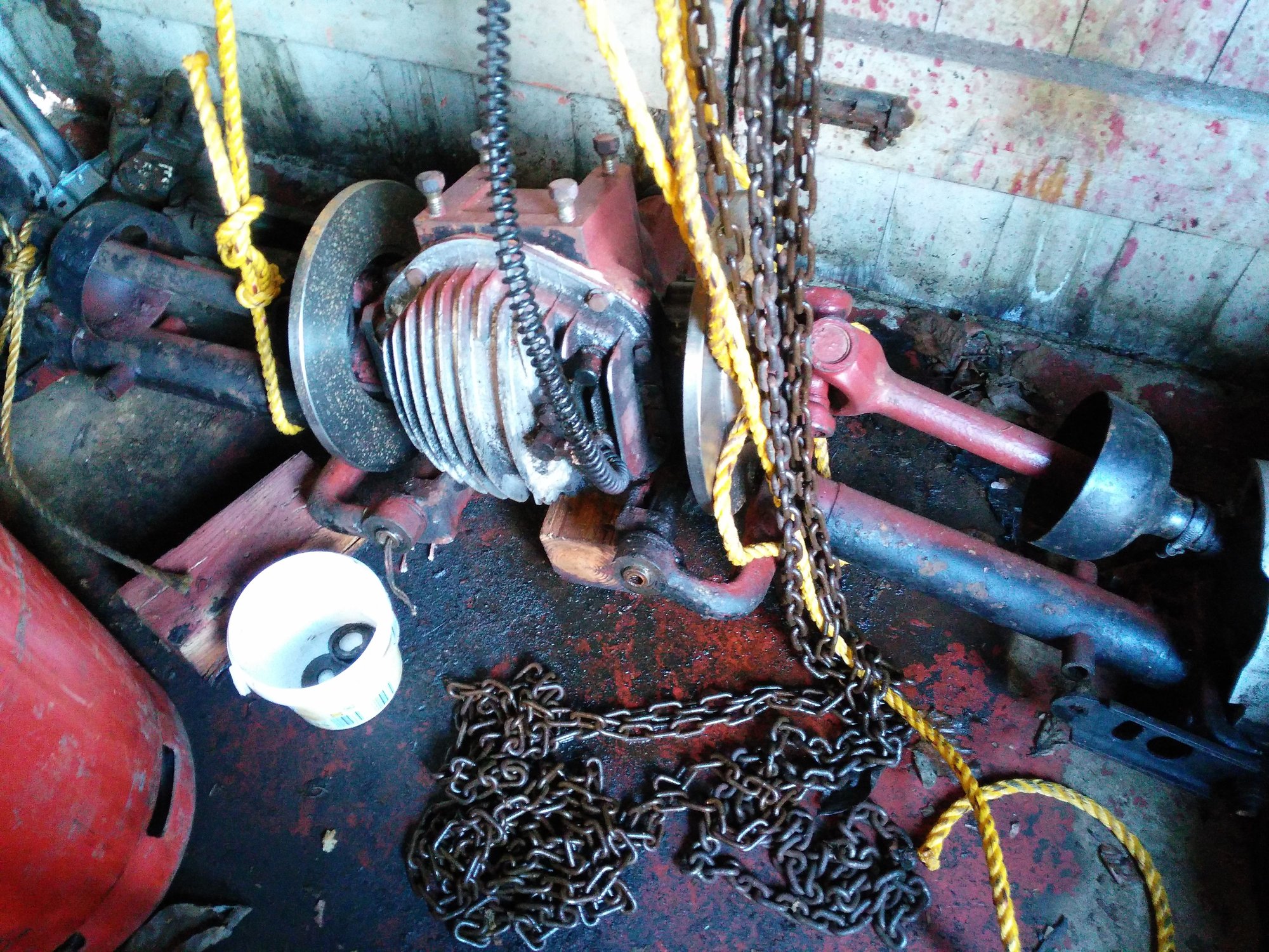

While waiting until June 1st to Road Tax '50 Shades' My Grey XJS, I've been working on an IRS Rebuild for 'The Ice Princess' that I took out of the Car about a couple of years ago, which ended up on the 'Back Burner' because of other stuff I had to do
During the course of this rebuild, I had to roll the IRS Diff over on its back, supporting it on Blocks of Wood, so that it didn't get damaged when placed in that position where I left it for a while while I was putting the IRS Cage back on '50 Shades'
During which time I noticed that there was a pool of Oil underneath the IRS Diff spreading out on the Garage Floor
Oil leaking out of the IRS Diff all over the Garage Floor about 250ML
I've no idea where its leaking from except to say that it isn't from the Oil Seal where it would connect to the Propshaft, although I may be able to hazard a couple of guesses unless anyone thinks that they may know the Answer
Where is that Oil Coming from I wonder
At first I thought the Oil Leak was coming from the Sensor that goes in the back of the Diff, until I happened to notice another Plug above it with a Plastic Cover on, which the IRS Diff on '50 Shades' didn't have
No idea what that 'Plug Thingy' is that is over the Sensor and am wondering if Oil Could be leaking from there, when the Diff is laying on its back with the Fins pointing downwards
Does anybody know what that Plug is for and would it be normal for Oil to leak out with the Diff in that position?

That looks like the vent. My MGB has one that looks the exact same. It allows air to expand out when the diff warms up in operation and allows air back in when it cools off. Otherwise you would put a lot of pressure on the seals.
OB
That is the breather; your other diff will have one too, even if it looks different. As the diff heats up the expansion of the oil and any vapour needs an outlet, or it will blow out of the seals. When you turned the diff upside down, oil ran out of the breather.
Just drain and refill - you did do that to the other one, didn't you??!!
