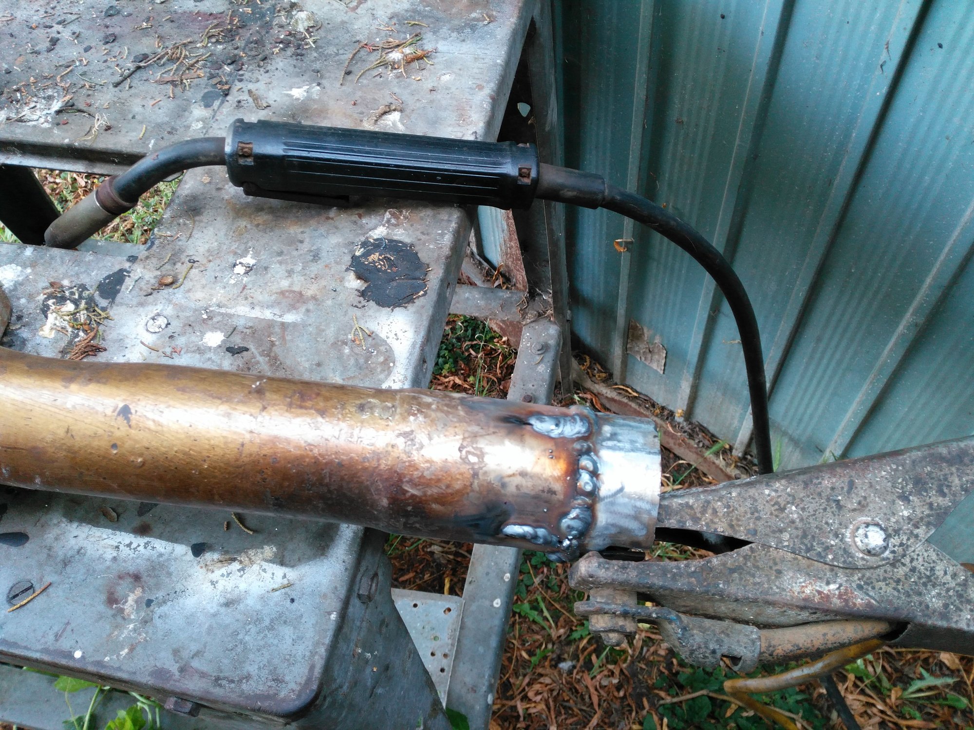

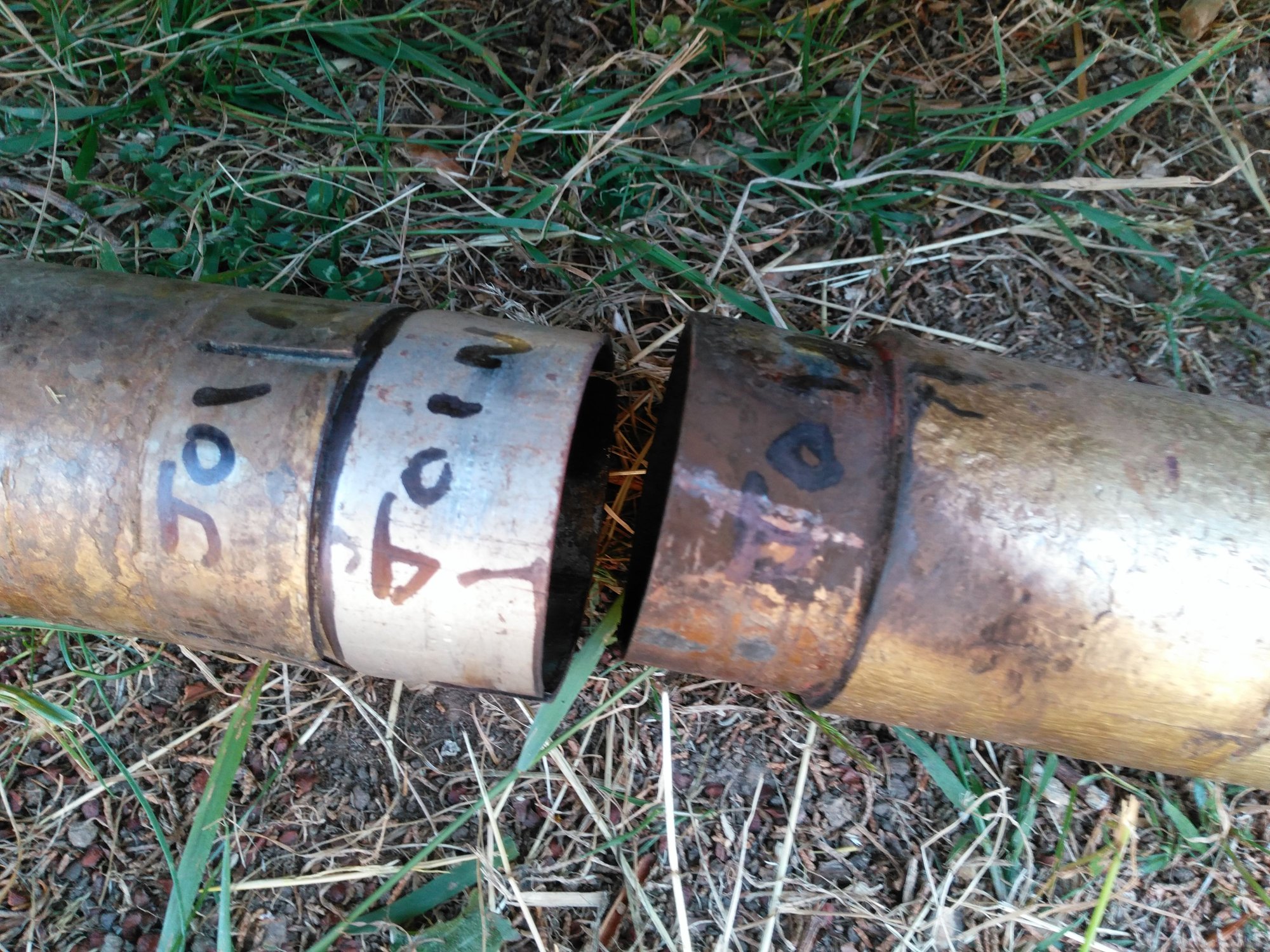

Exhaust Bodge Fixed At Last!
Today I managed to do a Job that has been on the 'Back Burner' longer that I ever care to remember, which was Fixing the 'Droopy Exhaust Pipe' on 50 Shades, my Grey XJS and all down to a bodge up by either the previous owner or the Shop he took it to
If you think that looks 'Crazy' then you ain't seen nothing yet! Just wait till I take it apart

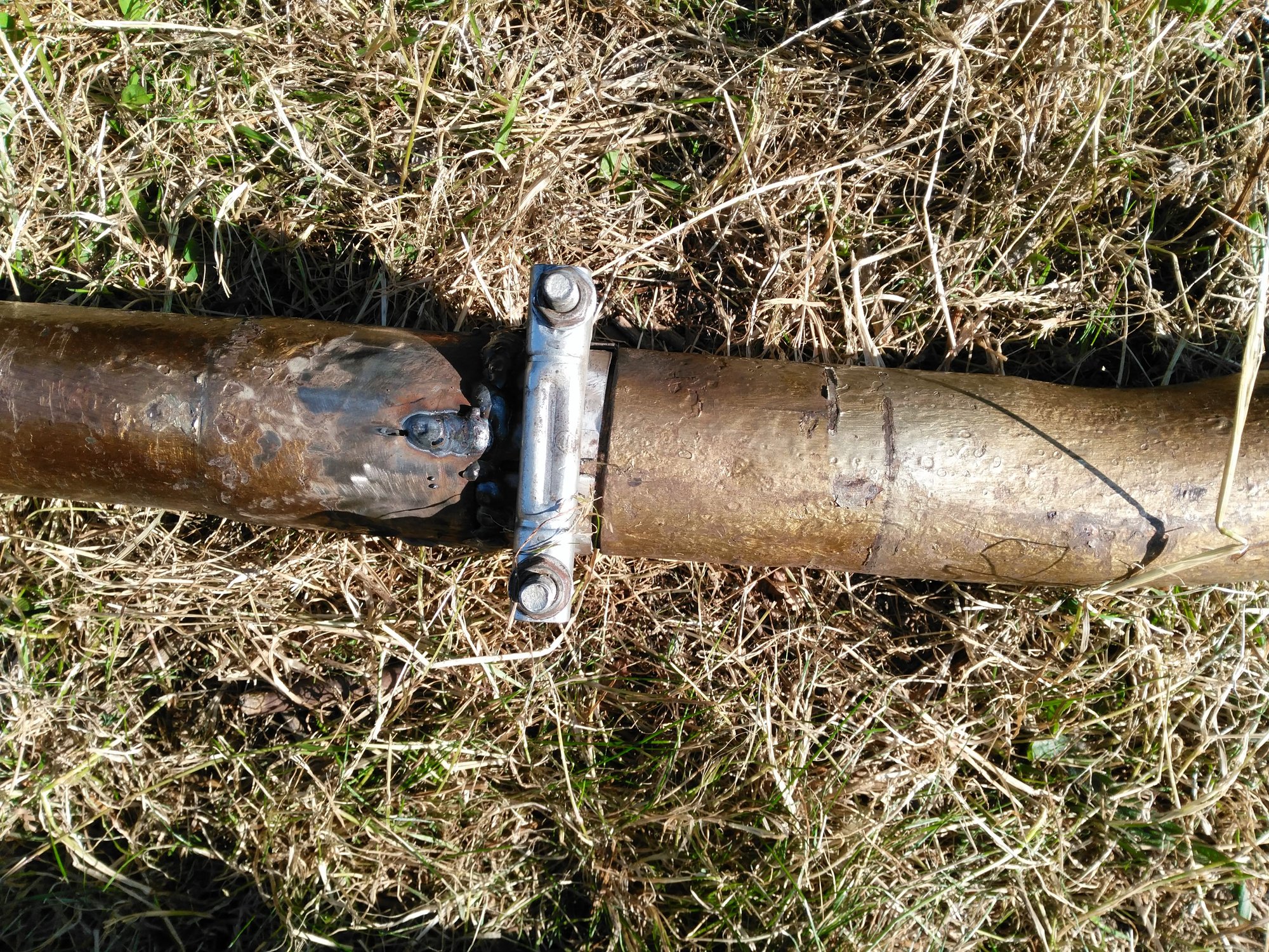

This Exhaust Pipe was joined in Two places by Clamps, instead of just the One so maybe not so surprising that it 'Drooped' as much as it did 'What were they thinking'
And come to think of it what was I thinking to put this job off for so long, as there were occasions when the Exhaust would bottom out, which could have torn it straight out of the Car 'No Skills and No Welding Set' is my one and only excuse and I didn't want to take her to a Shop
Having 'Migged' one joint up, it should go on with One Clamp, instead of that 'Crazy Contraption' that held it all together underneath
Trial Fitting the Exhaust Joint, which seemed to be ok
Holding the Exhaust in place, while I did up the Clamp
Looking Good, as the Exhaust Pipe I repaired is now higher that the original one on the other side of the Car, which will probably drop down to match after a bit of a run out in the Car, this repair took half a day but would have been a lot quicker if only my Car Lifter had been free

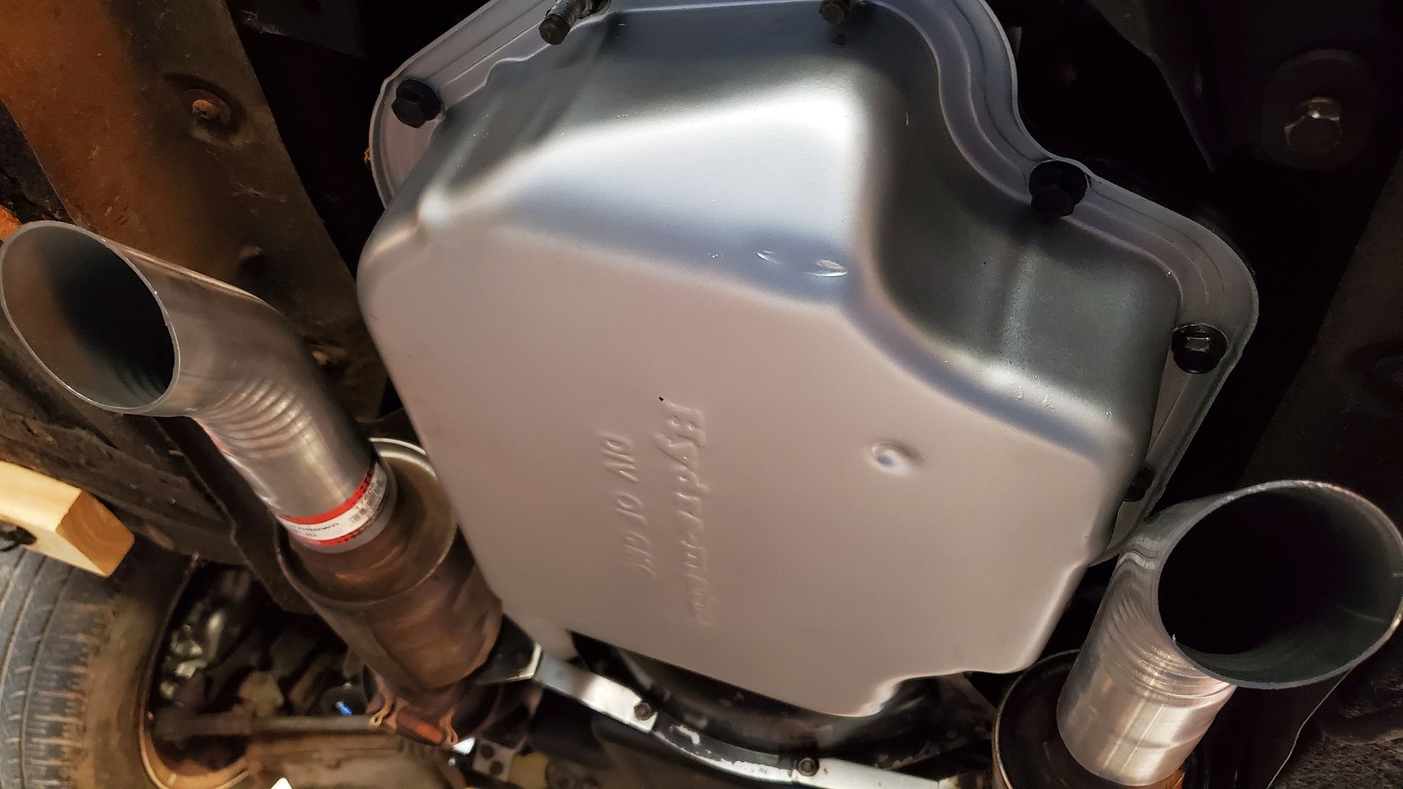

my exhaust fix for now lol. Someday I'll get a welder lol. For now the nieghbours can listen haha.

I'll do a video maybe this afternoon once I'm home. Gotta check for vacuum leak anyways.
My plan is to have 1 xpipe muffler installed and the exhaust exit in front of rear wheels with flat tips.

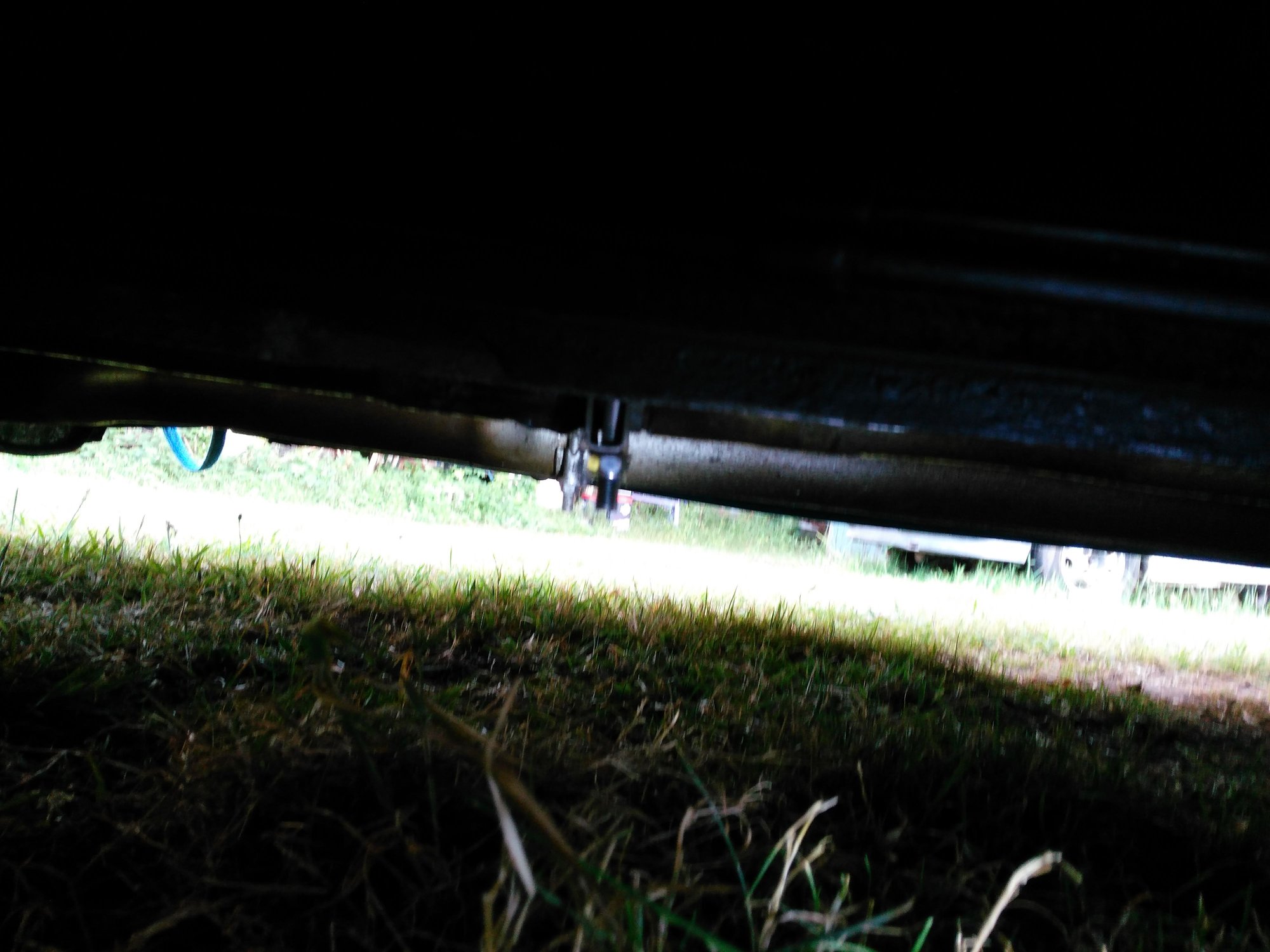

Acceleration Hesitation!

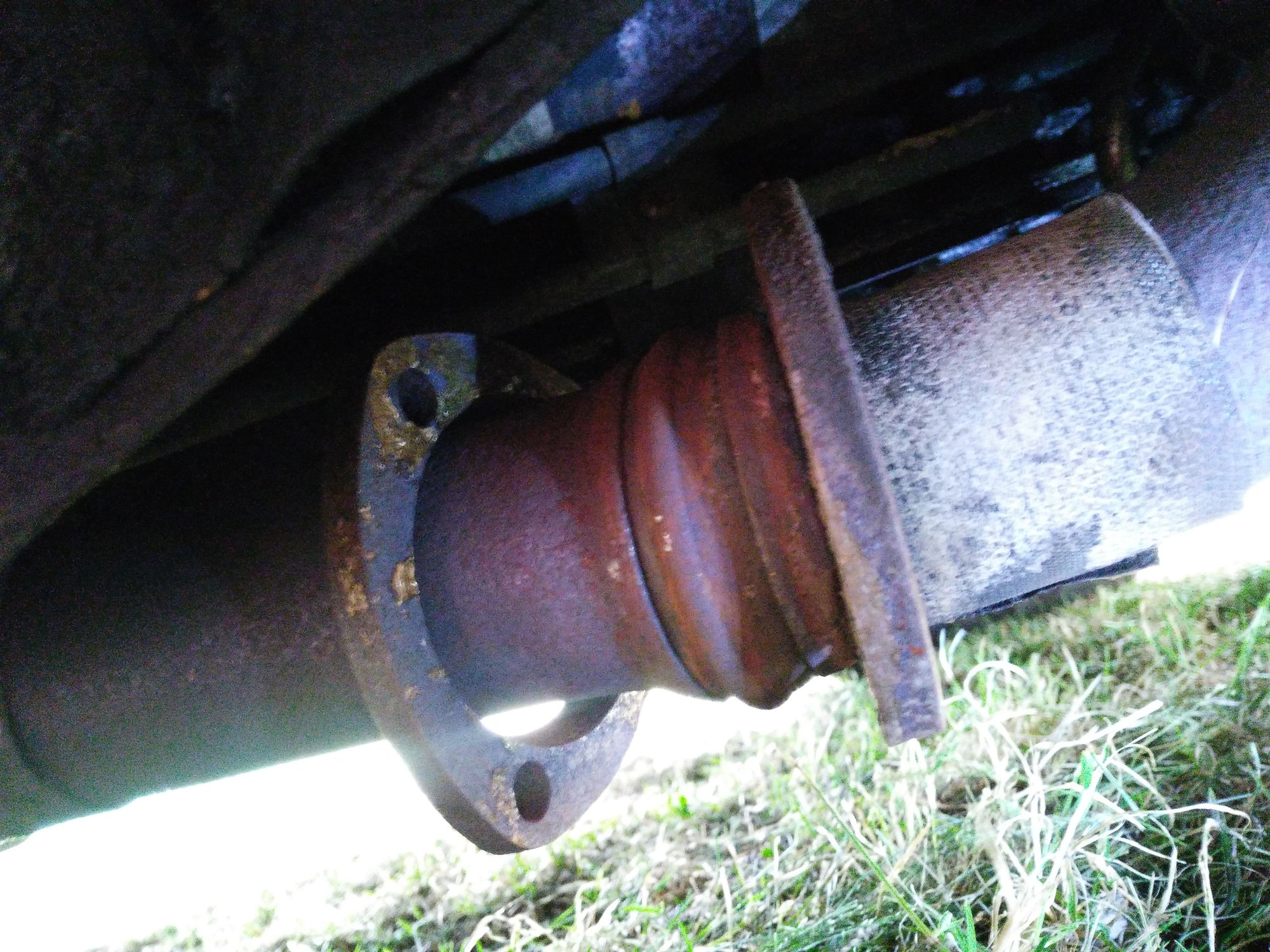

Having Finally Fixed the Bodge on the 'Droopy' Exhaust Pipe of '50 Shades' my Grey XJS I thought that I would take her for a 'B' Roads Test drive just to see if the Exhaust would hold up without falling apart
Before!
After: where the 'Droopy' Exhaust Pipe (nearest in the Pic) went back even better than the OEM so what could possibly go wrong!
Having now Fixed the 'Droopy' Exhaust and when I Started Her up, the first thing that I noticed was a Change in the Exhaust Note, which was a bit more of a Roar than a Purr although apart from that things seemed quite normal, until that is I took her on the road!
Where when trying to accelerate from a Standing Start, instead of the Smooth Take Off I was used to, the Engine seemed to misfire for a micro second just like I was hitting a flat spot in the power curve, only very minor and hardly noticeable but all the same that hesitation was there

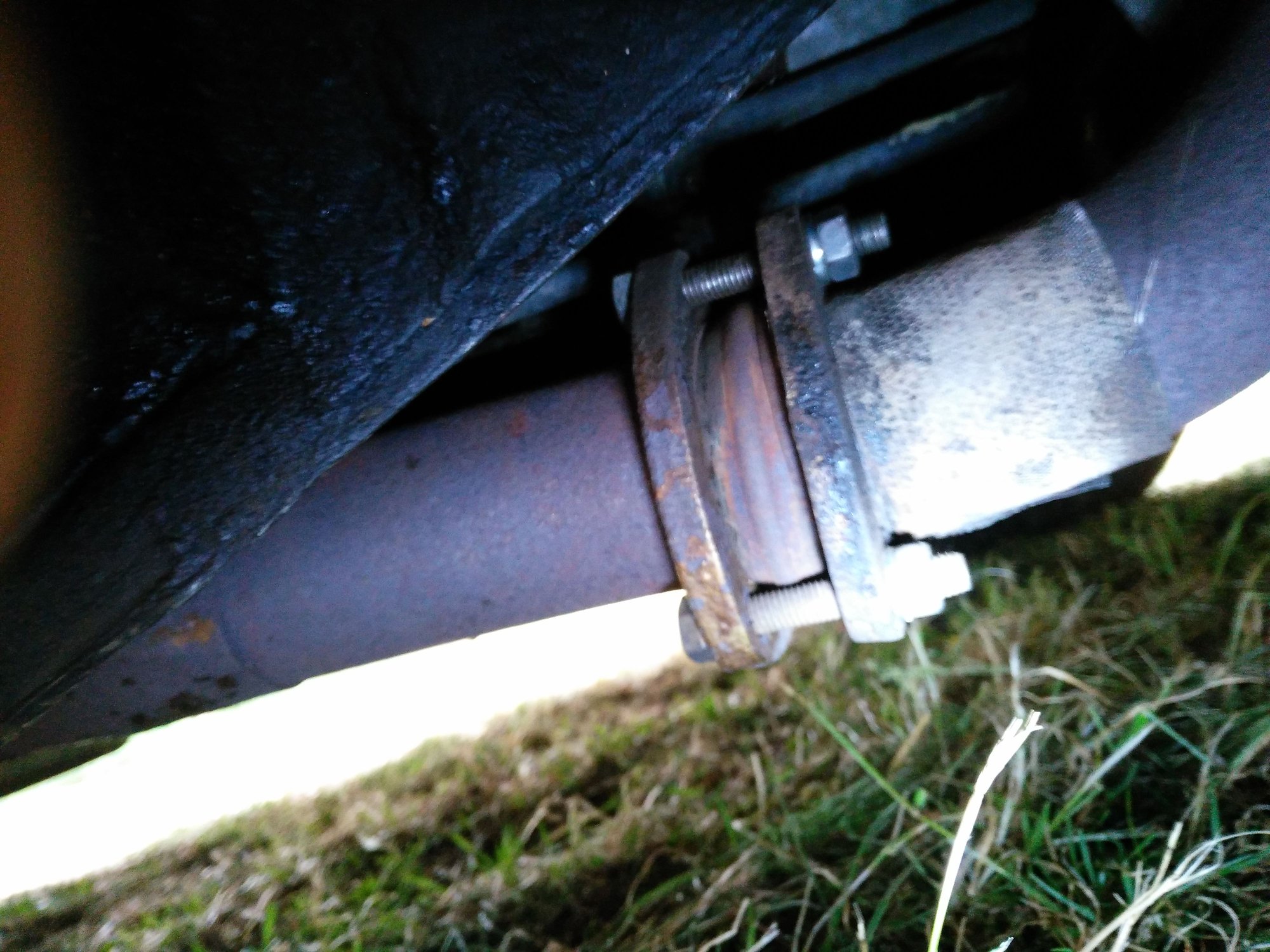

So back to Base to take another look, where upon inspection I could clearly see that I had put the Sealing Ring in Crooked
The Crooked Sealing Ring was the cause of the problem but even so who would have thought it could make that much difference, apparently Not Me!
Lining up the Exhaust Pipe on an XJS is not exactly a 'Walk in the Park' to get perfect
After much Jacking and Pushing and Shoving, I finally got it lined up and the Acceleration Hesitation Vanished!
So if that happens on your Car, the Exhaust System could be a good place to look

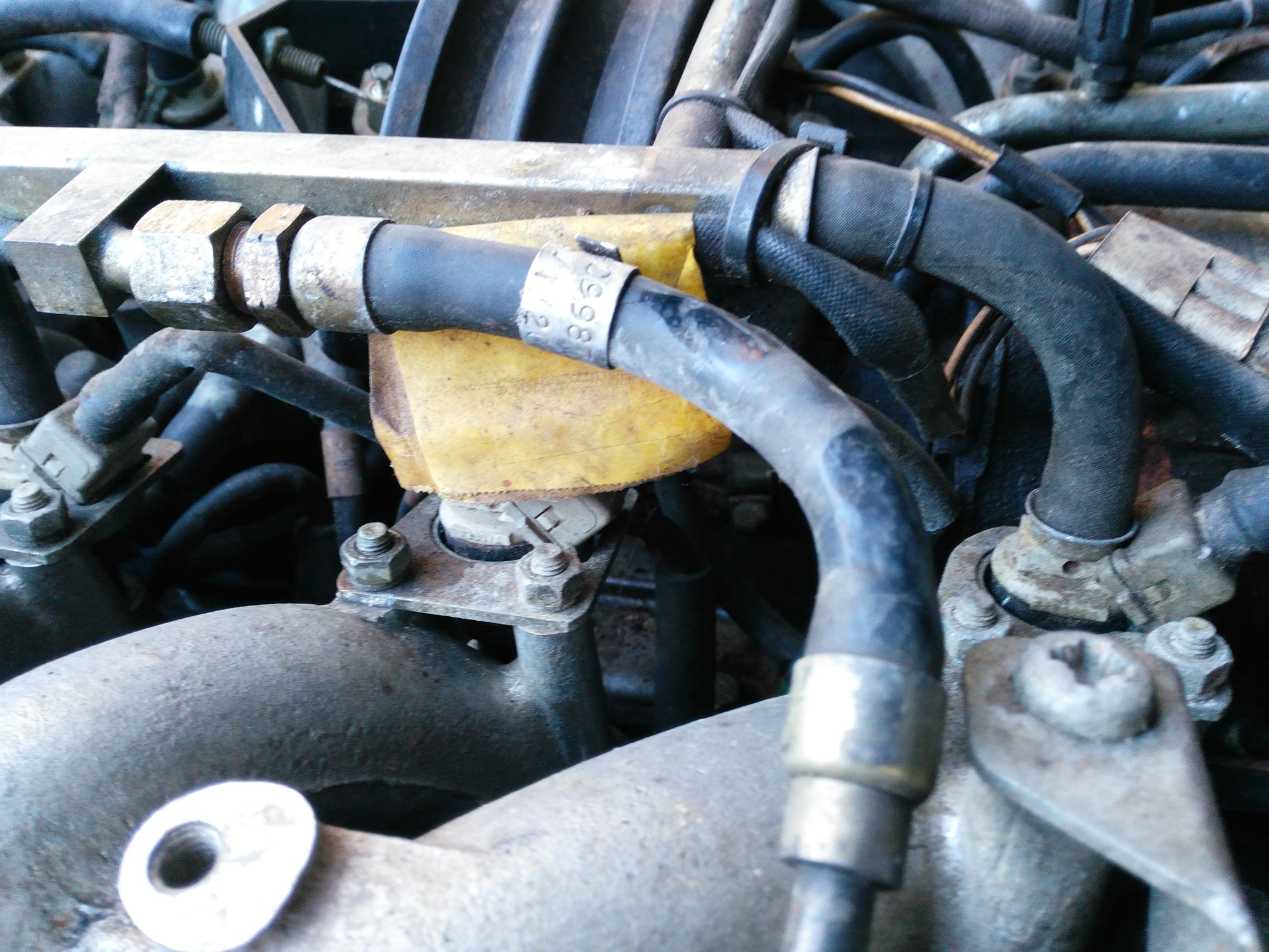

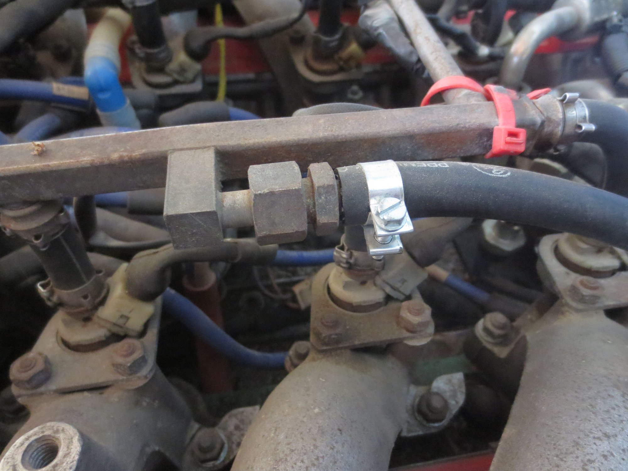

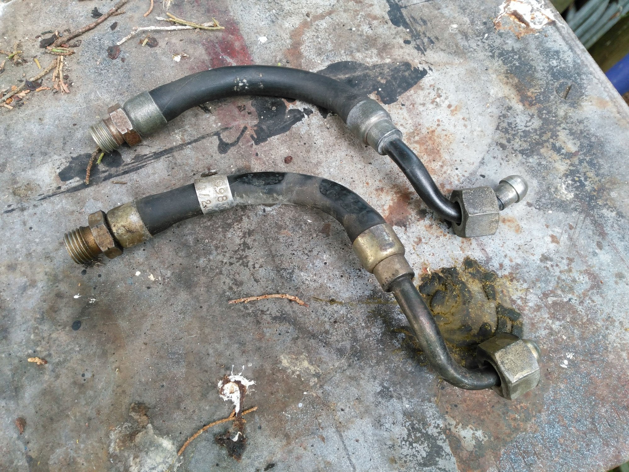

But when We got home, I realised that our grand day out, could have easily ended in disaster, as while collectively helping another Forum to get their XJS back on the Road, Doug came out with what I thought was a really great suggestion which was to test the fuel pressure on the Engine side of 'A' Bank FPR
At which point I thought I'd take a Photo to clarify that Area on my own Car '50 Shades' which I didn't take much notice of to start with, as I just took that Photo and put it in that Post
And here it is:
Look just to the right of that metal clip after that Top red Arrow That hose has been nearly cut through!
No Prizes for guessing what could have easily happened and no doubt would have done so any time soon but thankfully I also had a Spare one in the Shop, that I must have collected on a visit to a Scrapyard, as I thought that one day it might just come in useful and 'It did!'
So bad it looks as if it had been Weeping, which no doubt is what I would have done if '50 Shades' had gone up in Flames!

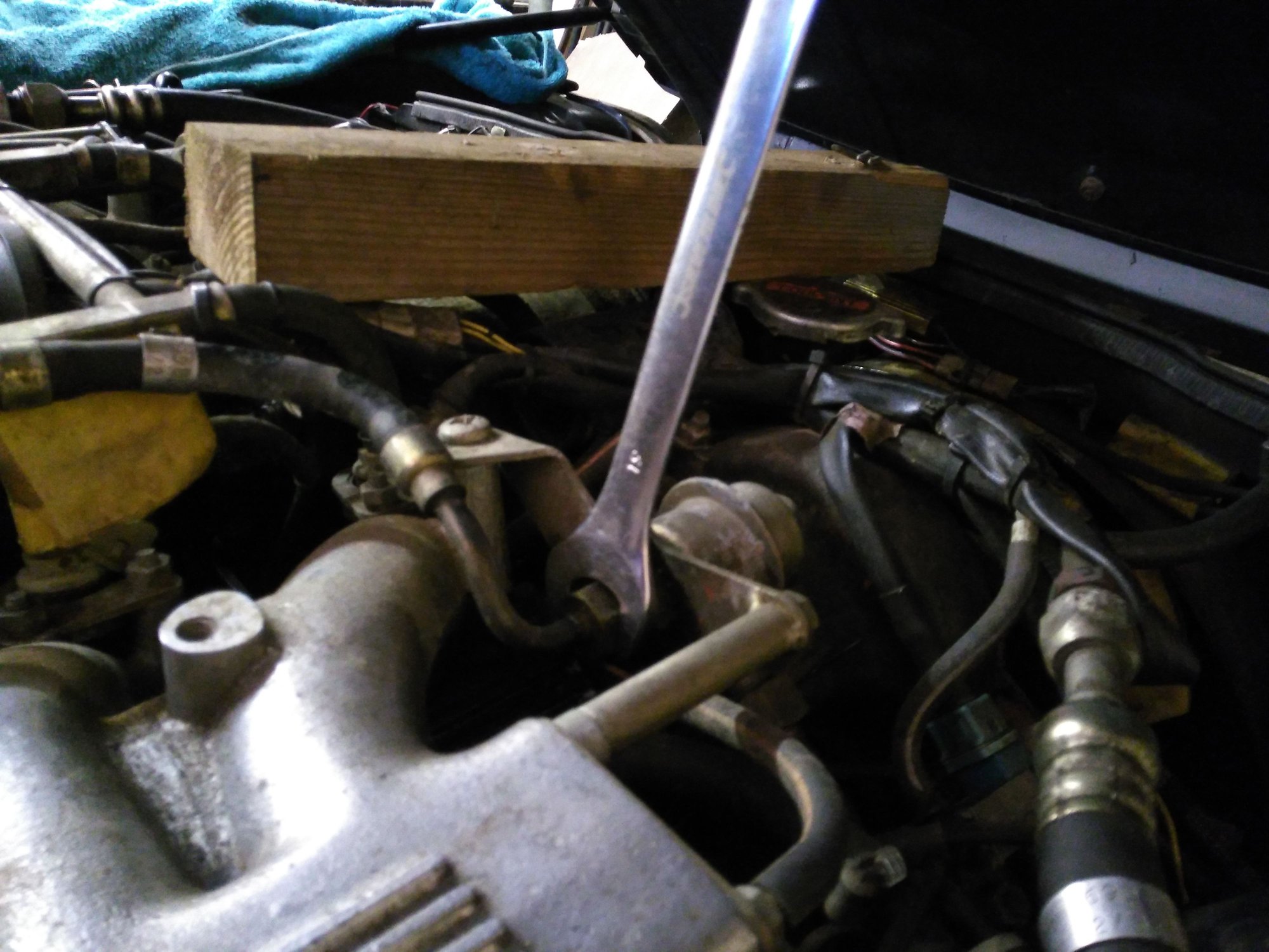

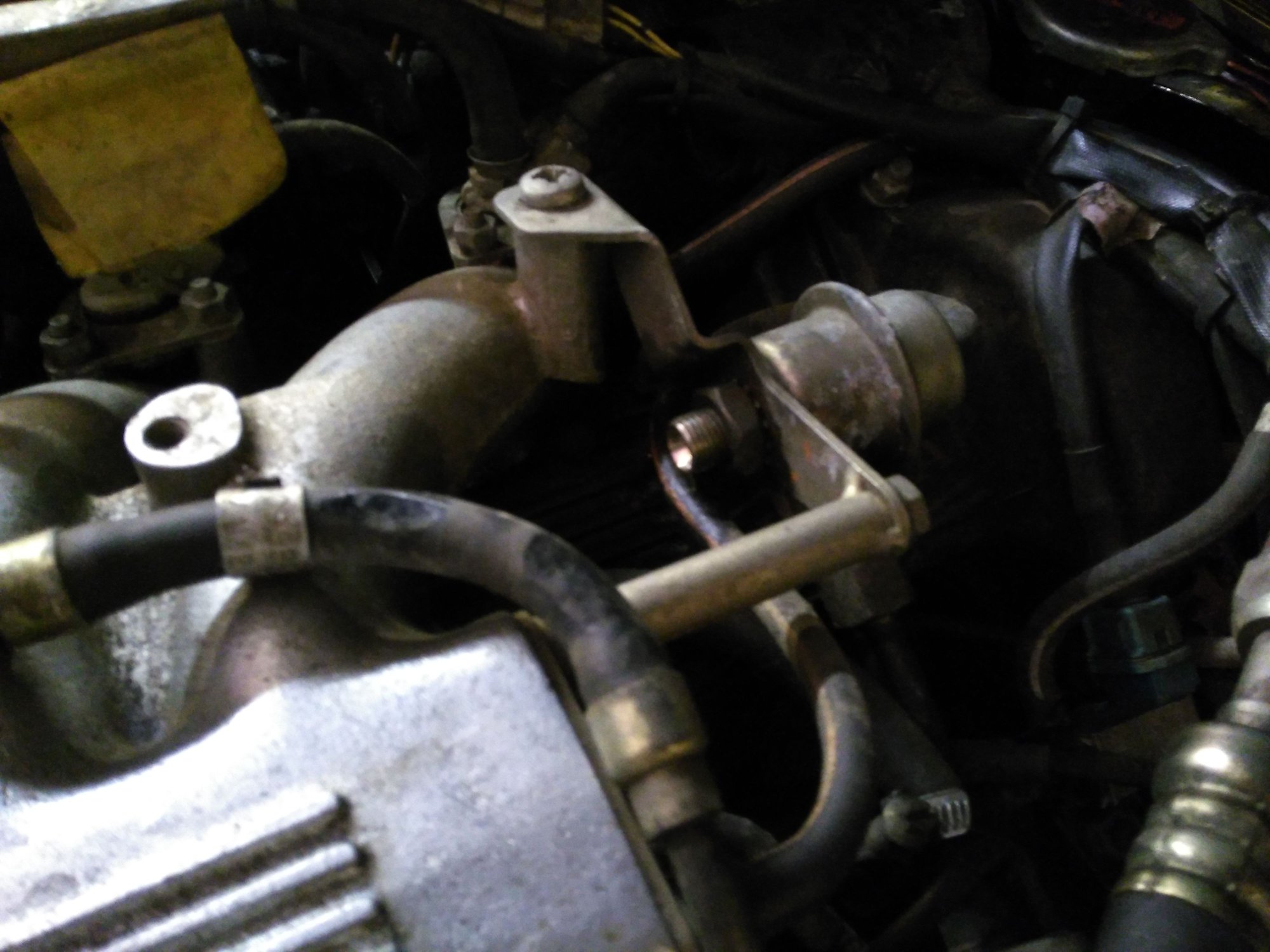

Counter Torquing the Connection that was really hard to undo!
Got it off at last!
The one on the 'A' Bank FPR came undone quite easy

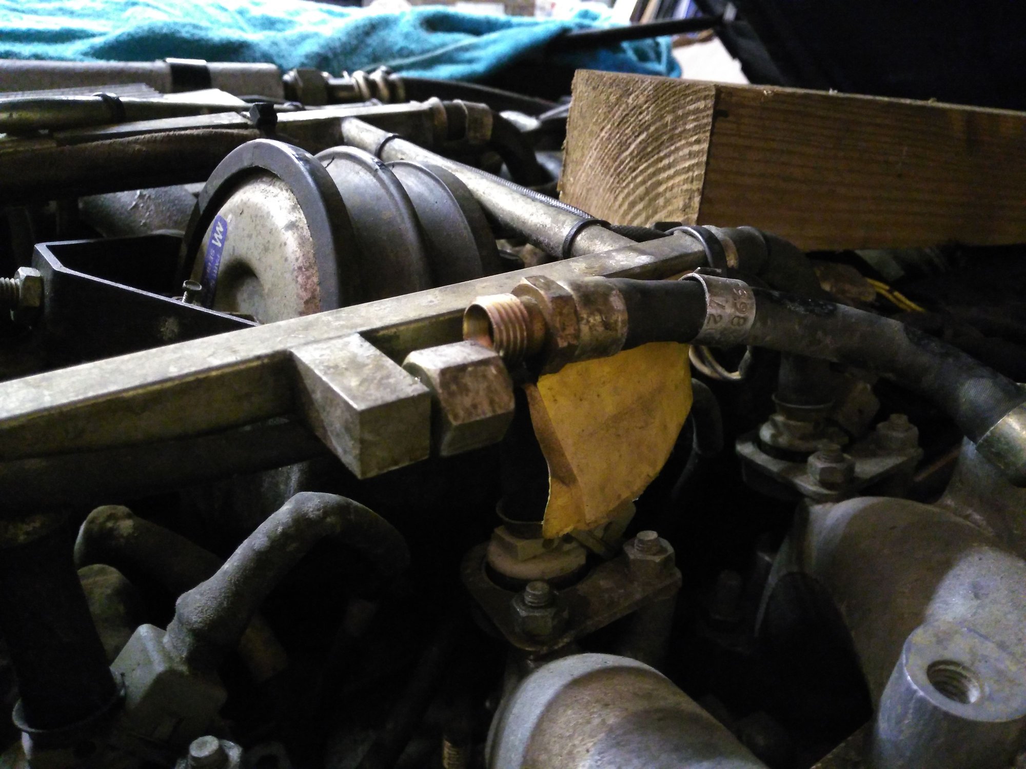

Yikes! it looks even badder from this angle
Spare Pipe ready to go back and having put it on, I then made a Short Video to convince myself it wasn't leaking!
So Massive Thanks to 'Doug' for Saving my Car from potential disaster!
Click: Video Link Below

Old Jun 22, 2020 | 04:49 AM
  #2251
Greg in France's Avatar
Posts: 14,611
Likes: 10,809
From: France
Ob
Do you mean those scalloped-out longish shapes in the hose?
If so, pop dobs of grease on the hew one and close the bonnet tight. Then open and look for grease on the bonnet, just to be sure they problem is not caused by something rubbing on the pipe.
Old Jun 22, 2020 | 05:59 AM
  #2252
orangeblossom's Avatar
Joined: Feb 2013
Posts: 17,809
Likes: 3,945
Hi Greg
Cheers!
I never thought of that!
Could well be some sort of abrasion as you said
But when I take the Car off the Road in November, I am planning to replace all of the Injector and Fuel Hoses and also Cut out the FPR on 'A' Bank even though She is running quite happily with it Connected
I can get my Hydraulic Shop to make me up a Pipe, with Two Female ends to 'Bridge the Gap'
Would that be the Best way to go?
Old Jun 22, 2020 | 06:48 AM
  #2253
Posts: 14,611
Likes: 10,809
From: France
Originally Posted by orangeblossom
Hi Greg
Cheers!
When i deleted my A bank FPR I took a flexible directly from the inlet barb on the hard line where it comes into the engine bay to the rail fitting. You carefully cut off the swage on the rail end of the hose you have the problem with, and underneath it you find a barb that you fit into the end of the flexible with a hose clip to hold it. use the best Gates Fuel Injection 25 bar hose though, CBS should have it, but specify that is what you want. Pics herewith:
Old Jun 22, 2020 | 07:09 AM
  #2254
Joined: Feb 2013
Posts: 17,809
Likes: 3,945
Hi Greg
Okay Thanks
Do you have the size of the Top Quality (Gates) Injector Hose that I am going to need as my Hydraulic Shop has a special machine to cut it to length rather than pay £100 for a Kit
Old Jun 22, 2020 | 09:07 AM
  #2255
Posts: 14,611
Likes: 10,809
From: France
OB, the hose ID I forget, sorry. But there are no special tools needed, just cut it with a knife. Both ends just push onto barbs with hose clips as in my photo. If you are getting a swaged hose made up as you originally mentioned, then the place doing it can measure the ID you need. But it has to be petrol proof hose. If you are supplying the hose to them, cut the old one in half and measure! Then buy what you need.
Old Jun 22, 2020 | 04:24 PM
  #2256
Joined: Feb 2013
Posts: 17,809
Likes: 3,945
Hi Greg
Cheers!
But I think that getting a Hose made up might be the easier option in my case, as then I can leave the disused 'A' Bank FPR in place as it is
Stop me if I am doing this wrong but when I replace the Injector Hoses, can I do this without the need to remove the Injectors by cutting them through half way up and then removing the Fuel Rail
Then Carefully cutting what's left of the Pipes off both the Fuel Rail and the Injectors and then putting all New Injector Pipes on the Fuel Rail and then pushing the Fuel Rail with the New Pipes, back onto the Injectors which will still be in place in the Car
Old Jun 25, 2020 | 10:05 PM

Its FPR which is the Fuel Pressure Regulator
The only one that's needed is the one on 'B' Bank and the other one on 'A' Bank can be taken out of the Circuit as it isn't needed and the later Cars don't have them
The Fuel Pressure Regulator has a Rubber diaphragm which acts like a 'Dam' that holds back the Fuel in the Rail until the Correct Fuel Pressure is achieved before releasing any excess back into the Fuel Tank, as I'm sure you know, so just throwing that out there for any newbies
Old Jun 26, 2020 | 12:23 AM
  #2259
Posts: 14,611
Likes: 10,809
From: France
You could, but it might be tricky to ensure you did not hurt the sealing surface barbs on the injectors.
My real point is that if the hoses are shot, so will be the seals the injectors push into, so in your place I would pull one injector at a time and do all the seals, change the little basket filters in the injector inlets, if they need it.
