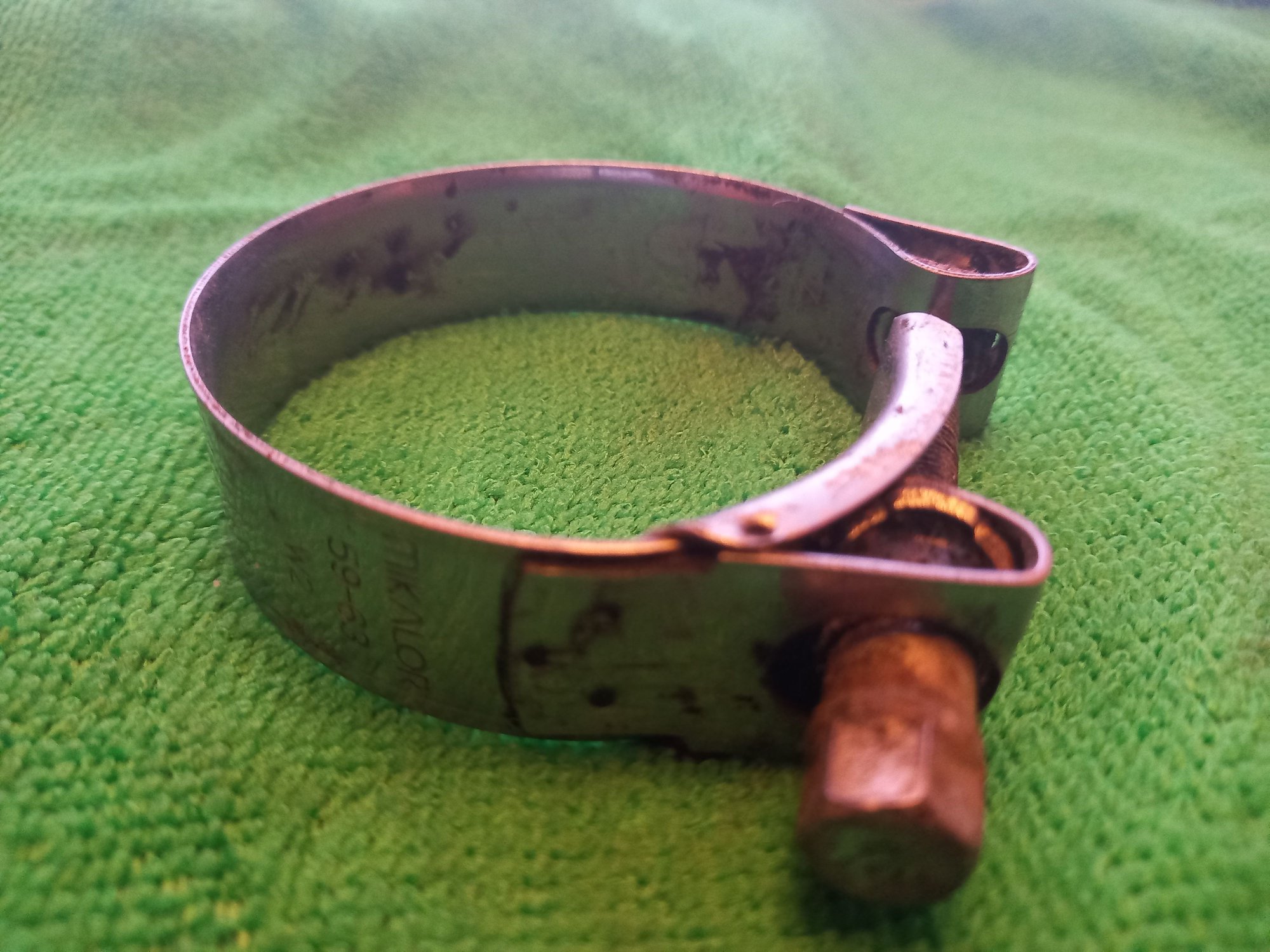

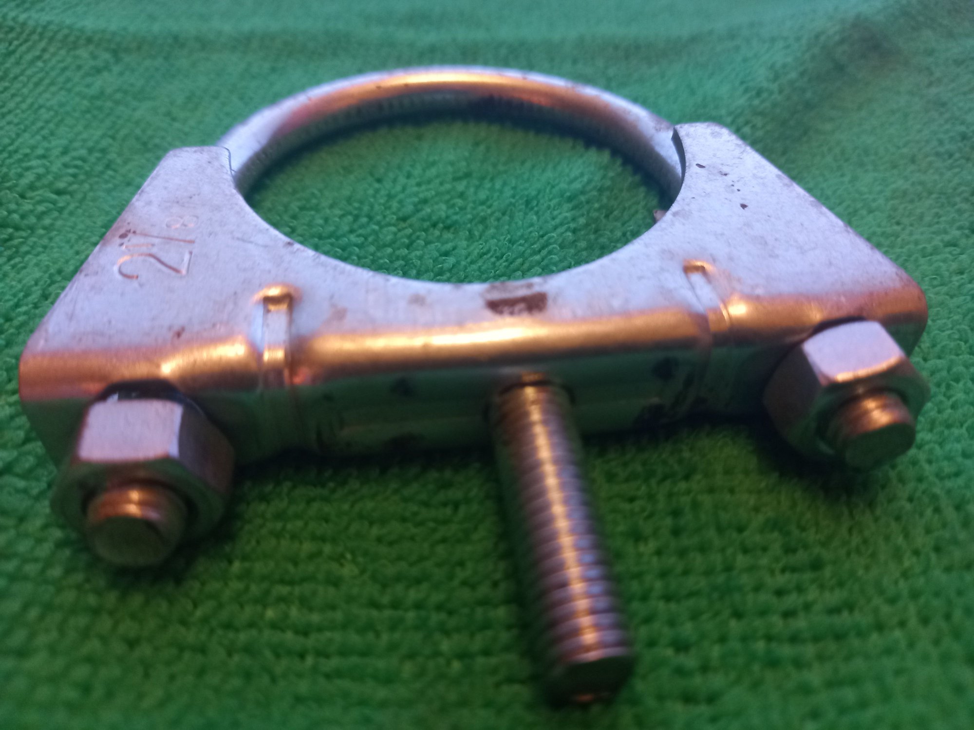

Lining up those exhaust Pipes is not my favorite job, for as soon as you get the Pipe in place, it's then that you suddenly realize that the bit with the bend is nearly touching the drive shaft
I think those Clips in Photo (Top) could well be the problem, as they may look nice but they don't seem to have any grip
While the more industrial 'U' Bolt shown in the Photo below that, should help to Stop that Exhaust Box from sliding around

Ohh, Alex, I Ditched those Very Pretty ring clamps soon after I got the car.
She now has U-clamps on all joints, ugly as they are, but they Stay Put!
It's just that I need to jack her up, loosen all clamps, set a bottle jack under the last upward curve and pump it up until I begin to raise the car, wiggling the pipes and forcing the joints together. Then clamp it SO tight!
Every time I set them up this way, Nary a rattle or even peep... until the next time I have muffler work done.

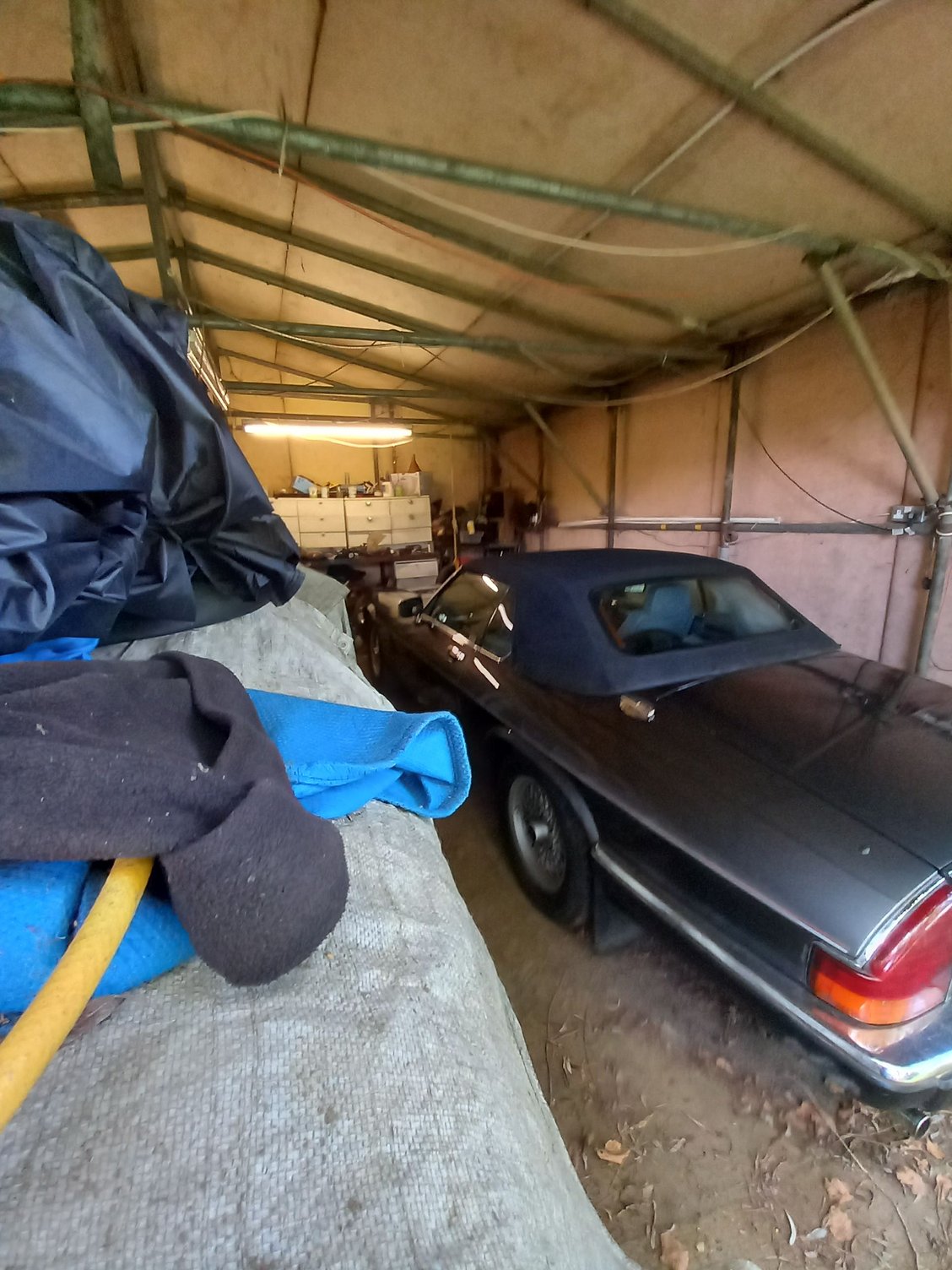

So the GF went off in the MAZDA to do the Shopping on her own and I picked up some Tools and went into the Garage, where having first opened the door and put the Lights on

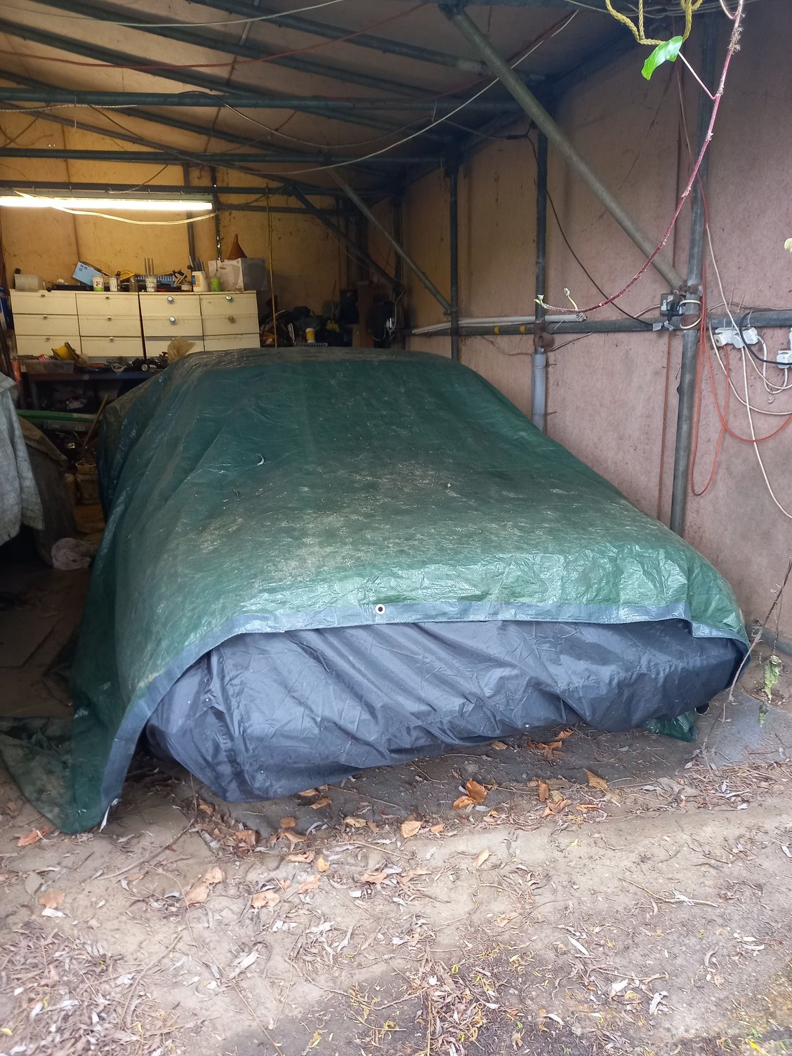

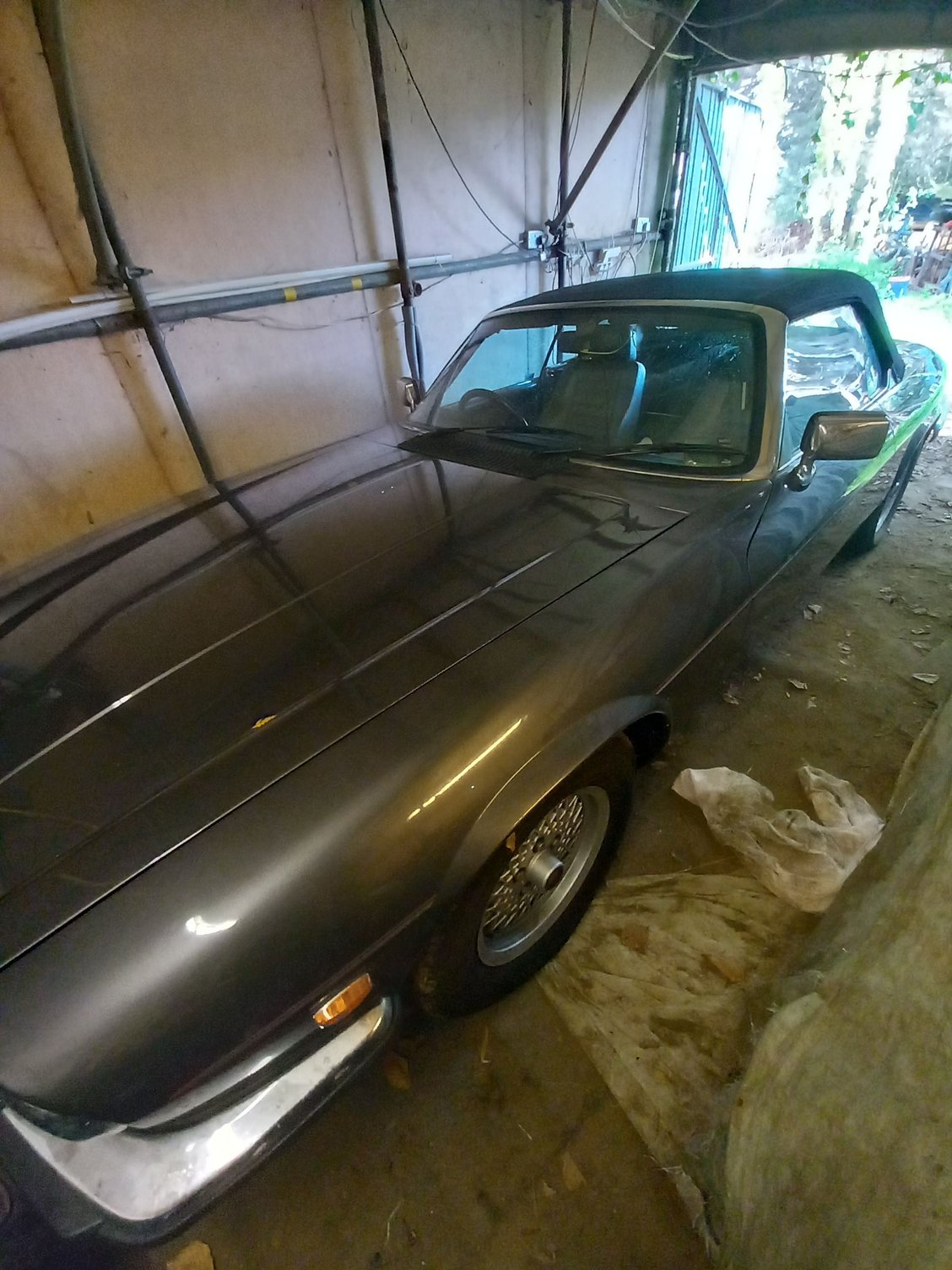

The First thing I saw was '50 Shades' my Grey XJS laying there under her Covers, where She had been hunkered down ever since last year and to be honest last year was a bit of a disaster, in every possible way you could imagine including the Cost of Petrol that had suddenly gone through the Roof!
And then on Top of that the Credit Crunch! where you needed a Second Mortgage to buy a Bottle of Milk, that had gone from £1-15 to £1-65 for a 4 pint bottle and in doing so had taken every thing else with it including 240 Tea Bags at £5-60 a Box! instead of the previous £3-50p
This was the New Normal, as once those prices had gone up they were non coming down and putting on the Washing Machine was now so expensive, that it was actually cheaper to go and buy New Clothes
And if that wasn't bad enough no one was using their Cars and my ISP had gone and doubled the price of our Internet from almost £40 per month to £80! and there's no way that I was doing that, and so my Friends, I decided to dump them and find another Company to give my money to
As already unbeknown to them I had a 'Cunning Plan' as now I am paying the Princely sum of £4-50 per month! and 'No that's NOT a Miss print! it's £4-50
So Stand by for a Magazine Article, where I will be showing everyone how to do it. as my ISP can Whistle in the Wind!
But now back to the Plot, with me standing there Gazing in Awe! at my wonderful Car that was still covered up, so as they say on YouTube, it's time to do some unboxing and see what is under those Covers
Already I'm thinking 'Yikes' that's a really long Car!

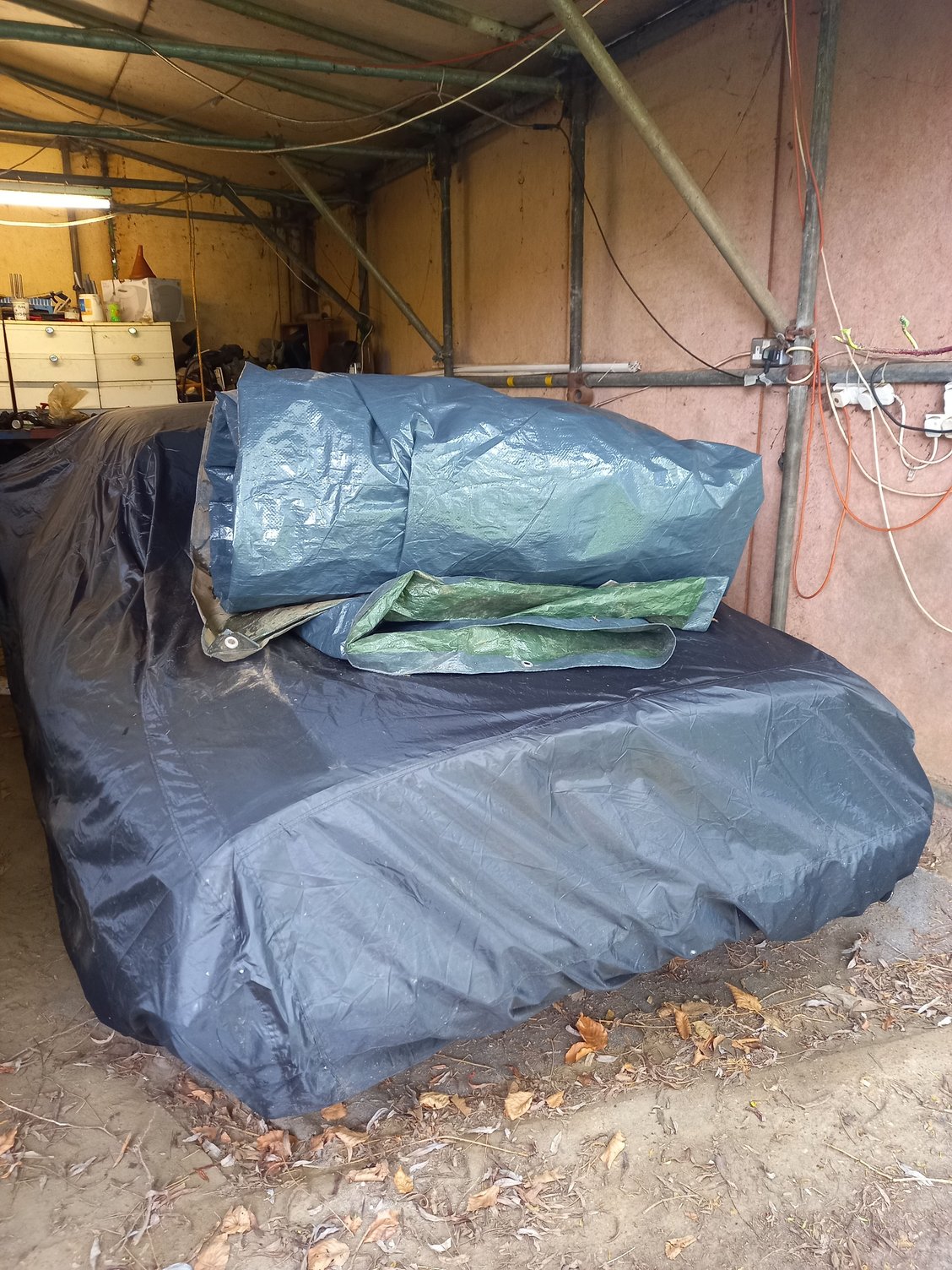

Off comes her Winter Cover and already I'm feeling excited like a Kid at Christmas!
Oh! Yeah Baby! that's what were talking about!
Overcome with emotion, I'm having to hold back the Tears! as She just sits there looking 'Drop Dead Gorgeous'
It's been a long time coming and to tell the Truth, I don't know what to do!
Though Slowly but Surely it's all coming back to me now! 'The Pre-Flight Checks' even though there's work to do before She goes back on the Road

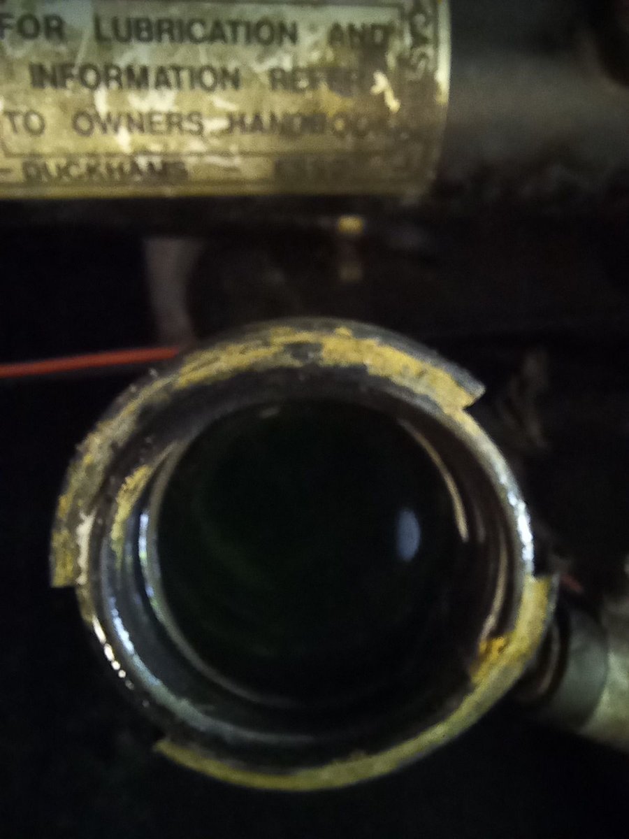

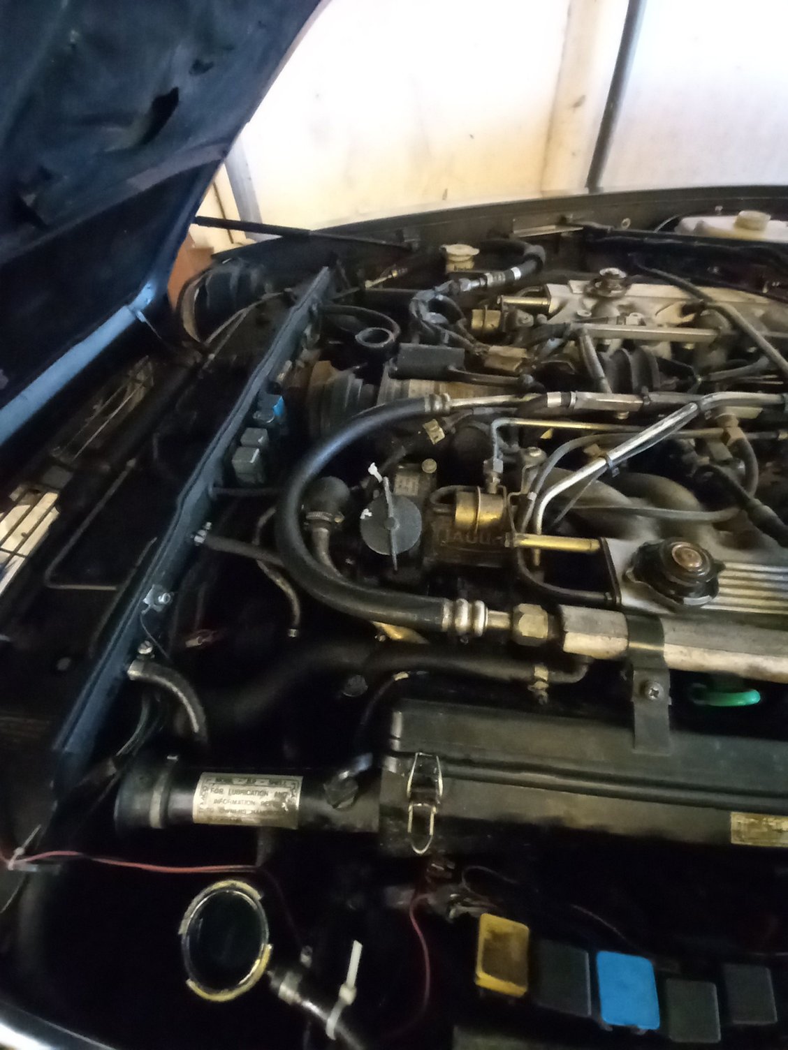

And so the First Job is to Check the 'Coolant' with both Caps off, as I'm thinking it must be low after standing all this time
At least I've still got an Engine! so that's a good start if She Starts?
Oh! my days! as they say on 'Tik Tok' She's still full to the Brim!

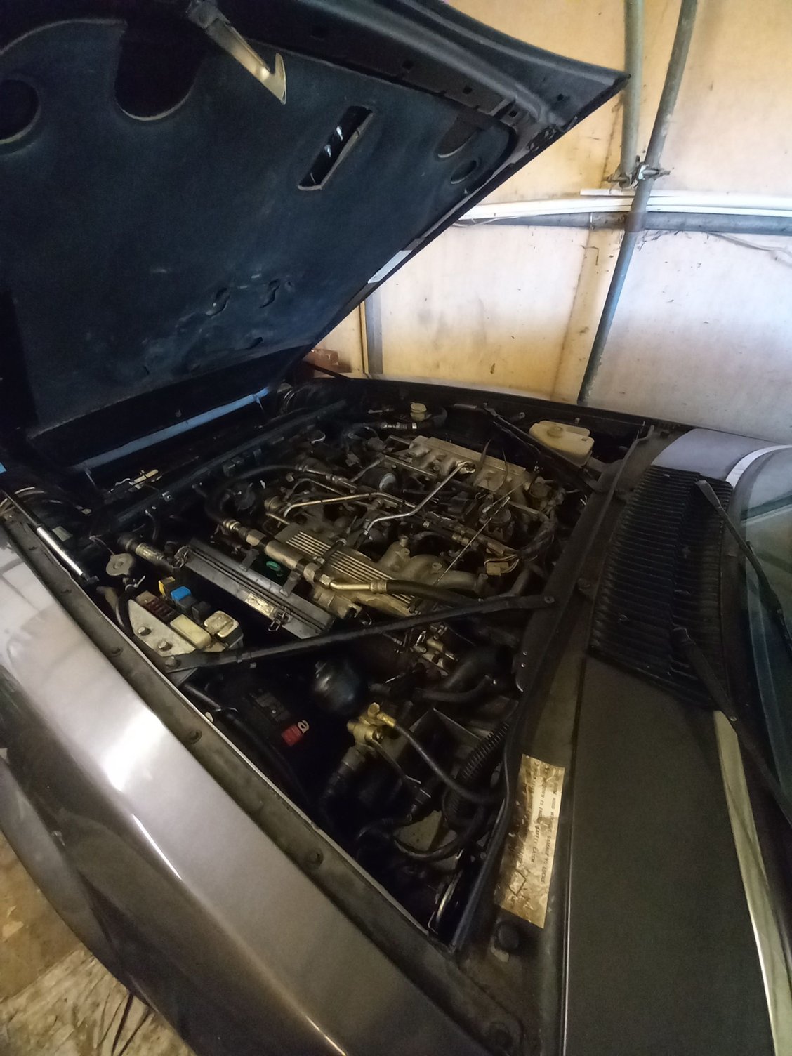

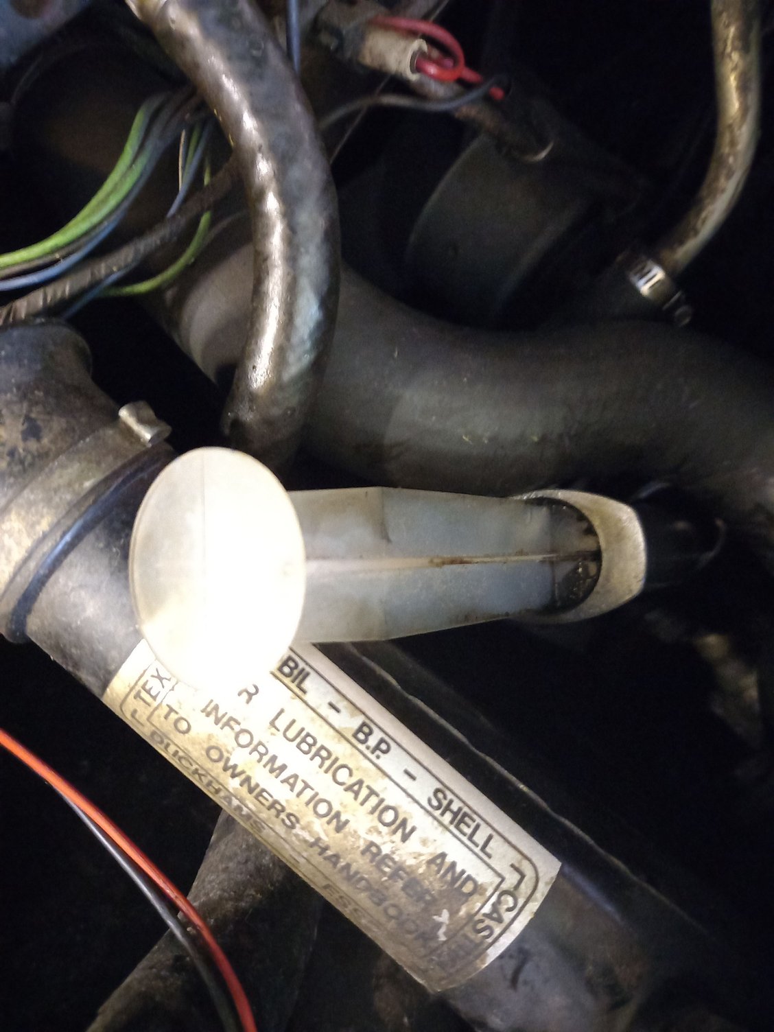

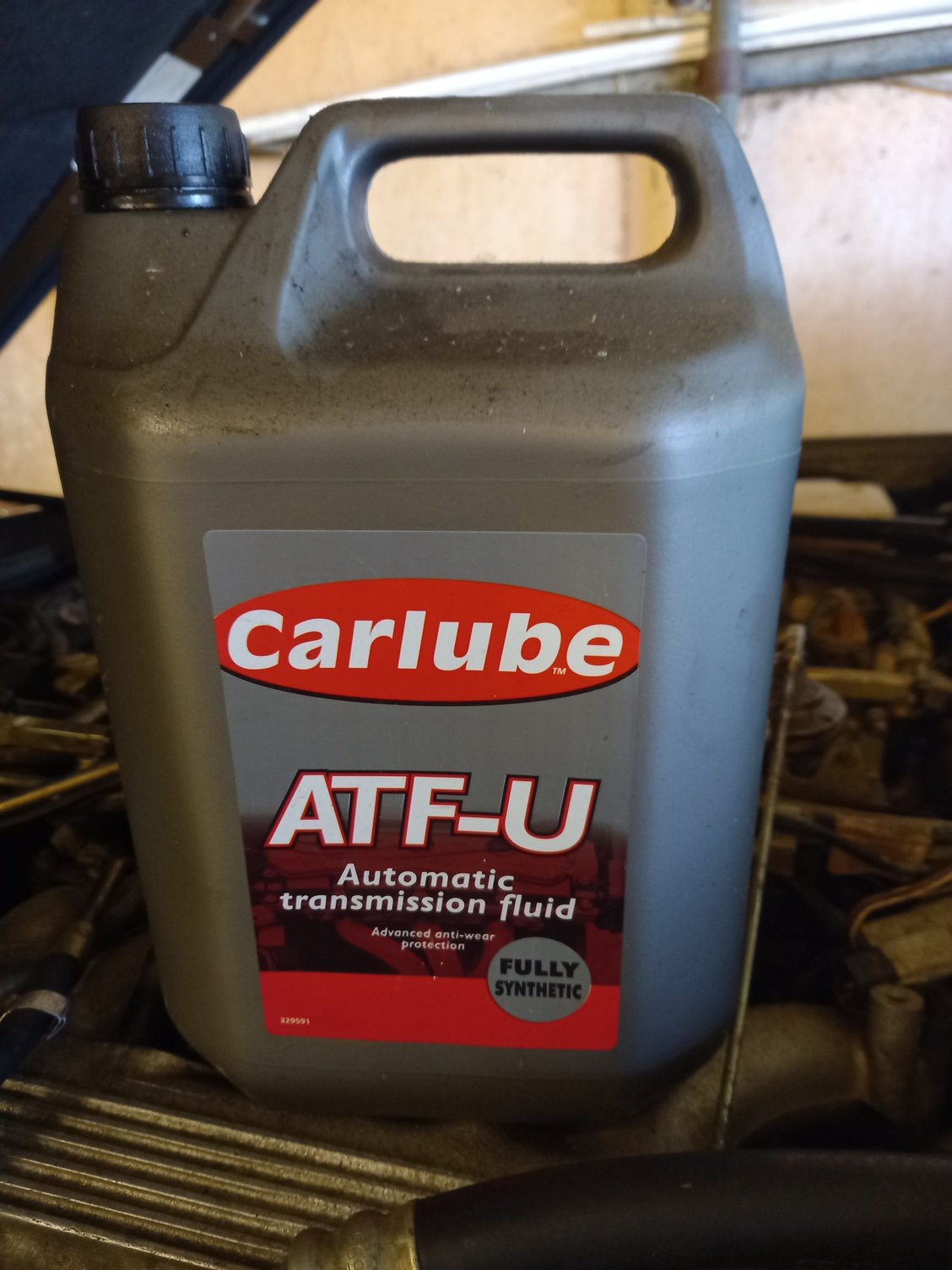

Although unfortunately cannot say the same for the Power Steering, as the Reservoir was empty! 'Been there done that, it's what I was expecting and so its not Freaking me out, so just have to keep an eye on it and Top it up every Trip until my ramp is free again

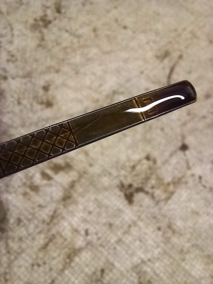

Engine Oil also up to the Mark but looks a bit like it needs Changing
Power Steering Reservoir has run dry, so time to Top it Up (or do I mean refill it?) Yeah I think I do!
As recommended by 'Grant' as it helps to Stop leaks!
Using a Syringe to Refill the Reservoir, dead easy doing it this way, as you can rest the outer edge on the Rim, as you Squirt it in and I had to do this four times to fill it right up to the Mark

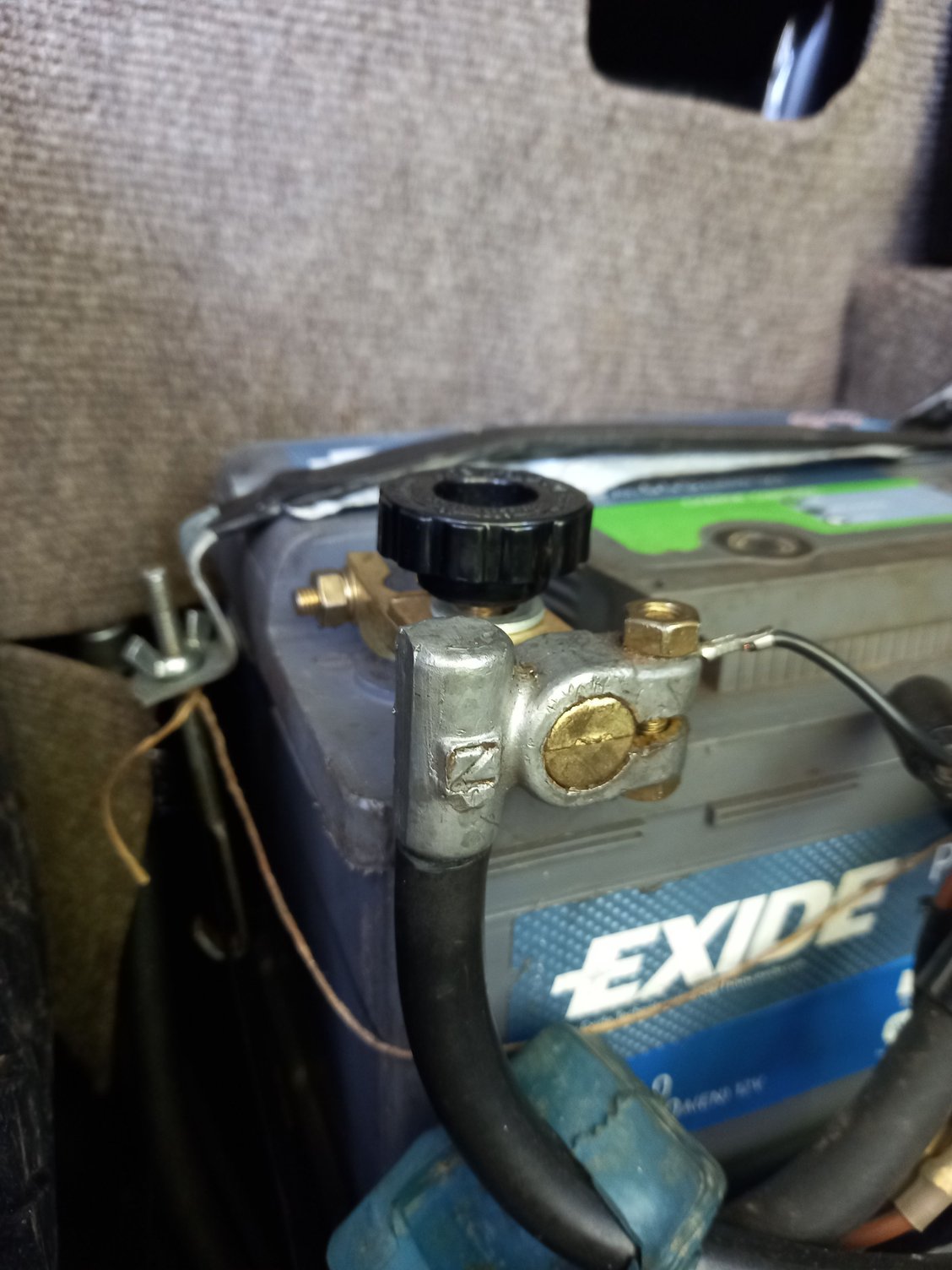

No 'Battery Tender' No nothing! all I use is a Battery Discarnect that I got off ebay for less than a Fiver and that Battery has never lost Power Yet

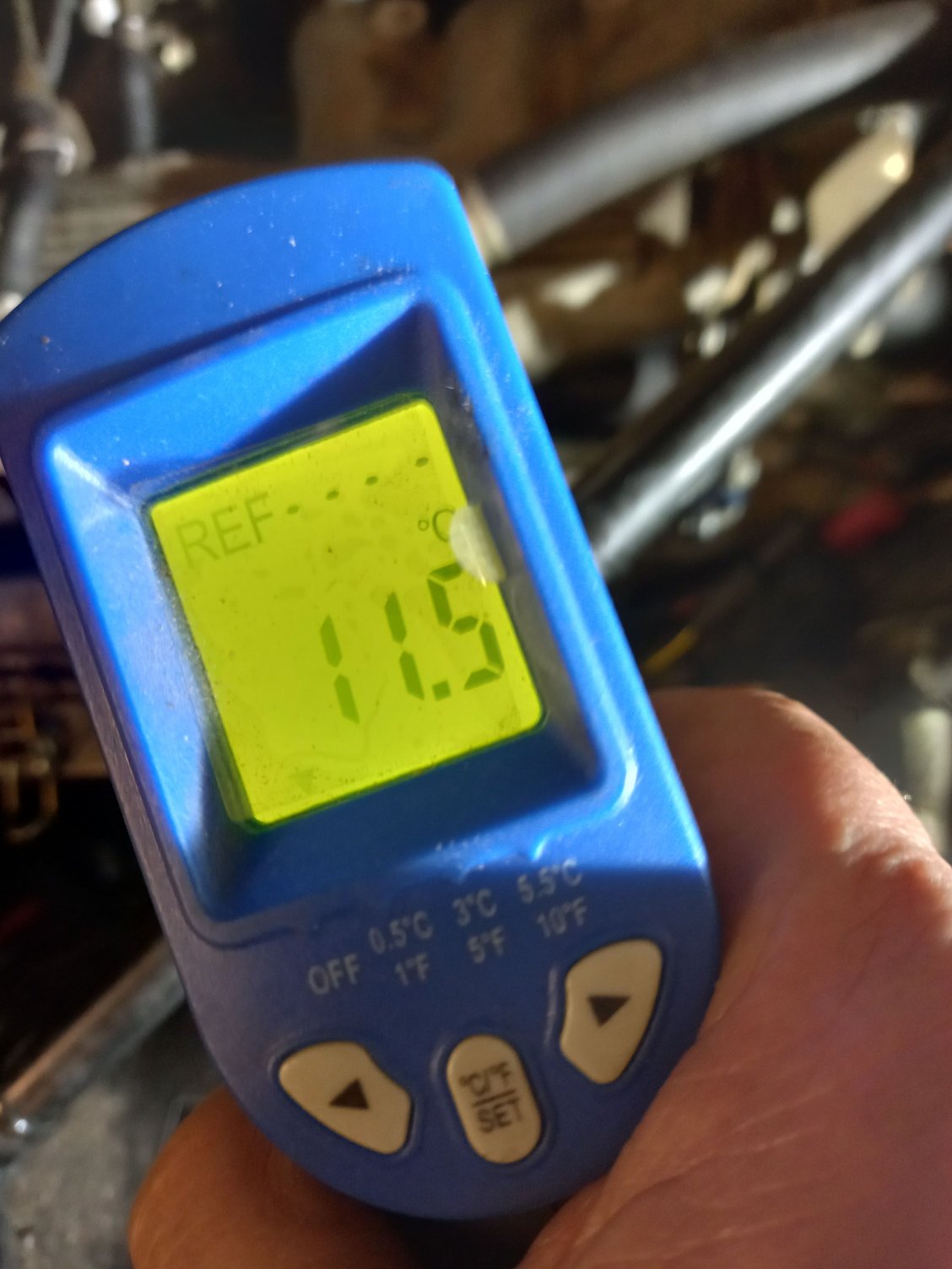

Ambient Temperature 11.5 c

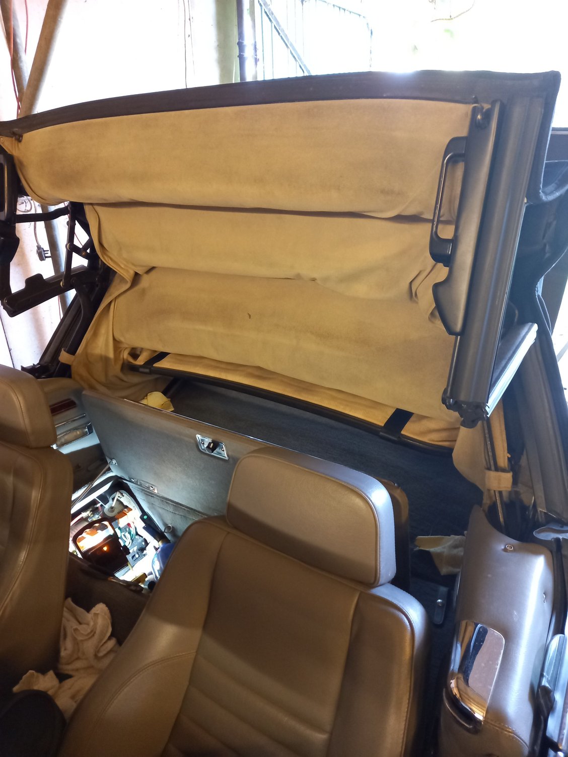

The reason being it looked like the Soft Top Pump was right out of Oil, where ironically that made Two of us! as I had also run right out of Royco 756 Which is the Hydraulic Oil that I use for The Soft Top Pump
Then to make matters worse if they could get worse, I thought I'd try the Soft Top just to see if it would go down and things were looking really good up until it was half way down or should that be half way up?
At which point the Soft Top was stuck up in the Air and wouldn't move!

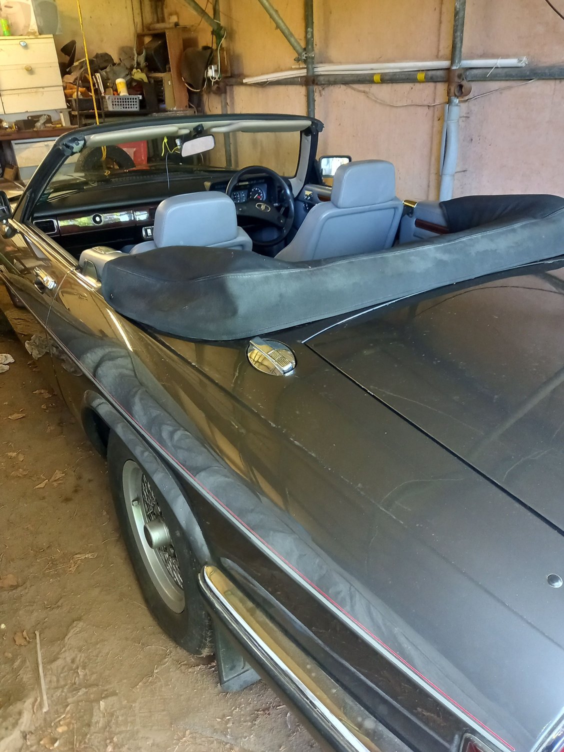

After Yesterdays debacle, '50 Shades' My Grey XJS is finally back on Track with just those very wobbly rear Exhaust Pipes left to do, which should be Fun as once again, it's Chucking it down with Rain in the UK
So in some ways I'm thankful that I haven't Taxed her for the Road just yet, as lining up those Exhaust Pipes can be a Thankless Job, that can seem like the equivalent of trying to Climb Mount Everest in a pair of Carpet Slippers (I kid you not!)
OK so back to the Soft Top, what went wrong and how did I fix it?
During the Summer such as it seems to be in the UK, I always leave the Soft Top down and just drive her into the Garage like that after we've been out 'Tripping' as if it looks like Rain we take her Mazda or my Merc
So maybe it should be expected that after 34 years the Soft Top Pump might leak a little bit of Hydraulic Oil from time to time

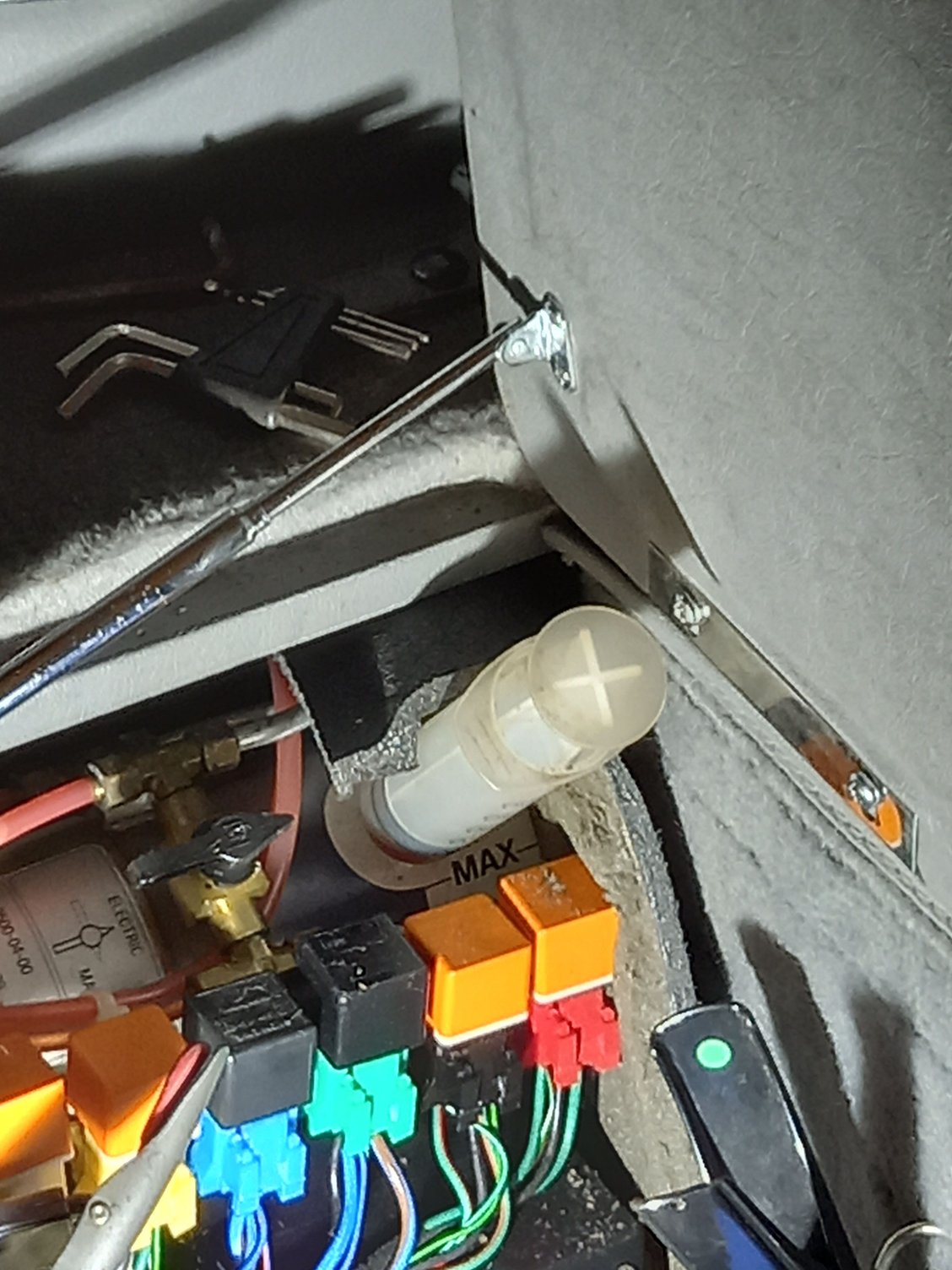

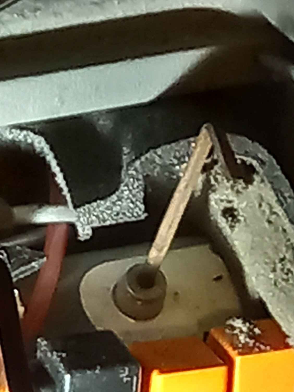

Not any old Hydraulic Oil but Royco 756 or you could refer to whatever your Handbook advises
As for the Hydraulic Pump that operated the Soft Top, that is inside the Rear Cubby Box on an XJS V12 and also on the Drivers Side on a UK Car, hidden beneath a piece of Trim that makes it a bit of a PIA to get to
Although in the interests of Research, you might find it easier with the Soft Top down, or accidentally Half Way Down like mine was, where all you need to refill it up to the Mark that's marked on the Side of the Pump, is an Allen Key
The Hydraulic Soft Top Pump is a little bit 'Awks' to get to, as you may be able to see
To Fill the Pump you need to remove the Filler Plug with an Allen Key
Using a Food Syringe to Squirt the Oil in, makes Filling the Soft Top Pump a 'Walk in the Park' (ish!)
At last the Soft Top is back down and the Hydraulic Motor that Powers it, is working like it should
Next Job and maybe the last Job on the Car this Year is Fix the Exhaust (which should be fun!) though maybe not until it has stopped Raining!

OB,
Well done for getting it fixed! Remember you could just turn the valve to Manual mode and manually lower or raise the hood.
Paul
Old May 10, 2023 | 12:47 PM
  #2758
orangeblossom's Avatar
Joined: Feb 2013
Posts: 17,809
Likes: 3,945
Hi Paul (ptjs)
That Certainly crossed my mind to do just that but the only thing that stopped me was seeing one or two Air Bubbles in the Fluid Lines, so I decided not to go there just in case I made things worse
Though if I get caught in a Rain Storm and the Soft Top won't go up, then it will have to be the Manual Option

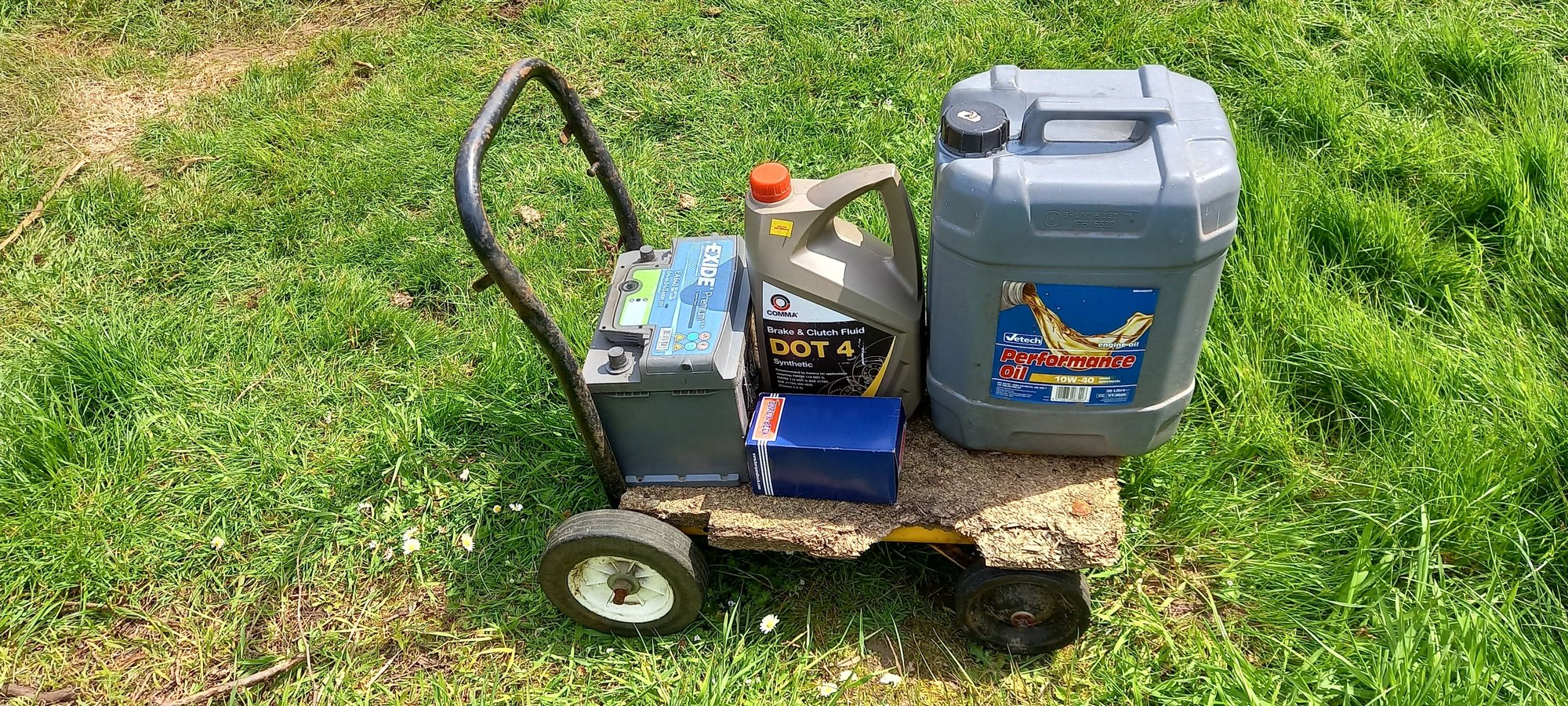

Meanwhile Back at 'Orange Blossom Towers' I took the Merc out Shopping an Spent £150 quid on the my Celebration XJS that has been so lightly used that She has never had a MOT Test which in the UK every Car has to have after 3 Years
Eye Wateringly Expensive Exide Premium Battery 20 Litres of 10/40 Semi Synthetic Oil 5Litres of Dot 4 Brake Fluid to hopefully give the New Owner Miles of Trouble Free Enjoyment
