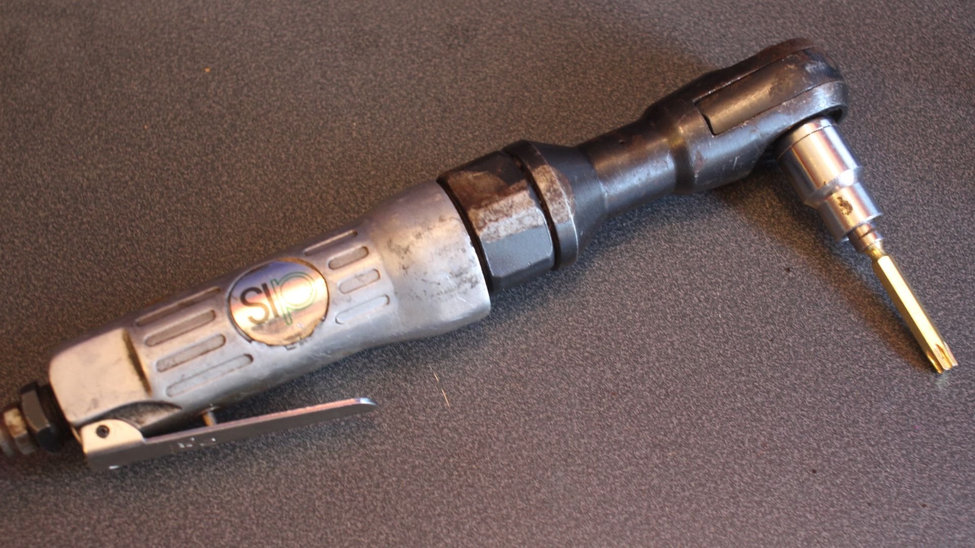

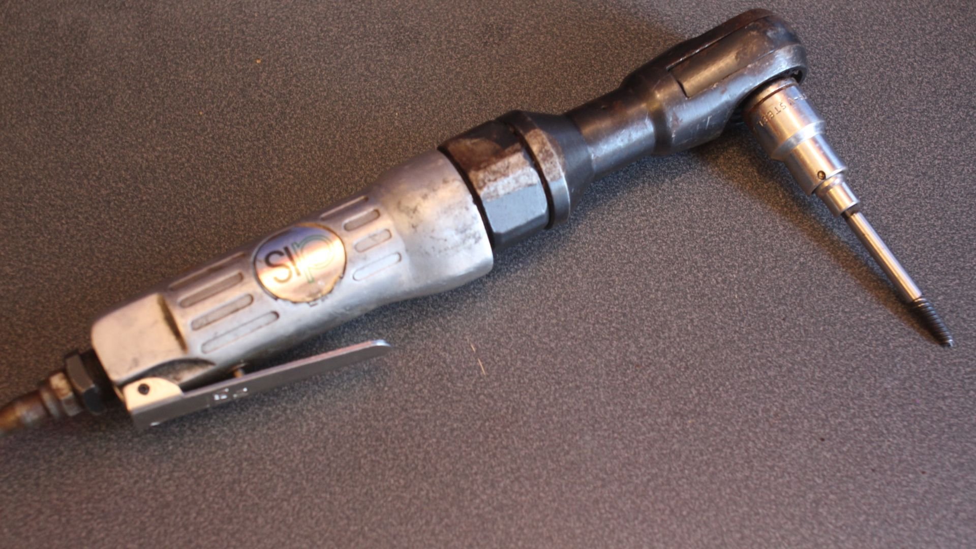

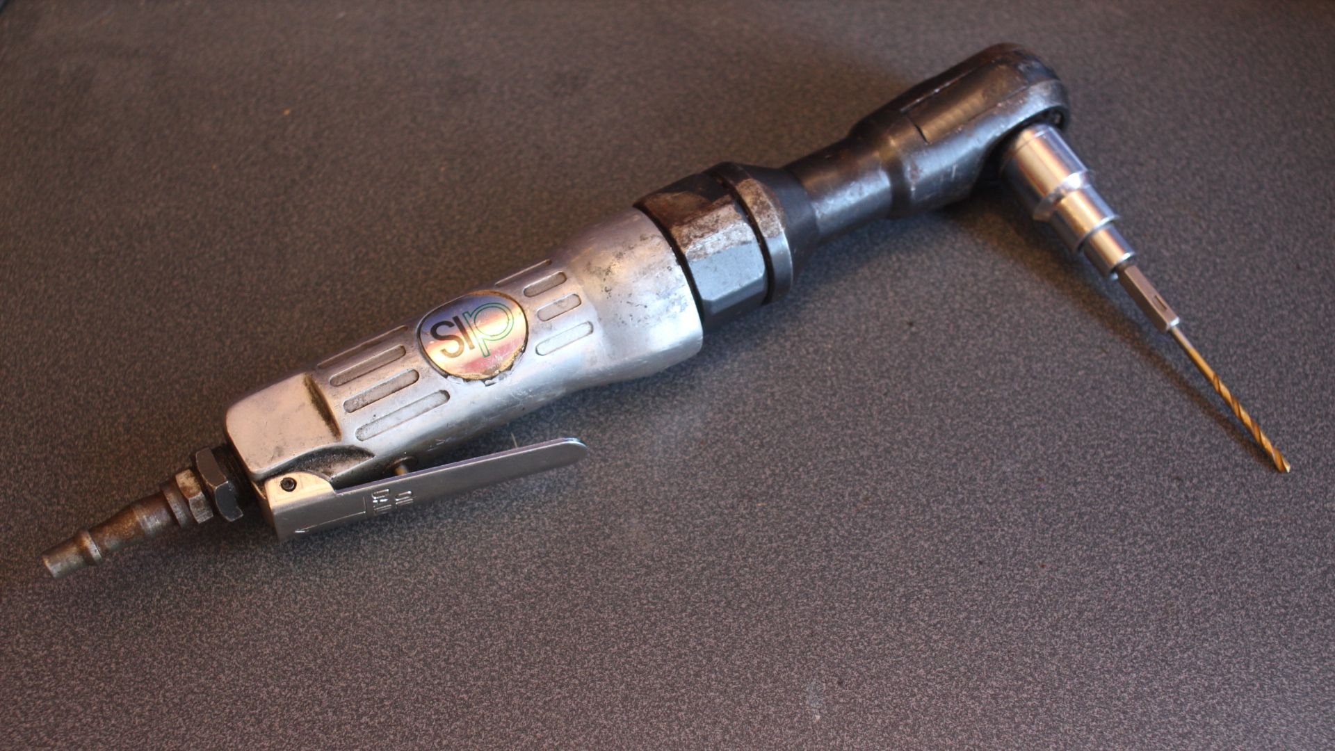

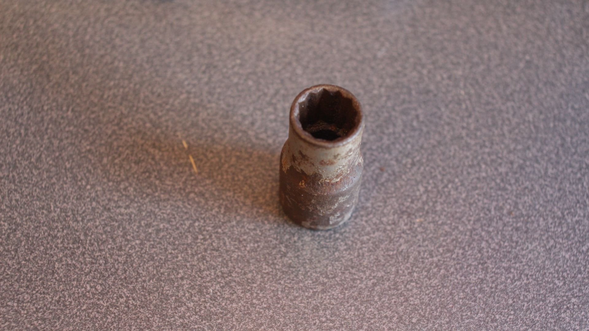

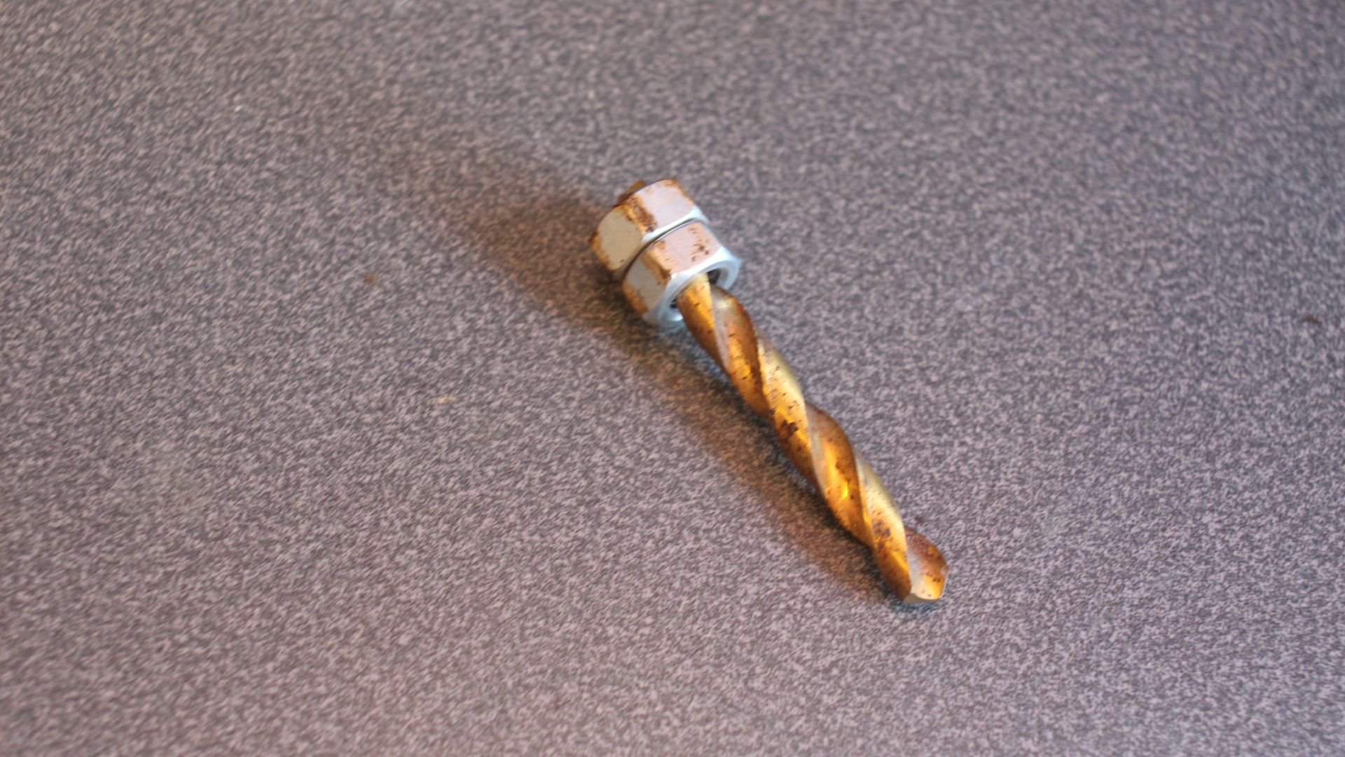

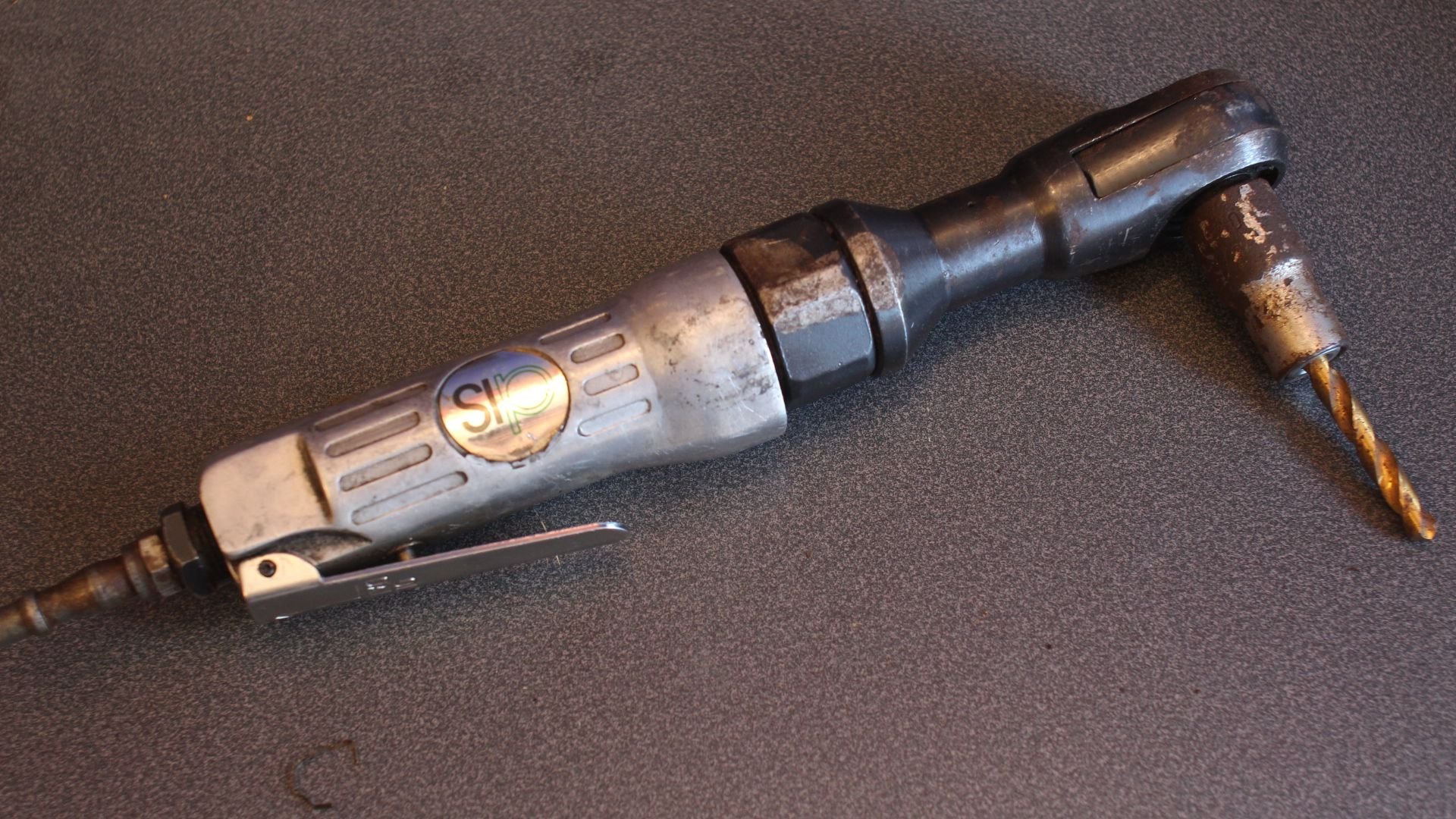

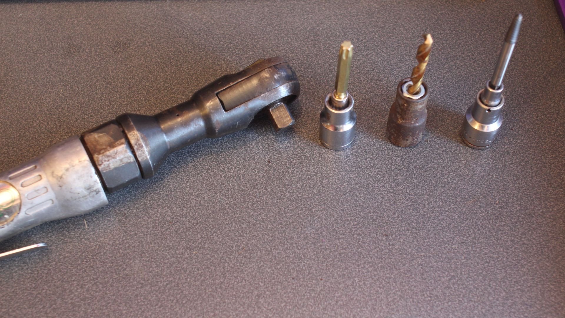

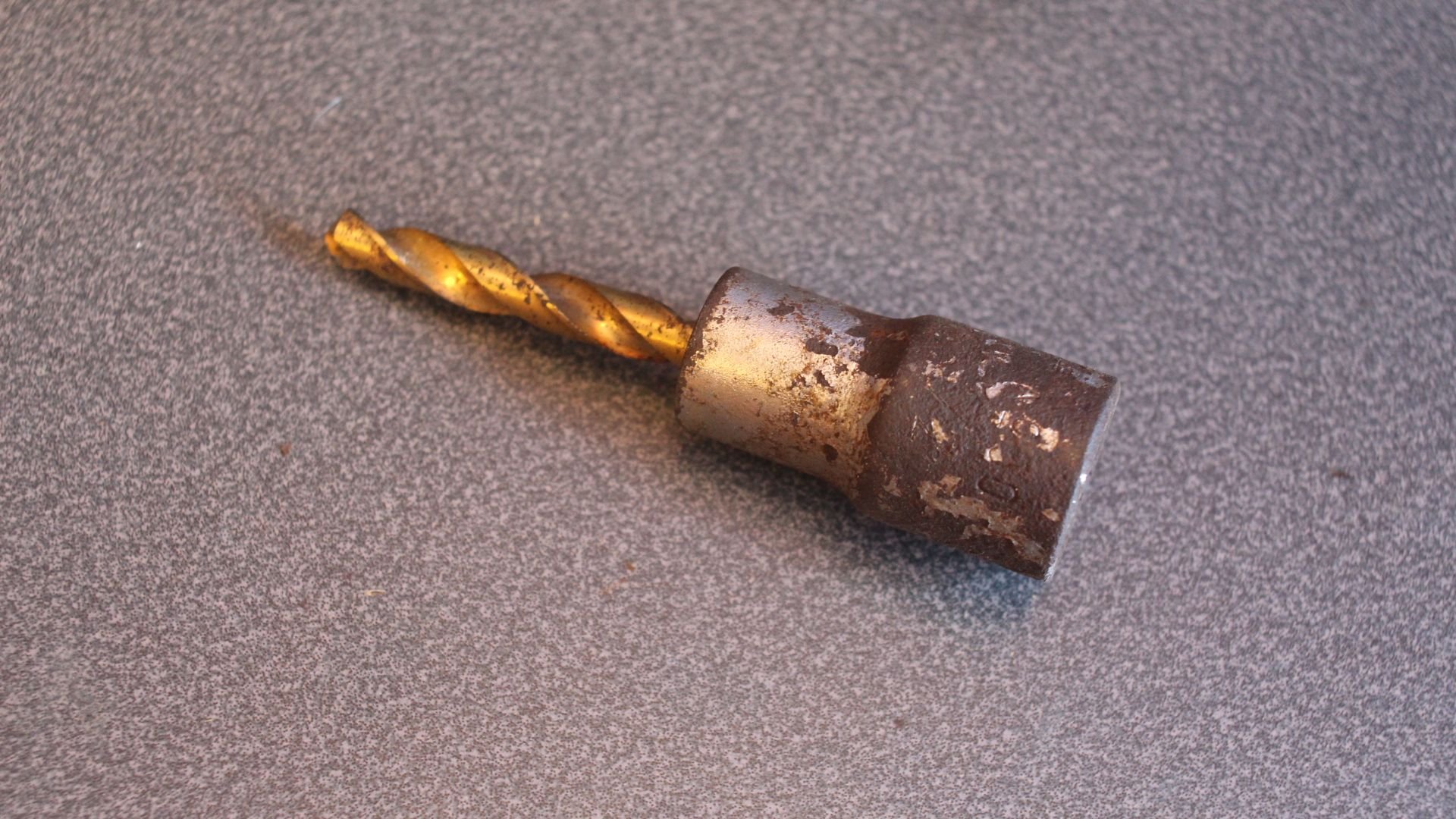

Homemade Low Profile Angle Drill To Try And Remove Broken Rear Brake Bleed Nipple On 'The Ice Princess'

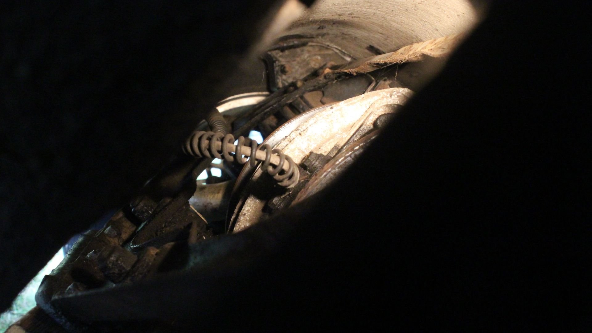

As some of you may already know, I have been trying to remove the Broken Rear Brake Bleed Nipple that Snapped off on 'The Ice Princess' rather than having to drop the Cage, as on this Car all the running gear seems to be in very good condition
And though I may end up dropping the Cage I am doing everything that I can do to avoid it, in the event that there may be an easier way

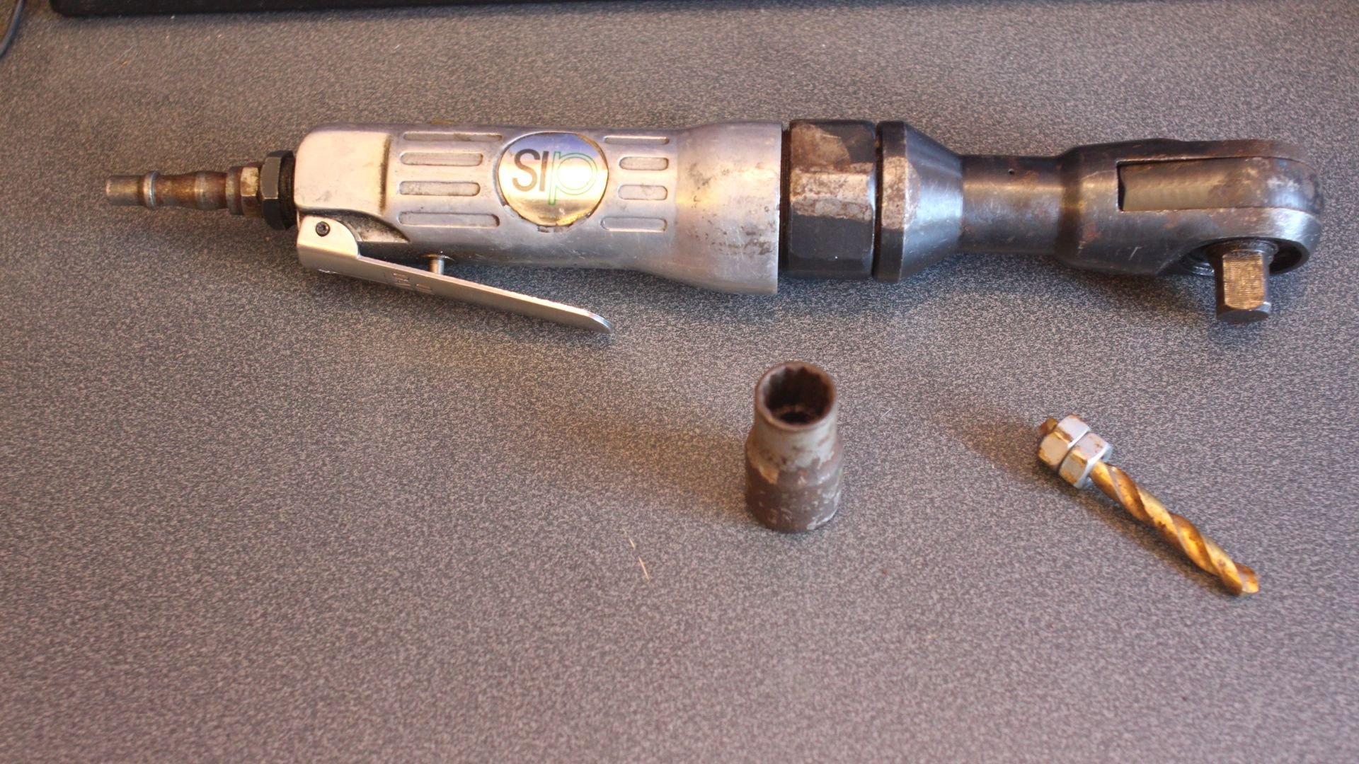

What I really needed was a Low Profile Angular Drill and since one of these might cost megabucks and might not even do the job, I decided that I would try and make one from stuff I had laying around
Using one of my Favorite Tools the Air Wrench, which I've had for about 3 years and has come in so useful for all sorts of Jobs, so the first thing that I needed was a Broken Drill Bit and I have got plenty of those
And one or two half inch Sockets that I'm always picking up at Auto Jumbles and Yard Sales, where making my Low Profile Angular Drill was a Breeze!
I just Welded a couple of Nuts on the end of the Broken Drill Bit and that is really all that there was to it! except of course I got carried away and made a very similar thing to hold an 'Easy Out' and a 'Torx' Bit etc
In Tests it was Amazing! with plenty of low down Torque but whether or not I am able to get out that Broken Bleed Nipple, we will have to see, although in any event I'll be using it for lots of other jobs, where there is no room for a big drill
Somehow this reminds me of the Dentist!

I stand in awe of your inventiveness OB! I wasted my money on one of these:
The question is, though, what condition will the calliper threads be in when you have finished? I feel your system needs a counter clockwise drill, and with luck it might twist the remains of the nipple straight out. Buy a CCW drill that is not as thick as the nipple (say 2/3 as thick). Somehow centring the thin will be the problem, but with luck, and a narrow enough drill, the hole down the nipple should keep the drillbit centred.
Greg

OMG Greg!
That Air Wrench cost me a Tenner at a Yard Sale!
The one you bought looks a little bit more expensive!
If I can get it to drill some sort of a Pilot hole, then I can try a CCW drill bit as for the Tenner I spent on that Air Wrench, it also works in reverse, as you would expect for that sort of money (Lol)

I've taken out a few seized bleed nipples before. The challenge as Greg has said is that because of the hollow thin-wall nature of the nipple, it's really easy to irrevocably damage the caliper thread.
However that hollow construction means that you can carefully run in a counterclockwuse bit that's only fractionally bigger than the hole and slowly wind out the nipple. I've done it twice with an Easyout turning slowly with a very small spanner on the end.
I wouldn't use a power drill at all unless you've completely exhausted attempts by hand with a counterclock bit of some sort.

Glad you are back on the Scene but I can't get the hang of those 'Gizmos' because its a Taper Spiral going into a Straight Hole, so it only grips where it touches if you see what I mean, unless that is the way those things are supposed to work
Though sometimes it just doesn't grip at all
Maybe its me? maybe I'm doing it wrong?
One of the Biggest problems is I can't see what I am doing, which really isn't helping matters at all
But I had an idea, that I would like to run past you
Do they do a Thread Tap with a left hand thread?
Or could I use a normal Thread Tap but put Locktite on the Thread of the Thread Tap and then when it sets wind it out (hopefully) complete with the broken Brake Nipple
That Locktite stuff is so good that it once took me 3 days to get the Nut off the Top of a Front Shock Absorber

First of all, I think you'll find that the small calibre Easyouts have a less severe taper so they tend to be much straighter in profile. Yes, they are tapered to some degree, but on the small ones such as you'll use for a bleed nipple, I think you'll find you can get quite a few turns in giving you a greater contact area and then it will turn out. It's worked well for me in the past.
As regards using taps, it's very easy to find left hand taps, which might also work. I wouldn't use right hand taps and loctite. Just my opinion.

But now we've got an even bigger problem, as the hole in the Broken Brake Bleed Nipple is blocked up and I don't know how that happened, as I haven't attempted to drill it at the moment
As instead I was just offering up one of my 'right hand taps' to get the right size for a 'left hand tap' I wasn't even attempting to try and screw it down
So maybe a bit of Swarf from somewhere, has become dislodged and fallen down the hole, so now I've got to try and find a mirror on a stick to have a look
I did try Welding on a Nut a few weeks ago but I think that the Bleed Nipple may have been made from some sort of alloy material, as I couldn't get it to Weld
I'll probably end up having to take the Cage out but one of the first things I'd need to do is to take out the Speedo Sensor from the IRS which looks deceptively easy to take out
If only they'd left it on the gearbox like the earlier Cars!

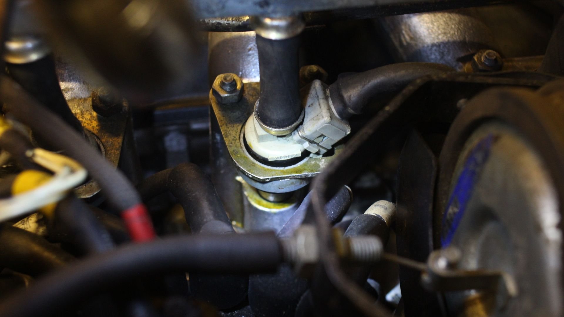

The Speedo Sensor looks deceptively easy to take out, the only problem being that it looks an almost impossible job to try and get your hand in there with a spanner

it is possible to get to the sensor but it's definitely a fiddly job. As you pull the sensor out, be very careful as it's really easy to catch it on the hole and chip it. Also carefully remove the shims as the Speedos are really critical on having exactly the right air gap.
as regards the nipple, you're right, you really need to get any blockage out of the hole before you insert the Easyout.
I've never done inboard XJS brakes in situ, but they sound an absolute pain!

I needed a 1/4 Ratchet to turn the drill bit, so because I haven't got one, I borrowed one from a mate which was great but the Ratchet on that Ratchet kept on slipping
For which I can only blame myself, as I should have asked him to lend me one that worked!
But I managed to drill out the blockage, which has taken me 5 Hours! and now I've got to drill down even further, so now I am going to buy one, as I need to get a decent Ratchet for that
The Problem with getting the Sensor on the Speedo out, is undoing the bolts that hold it in and while they look easy to reach they are anything but
Its a bit of a 'Catch 22' As You cannot get the Cage out until you've got the Sensor out and you cannot get the Sensor out until you've got the Cage out!

I've had the Speedo sensor out quite a few times. Can't remember if I used spanners or sockets with wobble bar, extensions etc but I've definitely managed it without too many issues.
if you really do have to move the cage, why not just carefully lower it a fraction to give requisite clearance for bleed nipple and leave sensor in place?

OB, why undo the cable on the diff? It plugs in in the rear left side of the boot. Unplug it there, thread it through the opening and it is out.
Don't know what all the fuss is about.
