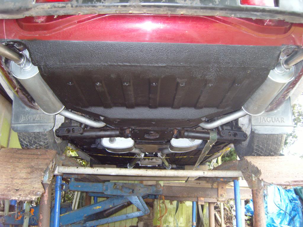

Default Safety First
Never really been 'PC' or a Fan of all that 'Health & Safety' but when you're working under a Jag, or any Car for that matter, you need to make sure that it wont fall, so needs to be well 'Chocked Up!' so that can't happen.
(1) The hydraulics on this lift, are so good that they won't go down even when I've had my LWB Land Rover sitting on it for a Week!
(2) The Lift also came with safety 'Pit Props' which are the 'Blue Poles'
(3) GF's Dad knocked me up some Extra Strong ones out of some scrap that he had laying around, so now its a really belt and braces job!

Problem (One) Was the Road Wheels on the 'Front' of the Car, It took hours of Careful Bashing to remove the one on the drivers side (UK)
Then when I finally did get it off, things didn't look very good!
The Road Wheel on the Passenger Side (UK) had suffered a 'Blow Out' and nothing would get that wheel off!
So I am planning to Fit the New Rad with New Belts & Hoses etc, then if I can get Her Started! after 14 years!
I will loosen off the Wheel nuts, then Rock the Steering until the Wheel comes loose.
Then back on the Lift for the rest of the Restoration.

Default Sometimes You Just Have To Get The Big Guns Out!
After banging and crashing for what seemed like a Week, I still couldn't manage to get the N/S Front Wheel Off!
Even my trusty Sledge Hammer failed to make it budge and I needed it off so that I could do both sides of the Front Suspension together.
Then I suddenly had an idea! Which I was unable to find in the Workshop Manual, even though it seemed a bit extreme but you know what they say 'Needs Must When The Devil Rides Out!'
So I put a great big 'Acrow Prop' between both of the Wheels, which I hung from the 'Down Pipes' as it was blinking heavy, after which I screwed it with a 2ft Pipe Wrench.
Even then it wouldn't move until I hit the back of the Rim with a 'Lead Club Hammer' and it didn't jump off either, as I was expecting it would and clung on like a 'Limpit' until the very last Thump with the hammer.
When unlike myself it gave up and as such I was now able to remove the Wheel and Tyre, which had perished and suffered a 'Blow Out' as a result.
So one of the next jobs is going to be refurbing the Front Suspension.
When it Stops raining! as I'd much rather get the Chassis done before I go and fit the Radiator.

Originally Posted by Daim
I know how hard it can be to get a wheel off... My tip would have been: jack her up and with 2 or 3 lug nuts on, drop her hard. It sounds brutal, but that will loosen it up and get the tension off
Hi Daim
You can't do that with my 'Lifter' it comes down too slowly but the 'Acrow Prop' eventually did the Trick.
The restoration that you have done is absolutely 'Amazing!' I'm not really sure I could cope with something like that.
