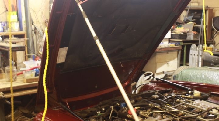

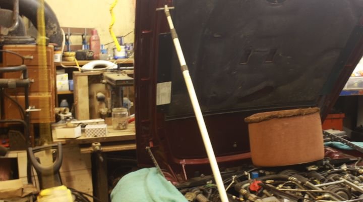

Tried lots of different setups today and 500mm is the only comfortable fit as the 'Gas Strut' needs to Telescope down to 13 ins as you were both saying
But both of the 'Gas Struts' on 'Cherry' 500mm Telescoping down to 13 ins are completely shot away, meaning I have to lift the full weight of the Bonnet/Hood and have done ever since I got her back on the road again, with help from 'Greg' and 'The WOZ'
Although the weight of the Bonnet has never bothered me, its just something that I have got used to and the only real reason for making those 'Struts' was to Safely hold the Bonnet/Hood open, as far at it would go
For stuff like Changing the Fan or replacing the Spark Plugs and so with that in mind I started to wonder, if I really needed any 'Gas Struts' at all and just use my Homemade Struts for doing the sort of jobs, where wide open access is required
And just use a Bonnet/Hood 'Prop' to keep the Bonnet/Hood open while either doing 'The Pre-Flight Checks' on the Oil and Water and to also make it easier for putting on my 'modded' Struts' whenever I needed to use them
But as I hadn't got a 'Bonnet Prop' I had to find something to make one from
So while I was down a 'Thrift Shop' today, I found the very thing! which was a long pole scoop for picking up Golf *****, which just required a little bit of 'modding'

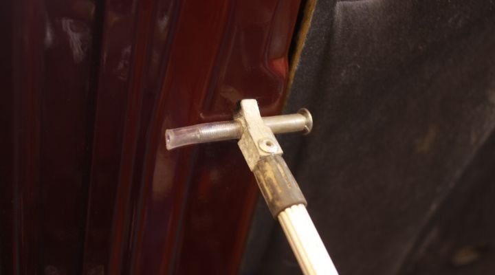

Which was to take off the Scoop parts and then replace it with a bolt, with Plastic Tubing on each end to protect the Car, where by way of a bit of a bonus, this Pole had a friction lock to adjust the length
'Ron' was using something similar, which inspired me to give it a go and found out that it was a great solution, which also holds the Bonnet/Hood up, in case I want to put the 'modded Struts' on
Golf Ball retriever with friction lock to make a Bonnet/Hood Prop
Cup removed from 'Golf Ball Retriever'
Hook protected with Polythene Tube was a perfect fit! with the other end tucked underneath the 'Brake Pump'
Blunt end with rubber handle tucked underneath the 'Brake Pump'
Bonnet/Hood Prop seems just the job and the Cushion is only there in case the 'worst should happen' while I am lifting it up

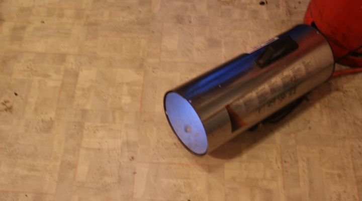

Or at least what's left of it anyway, after having attacked the rest of it with a FBH and my newly acquired Power Hacksaw
That is not a 'Clothes Rack' that you are looking at, those are Uber Super Douper Double Acting 'Gas Struts' 600mm long
or at least they will be, although not as we know it in about 3 hours from now

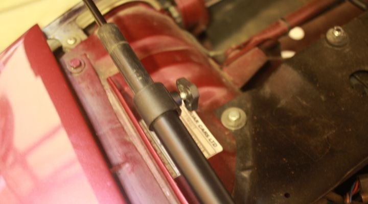

The Stock 'Gas Struts' on 'Cherry Blossom' had seen better days and as I was about to buy some New ones anyway, I thought that I would use these as a prototype and what's more you never know, they might even work!
And so the very first thing that I had to do, was to file the eye bolt down on the sides of the blunt end of the 'Gas Strut' so that I could slide them into the Tube that this Clothes Rail was made from
That is all I had to do, as once that 'eye bolt' was slimmed down about 1/2mm, the rest of the 'Gas Strut' just slid in! absolutely perfect with virtually no play
At which point I got the 'Chills' as I had a sneaky feeling, that it this was now going to work
Which if nothing sometimes shows just how wrong you can be, or maybe not as we will have to see!

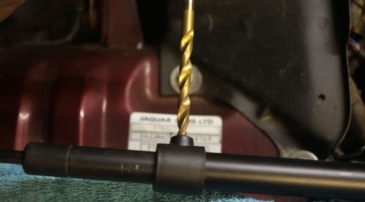

Cutting the Tube the same length as the 'Stock Gas Strut' with the 'eye bolt' of the 'Gas Strut' just inside the New mounting Bolt

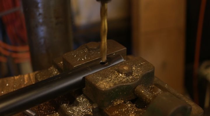

Drilling out a 5/16 Mounting Hole in the Tube
Slimmed down 'eyebolt' of the 'Gas Strut' (which is made of plastic) about to be slid in the Tube, where this actual Tube was a 'Mock up' just to take the Photo, the Actual Tube I used was the right length (dimensions to follow later)
Stock 500mm 'Gas Strut' now slid into the Tube, with the head of the 'eye bolt' that you can no longer see, sitting on top of the New Mounting Bolt (the Bolt does NOT pass through the 'eye bolt' of the 'Gas Strut' or we would be back to square one!

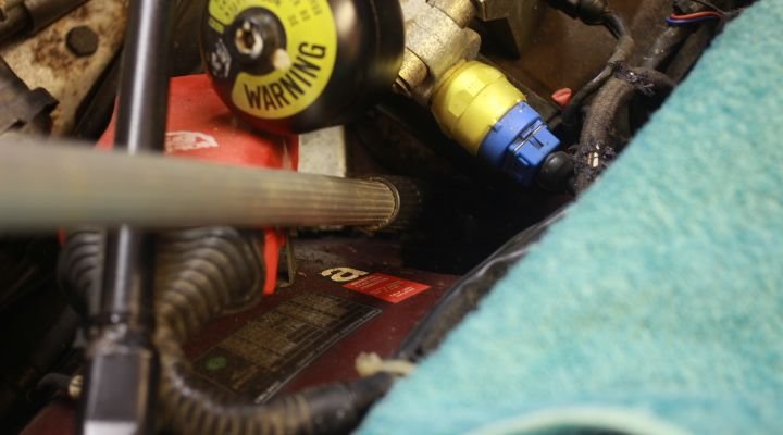

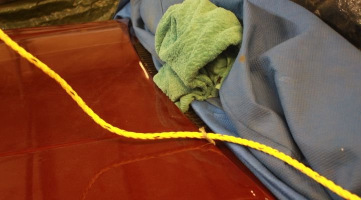

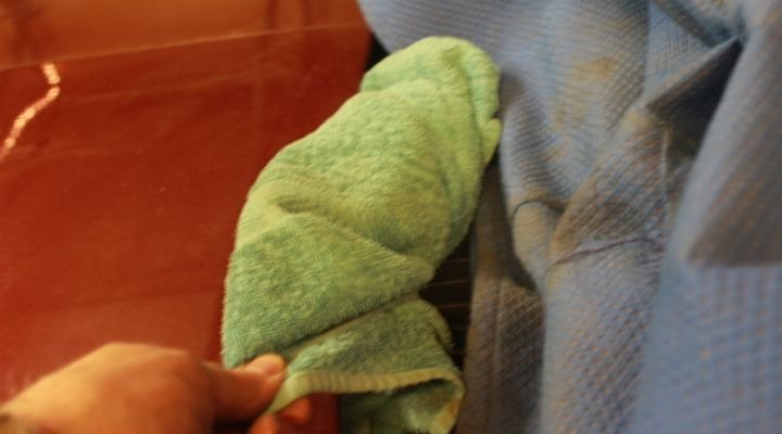

Squeaky Bum Time! as I very gently close the bonnet and pull the Towel that's holding it an inch clear out the way
Nearly there but at this point, my hearts beating out of my Chest in anticipation of what could possibly go wrong!

Draw me a diagram please Alex, for the life of me I cannot grasp what is going on! How is the strut anchored to the wing?
Old Dec 20, 2018 | 03:28 AM
  #1973
orangeblossom's Avatar
Joined: Feb 2013
Posts: 17,809
Likes: 3,945
Hi Greg
The OEM 500mm 'Gas Strut' is Not anchored to the Wing, it just sits into the extension Tube, where it holds up the Bonnet/Hood in much the same way as a 'Bonnet/Hood Prop' might do
Which seems to work fine in the Garage but could blow over outside if hit by a strong tail wind, so it would need a tether to stop it doing that, although I have plans to connect it to the mounting bolt from inside the tube so that can't happen
This is just my prototype which is still in the early stages of R&D but it works well for what I want it for, as this is 'NOT' A 'How To' Guide but just something that I put together for myself
Which does seem an improvement on what I had before, as I was restricted on how high I could lift the Bonnet/Hood up without the need of taking off the 'Gas Struts'
The ones that you had Custom Made undoubtedly work better but since I like to make things, this was something that I really wanted to try out, even if I have to go back to the drawing board
Although for any serious work I will be using my 'Maintenance Struts' to much more Safely hold the Bonnet/Hood high up in the Air

I too could not see what the fixing point looked like to the wing. While I was reading and trying to imagine the workings of your idea, am I to understand that all you did was place or slide the original 500mm strut inside the new tube with no change to the original tube? Meaning the old strut is free to move forward in the open position but stops at point inside the new tube. This overall stopping point, which I assume is right up against the new bolt/eye position. It is at this position that a 600mm dimension is achieved? At this new position, could you not place a pin through where the old eyelet sits in the new tube? This would fix the old strut in the new tube with no fear of the hood/bonnet moving any more forward in a gust of wind. Once the best position is established, for both open and closed positions, you drill a hole in the right place for the inside strut to the outside tube. ..or ..have two hole positions on the outside tube. One for the best closed position, and one for a "maintenance" open position which you could lock the tubes in the most open position and lock with a removable pip pin.
Old Dec 20, 2018 | 05:29 AM
  #1975
carsnplanes's Avatar
Joined: Dec 2017
Posts: 495
Likes: 75
From: Brookfield CT
Pip Pin
Old Dec 20, 2018 | 01:58 PM
  #1976
Joined: Feb 2013
Posts: 17,809
Likes: 3,945
Hi Carsnplanes
You have understood the workings 'Bang on exactly right' though maybe I could have explained it just a little bit better and also today I have 'Modded' that Strut, so that the 'Body of the Gas Strut' cannot pull out of the Tube
Where apart from that the Advantage as it occurred to me, was to have the 'OPTION' to 'Temporarily' EXTEND a 500mm Gas Strut to 600mm
So that you have the 'OPTION' of having the Extra Distance should you need it, WITHOUT the Extra Strain on the Bonnet/Hood Hinges and then you would SHORTEN them up again back to 500mm BEFORE closing the Bonnet/Hood

Where the problem that I thought I had was locking them in position, until I suddenly realized that the Solution to all this was Staring me in the face!
As the Clothing Rack I'd made them from, came with locking Collars and Screws to Clamp everything in place but since these Clamp Screws were facing up, I didn't want to use them, in case they fouled the Bonnet/Hood when I tried to close it
When these Adjusting Clamps were facing upwards, it looked like the Adjusting Screws were going to foul the Bonnet
The Solution was quite simple, as the only thing I had to do was to drill a hole in the Side of the Tube, so that the Adjuster would be laying on its side
Note: I took the Tube out of the Car to drill a Hole in the Side before putting it back, this time with the Screw Clamp, laying on its side, where I'm please to say it didn't foul the Bonnet
If you decide to make something like this or hopefully even better:
DO NOT DRILL A HOLE IN THE STRUT ONLY THE TUBE IT SLIDES INTO
So how does it work?
With the 'Stock Gas Struts' Clamped in place at 500mm The Bonnet Hood opens as Normal but if I need any extra height, then all I do is to undo the Locking Collars and Clamps and then 'Manually' push the Bonnet/Hood up another 1000mm
Where on my Car anyway 600mm is enough to have the Bonnet/Hood Open, as far as it will go
With the Advantage being because the 'Hybrid Gas Struts' are a combination of Manual and Auto, I've found I can get the Bonnet to open that much wider without increasing the strain on the Bonnet/Hood Hinges
As you also have to undo the Clamps and Manually close the Bonnet/Hood 1000mm before the Gas Struts take over
This is Not a How To, I did this for my own Car but if you do something similar, take very accurate measurements and be extremely careful that you don't strain the Hinges or Damage the Bonnet/Hood
