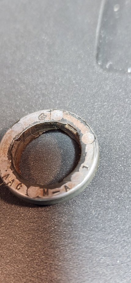

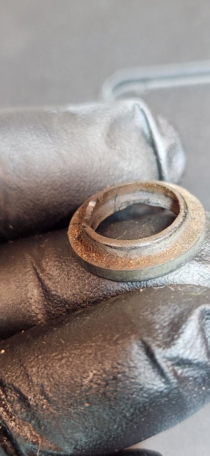

So I removed the hydraulic cylinders this weekend. I removed the two rear panels by simply removing one of those push in nylon type panel fasteners. Once removed the panel sort of lift up where you can get access to the cylinders (93 XJS). One of my clinders appeared to have been leaking at some point in the past. I decided to remove both of them and look at them closely. They were easy to disassemble and once apart, there are just three orings that need to be replaced. I haven't sourced them yet, but the dust seal on the top of the cylinder is the hard to find part. The shaft is .50 inches, the od is .75 in. The seal portion narrows as it goes trough the cap, but that's not necesary and its about .125 thick. But the thickness can vary a bit as the seal just sort of gets pushed up into the cavity and held in place with a sort of large star washer type fastener. I removed the first cylinder and damaged the seal so bad that on the second one I used a pilot bearing in an attempt to remove it. This was a bad choice as it damaged the metal sleeve so bad I wound up ordering new cylinders on ebay. But these could be rebuilt. I did manage to see the seal as it should be without any damage. I'm going to try and source this seal and see if I can come up with a kit to rebuild these. In the meantime, I'm just waiting on the new cylinders.
