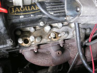

Old Apr 6, 2013 | 06:25 PM
J_C_R's Avatar
Posts: 784
Likes: 182
From: central Indiana
Default cooling system "shock"
Well, the photo says it all I think.
Spent a good part of the day pulling the radiator. Surprisingly, I really didn't find any of the pea green/brown gunk in the left side thermostat housing or pipe...but it all gets cleaned/replaced anyway. Now to find a good radiator repair shop...
For laughs I pulled the heat shied (which I intend to clean, prime and paint) and was surprised to find that the rear heat shield bolt hole (not in the photo) appears to go all the way into the exhaust flow judging by the amount of soot on the end of the bolt. Why would this be? Not a big deal, just curious.
Thanks,
John
1987 XJS V12, 62000 miles
Attached Thumbnails cooling system "shock"-overall-view-radiator-removal.jpg   cooling system "shock"-left-side-thermostat-housing-removed.jpg
Old Apr 6, 2013 | 08:21 PM
Posts: 28,829
Likes: 11,287
John, glad to see you are having fun.
That shield bot from memory (not as it was) I reckon was a blind hole???, but if it goes thru it sounds odd to me, even for the British. maybe something to do with EGR (exhaust gas recirculating) that we never had down here.
