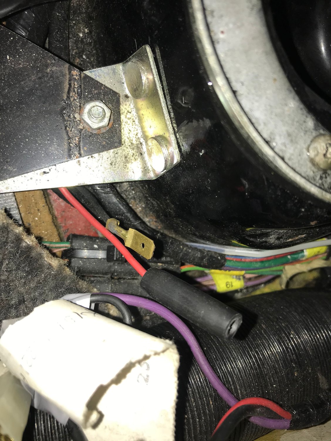

I have the speed control fuse in the passenger side fuse box. Above it is a wiring harness not connected to anything. Under the centre console is two wires together with nothing plugged in.
What are the chances if I get the cruise control unit and the switch I can literally plug them in and it will work?
Is the wiring all in place for it?

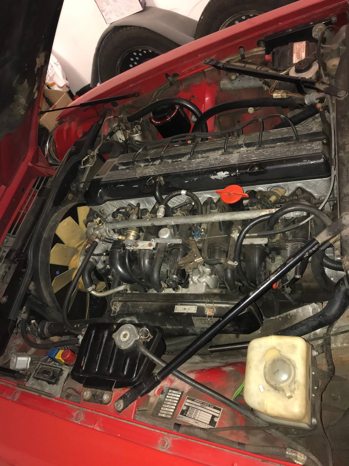

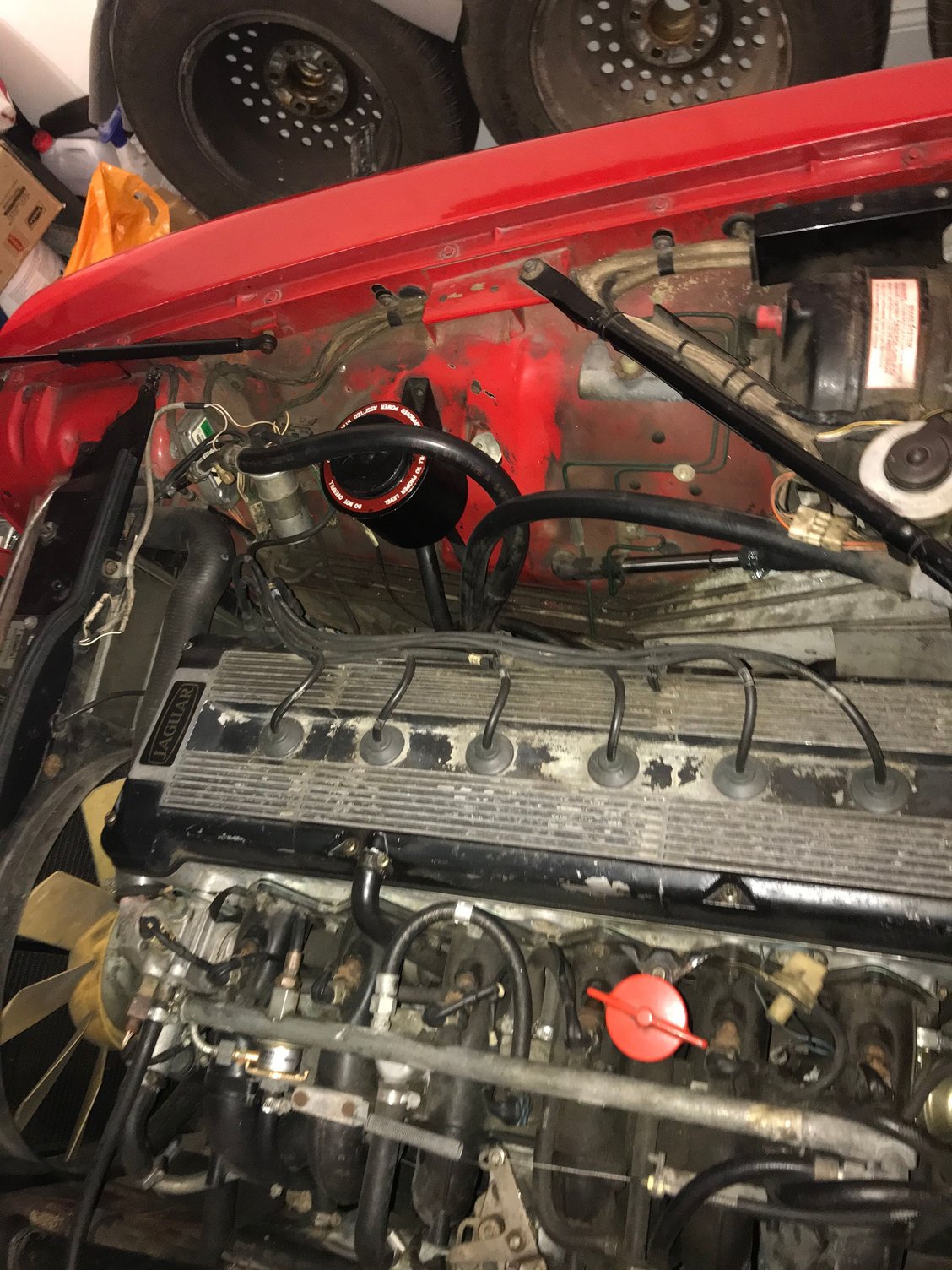

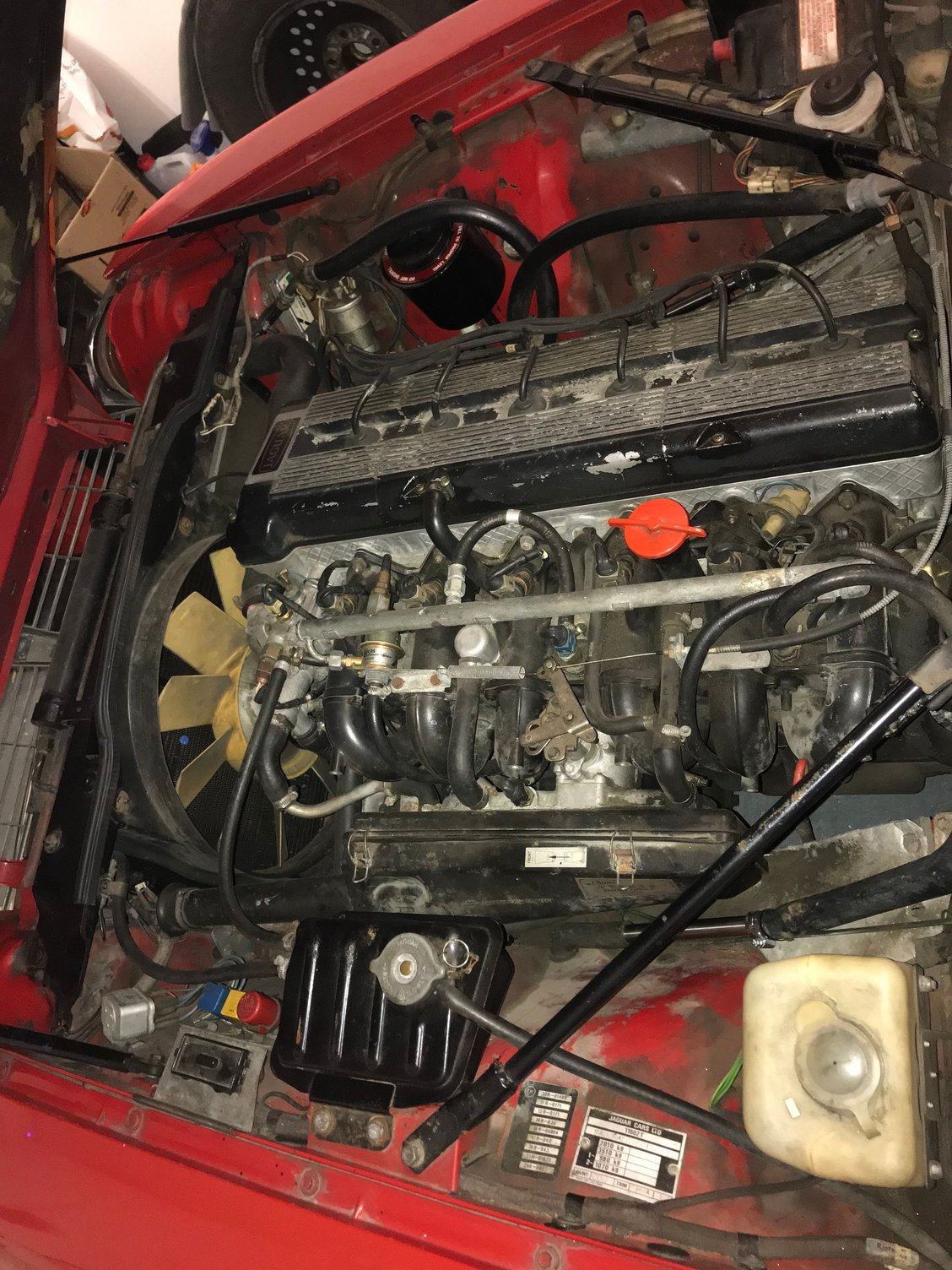

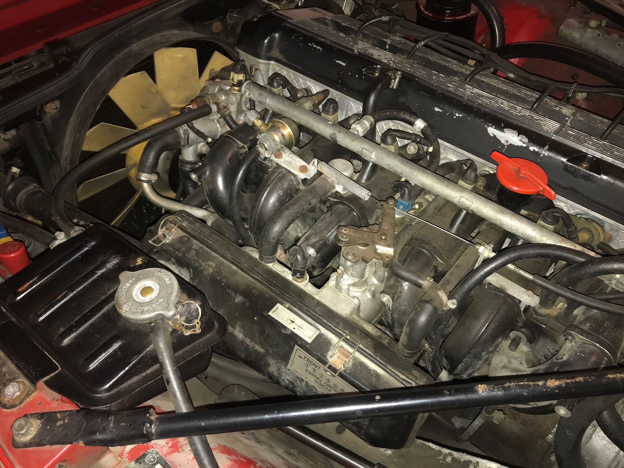

Photos. Fingers crossed.

The plug in the second photo is for the cruise module. It's not a difficult system to retro fit, I have adapted it to an earlier Daimler that never had cruise. You will need an extra micro switch on the shifter to give it an indication when the shifter is in D, and you'll need the cancel switch on the brake pedal.
The 1994 cars use a different system from the earlier cars. The later cars use a Hella system, the earlier ones are AE Econocruise.
I've attached the XJ6 wiring diagram, but the wire colours and the components are the same for an XJS.

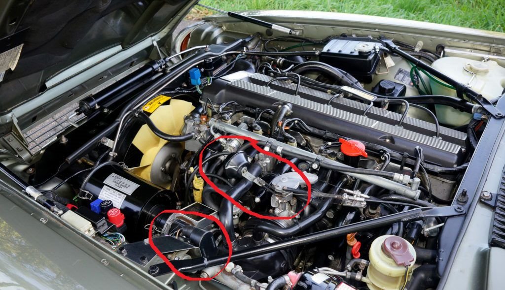

The vacuum pump/ dump valve is on the left wheelarch, and the bellows will be near the throttle assembly, mid point of the engine. The photo is a LHD car, but the vac pump is the lower circle, cruise bellows is the upper circle. This looks like a Hella vacuum pump to me. At least it's common on XJ40's and X300's.
Old May 20, 2020 | 01:39 AM
Duke85's Avatar
Joined: Apr 2020
Posts: 141
Likes: 20
From: Derby
Wow, super clean and tidy engine bay. As you can see mine is lets say, different to yours!
I don't think I have the parts you circled in my car
