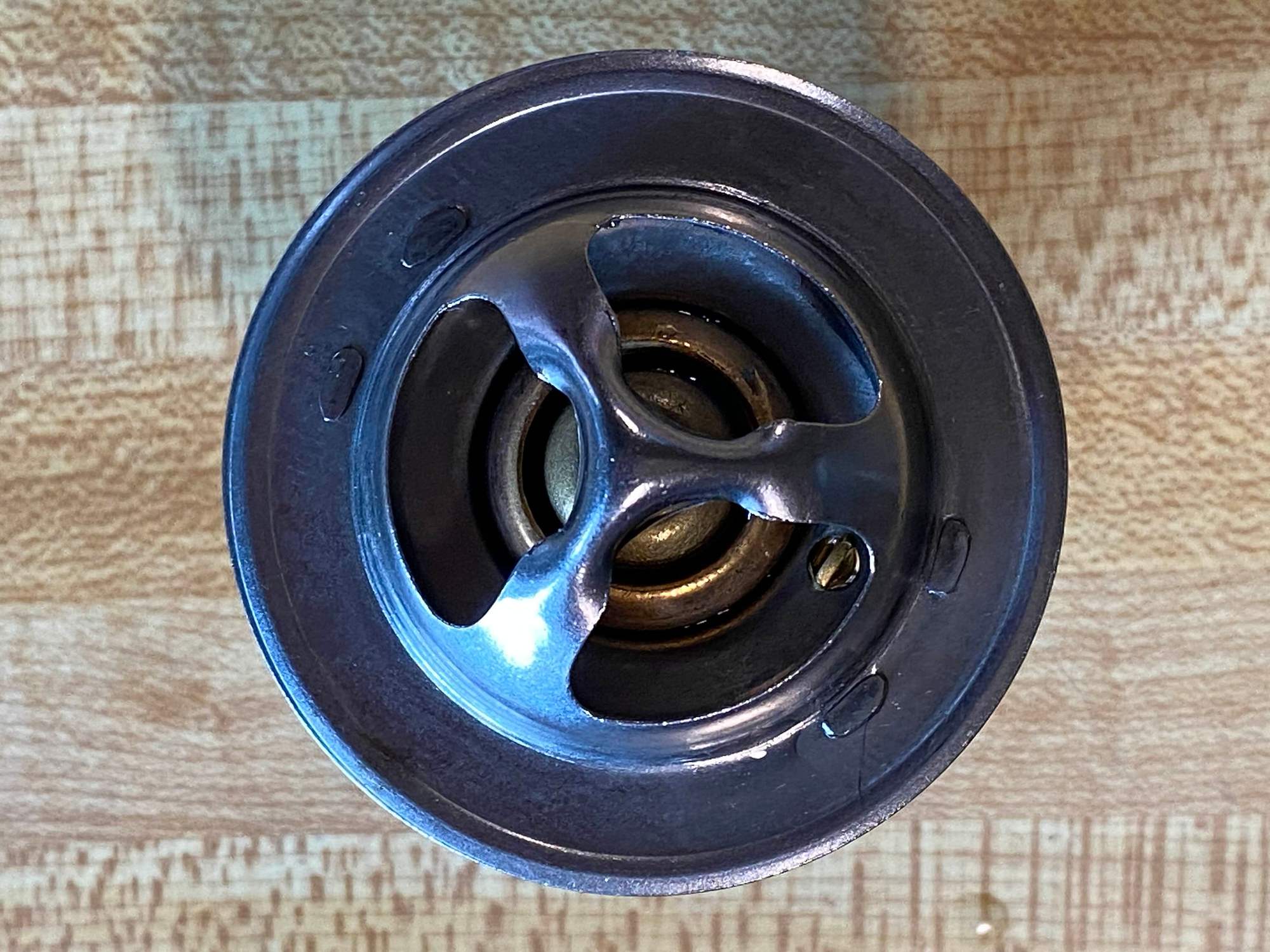

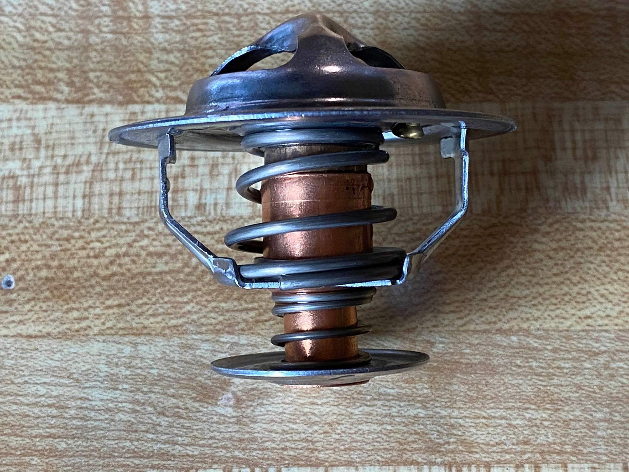

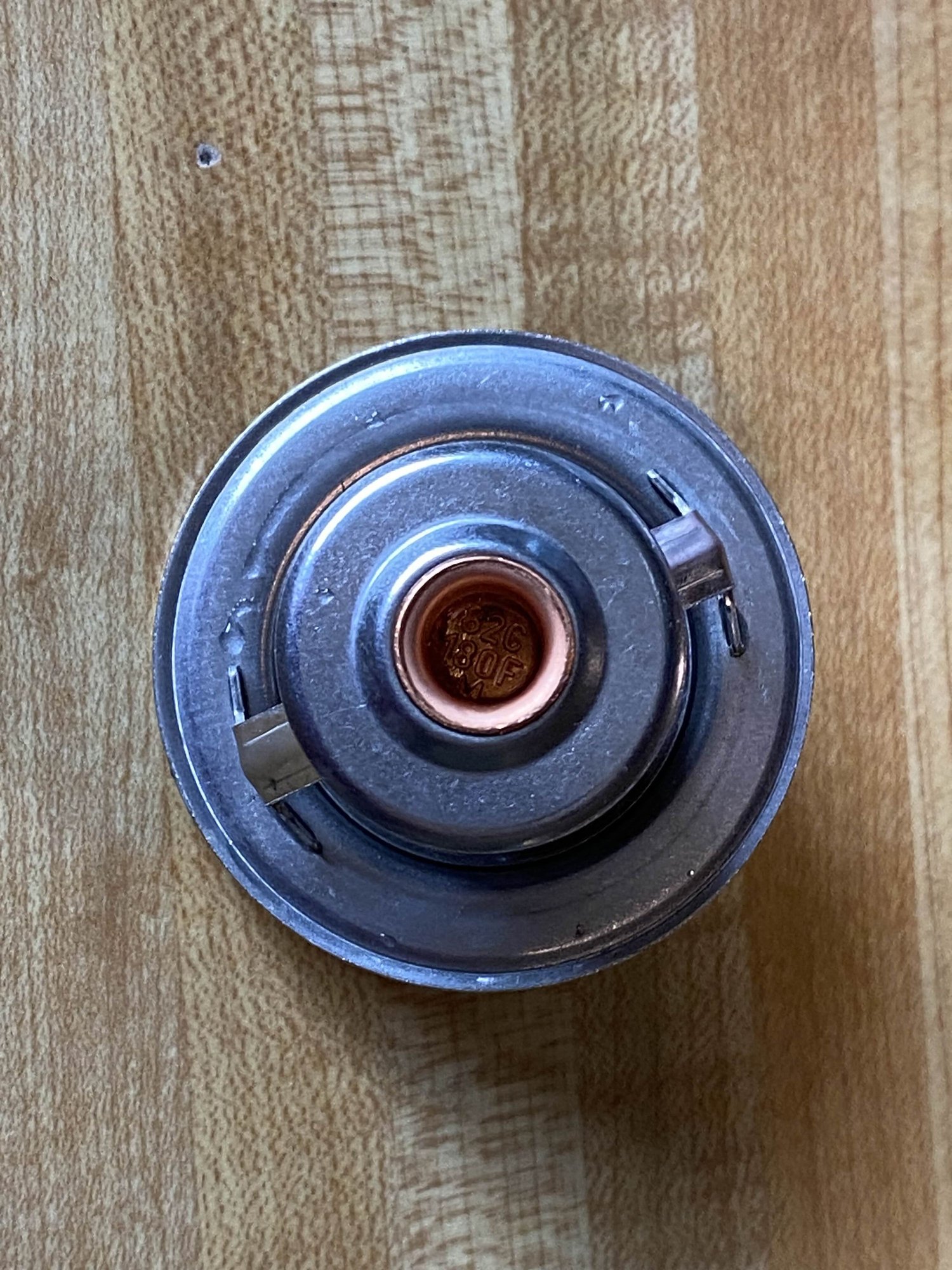

The thermostats arrived today.
They crack open at ~179F, and are fully open by ~195F in my stovetop testing with a thermocouple. I will say, they weren't kidding about the "High Flow" marketing, the opening is massive compared to other thermostats I've used.
From the bottom of the flange mating surface to the opposite side of the bypass mating surface looks to be just over 41MM when fully extended, maybe ~42.5-43MM. Yes they have an air bleed jiggle pin as well.
Should work pretty good once I get around to doing them, after figuring out this distributor debacle.

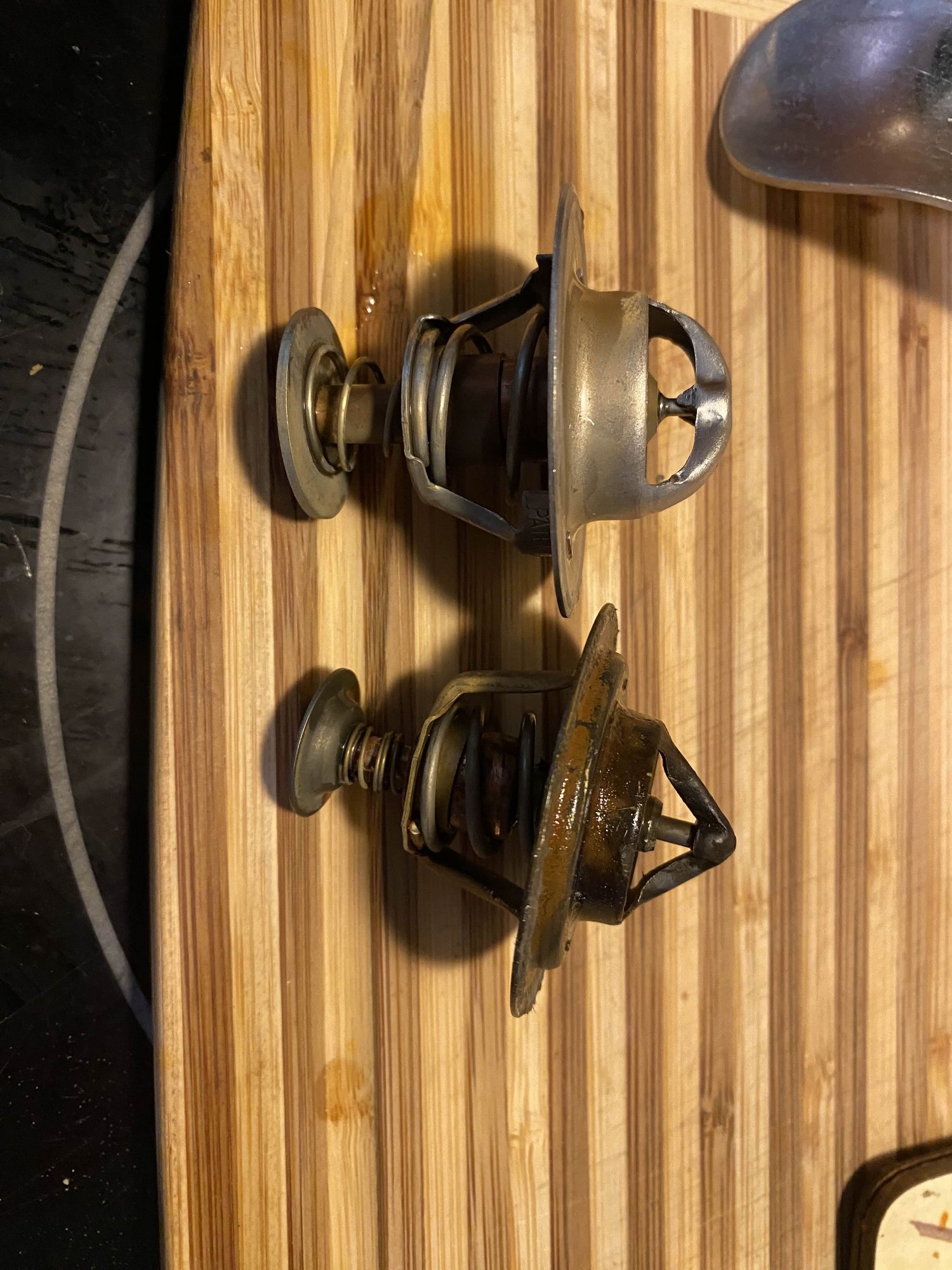

Really glad I decided to flush my cooling system and redo the thermostats. I cracked open both housings today (only breaking one bolt) and discovered 2 completely different thermostats. Neither OEM, 2 different temperatures, different brands and designs, etc. The one on the B Bank doesn't extend anywhere near long enough to close the bypass. Neither of them opened at their rated temp. Lots of sludge and silt came out as well after pulling the thermostats.

Good find, and a lesson for any V12 owner.
Ya gotta luv a well cared for V12, oops.
