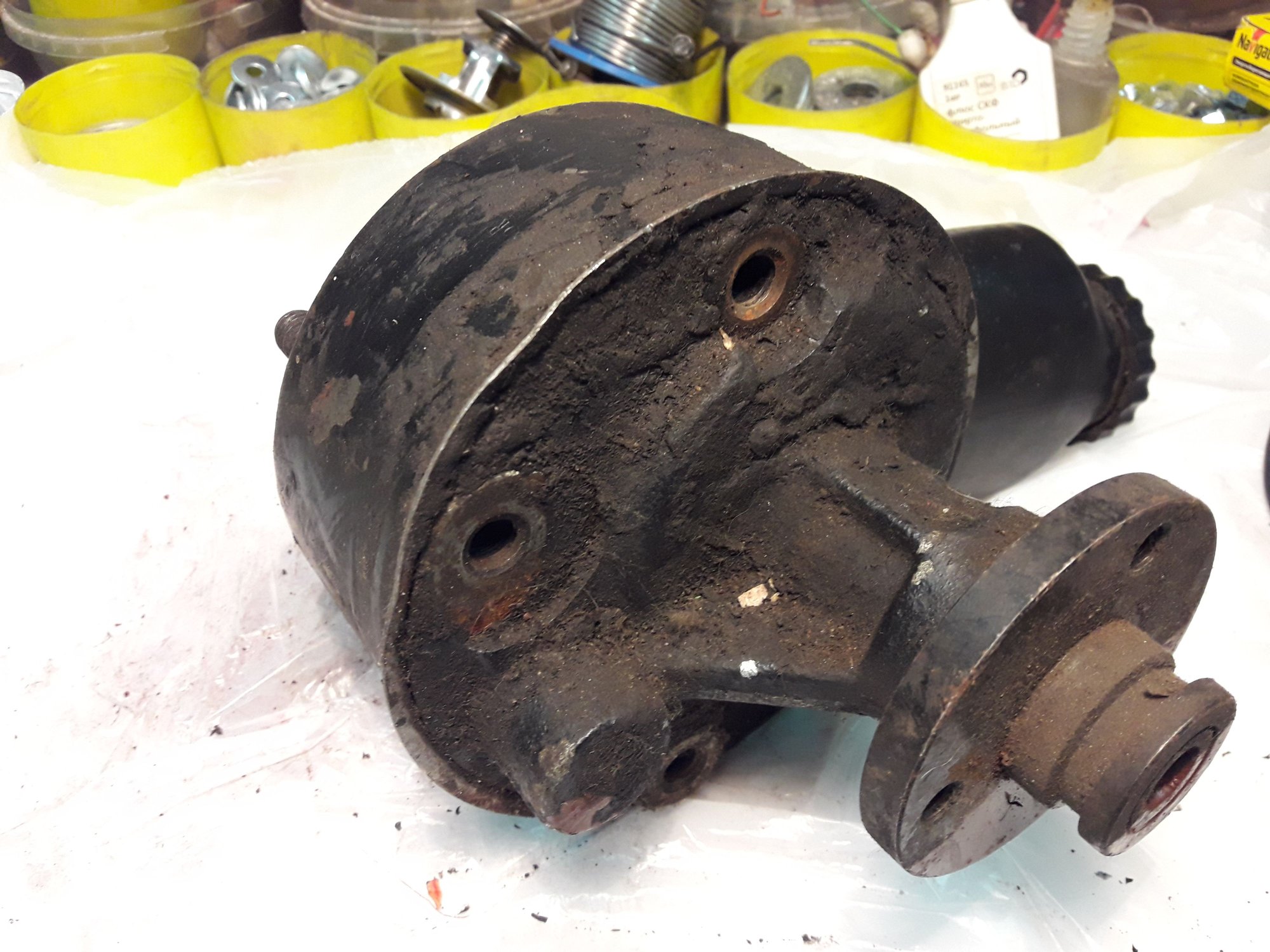

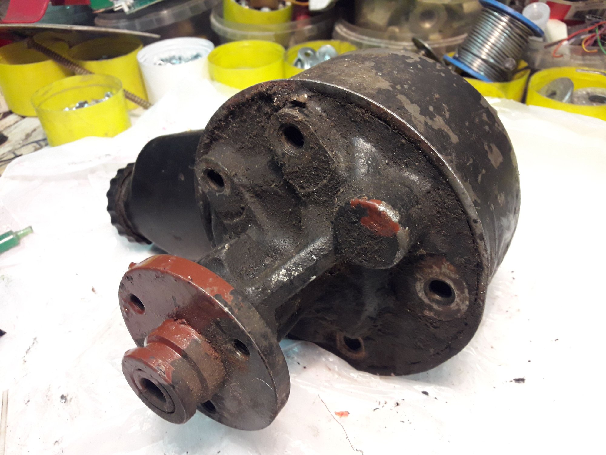

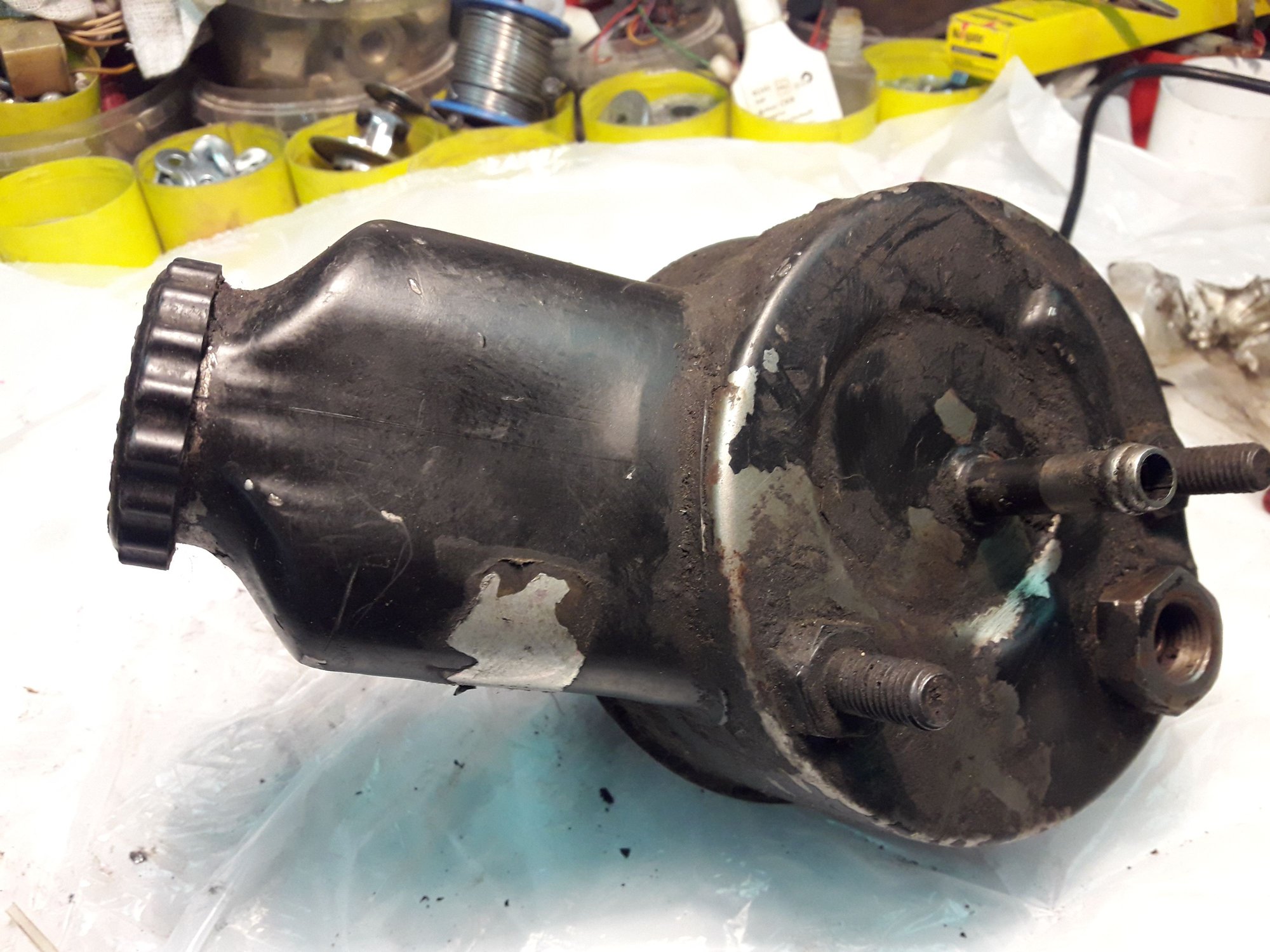

Hey guys,
Sp, I need a new housing for my Saginaw pump. These were made by GM, as we know, but GM uses a different NONcompatible case/can with the return pipe sitting in the lower left corner as opposed to the Jaguar setupmwith it in the middle.
Has anyone seen ONLY the case for sale somewhere? I can get hold of the can for a Chevy, a mere USD30 will buy a properly serviced and overhauled unit, but I can't find a new case...
Ideas?
Damien
PS: new because mine has been overhauled and refurbished but has so many dents and scuffs now, that it isn't worth doing it again...
