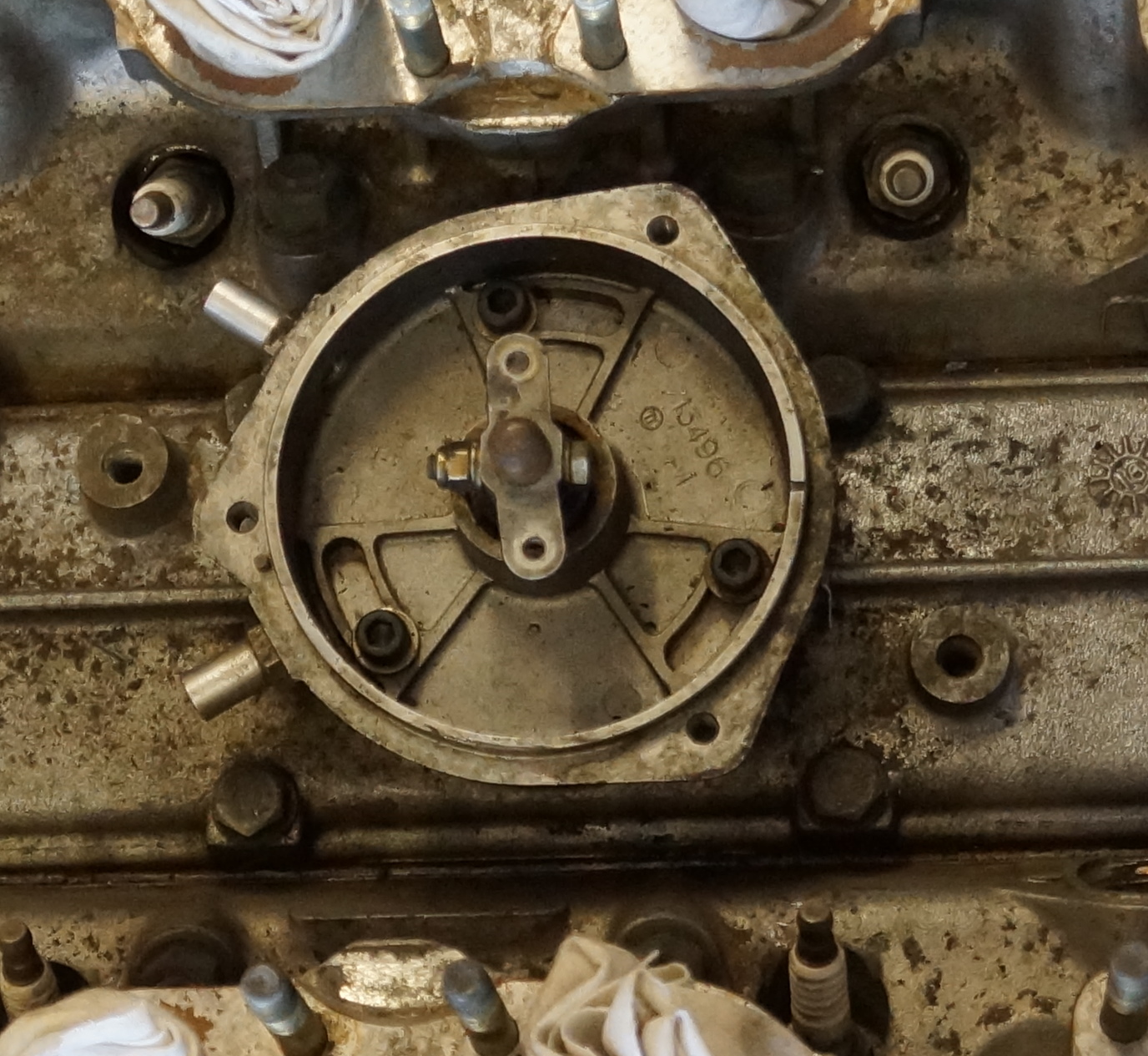

no need to "rig" up a vent system on the marelli, it already exists. Hoses are not shown in the pic but the fittings are obvious.
Makes sense! I stand dejected.
