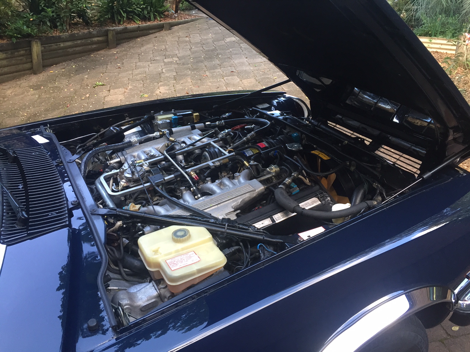

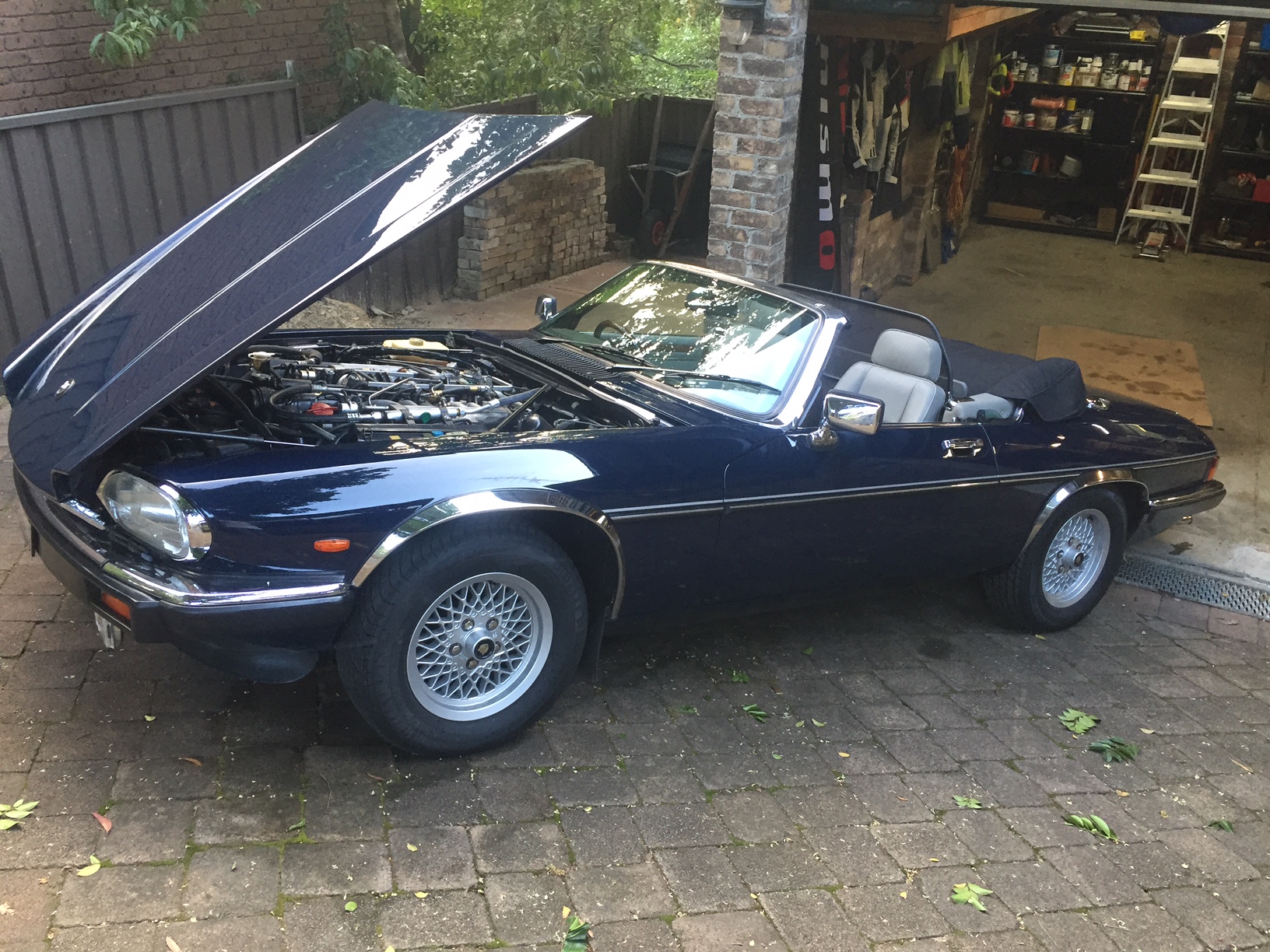

Ok I have the ideal driveway for this, unfortunately forgot the bit about filling to the bottom of the pipe and filled it right to the top. Managed to cover my pristine engine bay and front of the car in coolant on start up - bugger!
anyway all cleaned up now an managed to get 3litres more after the initial fill yesterday.
some pics for the hell of it
