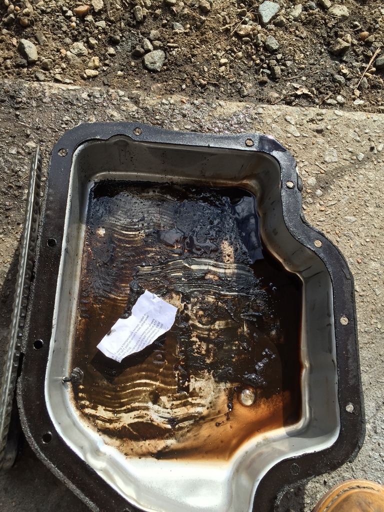

Whaddya think? Could've gotten a few more miles out of that fluid? Jeez, car only has 67k miles.
I replaced transmission filter, transmission mount and added a B&M deep pan with drain plug and then drained and filled transmission 3 times. Gonna drive a few miles and then do a final drain and fill.

Just in time by the look of it.
Was the piece of paper there when you dropped the sump or did you add it for effect?

Watch out for the drain plug leaking in that B&M pan. Mine did, from both the hard nylon sealing washer on the drain plug and from the drain plug fitment where it was attached to the pan itself inside. Well worth sealing the inside join with some hi temp epoxy stuff, and changing the nylon plug seal for something better. Just a heads up, may not happen to you.
Car looking great. LOVE the front bumper - which will greatly enhance clean airflow into the rad stack too, and do wonders for cooling.

Thanks for tip, this pan has one of those metal gaskets with a rubber surround on the inside diameter--maybe that is an upgrade?
Gonna have to cross my fingers on the welded area-I didn't even look at that.
Here is the pan I bought:
B&M Automatic Transmission Deep Pans 20280 - Free Shipping on Orders Over $99 at Summit Racing
Heads up, those fins on the inside had to ground down some in order to clear the tranny filter.

Yours is a much better quality object than my version was Andy. Looks like a cast one, so no leak worries from the fitment. That type of sealing washer is called over here a Dowty washer, and they are just fantastic. This is what mine looked like:
Robot Check Robot Check
and I took it off in favour of a Moroso jobbie that I am really pleased with and got at a decent discounted price:
Greg

Yes, I scraped some sludge up with it. Yuck.
