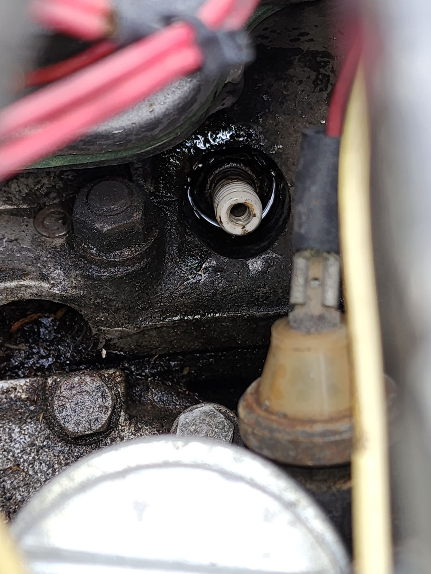

Good call gentlemen! Seem the rear sparkplug on the right bank lots its top. Of course it couldn't have been one of the easy-to-reach front plugs :-)
The fluid around it isn't oil, it's PB Blaster. Plug is stuck so I'll give it some time and replace it.
