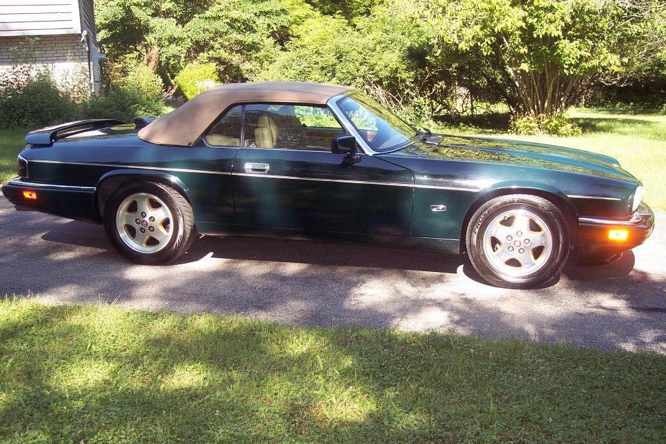

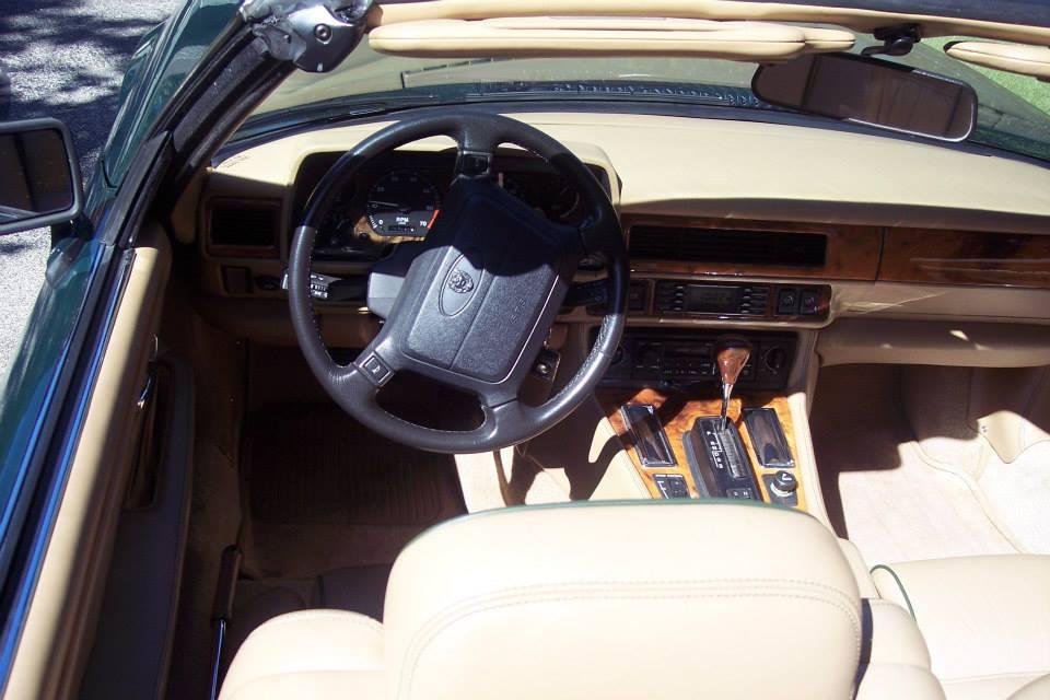

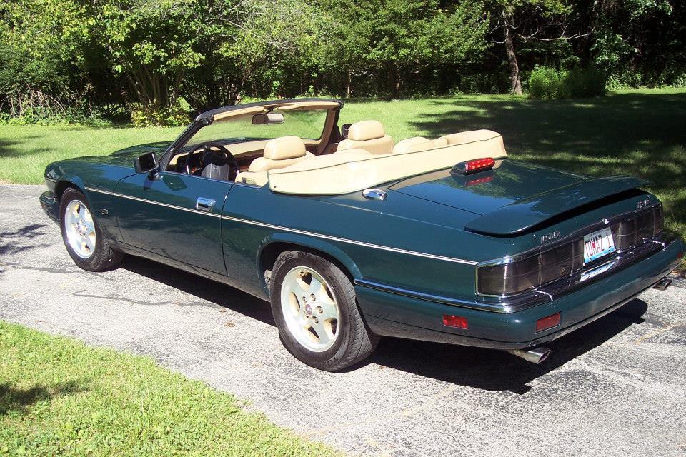

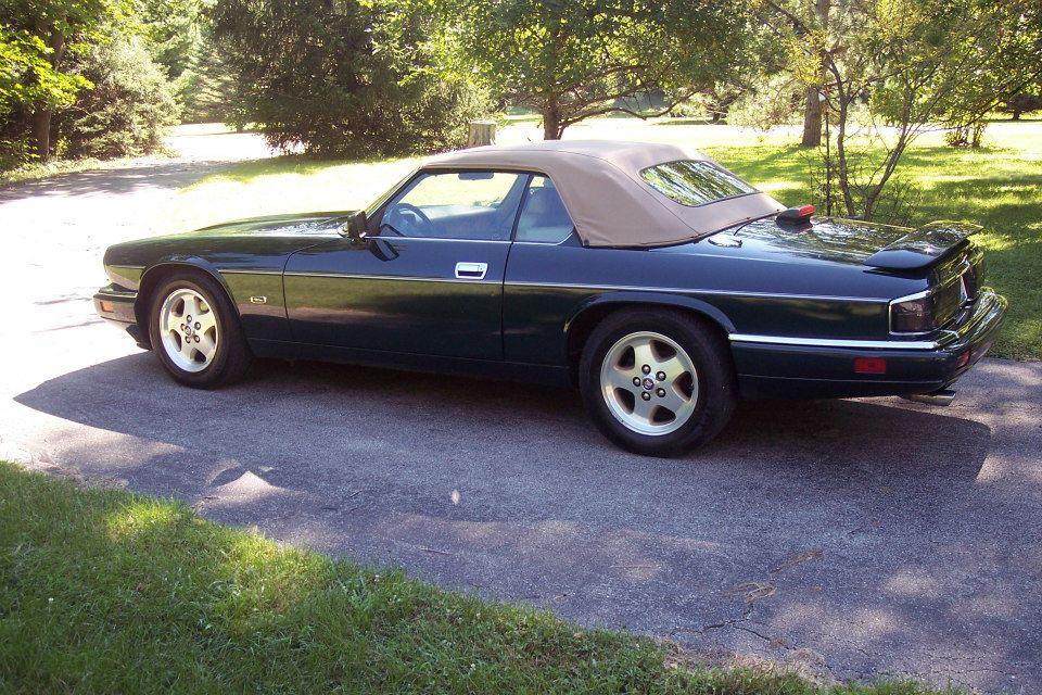

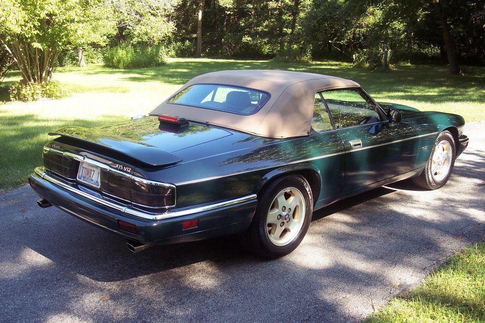

Here are some photos.
I'm just a little concerned about the silicone mod before we set out.....grinding the, hexagonal?, locating stud, to a state of just protruding, with my Dremel...I'll take the Dremel and a hand vac.
So what can you recommend brand/type wise for the silicone?
Still? Anyone any recommendations on gas to use?
Thanks to all,
Rob.
Attached Thumbnails Driving our "new" xjs back home next week.-brgjag1.jpg   Driving our "new" xjs back home next week.-brgjag3.jpg   Driving our "new" xjs back home next week.-brgjag4.jpg   Driving our "new" xjs back home next week.-brgjag6.jpg   Driving our "new" xjs back home next week.-brgjag7.jpg
Driving our "new" xjs back home next week.-brgjag2.jpg   Driving our "new" xjs back home next week.-brgjag5.jpg   Driving our "new" xjs back home next week.-brgjag8.jpg   Driving our "new" xjs back home next week.-brgjag9.jpg

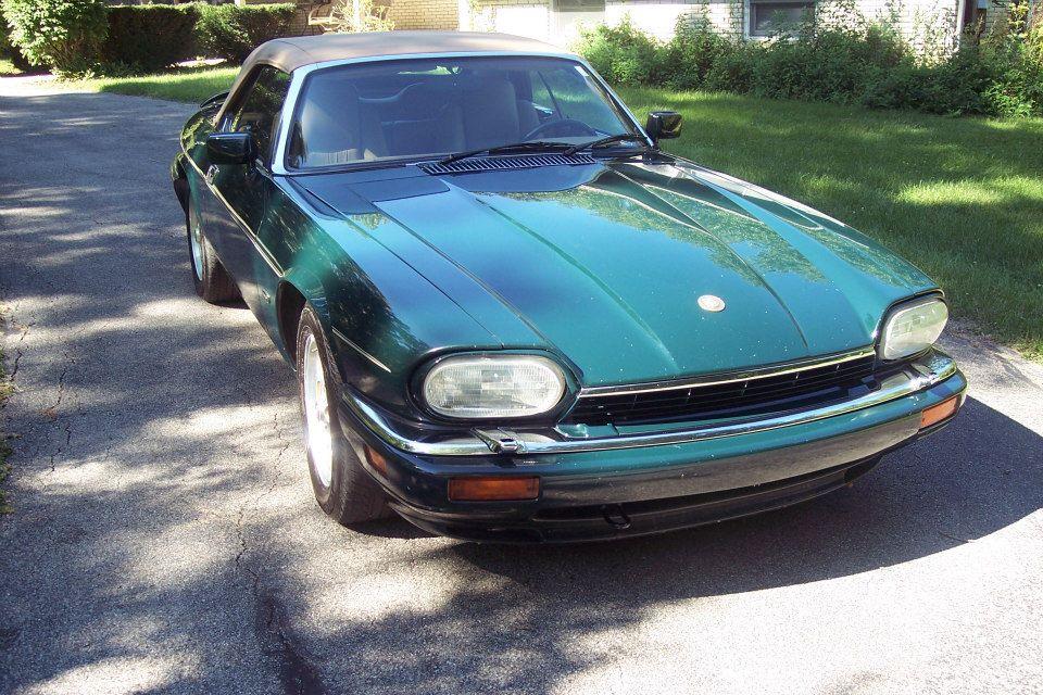

Thanks for the pics - nice ride! What is that protruding from the passenger headlight? And wow, I never realized rear seat legroom was so tight in the convertibles. I see why folks do the storage / subwoofer conversion.
For what it's worth, I did not have to (and would not have) ground anything down. I don't recall the brand of silicone, but it was obvious once I found the right isle at the hardware store.

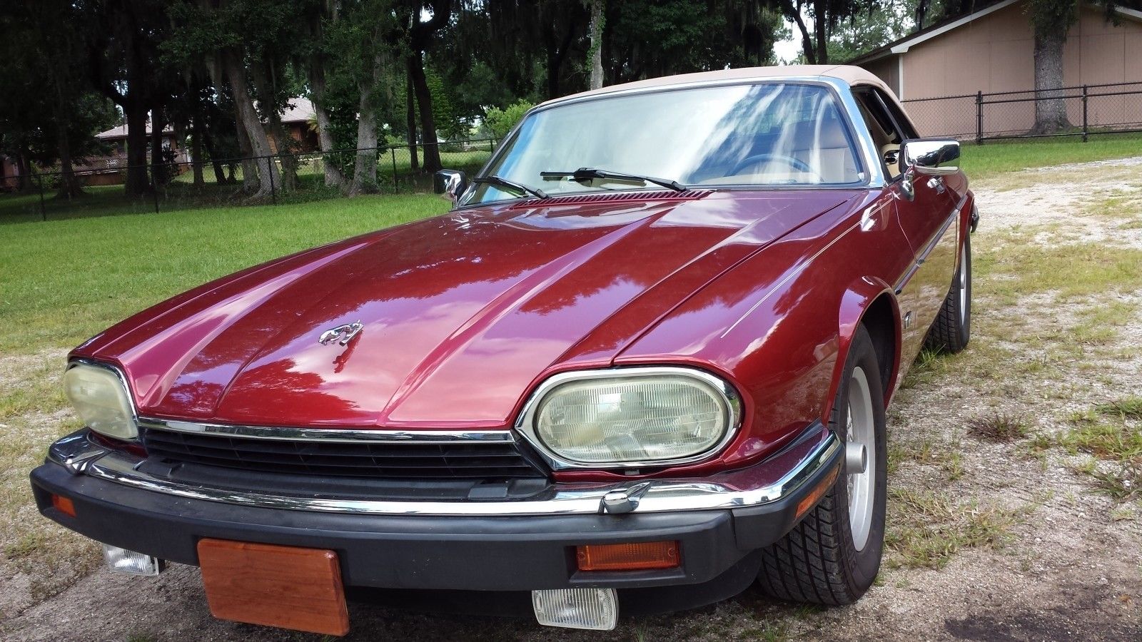

Protruding from under the pass headlight? That would be the heated power headlight washers.....bit difficult to see on the drivers side in the photo.
Fitted as standard on the V12s from 1992 on (the winter package option on 4.0 I6...headlight washers/heated seats/heated door mirrors).
Photos of a couple of '92s (5.3 V12s) show them more clearly.....the burgundy one was one we really wanted to buy....no rear seats..really wanted the storage here....not too concerned about the inboard brakes....couldn't come to a deal with the owner.....love both the burgundy or the green though.
Only 87 octane (with or without ethanol) here in the village !
We are also looking at a 1990 Oyster color, in great shape with 120,000 plus on it....if the price is right we would like this for an everyday ( well most dry days) use, because of the storage aspect.
Rob.
Attached Thumbnails Driving our "new" xjs back home next week.-%24_57.jpg   Driving our "new" xjs back home next week.-1992jaguar033_zpscc0cb360.jpg

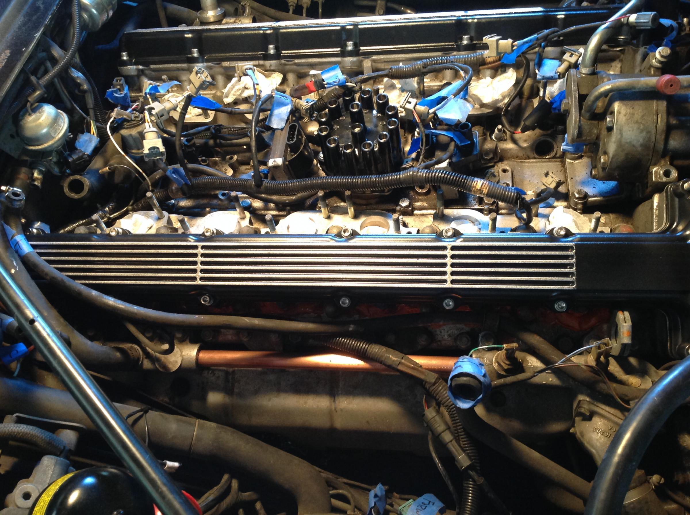

Originally Posted by Flint Ironstag

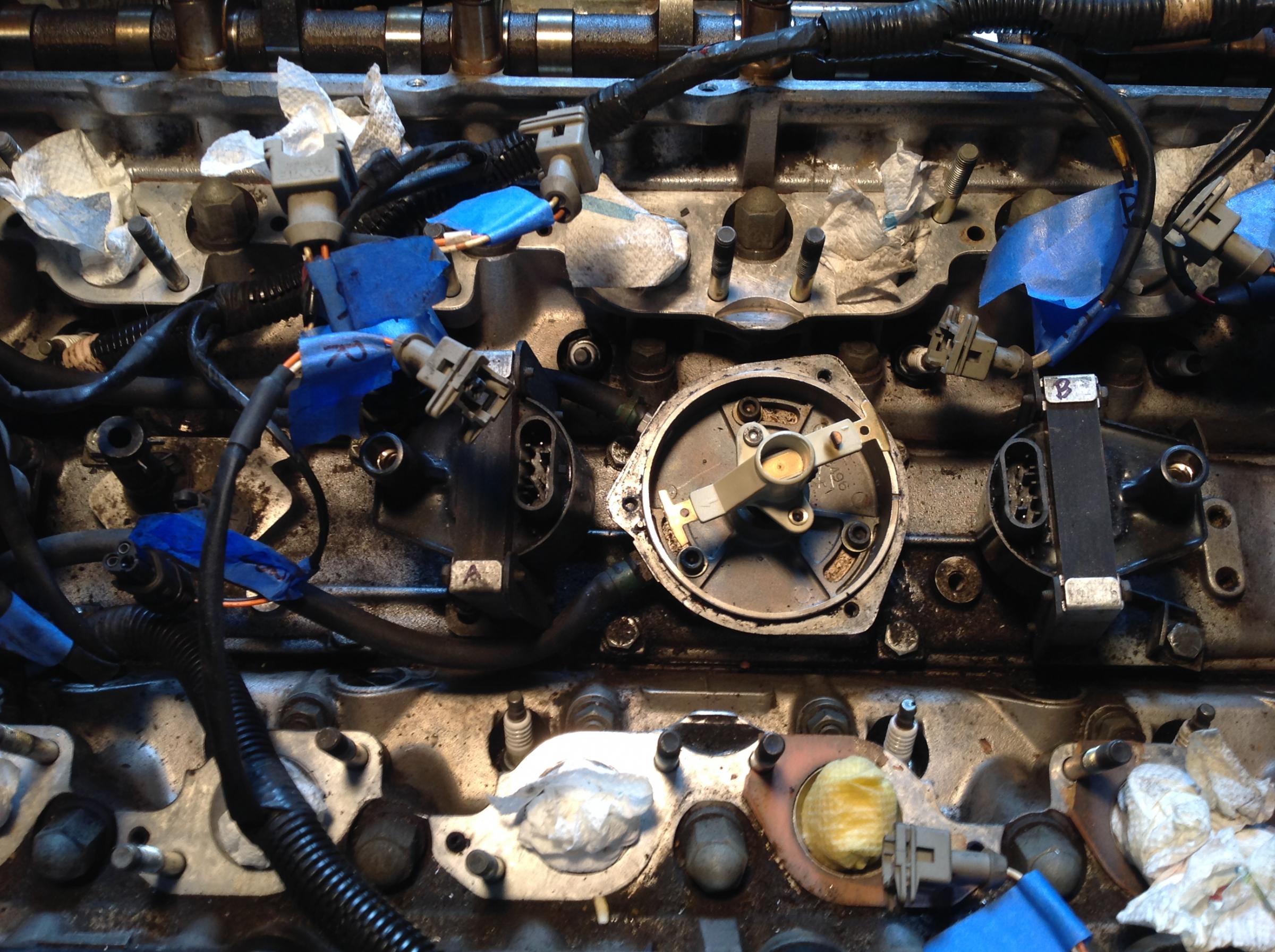

I am with you 100%. Now that I have done it once, it would take 30-40 minutes max to do it on any Marelli V12
I agree. Now that I have done it once....
When first looking at the engine and contemplating the work, I was very intimidated. Not having much automotive mechanical experience didn't help. I don't know what your level of expertise is but, me being a novice, here are a few things I ran into.
The Top Cover. Specifically the fasteners that keep it in place. The previous owner had replaced them with plastic Fir Tree type fasteners. I found three of the originals deep inside the "Vee". My guess is they pop out and are easy to drop and loose.
Cruise Control Bellows and Linkage. This will have to be moved/removed to get access. Have tools handy. A set of small metric wrenches (don't drop 'em) will help.
Spark Plug Wires. Will (of course) have to be taken off the Cap. Make sure they are marked.
Cap Removal. Straight forward. Phillips screwdriver if I recall correctly.
Rotor Removal. Should have been straight forward removal with an Allen Key. No so easy on one side. I needed to cut a slot in the head to get a screwdriver in there to get it out.
Cutting the Stud. Cant miss it. It's maybe an inch tall, 3/4" in diameter. Cutting it does make a bit of a mess and a hand vac might not be good enough. Cover as much of the area as possible to catch the filings.
Like all else with these cars, access to your work area will be the biggest problem. I was expecting to open up the hood, pull of a few spark plug wires and have at it. Not the case.
In the pictures you'll see the exposed Cap (I was doing other work at the time). And then the exposed Rotor.
All this work is very doable. I've done it, anybody can.
Enjoy the car and don't loose sleep about the Marelli thing. And certainly don't let it distract you from a thoroughly awesome car
P.S. Regarding the octane. On my car, just at the bottom of the instrument cluster, on the left side, there is a note. "Premium Fuel Only". I believe there is also one by the gas cap.
Attached Thumbnails Driving our "new" xjs back home next week.-rails.jpg   Driving our "new" xjs back home next week.-rotor.jpg

Bill C, nice shots of the working area. If I recall, I read and reread Kirby's instructions about 100 times in the preceding days, then I saved the relevant section on laptop or iPad, and went down to the garage to tackle it. Took pictures EVERY. SINGLE. STEP. My wires were labeled and matched the markings on the distributor.
Removed the cruise control bellows, and loosened the AC compressor just enough to tilt it out of the way.
I really wanted to clean the V while I was in there, but frankly was too chicken
It all went back together smoothly and fired right up. After a minute or so of white smoke billowing from the passenger exhaust, I took her for a vigorous spin, and all was well.
My level of mechanical expertise? Absolutely zero, as in none at all. Must say I was quite pleased with myself afterwards
