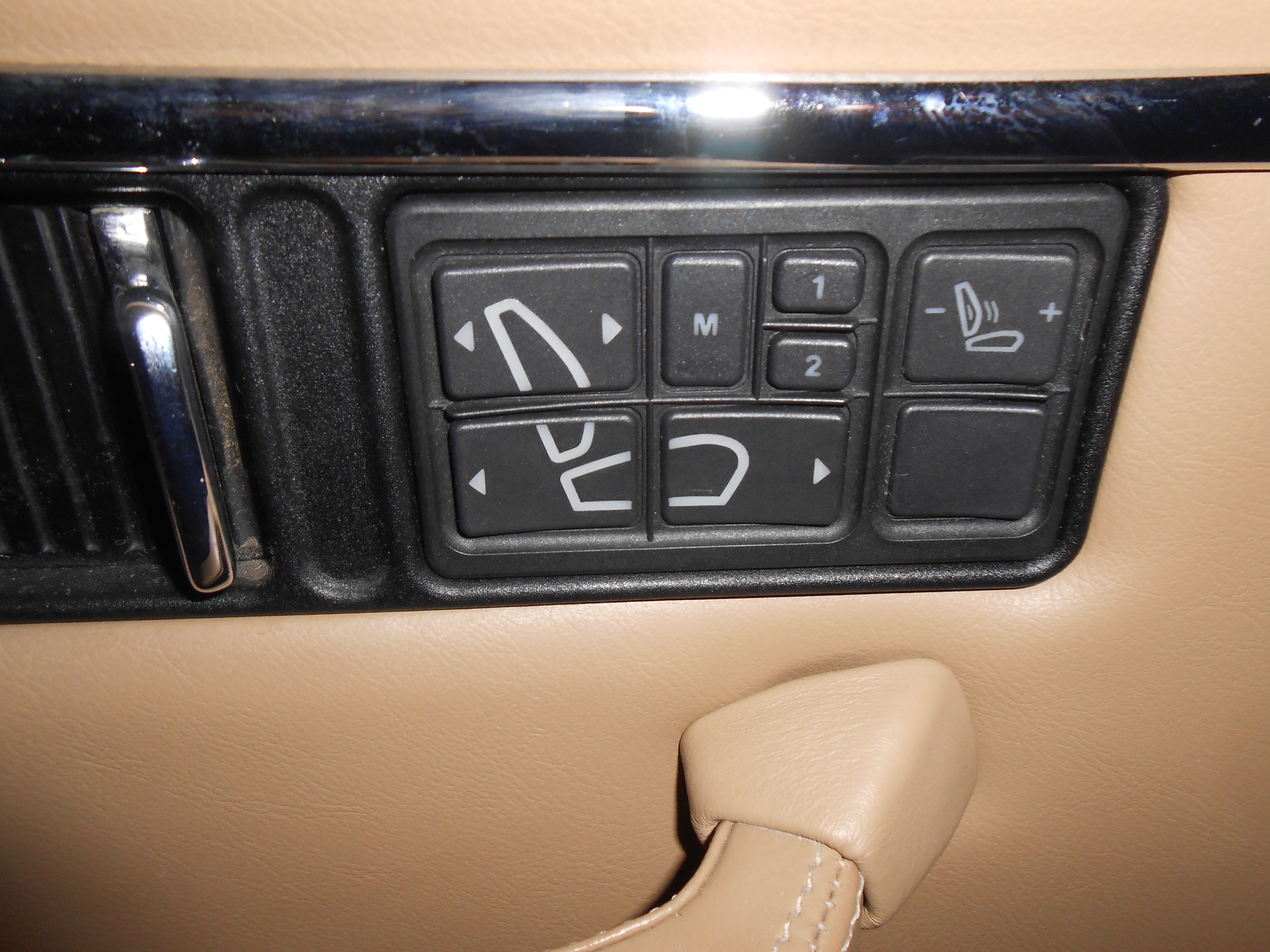

Old Jan 10, 2018 | 09:29 PM
malc4d's Avatar
Posts: 1,704
Likes: 470
From: Orlando
Are you guys sure about the seat heaters. The switch is on the door next to the lumbar support switches. Rear fogs (on the trunk) only work with the headlights and I believe the ignition on.
That is exacty the switch panel on the door as pictured, but even though the "button" is there, there is no label on it and the button does not push in or activate. It's a dummy button for where the real switch would be. I am curious if the switch panel or even the door harness is even wired. And like we all say, most would not even be driving in winter with these cars so why are we racking our brains about it... becuse we can, and inquiring minds want to know , maybe on some engineering or commercial level, if Jaguar does any pre-wiring for options, etc..and how hard would it be to do it ourselves. I'm gald I'm in the company of other nutty enthusiasts.

From: California
Here is my drivers side 96 XJS. No seat heater button. Would be nice to know if the seats are wired/outfitted with heaters - will need to look at those more closely
