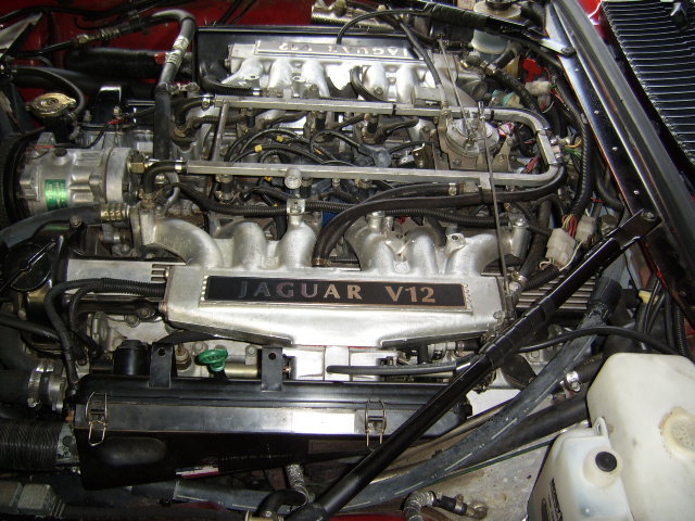

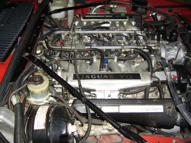

Some of mine. Many more on file if needed.
It is totally rewired, with ALL wiring coming onto the engine from the rear.
Engine bay pics.-engine-bay.jpgEngine bay pics.-engine-lh-pc.jpgEngine bay pics.-rh-general-engine-view.jpg
