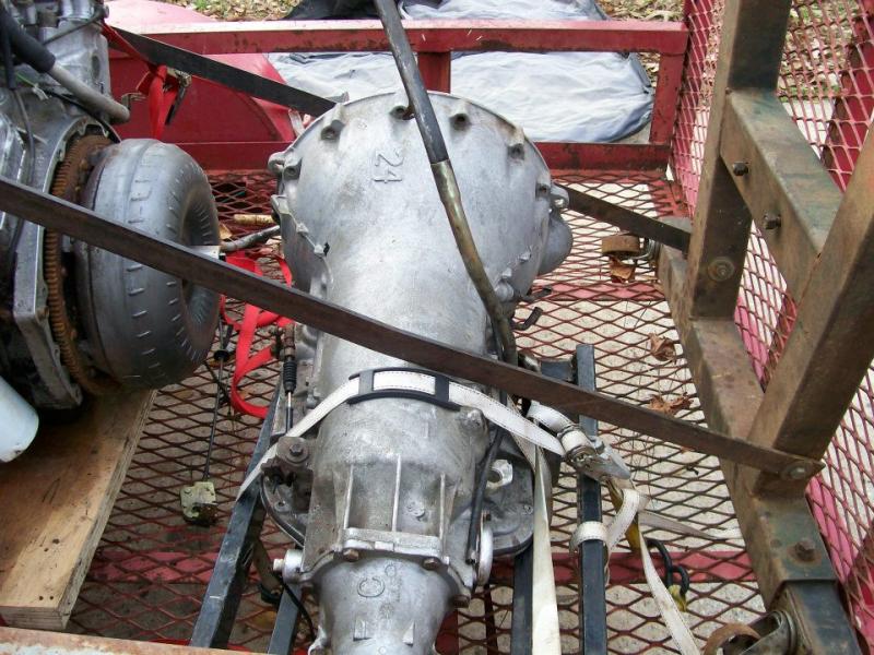

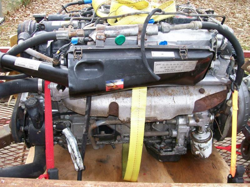

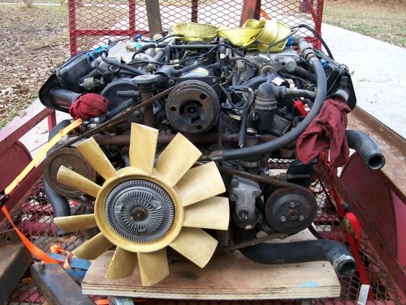

a few pics. all i know is its a US spec HE. The lady said its a low mileage 86 but who knows. All of the rust and dirt is from being outside really

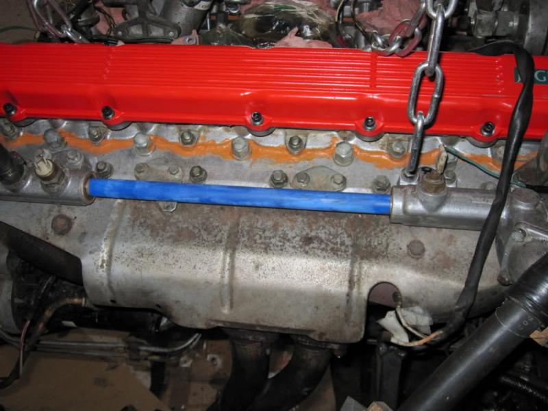

Basically it's all caused by oil leaks! Gunking everything will shaft the electrics in no time. To stay clean it has to be oiltight. If you redo all the gaskets (apart from head gasket) and fix the half moon seals and the timing chain access hole, and keep a careful eye on/regularly renew the oil pressure senders, it will stay a lot cleaner.
The great but epically stroppy K Palm's book is very sound on what needs to be done to make the thing oiltight. Just the time to do it now the engine is out.
By the by, the seal between the tappet block (that holds the camshafts etc) and the head also leaks. It is a very big job to remove it and not worth it IMO, unless you have a valve problem, obviously. Once the engine is cleaned up, rough up metal along the join with a bit of sandpaper, and lay a bead of high temp silicone all the way round and press it in with a finger. It will stop the leaks just fine. Bit of a bodge for the purist, and I am not very good at making these things neat as you can see, but works a treat!
