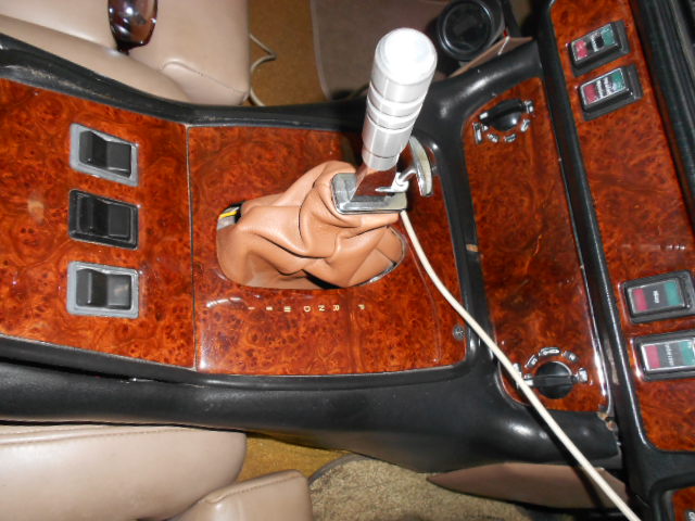

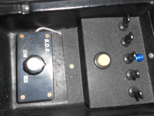

pic of my James Bond consul switches, key switch is a master for all of them.
1st on left is fuel pumps activate on.
2nd is computor activate on
3rd is ignition activate on
4th is fans & vacuum pump on
5th is a master for the full panel of switches.
button in center is for starter solenoid on
Knob is for rich or lean while driving ,along with an Air/fuel ratio gage!
works great and i can turn any on or off at will, been 20yrs since installed.
YES i probably was a little ahead of the curve, they didnt have any useful jag internet back then!
Attached Thumbnails Extending the Start Up Phase-center-consol-j-bond-system-002.jpg   Extending the Start Up Phase-center-consol-j-bond-system-003.jpg

diam, the switchs give the ability to diagnose problems(if they occur), seperatly!
like checking fuel pressure,without all the other systems on.
or testing ignition without fuel on, just starter cranking,ETC.
test fans etc. or any other electrical components, one at a time!
my car is about exclusivity, anyone can buy a standard ordinary car(factory stock,just takes money) but mine is a custom build to suit my own ideas, and no one i know has one like it, to duplicate my car,having some shop do it, would coast easy $50,000.-75K.
