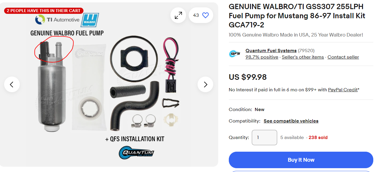

Also what fuel pump? It should have a barb.
I use this Walbro over sized pump, it's not a direct replacement but can be made to work with a few mods... The the point is that the right pumps have a barb like the one shown.

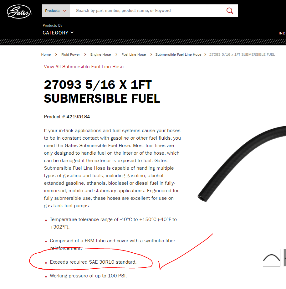

Submersible fuel hose.
https://www.gates.com/us/en/fluid-po...00-000012.html

Well, the shop kept insisting on using Gates Barricade 4219BF, even though it clearly says not to use it in tanks. They say they never had any problems.
I ended up paying RockAuto $60 for 2 feet of Gates 27093 Submersible hose and the shop will install it... I'm not happy, but in the end, I have to get the car back, and this is warranty work, so there's no more charges.
I found some SAE J30R10 5/16" hose on Amazon for $11 for 10', but at that price difference, I had to assume something was not right. There was also one for $18 for 5', but I think paying more for the brand name here makes the most sense.

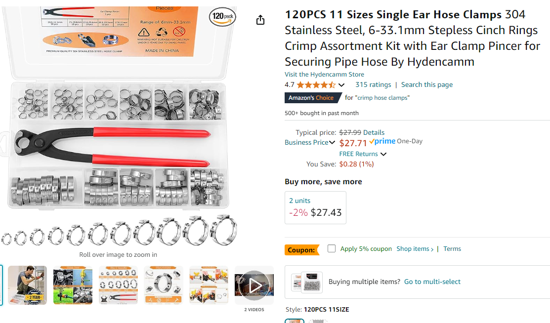

According to Gates' web site 27093 ecxeeds SAE J3010R, so you're good. Use a propper clamp and you'll be good to go for a long time. One possible prop[er clamp are the EOTINKER stainless steel crimp clamps as shown below.
