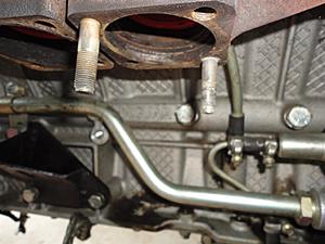

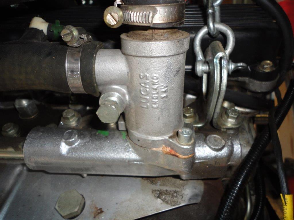

I bought the new to me used engine from SW Engines in Eugene Oregon. It arrived yesterday. I noticed a few things that look different than my engine, although it is a Marelli ignition engine.

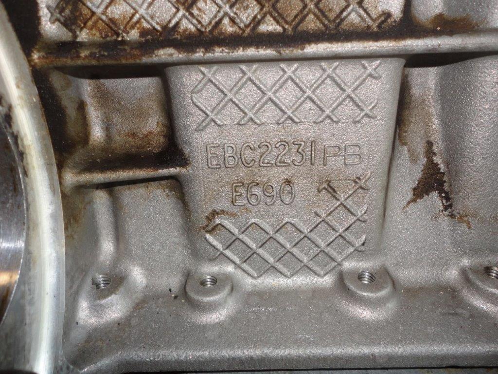

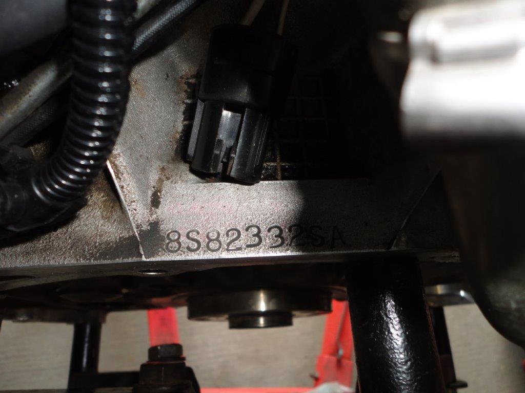

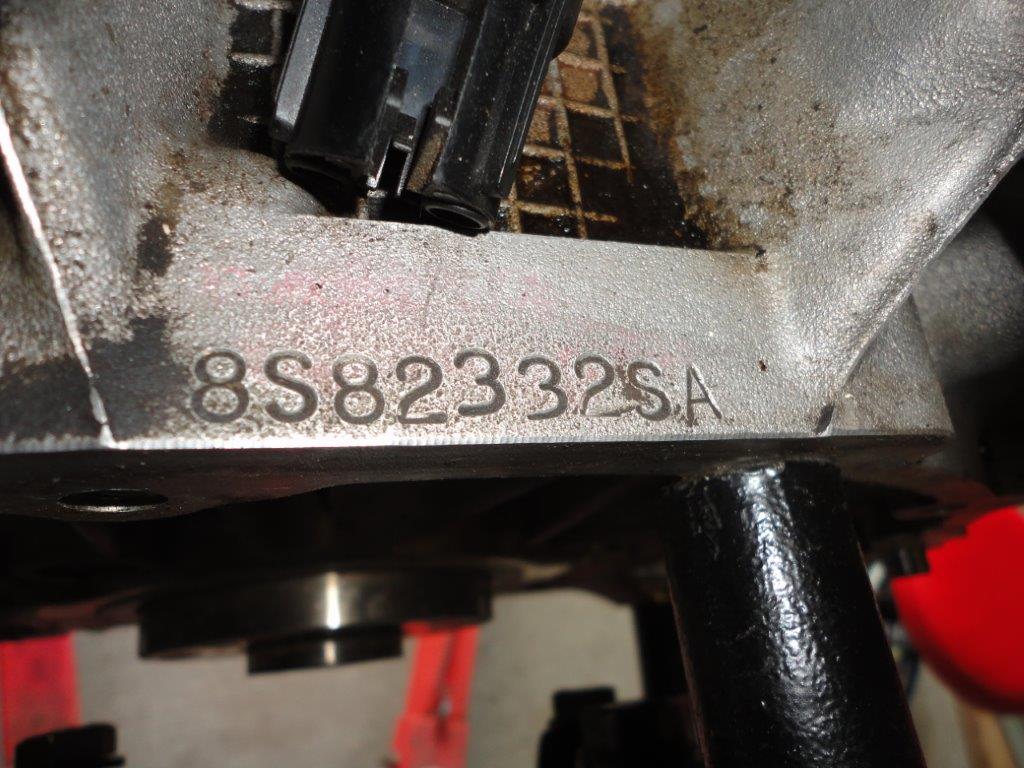

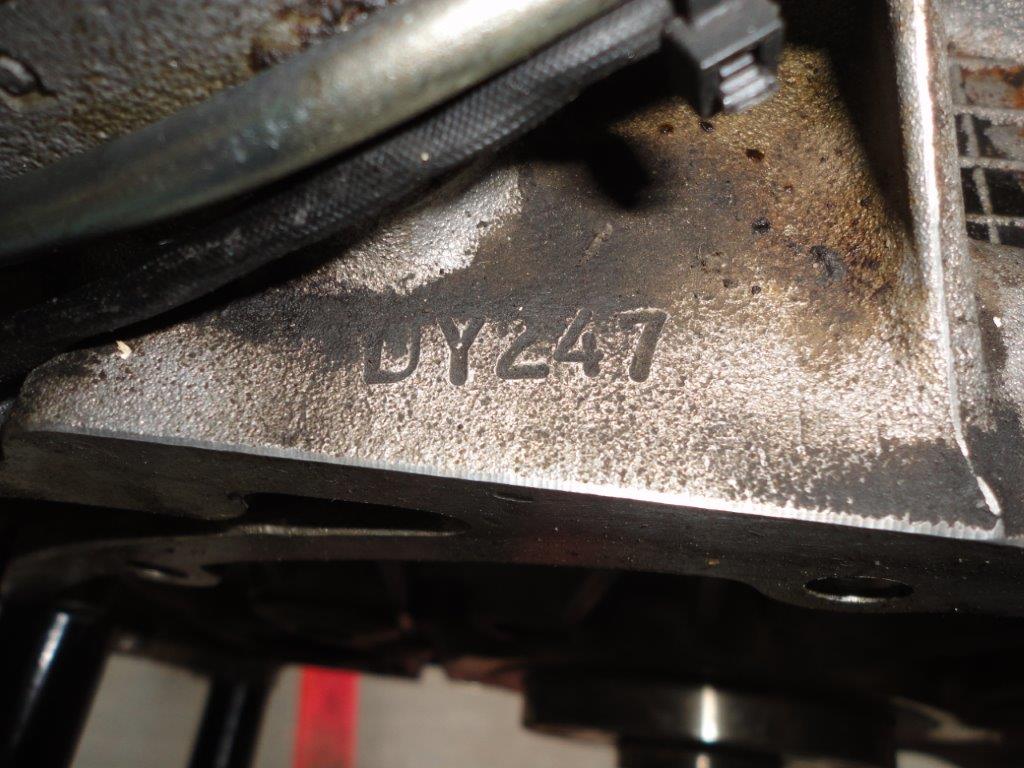

Serial Number for this engine is 8S82332SA. DY247 is stamped to the left of the serial number. There is an additional web above left of the transmission mounting flange. The exterior of the block for 8S73301SA is smooth surface rough cast. Engine 8S82332SA has hashmarks cast on the exterior of the block. The JAGUAR embossed on the left side of this engine is different whereas the JAGUAR embossed on 8S73301SA is in a hexagon.
Other than these differences, the engine seems to be equipped the same.
What can you tell me about this engine?

ENGINE Code
Breakdown for 8S82332SA
PREFIX : 8S Jaguar XJ-S 12 5.3L 12 cylinder SERIAL : 82332 Marelli digital ignition HE (High Efficiency). NGK BR7EFS Spark Plugs. Gap .025". Bosch 115A alternator. SUFFIX : SA Standard Compression with Grade A pistons & liners. (11.5:1 Compression)MFG YEAR (GUESS): JUL 1981 to LATER
This is the place to decode all XJS numbers:http://jaguar.professional.org/jagvin.php

Does anyone know about when the change to the crosschecked Blocks started?
