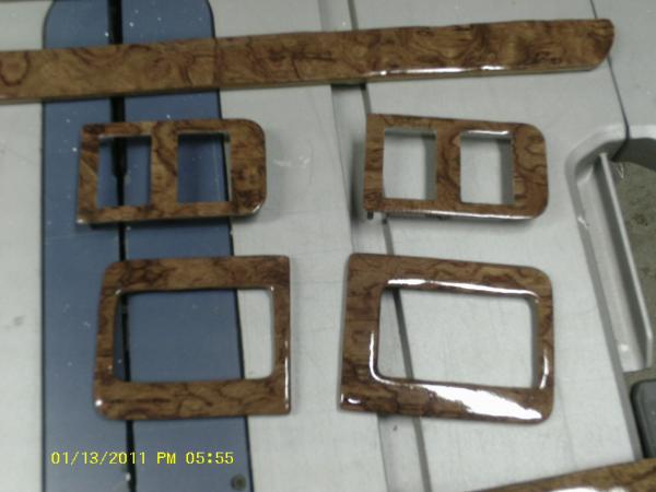

Been re-veneering my wood trim for the past couple of months and finally got it done. I decided since I am doing it myself, I went with WaterFall Babinga veneer. Have bought an extra ski slope on ebay and intend to do it the same.
Attached Thumbnails Finally finished the woodtrim-1-daverb-139963-albums-wood-trim-finally-done-8842-picture-10-coats-polyacrylic-applied-brush-ha.jpg   Finally finished the woodtrim-2-daverb-139963-albums-wood-trim-finally-done-8842-picture-010-22779.jpg   Finally finished the woodtrim-3-daverb-139963-albums-wood-trim-finally-done-8842-picture-008-22778.jpg   Finally finished the woodtrim-4-daverb-139963-albums-wood-trim-finally-done-8842-picture-012-22782.jpg

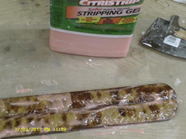

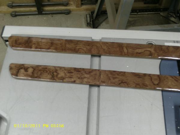

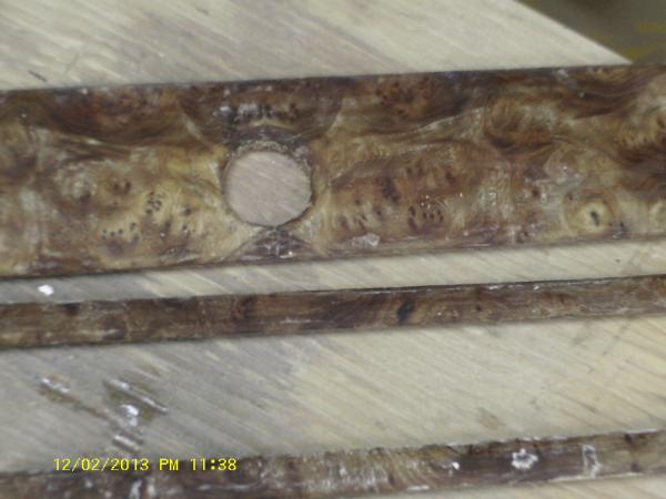

these are the pics of the process I took for re-veneering. Since I did not have a vacuum pump I used one of those Space Bags LOL
Attached Thumbnails Finally finished the woodtrim-daverb-139963-albums-wood-trim-re-veneering-8742-picture-stripping-down-22494.jpg   Finally finished the woodtrim-daverb-139963-albums-wood-trim-re-veneering-8742-picture-more-stripping-22493.jpg   Finally finished the woodtrim-3-daverb-139963-albums-wood-trim-re-veneering-8742-picture-vacuum-sealed-do-not-own-regular-vacu.jpg

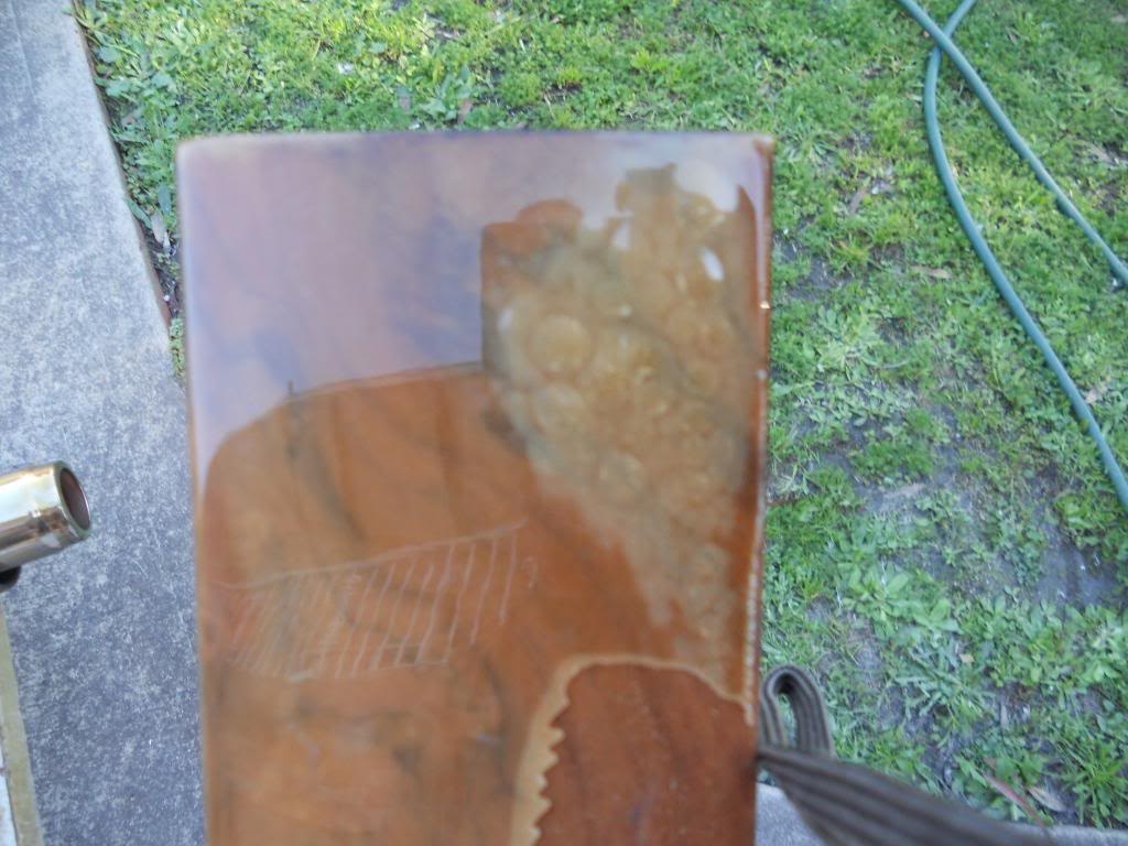

The lacquer is Polyester resin and it comes off easy with a heat gun. Do not get the gun too close or you will burn the wood. Just enough heat to blister the polyester and a paint scraper.
I used 2 pack polyurethane to refinish mine. Then wet sand and buff.
Before being buffed.
Attached Thumbnails Finally finished the woodtrim-dscn0527_zps203d4b4f.jpg   Finally finished the woodtrim-dscn0564_zpsd685d375.jpg   Finally finished the woodtrim-dscn0561_zps6b65c895.jpg
