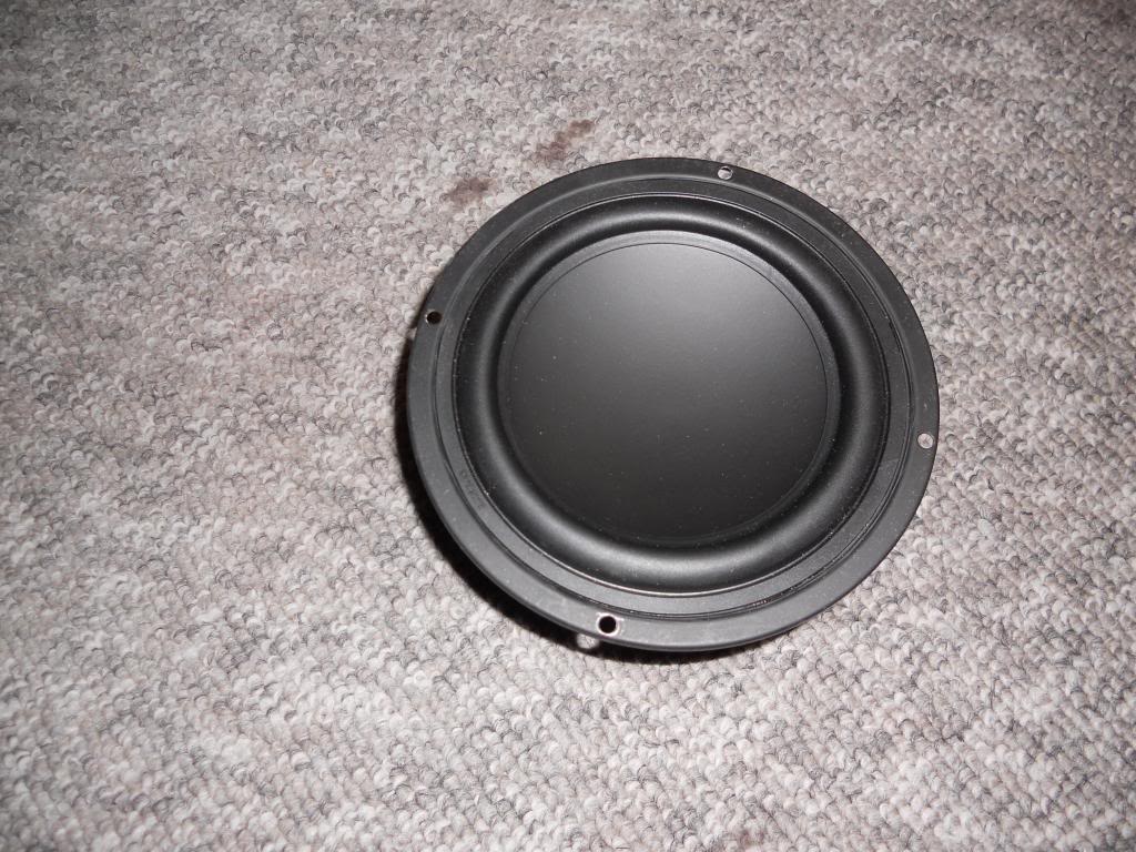

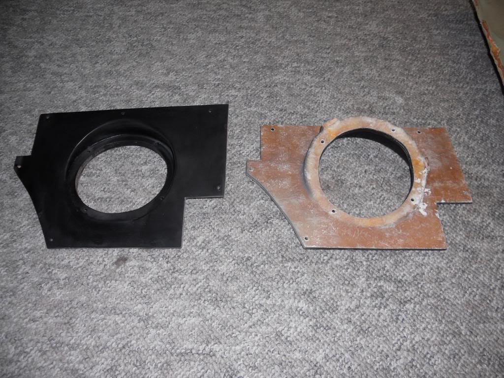

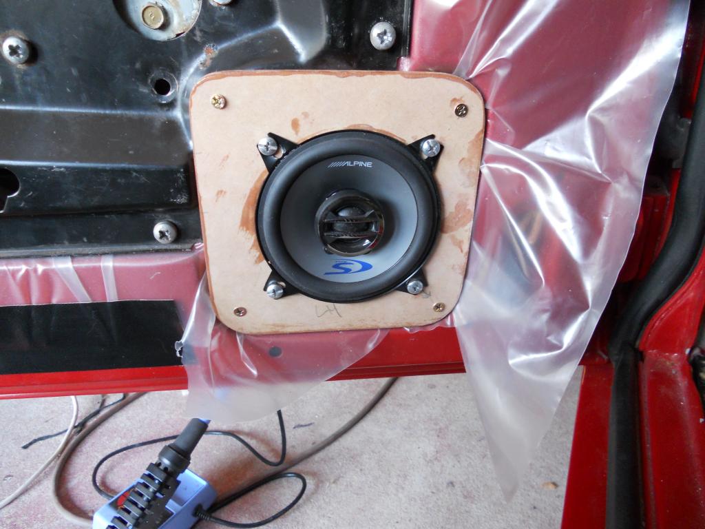

6" will fit in the rear I made new mounts to fix the speakers to the car body. These are 6.5"
6" will not fit in the doors there is not enough room I think 5" might fit. Again mount them to the door.
