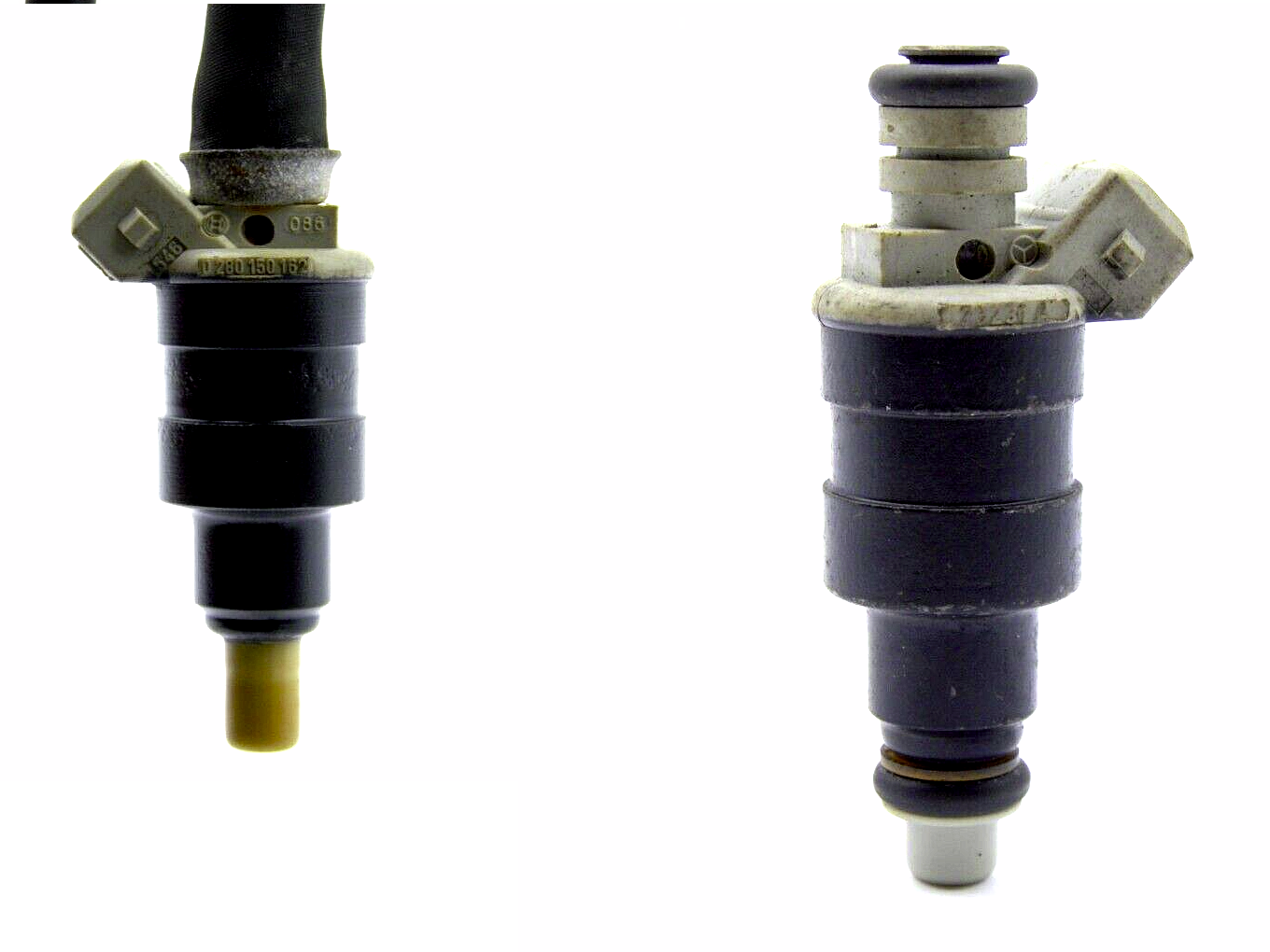

This will seem like an odd question but how does the later Bosch EV14 insert into the manifold ? - are the injector ports in the manifold any different on the 6.0 vs the 5.3 -
Does anyone in the UK have a scrap injector from a 6.0 laying around that they wish to dispose of - want to check something out - is the O ring on the 6.0 injector the same diameter as the rubber seal used by the early 'non O ring' version is the question I'm trying to answer.

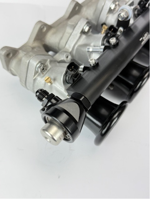

Injectors will be clamped to the rail, the rail will be clamped to the manifold
I am in the process of designing the fuel rail mount - I could use the injector hold downs but I could simply use the fuel rail to hold the injectors in place - it is rigid enough so perhaps three of the existing injector mounts would be replaced by a fuel rail mount - no more hold down plates either. You can make out some mounts in this image - it also shows the pulse damper 'prototype'
and yes I am getting these made in Australia ....
And to answer the question I am moving to high impedence EV14 injectors - 14ohm not 2 - the flow rate is higher but I will be using wideband Lambda to manage, I will be running a slightly higher pressure than the default Jag pressure regulators. I will run 43.5 psi (3 bar) with vacuum compensation and will run in closed loop. Idle air will also be electronically managed.
