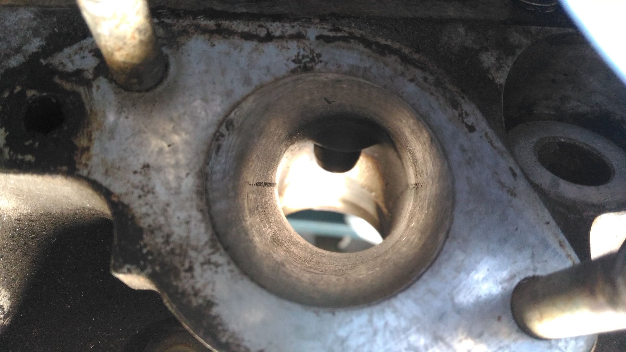

That assembly will work. Daim is correct it will not have cold start injector bosses machined, but I have read numerous threads where (I think it was Grant) deleted the CSI.
You may need to swap the FPR for an adjustable one to tune AFR. But I would install it as is and check AFR first.
Also before you install the manifold I would port the head end to clean it up and remove most of the injector boss.
First pic is the ported manifold, Second is the intake port before porting, notice the rough 45° chamfer, third pic is the port after smoothing, I have opened them slightly but not much, mostly they were matched.

I saw that on the 6.0 head the 45’
ran into this today. Going to needs to do some mods.

That is a 6.0L head.
It's the small things that catch you, like the different spark plug angle on the pre-HE.
That manifold is off a saloon keep the throttle body angled adaptors and make a new intake system with a pod filter inside a can.
